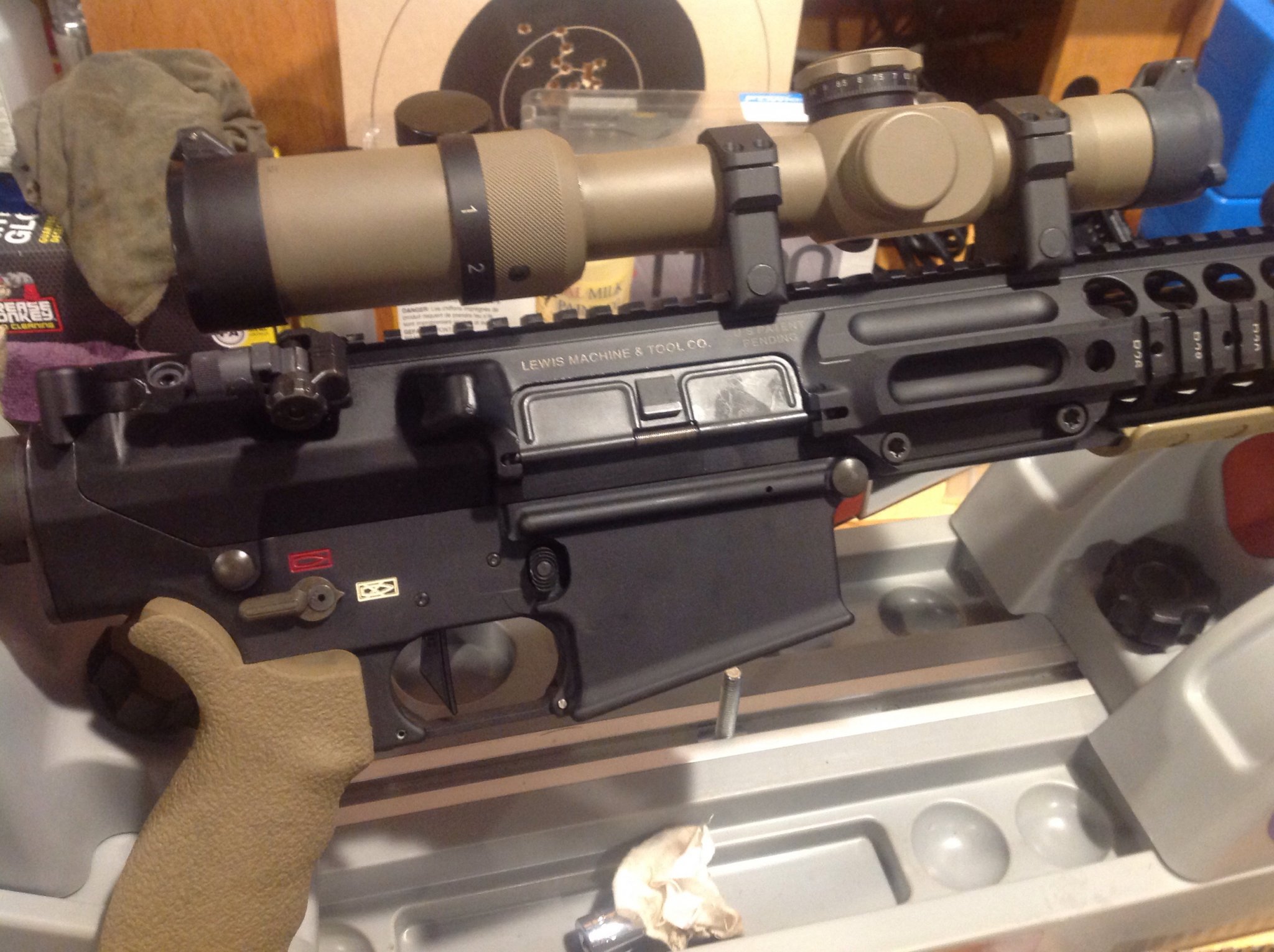

LMT .308 MWS
my humble submission
Nice setup, how do you like the offset sights? Is this LMT setup for a run and gun type of application?
The LMT was originally set up to be my "One" precision rifle when I decided my Garand wasnt it when I started getting back in to shooting back around 2011.
Somewhere back in these pages its pictured with a PSR stock and S&B 5-25.
It never seemed to give me the accuracy I wanted and it was heavy. I learned to love bolt rifles.
I decided to "detune" both ARs and make them what they should be.
The 1x8 came off my CQB now that gun wears a TA33.
The MWS went back to Sopmod and wears the 1x8.
The S&B will go on a in build bolt.
An AR for 0-600.
An AR for 0-800
Bolt guns for 0-1000
Garands, M1A, 03s for smiles.
The offset KACs are great. I rarely use them. I went with offset thinking if my scope ever did go down in time of need they are there without me having to take out tools to remove the scope. They do point nicely with a quick roll of the rifle if you have them deployed and ready.
Top rail KACs go on the guns with QR mounts.
