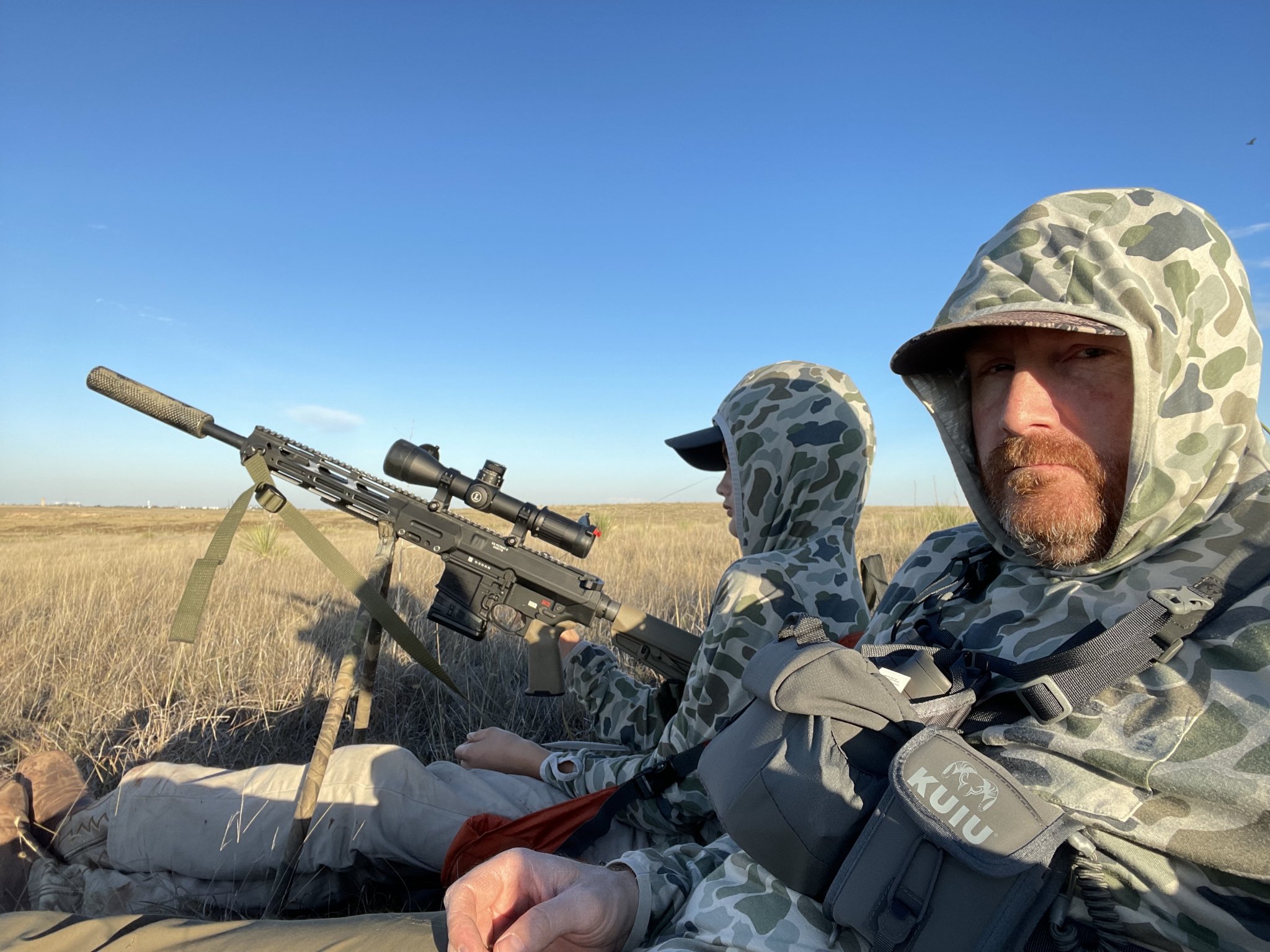

My boy got this antelope with the MWS last weekend. Made a nice little layup shot. She tasted awesome! Did some coyote hunting later that evening as well. They were bursting with manliness so the shirts had to come off.

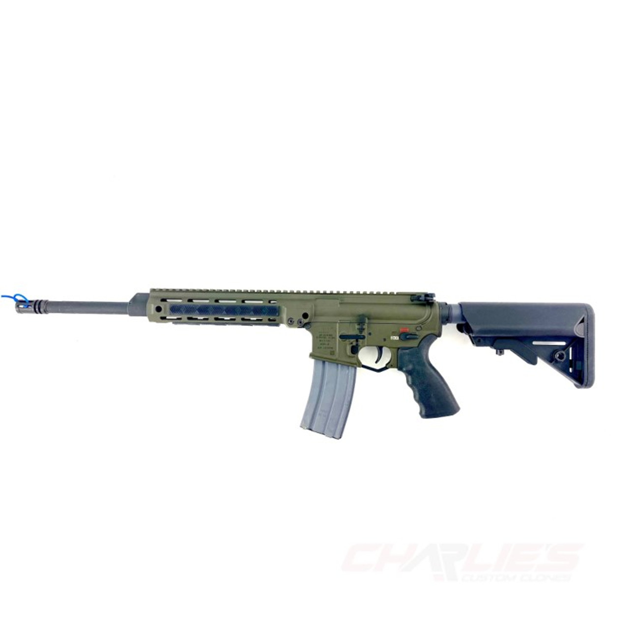

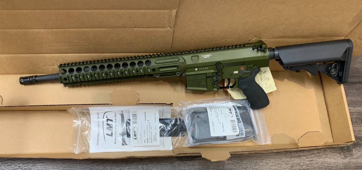

Question for the LMT community, I just purchased an LMT MARS-H 7.62 with 20" barrel, I would have liked a 16" SS 5R barrel but since I could not find practically any other LMT 308 anywhere I figured I might as well grab this one. I also would have preferred an LMT Olive Drab rifle but these are like unicorns these days.
Question is - if I have my rifle Cerakoted in some type of OD Green, but leave all LMT markings masked - how much would this "devalue" the rifle, I am "okay" with black, just prefer other colors and like the uniqueness of the OD Green. Also, if I do go the Cerakote route, anybody know which color might look best, I know Charlies (@longshot2000) has had some green LMT's before but I think these are from factory. I have a question in with LMT to see if they can provide any guidance but thought maybe some of you may have already gone down this road and curious your thoughts.
Yes I believe you’re looking at two different finishes, the mrp 5.56 is likely ODG in cerakote and the mws 7.62 was a contract overrun which was anodized.
Thank you TS, that must be where my mixup is - I've seen what looks to be painted rifles and thought they were MWS but likely just the 5.56 whereas the green MWS was anodized.
There were anodized green MWS and MRP rifles. Low two digit examples. Everything else since then has been OD cerakote.
Brilliant, Cerakote has like ten different OD Green, any idea which matches best? MIL SPEC O.D. GREEN H-240 looks like a good match, but so hard to tell even on color corrected monitors.
