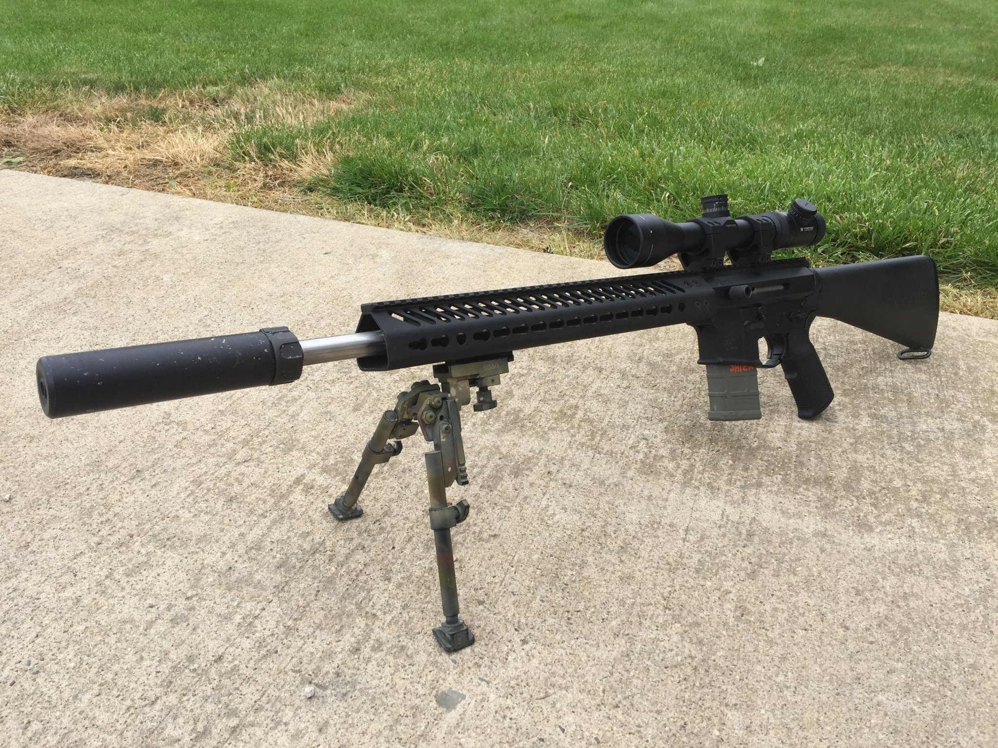

    Any way, rifle specs are:
    -Older Rock River Arms complete lower with Geissele SSA-E trigger
    -LAR Side charged upper (very tight fit on lower)
    -Lothar Walthar 18" 1:8 SPR barrel
    -Surefire SOCOM suppressor (always on the rifle)
    -Vortex PST 2.5-10

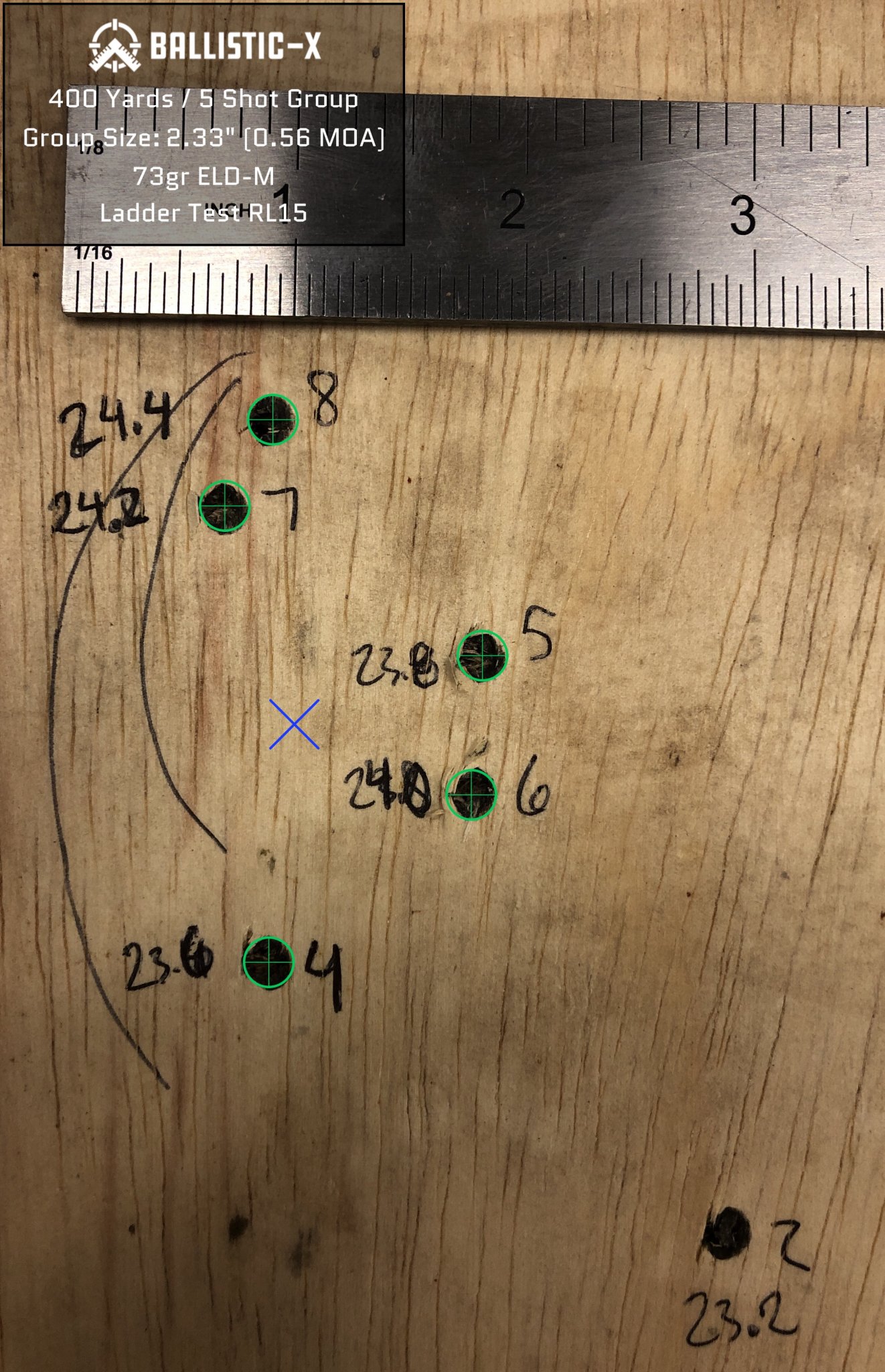

    After narrowing down the 2600fps node, I went with the TMK and the ELD-M, and took those out to 400yds on a calm day. Across 4-5, 5-shot groups, my results weren't very exciting, giving me 5-6in groups with a lot of vertical spread. I went back to the bench and redid my load development with RL15, and pushed upwards in the velocity until I found my pressure ceilings. After reading more on ladder testing I decided to do ladder testing at 400yds with the TMK and the ELD-M. THis is where it gets better, but also left me still trying to decide what to go with.
    The 73gr ELD-m ladder testing using RL15 was super interesting to do, and learned a good bit. I narrowed the initial ladder test to these 4 grain charges.

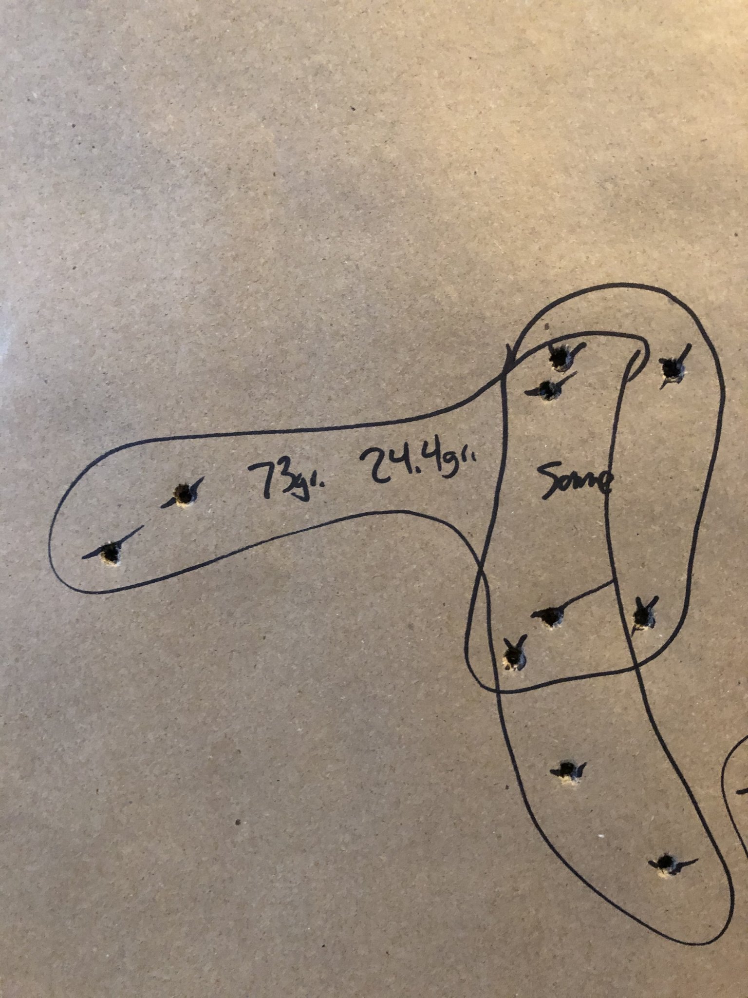

    I ended up sticking with 24.3gr RL15 and that produced roughly MOA 5 shot groups at 400yds. As I do testing I usually do 2, 5shot groups with chrono graph. The whole 10shot group was about 6in, however there was obviously 2 bad fliers to the left. There's also more vertical stringing to the 73gr. ELD-M load, which I was wondering if it could be that i'm not quite in the node of 2740 that I have seen in the rifle. Groups below: The vertical stringing is pretty normal for this load, however the 2 fliers to the left were abnormal. SD for this load across 10 shots was 10, which makes me like the load and think that hte vertical stringing may be more of a node issue.

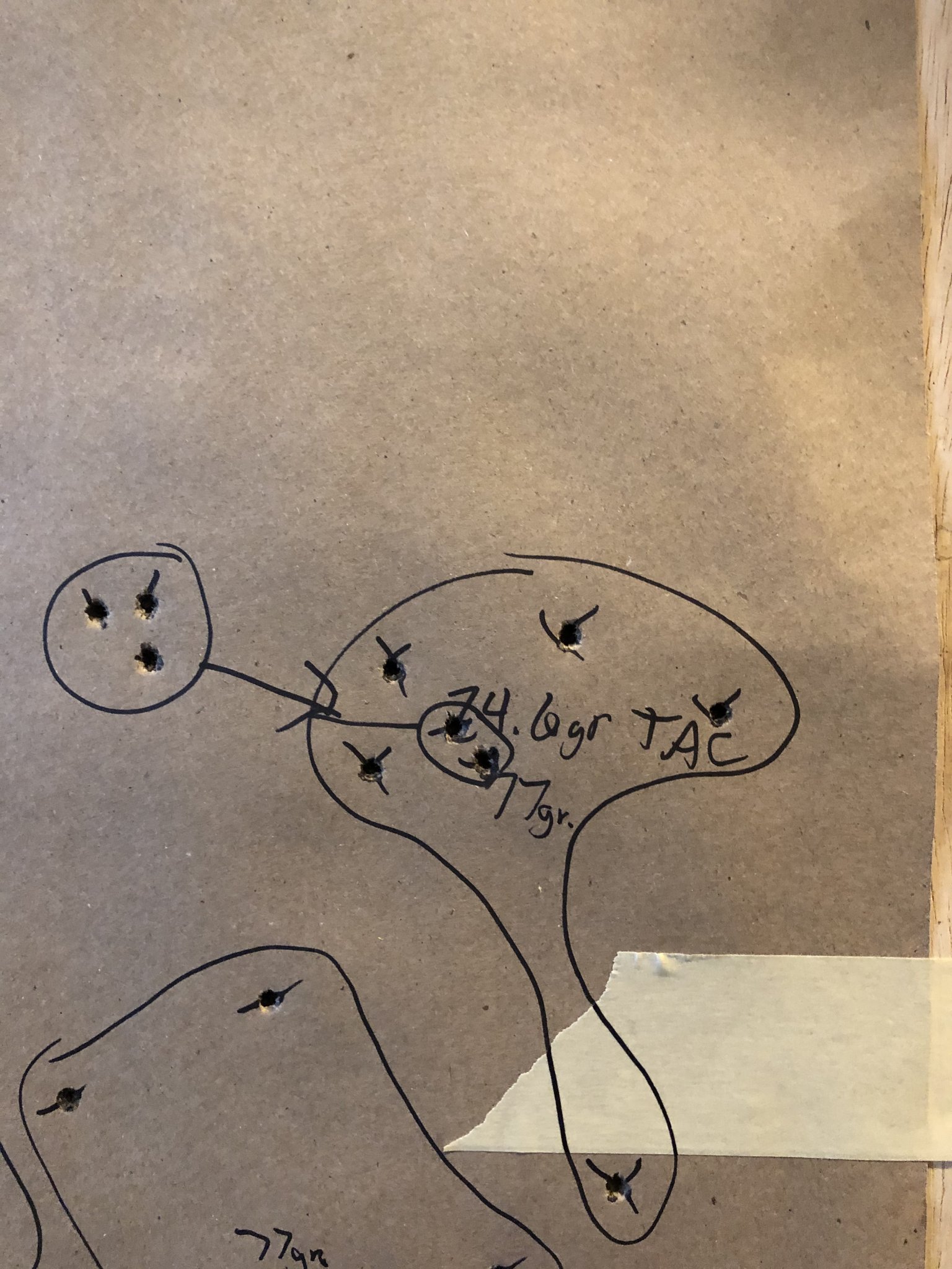

    Now on to the 77gr. TMK. I worked up to 24.6gr TAC which is just under NATO max and my brass shows very mild signs of pressure. Mildly flattened primers, no cratering, and a very slight ejector mark. This load produced very little vertical, and averages 2740fps pretty consistently. This definitely seems like the best load, and at 400yds did the best overall, taking into consideration all variables. SD's for this sit around 10-14.
    The group had 3 little fliers off to the left, which I feel like was a great 3 shot group, and most likely was my cheekweld/position/etc that may have pushed them consistently to the left. The low round round seems like the only real flier.

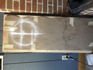

    yes I did have an aiming point, i just zoomed in the photo so it was easier to see. I was also collecting data on drop in Mils at 400yds so I didn’t adjust my turrets. Here’s my overall target.
