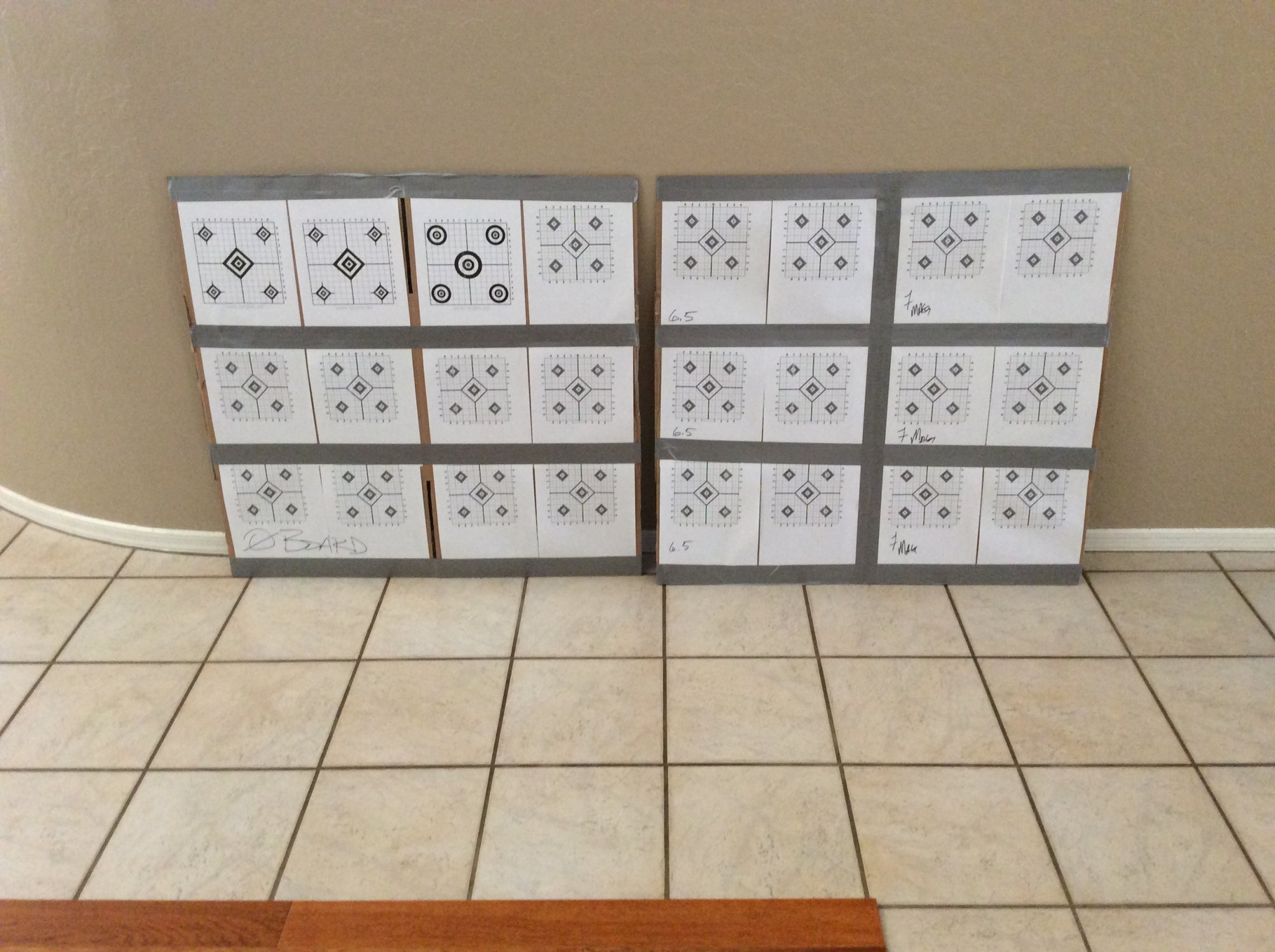

Thank you. I’m a framer by trade and we use story boards. These are mine for fire arms and I’ll incorporate that along with my magneto speed.
Reactions: 1J04
