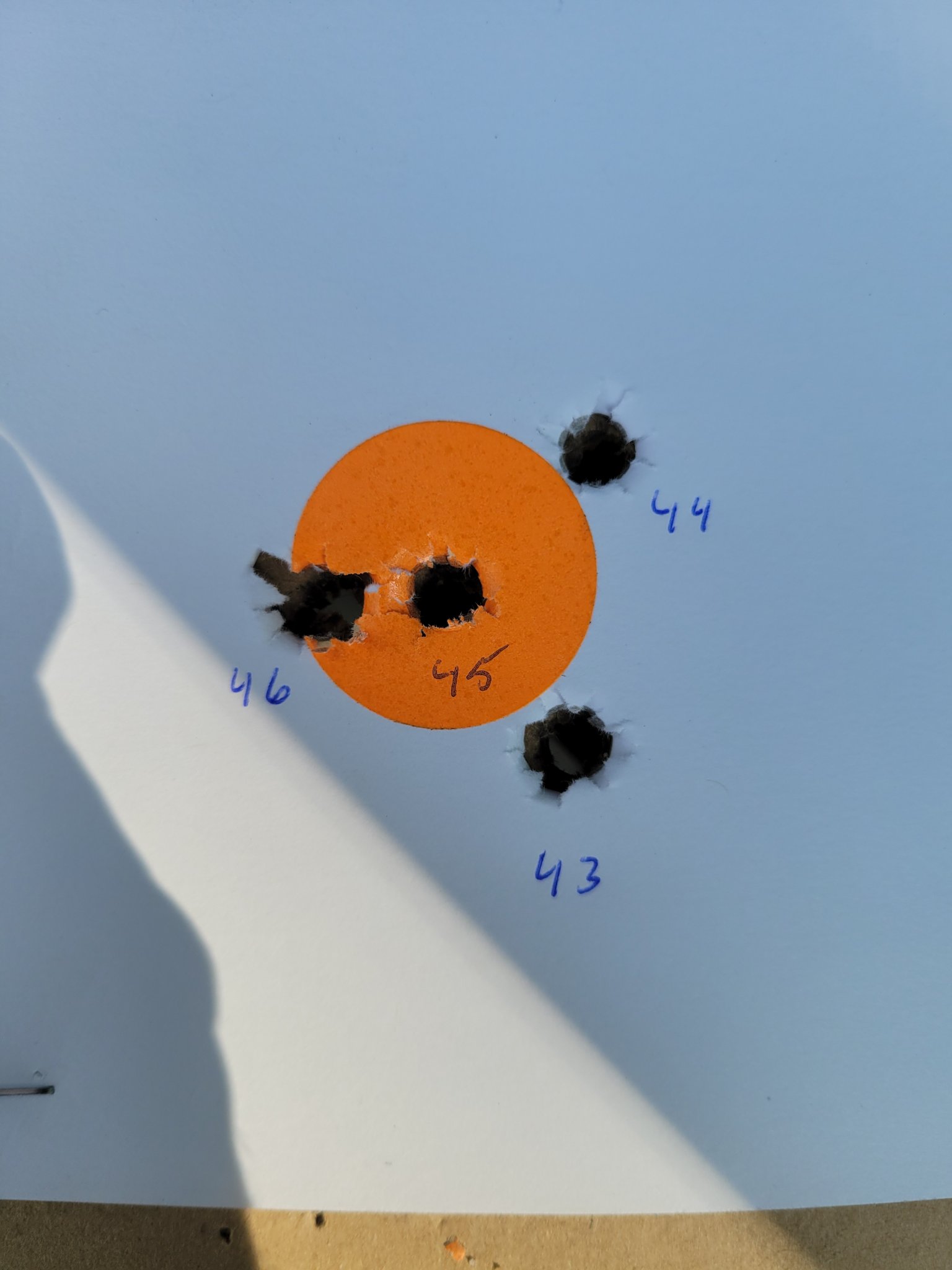

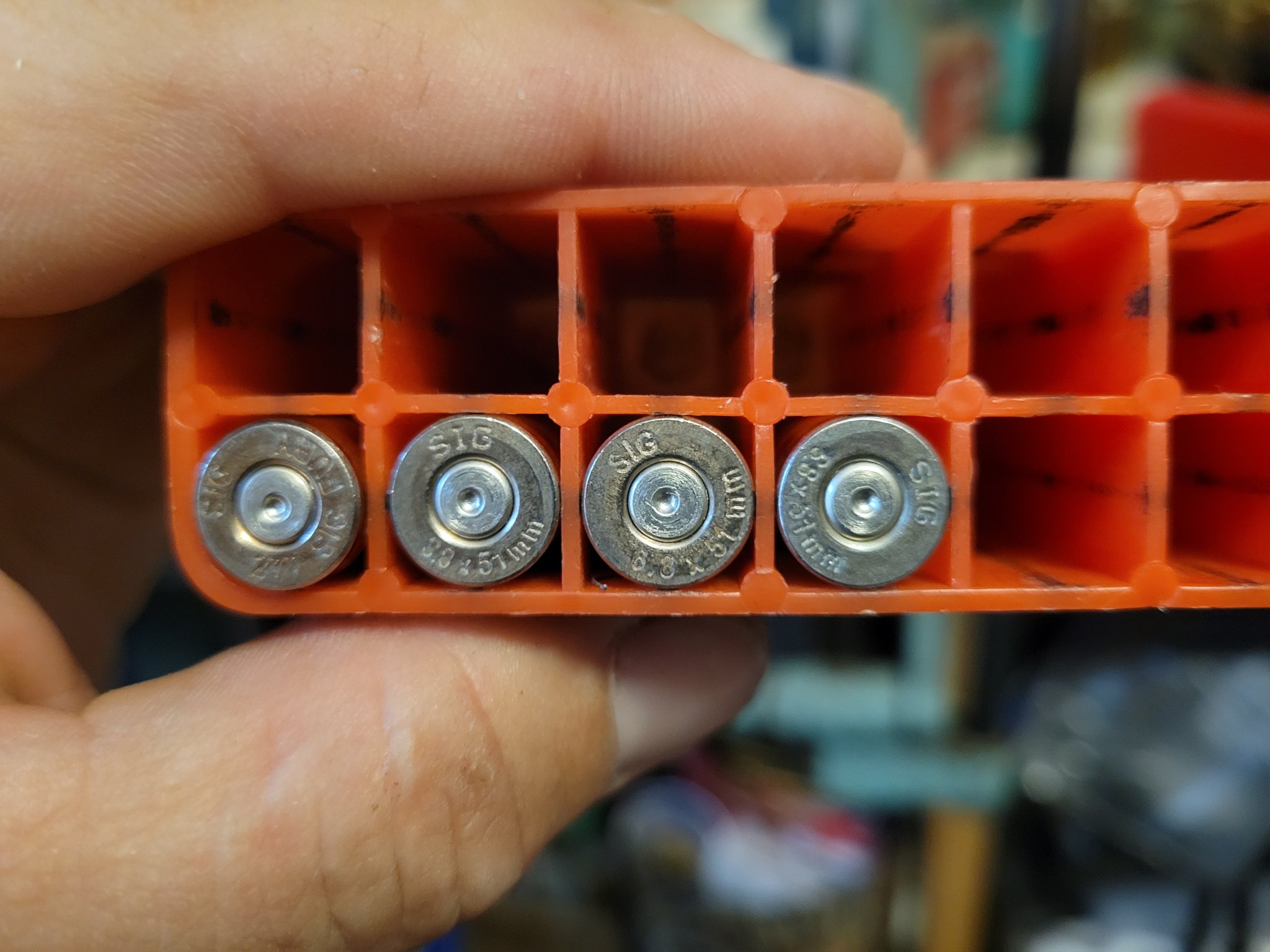

So, using my normal method, I loaded four rounds in 1gr increments,43-46gr, and fired them all at the same target. Just judging by what I saw on paper, and what the chrono showed, I'd choose 45gr and load five to verify. 45gr was the load reccomended by @Chris1972. Had I seen his post before I headed out I'd have just loaded that and shot it. I've got five loaded now but my son has Teeball this evening so, to be continued...
I'll add that 46 showed no pressure and bolt lift wasn't out of the norm. I'll push it a little more. Hornady says max load for this combo is 42.4gr.
Also, I elected to use the primers that came in the cases for the first firing. Primers aren't getting any cheaper, may as well use them to fire form. These are pulled down cases from American reloading.
Here are the results thus far.
