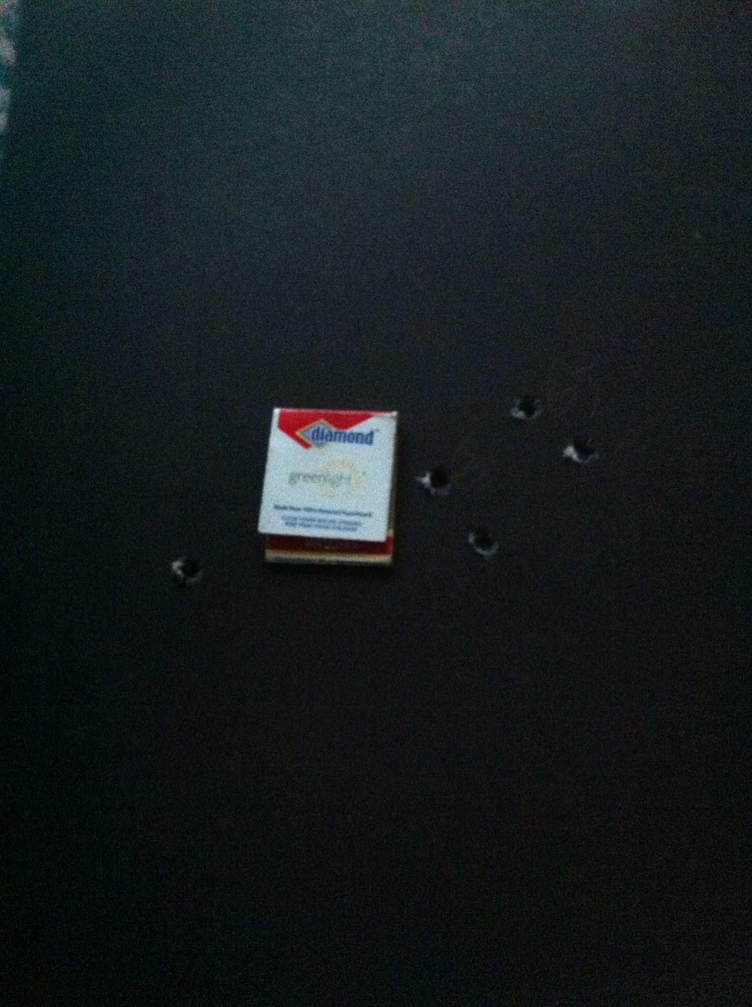

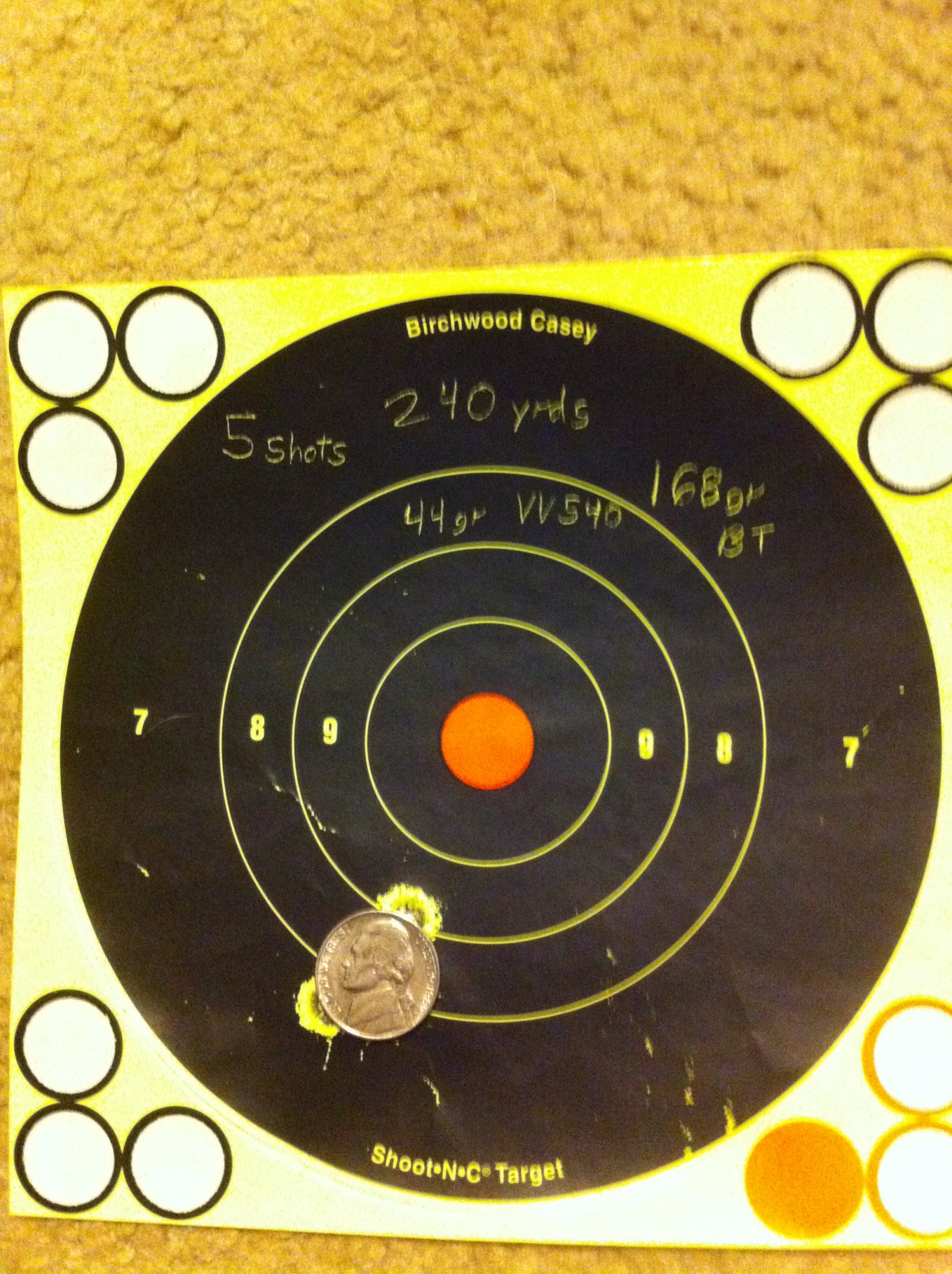

N540, Lapua large rifle primer brass with CCI Benchrest primers worked outstanding for me through a wide variety of temperatures. 44grs N540 (start lower)with Hornady 168 BTHP is my go to for anything 200yrds and up. I used Berger 150 flat base match bullets with H380 to shoot ragged holes at 100yrds(really fun). Varget worked pretty well for 168’s as well. All these groups are the N540/168gr combo. The one with a match book was shot at 400yrds over a windy ravine near Prescott AZ, off a bi-pod and shooting mat. The last 3-shot was so cool I stopped shooting the group.They are pretty much representative of that sweet spot my rifle likes. It’s nothing fancy just a factory Winchester model 70 Stealth with a Timney trigger. I like Wilson dies with bushings and use an arbor press micrometer seater. The charges were just thrown from an older Redding. I did pickup a 21st century priming tool which I feel helps some. Have fun out there, learn a lot then throw a match barrel on later and prepare to be spoiled! Cheers 🍻
Reactions: simonp
