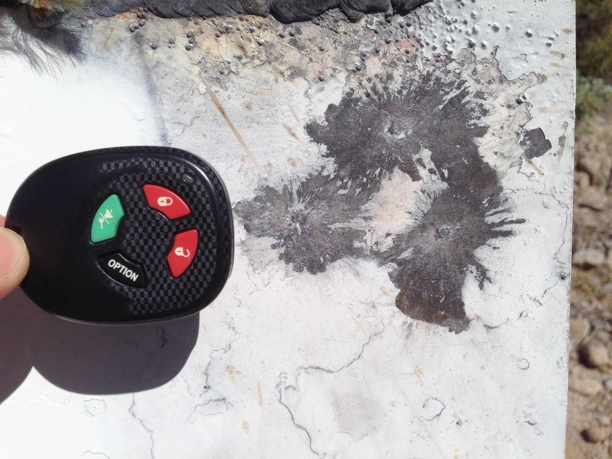

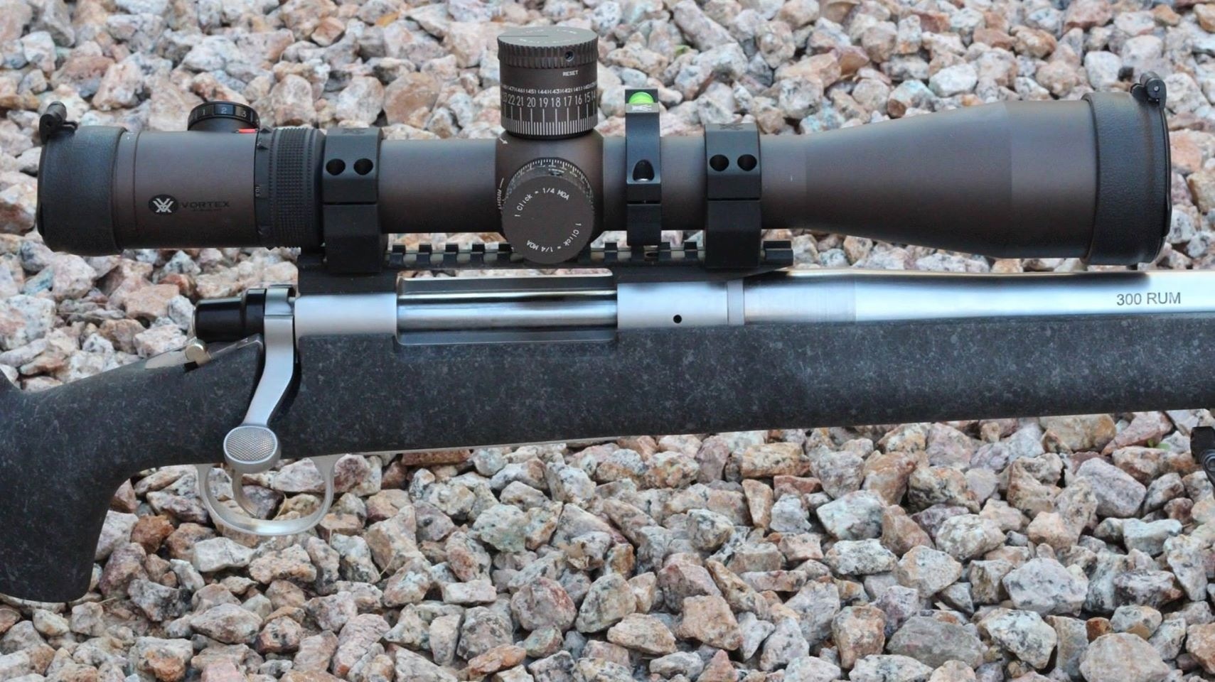

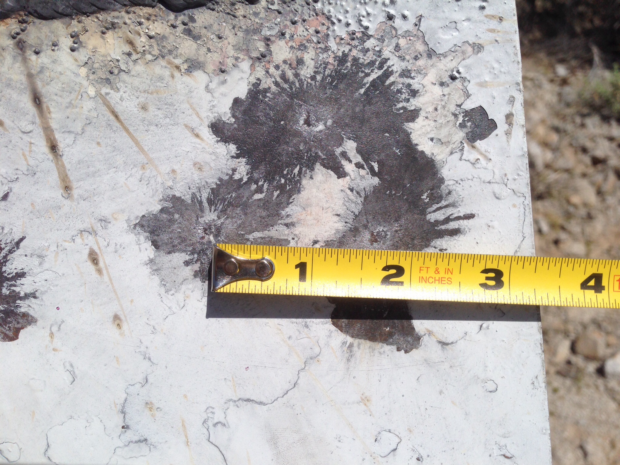

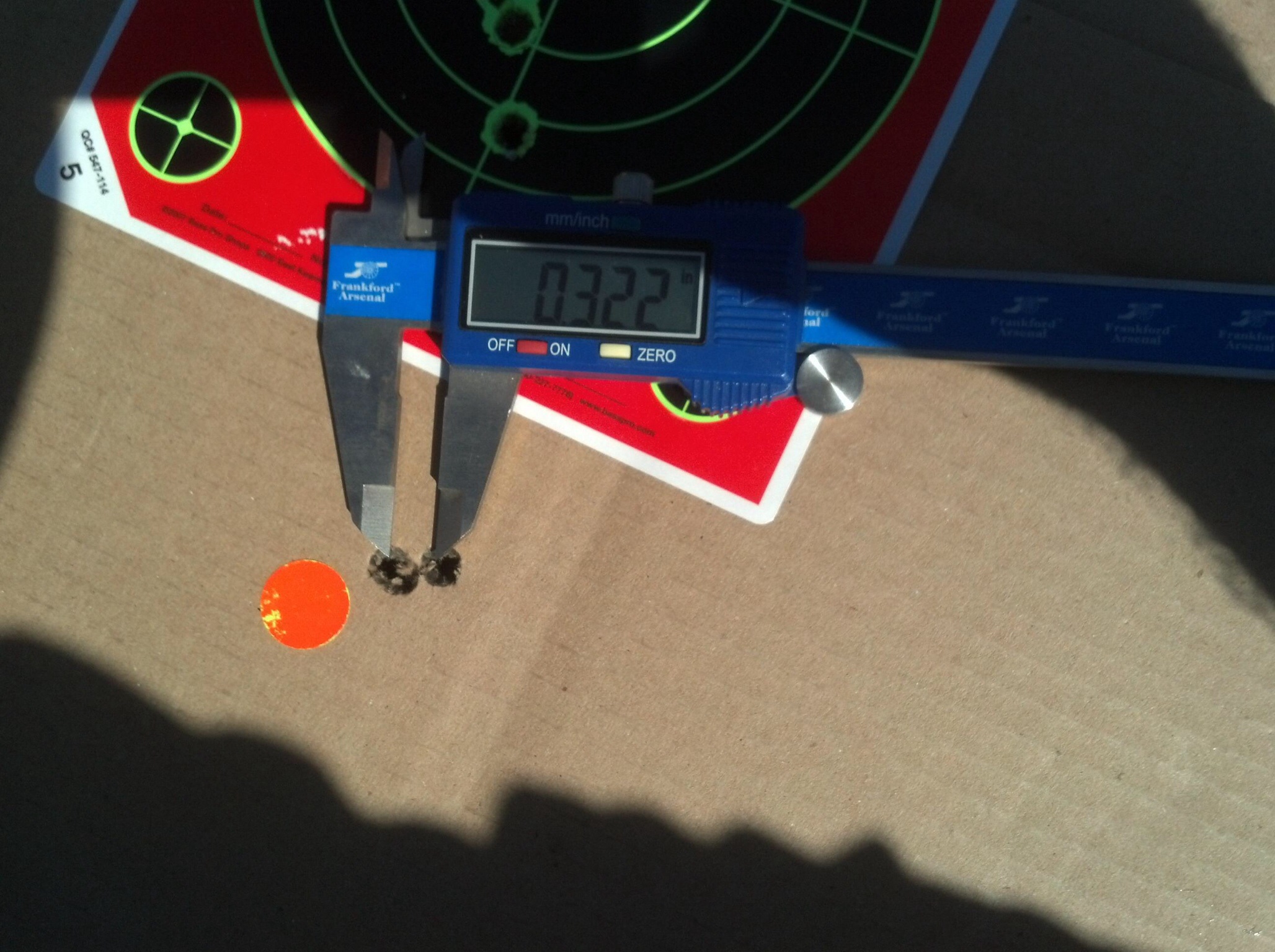

Phoenix Custom Rifles 300 RUM
Krieger 28" Remington Varmint/Sendero contour 1-10 twist
Remington Brass
Berger 230gr Match Hybrid Target
Federal 215
89.4gr Retumbo
3.899" coal
3,049fps
3 shots measured 1.75" @1,000 yards
3 shots measured .322" @ 100 yards
