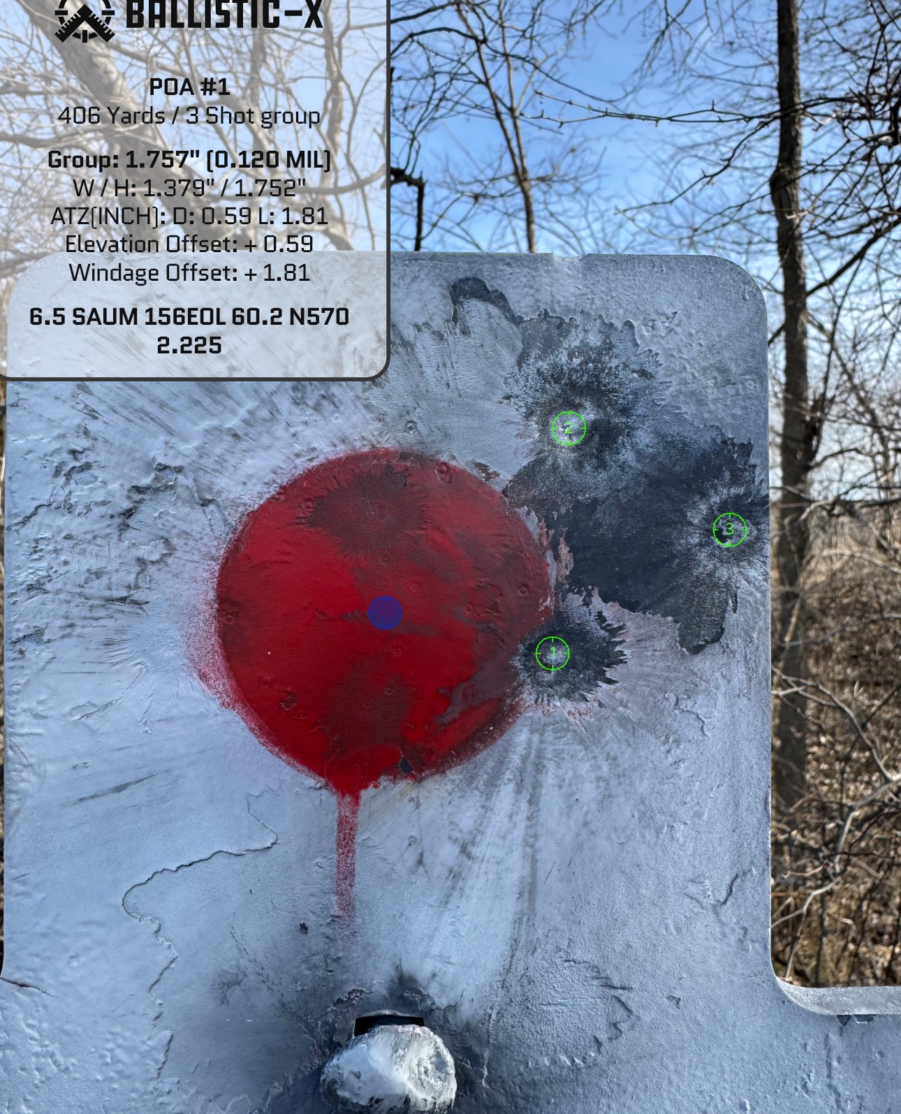

6.5 SAUM medium weight hunter built by Moon at Crescent Customs. Load data:
Bartlien #4 8 twist, 23''
103rds fired
Virgin ADG brass
Fed 210M
60.2gr N570
Berger 156 EOL
BTO: 2.225
2912fps
SD: 8.8
Barrel still needs to settle in a bit and I expect velocity to speed up 40-60fps. Target is the head of a 100% IPSC.
