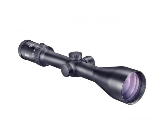

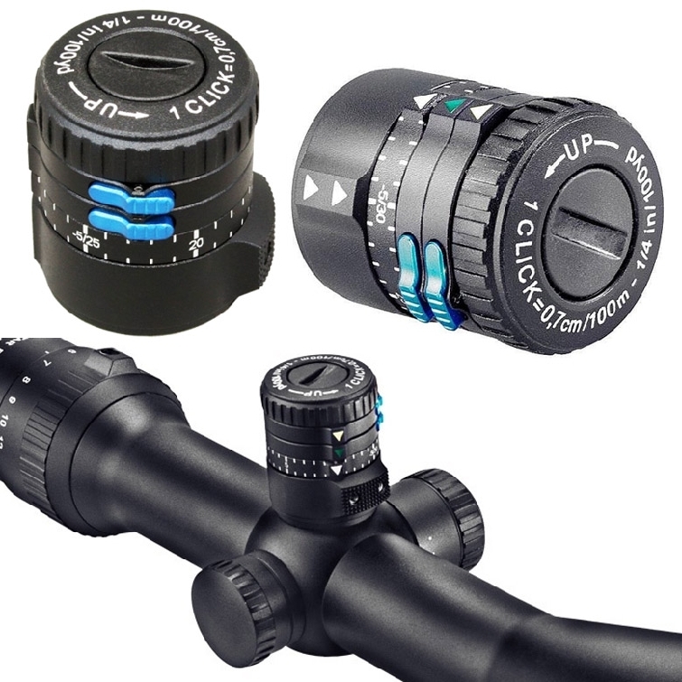

LRHS is one of the best ever hunting precision scopes, if you can find one. Still holding on to mine. It doesn't meet everything you want though.
This however meets dang near all of your criteria, but you will have to buy the top turret separate. I actually have one, without the ballistic turret, but have not hunted with it yet, so I can't speak to that, but I see no reason why it wouldn't excel, especially if you prefer SFP. The Meopta Meostar R2 2.5-15x56RD, the shown BDC3 reticle will get you as close to your perfect scope as you can get I think according to your criteria. And I can definitely say, you will not have a low light problem at all...
7035511
7035512
7035513

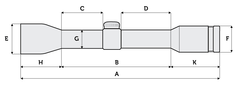

Magnification
2.5 - 15 x
Objective lens
56 mm
Objective Filter Thread
M59x0.75
Main Tube Size
30 mm
Exit Pupil Diameter
11.2 - 3.8 mm
Eye relief (mm / in)
97 - 95 / 3.8 - 3.7
Field of view (m/100m // ft/100yds)
14.9 - 2.5 / 45 - 8
Field of View at
8.5 - 1.42 °
Focal Plane Position
2
Dioptric compensation
-3 / 3 D
Daylight Transmission
94.5 %
Twilight Transmission
92 %
Twilight Factor
11.8 - 29
Impact per click (cm/100m // in/100yds)
0.7 / 0.25
Windage and elevation adjustment range (cm/100m // in/100yds)
175 / 63
Paralax Correction
no y/n
Length (mm / in)
352 / 13.9
Weight (g / oz)
650 / 22.9
A
352 mm
B
157 mm
C
49 mm
D
76 mm
E
62 mm
F
45 mm
H
98 mm
K
97 mm
7035514
And if you dont like the MEOPTA Ballistic turret, there is always these options:

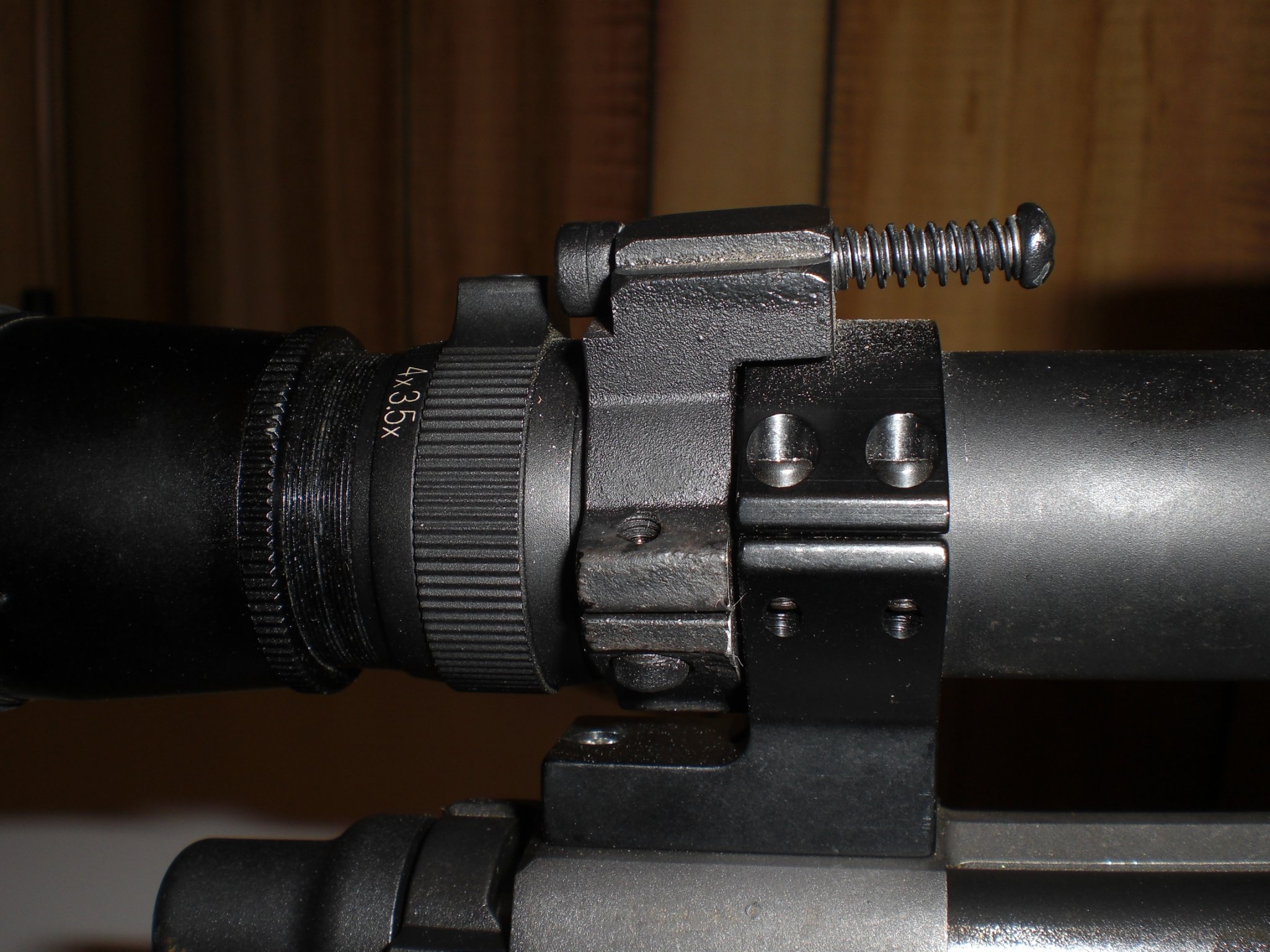

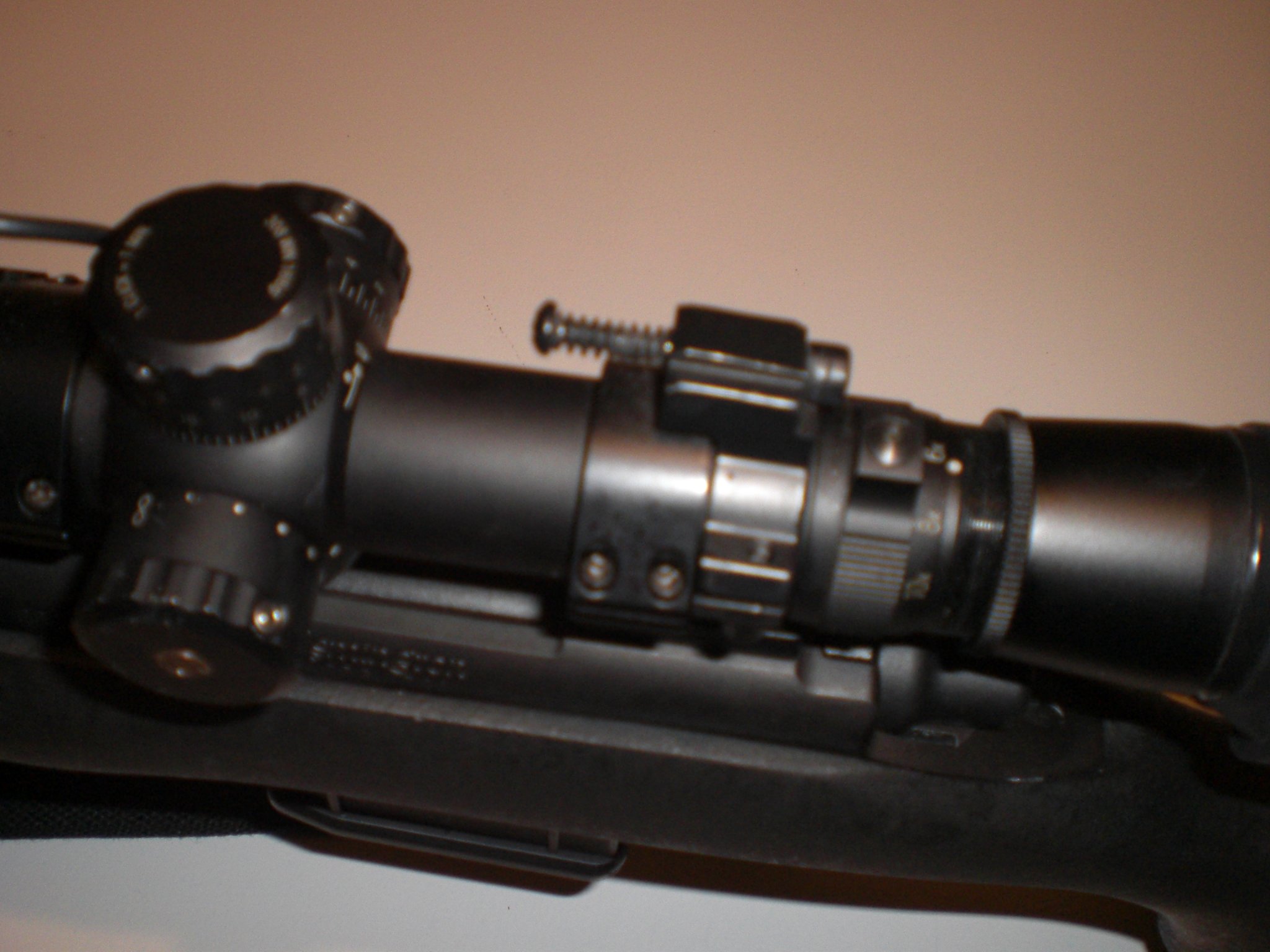

Should be, only work to scale at max power. I know mine at min, an where it doubles (have a double'r stop on all mine) Knowing how to use your gear to the max is job one.
Is the double stop you are talking about built into the scope. I have seen a vortex scope that had a detent at 1/2 power but into thr magnifying ring. Is that what you are referring to?
No, I built mine myself. I've never seen a SFP scope that doubled correctly at 1/2 power most of the time it's, over. An in the case of 3.5x10 Mk 4's it's around 6.1 an the 6.5x20 Mk 4 is around 12.2/3
Each of the Mk 4's I have all very just a little, hence why I built stops, plus I can make them double w/o looking where the ring is with the stops, so as not to lose sight of the target.
