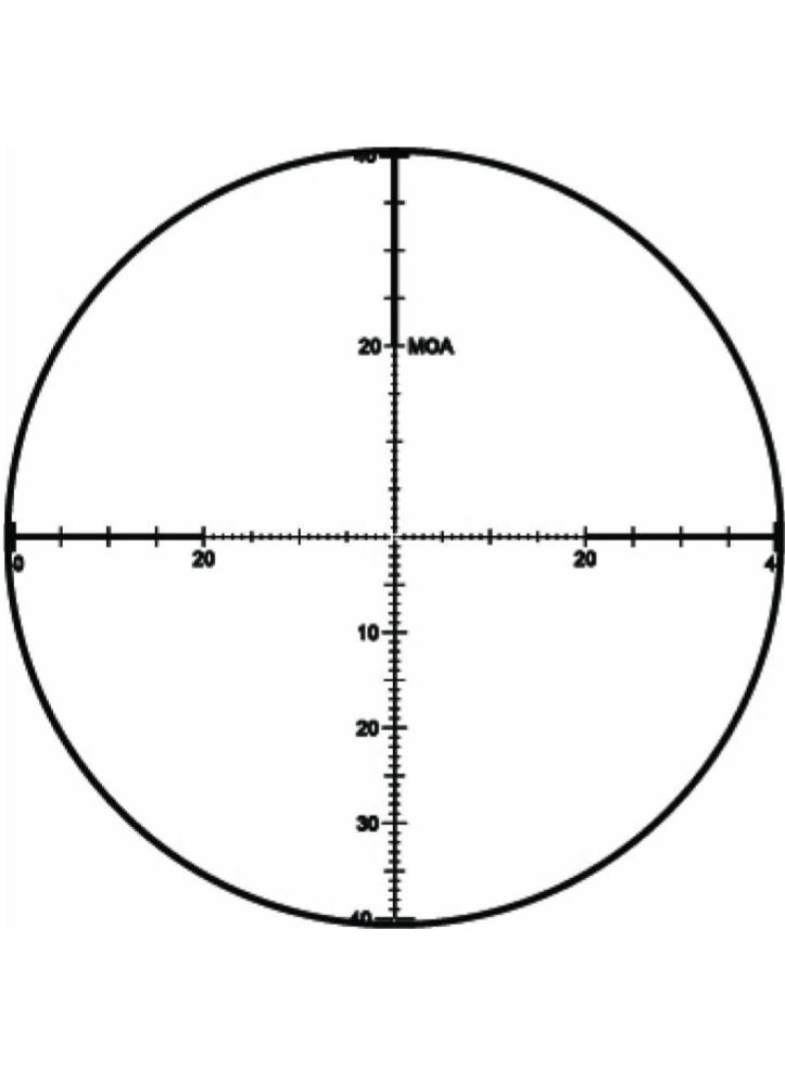

Leupold MK5 3-18x44 with a PR-1MOA Reticle would be one that comes to mind. Doesn’t entirely fit but comes close...
- light weight
-capped windage
-exposed elevation turret
-1 MOA reticle subtensions
-illuminated Reticle
-parallax adjustment
-FFP
-$2k range
-magnification is close but a bit above what he noted

Question for all you TMOA guys. If I zero my gun at 200 yards does that mean I can use each hash mark after as another 100 yards of elevation. So each hash after 200 would be 300 400 500 600 and so on? This works on my NF nxs but I have been having problems just using the reticle on the leupold for holds. I am trying to figure out if my scope is unleveled or if this scope does not work like that. Thanks
You need to know the scope subtensions at the power you are shooting, then you can compare it to your drops.
What reticle do you have in the NXS?
What you're describing is a "bullet drop compensator" type of reticle. That's different than a true MOA/MIL reticle.
I have the MOAR on my 338. When I sighted it in I was able to use the elevation hashes to shoot, each large hash was 100 yards. So Each hash after zero was 50 the large hashes were 100. I ran it out to 500 that day and each shot with each hash was dead on.
That is quite simply dumb luck that the hashes correspond to your come ups if you didn't plan it that way. I have a couple of hunting scopes that will do that. For example I have a 45-70 that every ½ mil is 25 yards from 100 to 200 yards (45-70s fall like a rock) but I loaded it that way. (405s at 1800FPS)
The bullet drop to any distance is a function of MV and BC. If the two don't equal the subtension on your scope per 100 yds then it's not going to work.
