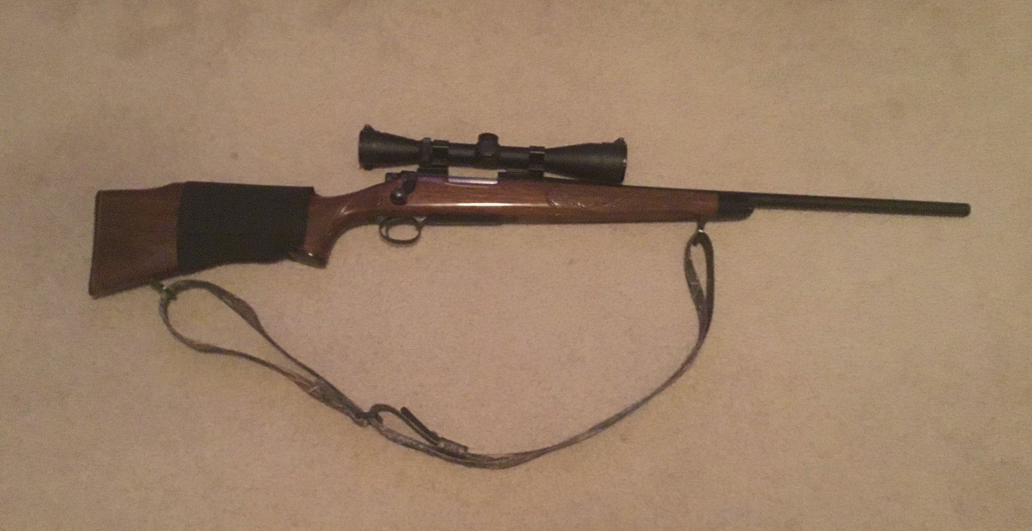

I ran a stock Remington 700 with 20" Varmint barrel and hinged floor plate in a hs preicion stock and a leupold mk4 in DNZ one-piece rings, it tipped the scales at 11.5 pounds.
A m24/m40 contour will at 1.25-1.5 pounds to that and a Razor gen 3 would add another 1.5 pounds.
Hope that helps.

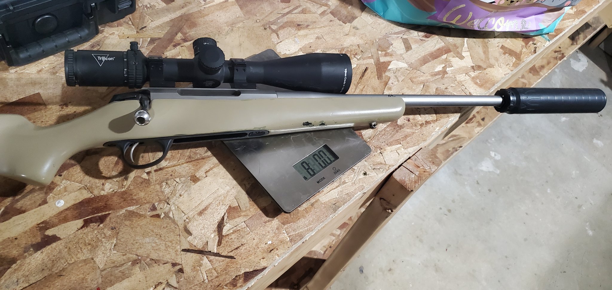

I put the CDG with a 16" CF barrel and an ultra 7 in an HNT-26 with a Mark 5 on it and its almost 12 lbs. You'll be over that with the stuff you listed.

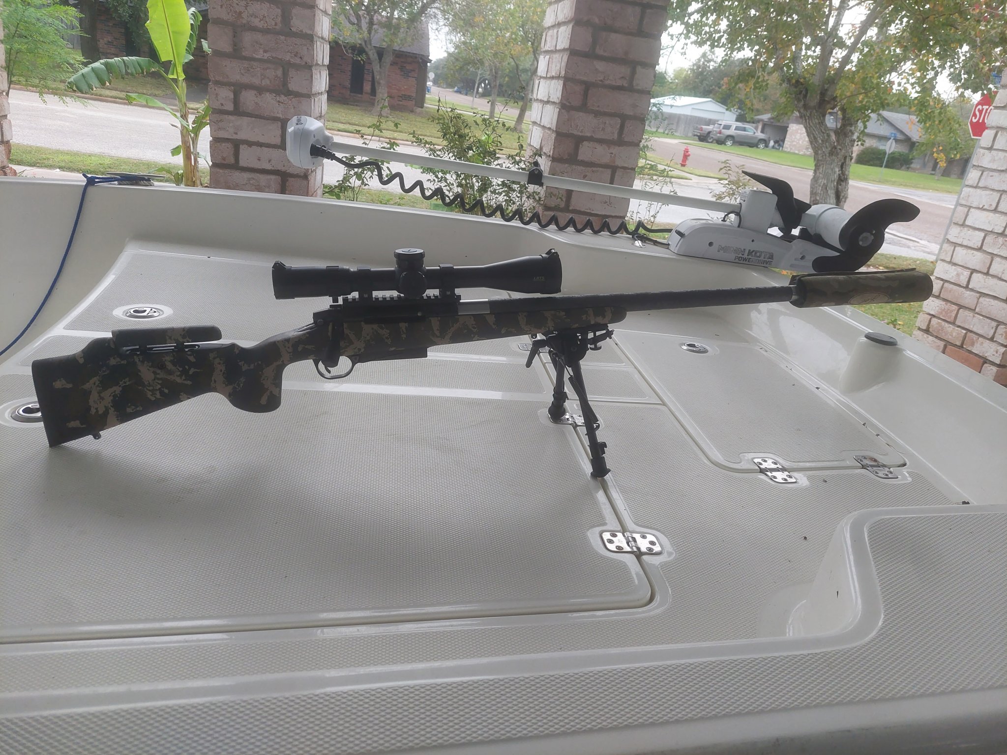

You could probably run a light Palma barrel and be plenty heavy for a 6 Creed and a lot lighter than an M24. Obviously, you can save weight on the scope, but you seem committed there. I love the T2 GAP… but I’d probably skip the adjustments for a hunting build and save that weight as well. A T2 w/ CF shell is like 2.1 lbs on Manners spec sheet.
That won’t make for a light rifle by any stretch, but it will be a lighter rifle. I’ve got a 20” Proof CF 6.5 CM on a Manners CF CS-2 with mini-chassis and ARC Nuc G2 that I like a lot. It’s close to what you’re thinking about.

Ballpark numbers for weight, but should be close.
Gen3 6-36- 45oz
ARC CDG- 34oz
Manners T2A in edge- 53oz
Supressor ?-13oz (my omega 300)
Trigger -2oz
Rings- 6oz (arc m10)
Hawkins hunter BM-3oz
= 156oz or just short of 10lbs before the barrel. I'm sure I forgot something.
For reference my 22" Barlein Carbon in Rem Varmint contour is right at 3lbs as a blank. It'll eventually be a 6cm.

Yeah that's a ridiculous weight for a 7mm hunting rifle!
My wife hunts with a sub 6lb tikka 6.5 saum with a 16" barrel, it's 8lbs with a Nomad LT and Trijicon Credo 4-16.
My 14 YO nephew was smoking plates at 1065 with it yesterday.
My advice is buy a 6lb Tikka T3 6.5 creedmoor and be done with it

My favorite two 6’s are the 6mm Remington and the .240 Weatherby. That said always wanted one of each, never owned either one. We have owned two, .243’s. Brenda’s currently hunting rifle is an ancient Remington 700, in .243. It can, in her hands shoot like a bandit, has an action so smooth that it would make Tikka Owners throw their Tikka’s into the nearest trash dumpster out of jealousy and kills deer as good as anything we own using 100 grain Nosler Partitions.
I beleive that is the key with 6’s. A good bullet. The Nosler Partition has been as good as anything we have ever used for harvesting game.
In the 1960’s and early to mid 1970’s, Remington could really make some nice rifles.

Well, your scope choice adds a ton of weight.
I just built a 7-08 AI on a medium action with a mullerworks carbon fiber wrapped 22" barrel. It sits in a pure precision carbon fiber stock. With my 4.5-18 lrtsi and bipod it weighs right around 11 pounds.
