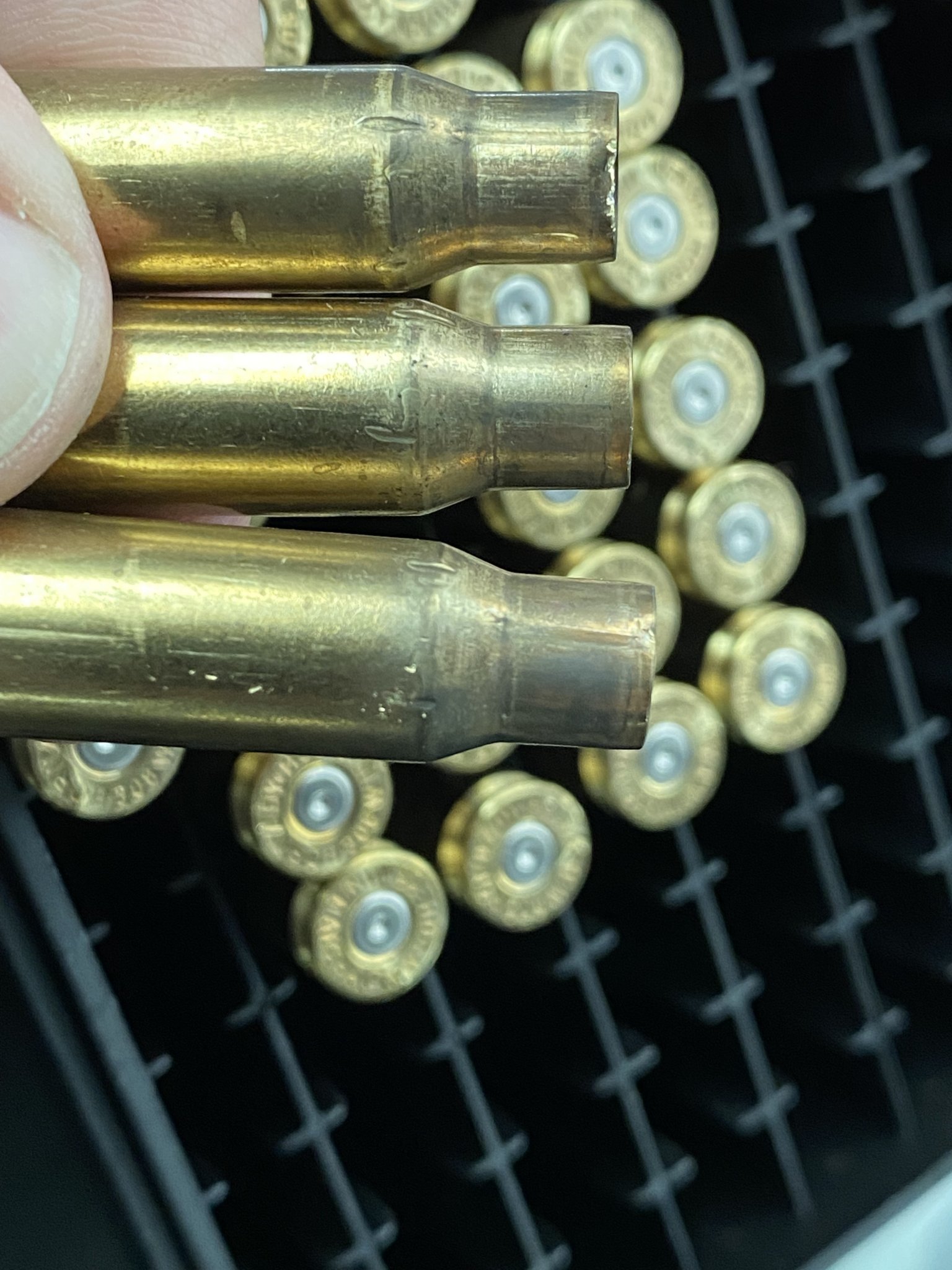

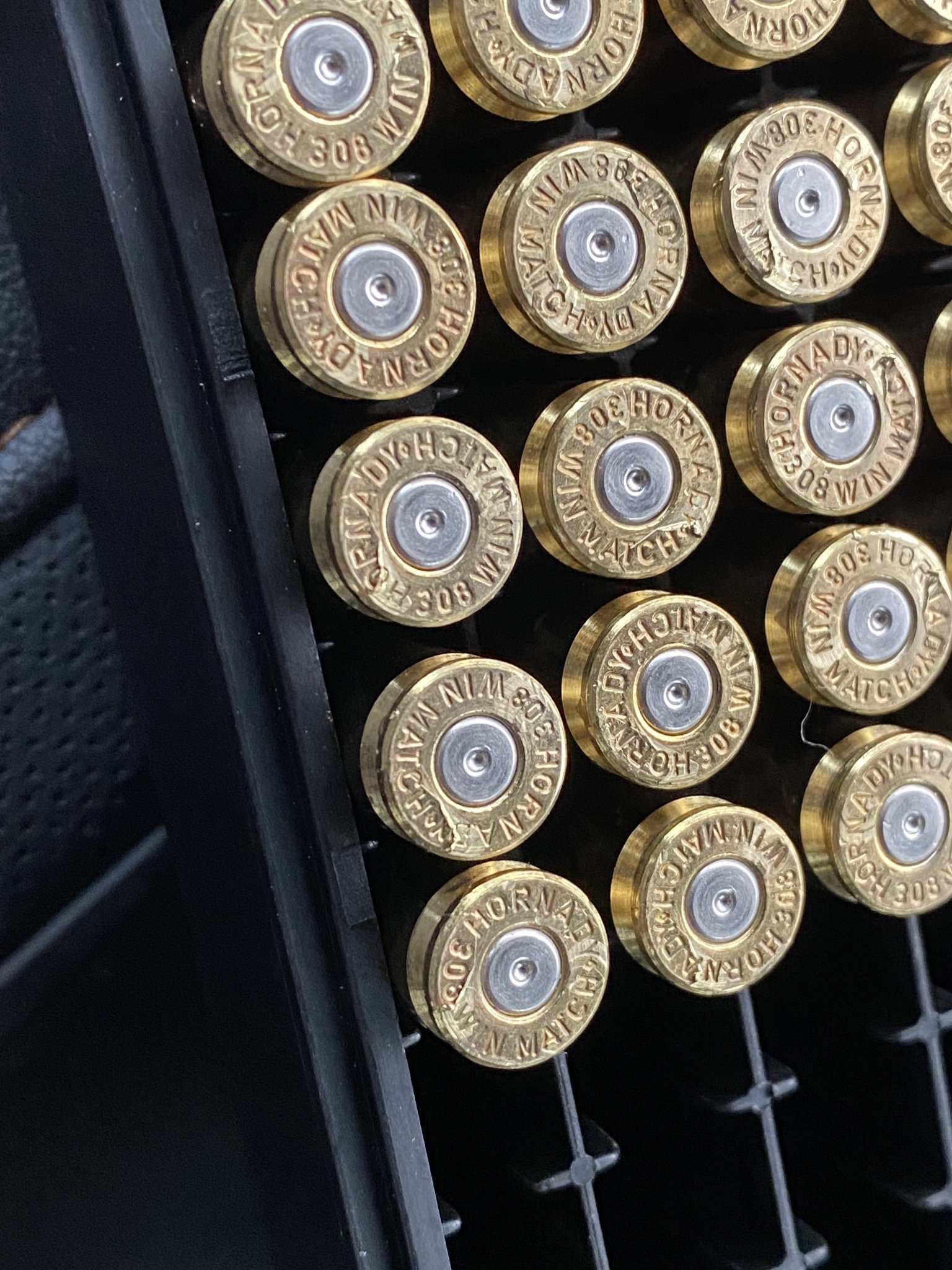

@bfoosh006 I've tried on a bench sitting the gun on bags without loading the stock / bipod with rear bag / loading the bipod consistently / not loading it - as well as prone with the same. taken it apart multiple times. went to clean the brass to anneal it and noticed weird marks on the brass. my dealer sent pics to POF and they want me to send the rifle to them. we'll see what they say.

FWIW... I wouldn't consider those brass case markings terribly weird. Honestly I have seen FAR worse.
Large Frame AR's beat up cases... the first photo looks like extractor or ejector smear. The second photo looks like the cases are hitting a RE lug.. either on feeding or ejection.
