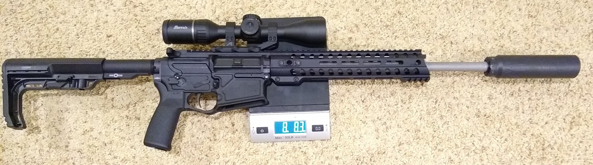

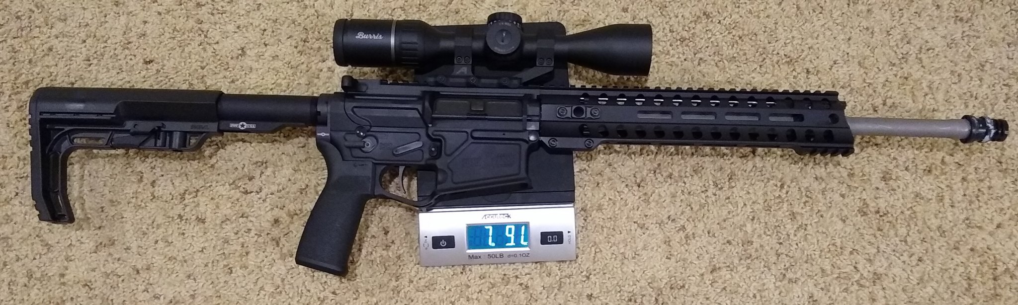

I’m betting actual weight of his rifle is well over 8+ lb. 5.9 lb might be accurate for the stripped rifle, but add the scope and mount, and a mag, and that can easily be another 2+ lb, so in the same realm as a lot of hunting rifles. No real point to make here other than just perspective.

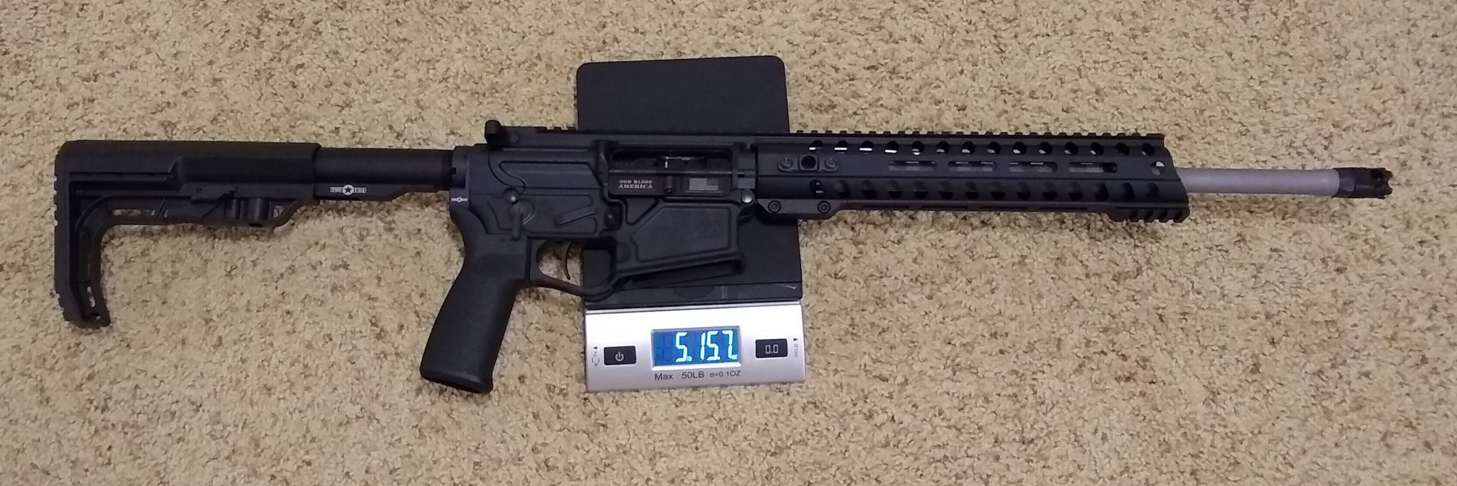

You can add various amounts of weight to any setup, but it's a difference without a distinction in this context. The Rogue is way lighter than pretty much any other .308 AR comparing both dressed or both naked, and it does buck and twist a little as the man suggests.

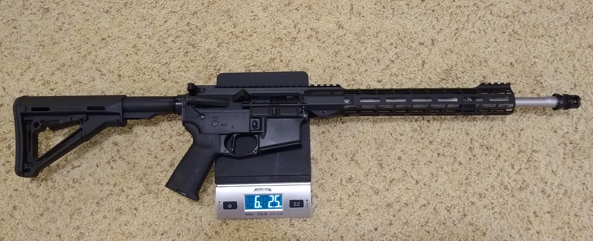

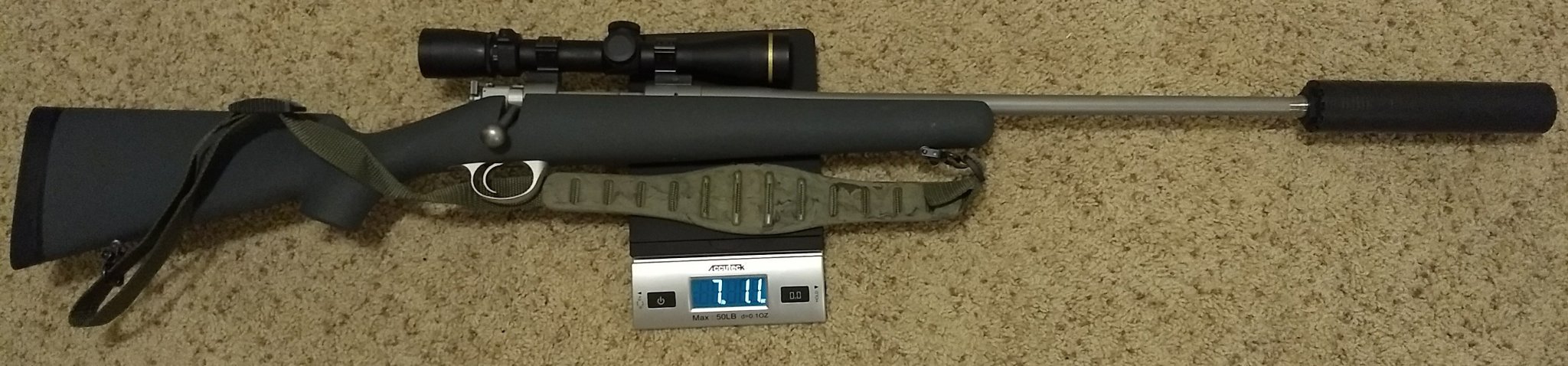

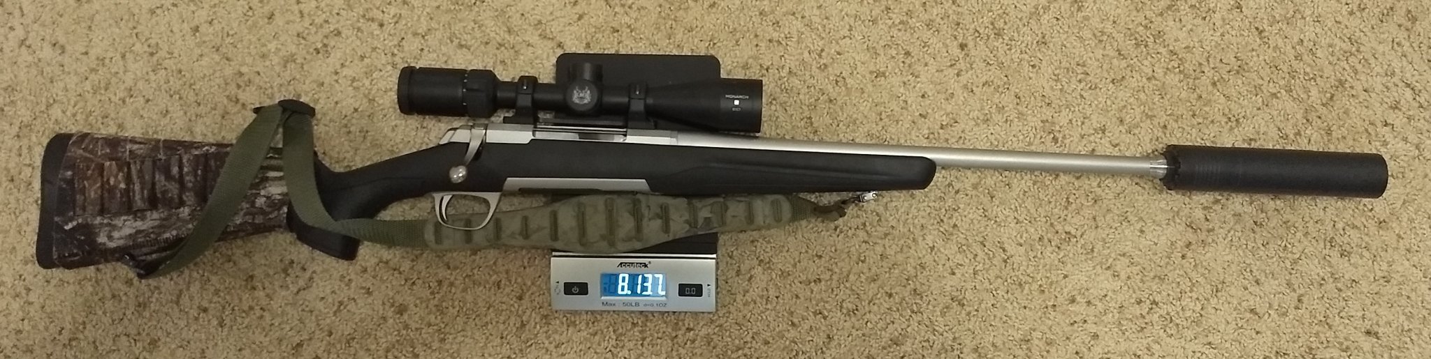

So you’re demonstrating that I’m right, but arguing that I’m wrong or it doesn’t matter? Sounds about right. 🙄
Where it matters is perspective- it weighs right about the same as a lot of 308 bolt action hunting rifles. I’ve had mine about that same ~8 lb weight too, and it doesn’t kick that bad, in fact it’s milder than a similar weight RAR if you don’t have a heavy AR10 bolt carrier in it.
Funny how it’s the complete weight of the rifle as it’ll fired that is more relevant than a stripped down weight…
No need to bust out the Emojis, I was just agreeing with you that there was "no real point to make" on your distinction. I think everyone would reasonably assume that 5.9lb is the naked advertised weight, and that most ready to shoot configurations would be some amount heavier.
That doesn't change the fact that there are only a handful of factory .308s on the market that will match the Rogue on it's 5.9lb naked weight (Kimber makes most of the options that aren't $2k), and it is without a doubt, an ultralight anomaly in the field of .308 ARs. To pretend that it's basically just like most hunting rifles (especially on this site) is a little ridiculous.
I didn't say it "kicked" a lot, but a significant portion of it's total weight jumps around with each trigger pull, and I noticed the twist shooting mine. Have you shot one before?
In the spirit of numbers over hand waiving, all of my favorite hunting rifles are advertised as lightweights, but only the Kimber is noticeably lighter than my Rogue was.

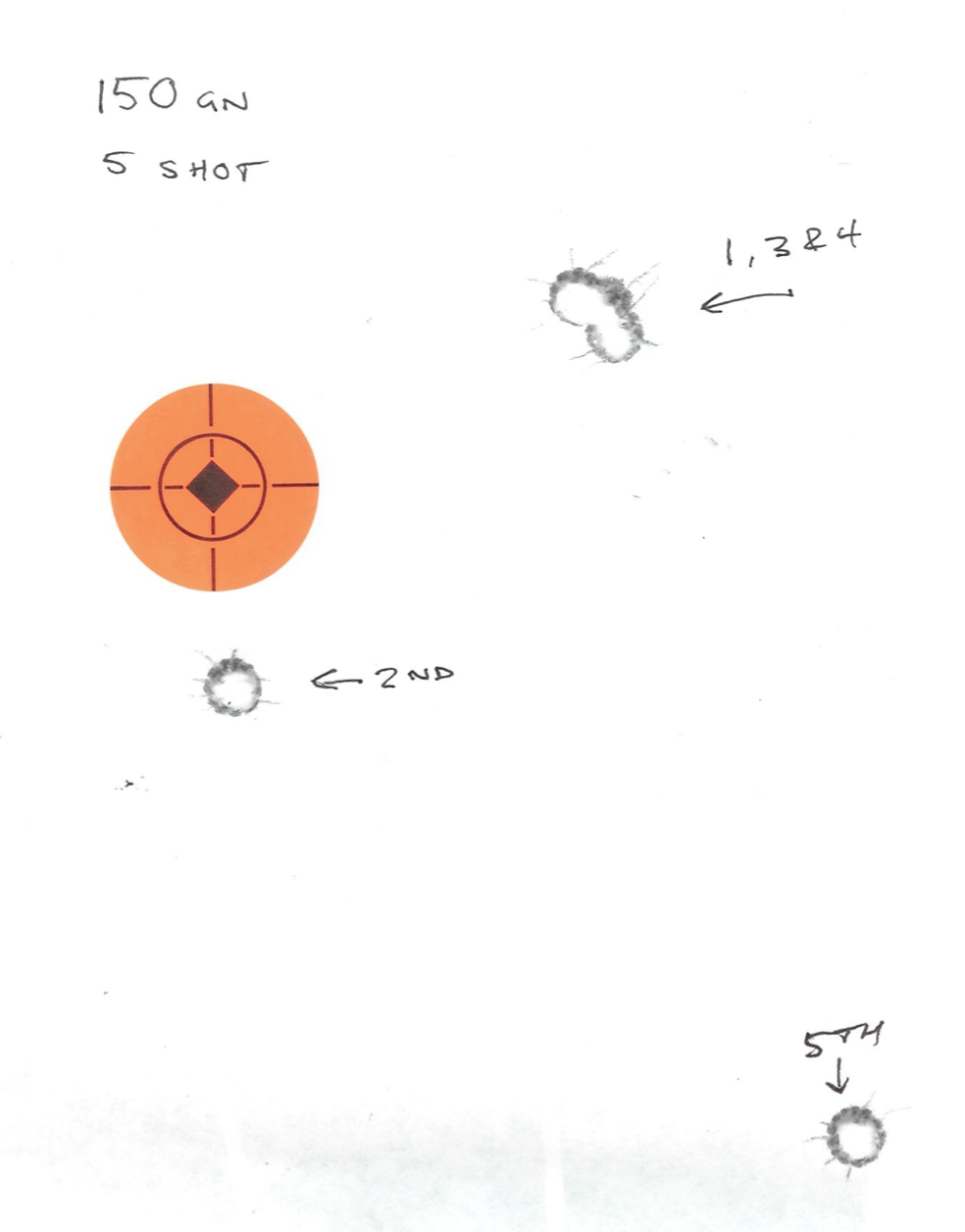

Regardless, 4" groups should not be the norm, if the OP is confident in his light rifle technique, the scope checks out, nothing is loose and a decent factory ammo doesn't change things, I'd certainly send the rifle back for repair.

Long story short, I have a POF Rogue AR 16.5" in 308 - can't seem to get it to group within 4moa with my go to round, 175smk (factory ammo). So I hand loaded some and took my lee hand press to try different seat depths.. tried 10 depths at .005" increments and couldn't get 2 bullets within 2" of each other.
Called POF and they blamed my "too hot" ammo - I never said how hot they were, actually had a lower velocity "accuracy" load per Sierra load data. So I asked what ammo they recommended and the customer service rep emailed me a list, which included the very ammo I was shooting. He also suggested I buy an adjustable gas block - if the gun needs one to be accurate, why wouldn't it come with one?
Went yesterday at lunch to try some lighter ammo with result below. I thought the barrel was just bad until I shot the 150gn and had 3 in the same hole.
After suggesting I didn't know how to shoot a semi-auto and they were different than bolt guns, he suggested the ONE cartridge to hang my hat on with this rifle is the Federal Gold Medal Match 168gr SMK... I started to order a box, but I really have no interest in owning a gun that will only shoot better than 3 or 4 MOA with ONE ammo flavor.

Looking at the target the OP posted he notes that it was the 2nd and 5th rounds that were flyers. He didn't put three in one hole and then have things go to crap.
I'm thinking it is a shooter issue more so than the gun.
Could be the shooter for sure but when I had my wandering zero issue with my scope it was really similar. I could drill 3 bullets in a cloverleaf and then the next one would barely be on paper and then next one would be back to the group. Drove me absolutely crazy thinking it was my trigger pull, the muzzle device, action screws, my load, my scale drifting, my rail, etc. Just ended up being the scope which I was stupid not to check first by swapping with my trustworthy Cronus.
Any ideas??

I wouldn’t trust that optic to hold together internally on a 5.9lb .308 gasser.
That group could very well be indicative of gear slip in the turrets from recoil and secondary reciprocating mass effects slamming into the breech and barrel extension.
A 5.9lb .308 gasser needs a really tough optic built with epoxied optical lenses and optical modules permanently fixed in place, with some of the best turret metallurgy the industry has to offer.
It should have something like Razor or NightForce-level durability on top of it, not Chyna Eagle price point optics meant to sell at volume.
Change that and see what happens. See how tight rounds 1,3,4 were?
Also, 1/8 twist is ideal for a 16.5” .308 Win. MV will be slower, so to stabilize 175s, tighter twist makes sense. Todd Hodnett did a lot of testing with that using 1/9 in 16” gassers taking them way out with 175gr SMK. You aren’t going to hurt the bullets at 16” .308 speed, even shooting 135gr Hollow Points as fast as possible.
There might be something in this post,
I was getting shitty groups in my MWS on day and when i got home found out the mount was loose. not sure how what happened there but it solved the issue. I would check the mount and optic to see if everything is solid and if so, maybe pull one of your optics thats on your bolt guns to see if you can narrow down the issue.
While the 1:8 seems a little odd, I don't think its should be trowing shots almost a half a foot at 100 yard.
