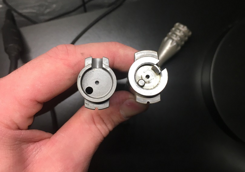

Just got the .590 bolt body in from Surgeon and I'm glad I went the route I did. Completely different geometry for the extractor on the mag bolt vs. standard. Not sure if the extractor placement on the new bolt is a revision (original bolt/action is a Prague OK action, 007XX serial #), or if that design is specific to just the .590 bolts.
Either way, the picture illustrates how far out the original extractor would have to be to interface with the case rim on a .590 case. The .473 extractor is maxed out before it even gets to the outside edge of the bolt body. Would probably be a lot more spendy operation than a new bolt, if it's even possible.
Now that you have a .590 bolt, I vote for a 300 NM improved or 338 LM AI.
33 or 37XC!
The plan in my head thus far is .300 Norma. Wanted to stick with .30 cal as my Ultra 7 I bought on a group buy at shot show FINALLY got form 3'd to my dealer this week (10 months later...). Once that tax stamp comes back I was planning on using that on as many guns as I could for the time being.
Might have to look into .300 NM AI though, that sounds like fun.
