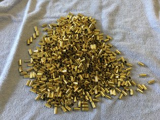

I ran 900 9mm cases through mine on Saturday. I thought it may be too heavy, but it ran no problem. It just kept on going
imagejpeg
