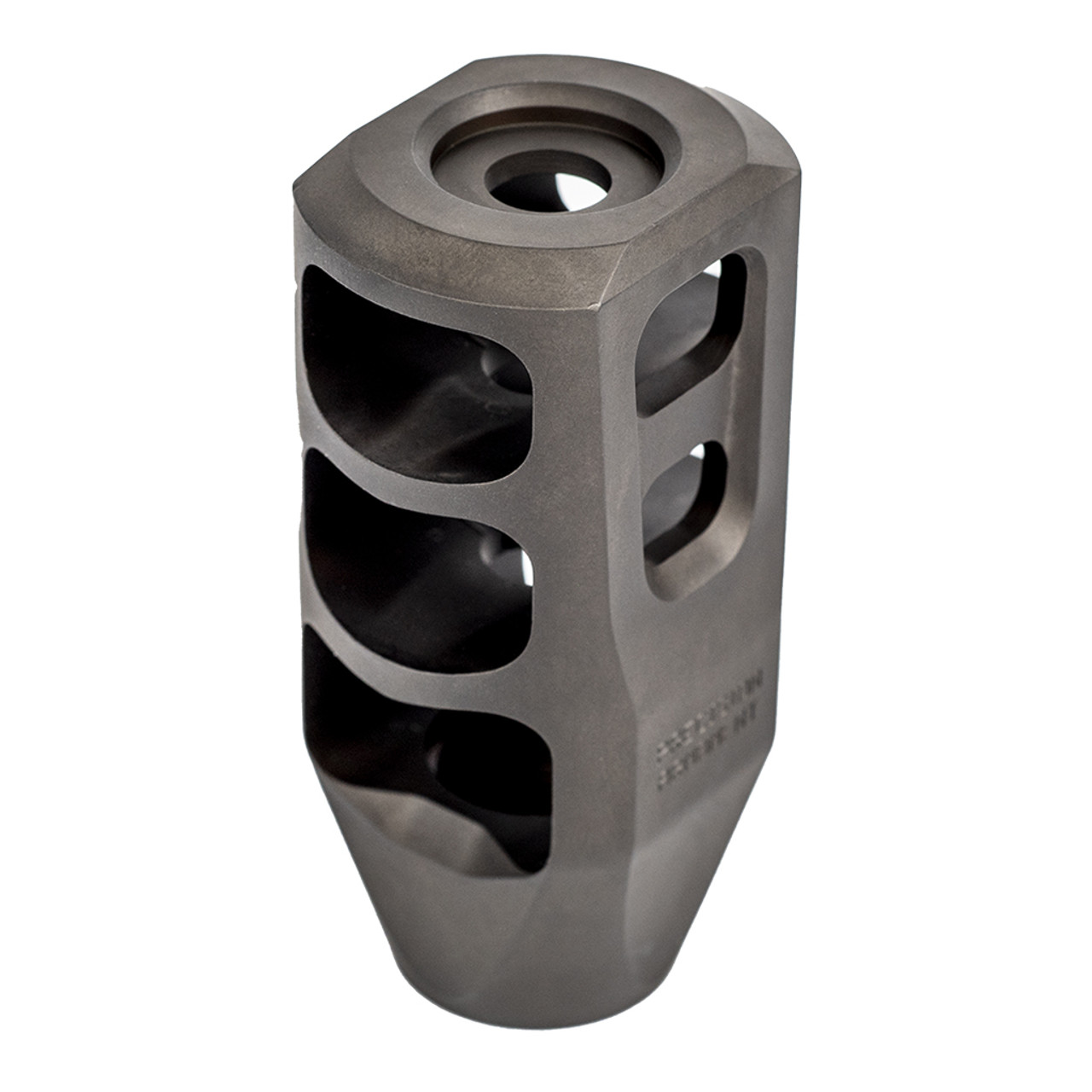

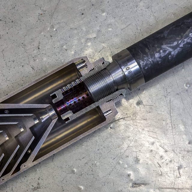

Can someone explain to ME ,exactly how a can works on a muzzle brake or flash suppressor ?. Gases take the path of least resistance o_O
The can threads over a dedicated muzzle device to create a seal that forces the gasses through the supressor. Some cans can utilize an A2 flash hider similarly. Otherwise, the can direct threads onto the muzzle threads.
Reactions: Ex E6
I'm only familiar with cans which direct thread onto a barrels muzzle ,which stuffs gases via ports washers aka baffles .
Wasn't aware any actually covered over a brake or flash suppressor ,as I assumed those had to be removed prior to installing a can/suppressor .

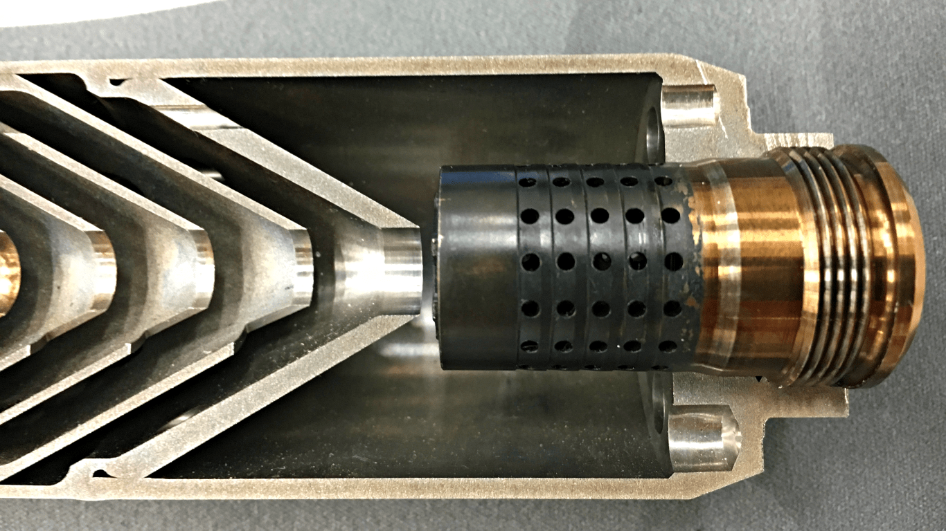

Um, I’m unaware of any modern suppressors that do not use some sort of baffle to slow and cool the exiting gasses. (Even wipes are baffles of a sort.) In the image below, you can see the acme threads on both the suppressor and the muzzle device. There is also a taper in front of the threads that seals them from the gasses. The second image shows the side of the can, and you can clearly see weld lines in this tubeless design. Each weld is due to the presence of a baffle at that location.

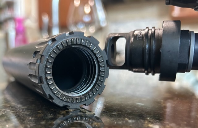

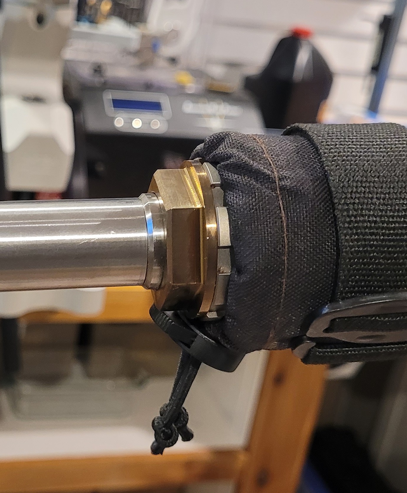

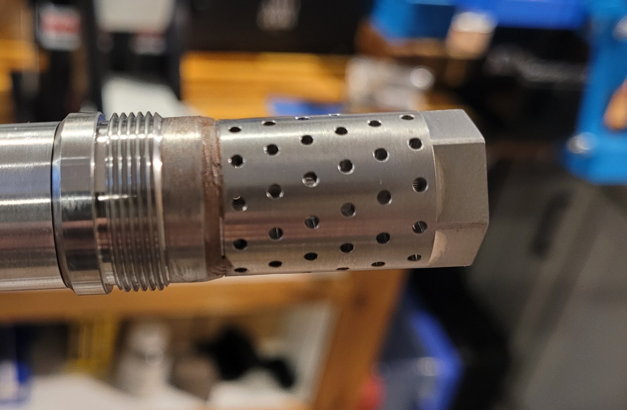

I had these on my phone. These are all titanium. The brake is on the barrel, and the mount (which you install into your can) then screws onto the brake with a different thread so it's easier to remove. It also has a taper to block the games and stuff from locking up the threads.

Both are of Q cans which I will never buy anything from them but it shows how it works.
Yeah fully aware of how they work and that illustrates MY perspective perfectly ; Threading onto the barrel ,regardless of thread as adapters are available .
What I was confused about was how they would work attached to a Brake or Compensator ??. Gases would simply blow out compensator ,rather than drive through the can's baffle system . Having read the 1 St. posting **,I assumed I was missing a new device .
