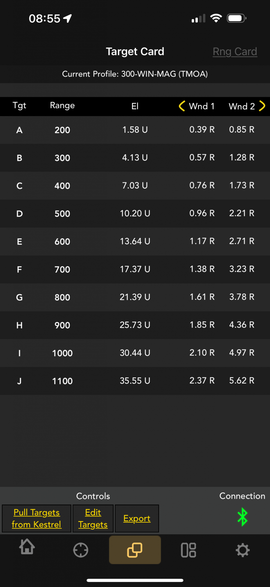

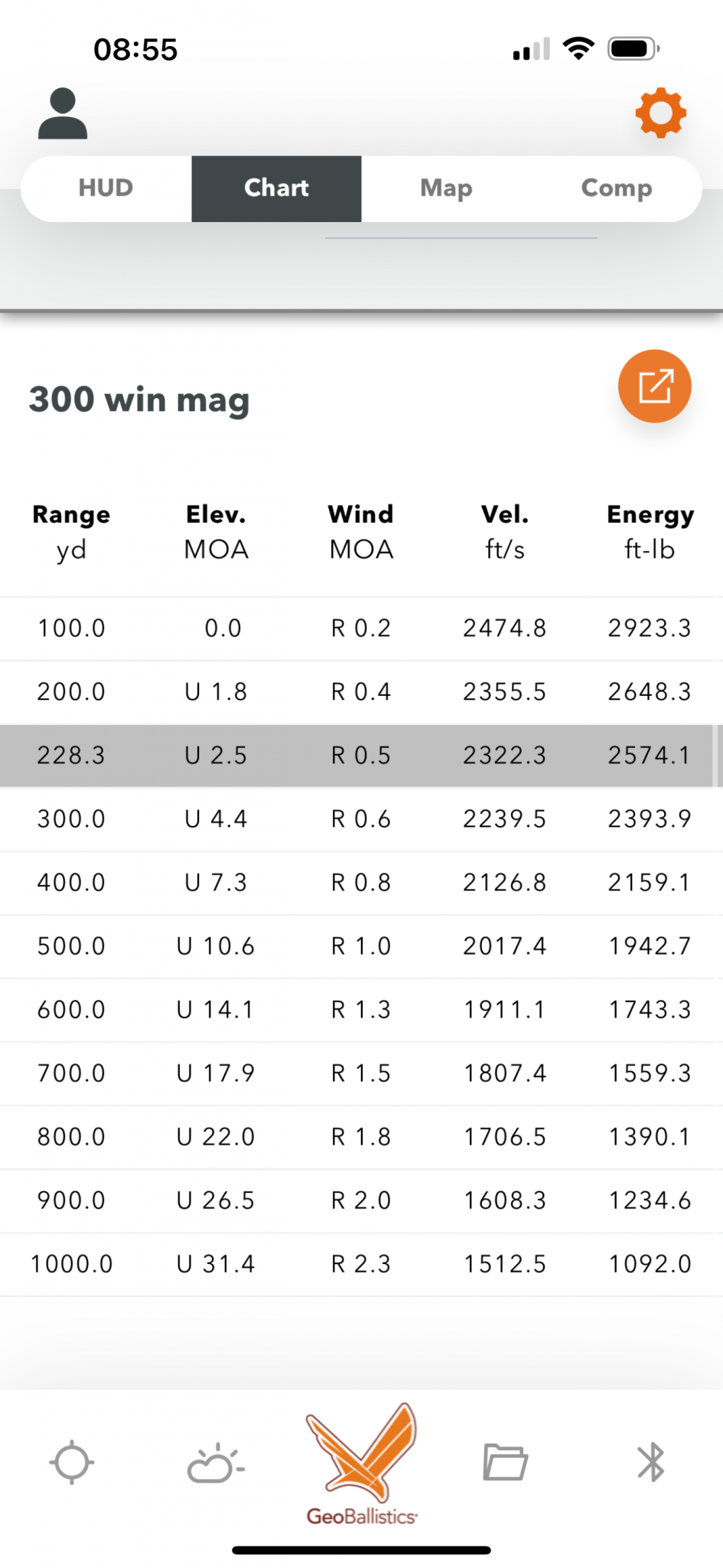

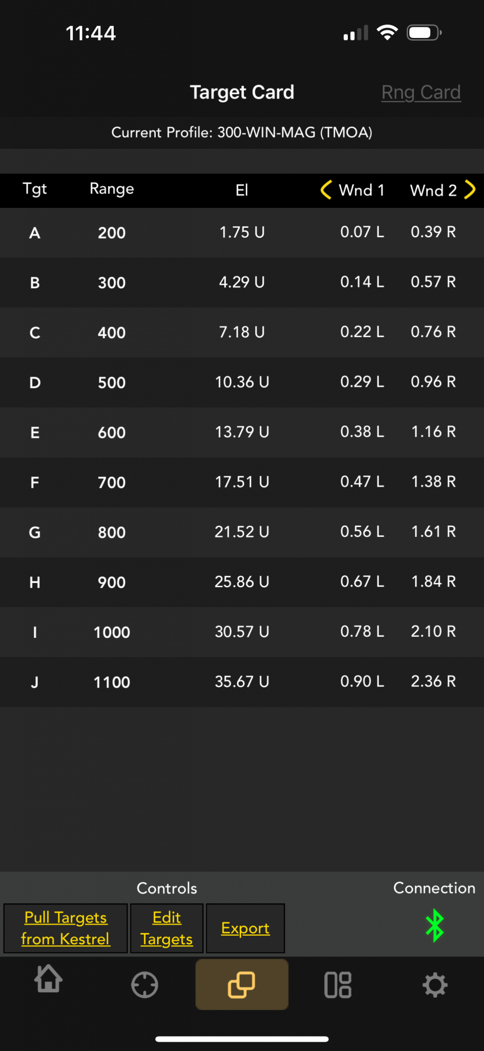

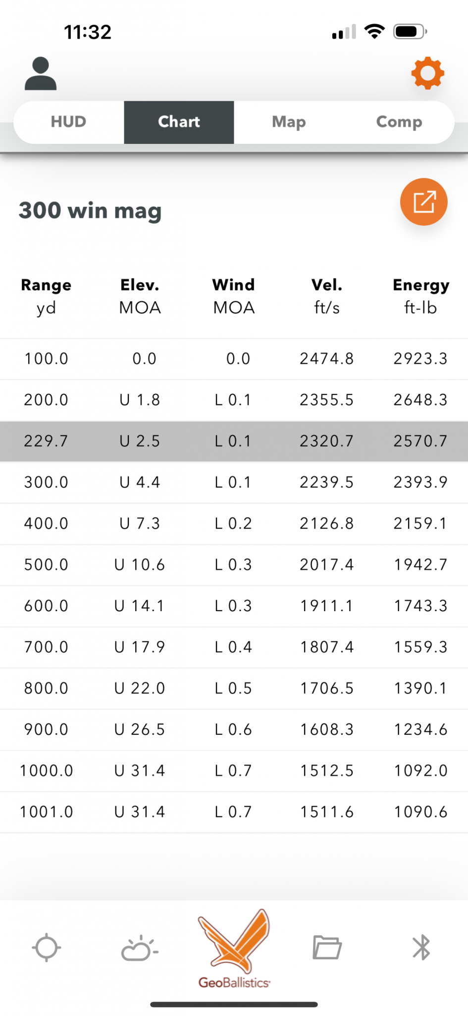

So I tested this today to see if you were right. I took the exact AB solutions I have used and absolutely know are dead accurate and compared them against GeoBallistics. The GeoBallistics from 700yards on was an moa and increasingly inaccurate beyond in drop. The wind and spin was fairly accurate but highlights my exact complaints. Those with good shooting solutions will be forced to go to a lesser or at least different system for no good reason. Same is probably true for those using 4dof.
I’m not calling anyone a lesser shooter but am surprised that anyone with time beyond a good solver wants to change to a new one.

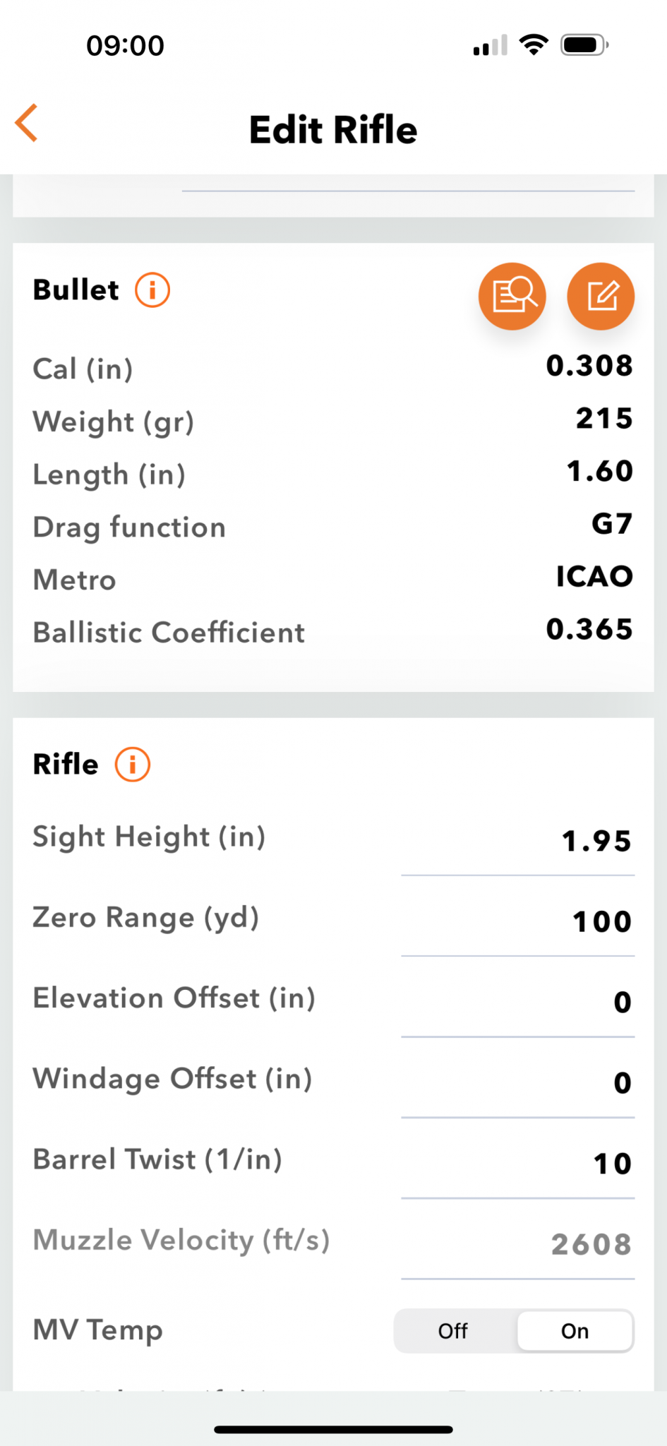

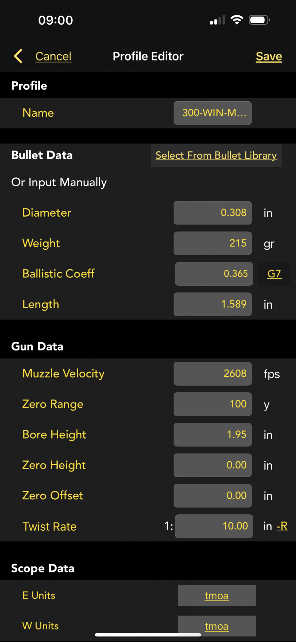

I used the exact same inputs in geo as my kestrel, same temp tables, and even paid the $15 to connect my kestrel for the environmental inputs and it was still inaccurate beyond 700.
I shoot 1k+ rounds a year at 800+ yards i know for certain fact the kestrel is the exact solution needed for my shooting.
All this being said this unit is badass and the kestrel pass thru is my only single gripe (granted it’s the one holding me back from buying it)

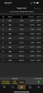

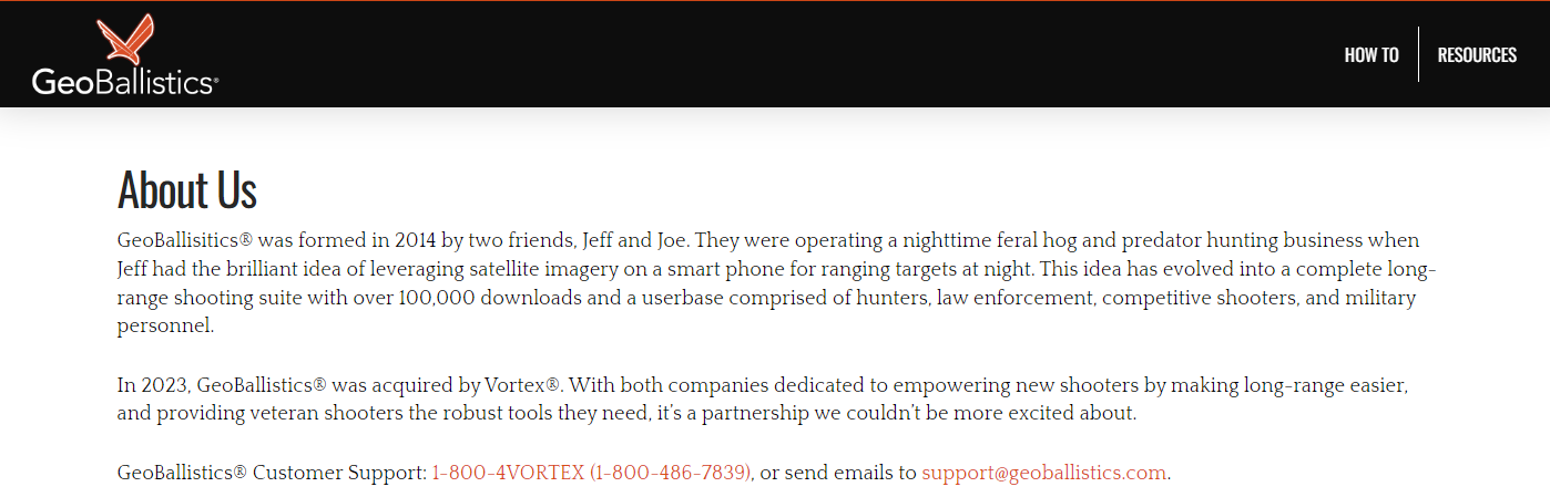

I didn't realize Vortex owns geoballistics. Interesting.
Sometime last spring I think it was made pubic

300 Win Mag - Berger 215 hybrid
Diameter - 308
FPS- 2608
Temp scale - 0.95/ degree
Bc - .365
Bullet length - 1.589
Twist - 1:10
Height over bore - 1.95
Environmentals - kestrel supplied for both.
Wind - 5mph 3 o’clock

I did it despite knowing what the result would be. No difference.
View attachment 8238676View attachment 8238677
Unless I'm missing something, you're getting 30.57 vs 31.4 moa at 1,000 yards? .8 moa translates to roughly 2/10 of a mil difference, which is pretty dang close.
Only difference I can see in your inputs is the bullet length is rounded off in one vs the other. Maybe fix that and see if it changes anything? You could also bump the ballistic coefficient a thousandth at a time in the Geoballistic calculator and see when they line up.
it is pretty dang close but it's not the same exact solving engine as others have claimed in here. I know that my bc is .365 changing it to accompany the solver is not a solution I accept and no one in here is going to argue that geoballistics is more accurate than AB.

Probably because having purchased Geoballistics, Vortex has an incentive to promote their own solver instead of supporting something that is now a direct competitor to their investment.
And likely because it would require paying a licensing fee to Kestrel & perhaps AB to access the kestrel elite ecosystem.

I doubt vortex would actually argue they chose geo because it is better than AB. They blocked out the industry standard 100% for profit and I encourage people to reach out to vortex over it.
Want to know how you can be sure geo isn’t going to surpass AB……. Just read the new research and literature geo is putting out. (Granted I disagree over some points of AB - tuners -but putting out this amount of research and literature is huge point)
