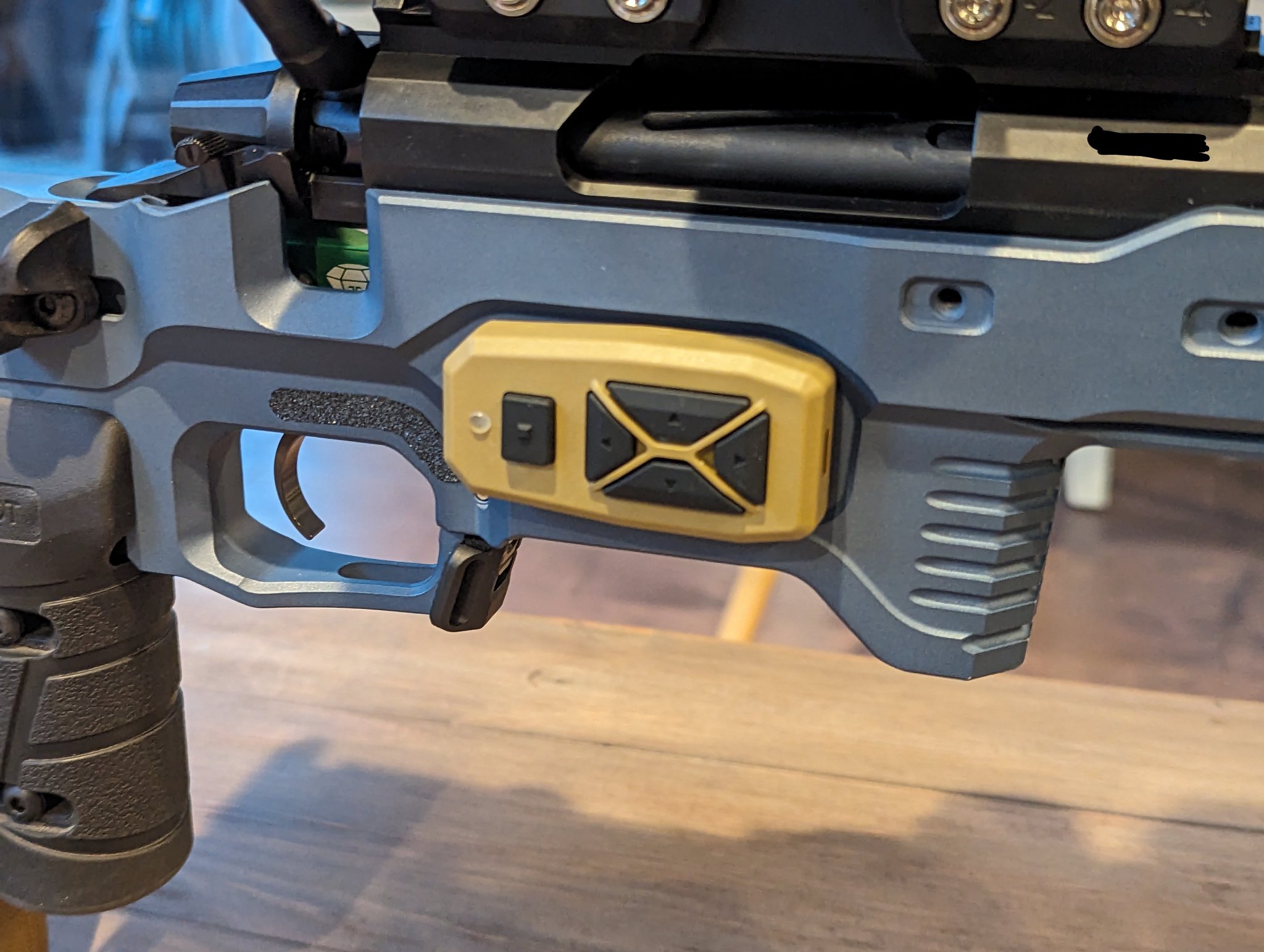

hey where are you guys mounting the remote?
somewhere near the action you can operate with trigger finger?
on the forearm or by rear bag where you can operate with support hand?
also, i had to mount mine on the side because my raptar rail wasn't tall enough to clear the clipIR ELR. interestingly, changing the orientation doesn't just change the rear screen, but also the buttons: when mounted on the right of the gun, the "right" button becomes the "bottom" button etc. HOWEVER, the remote does not appear to change which is kinda odd mentally.

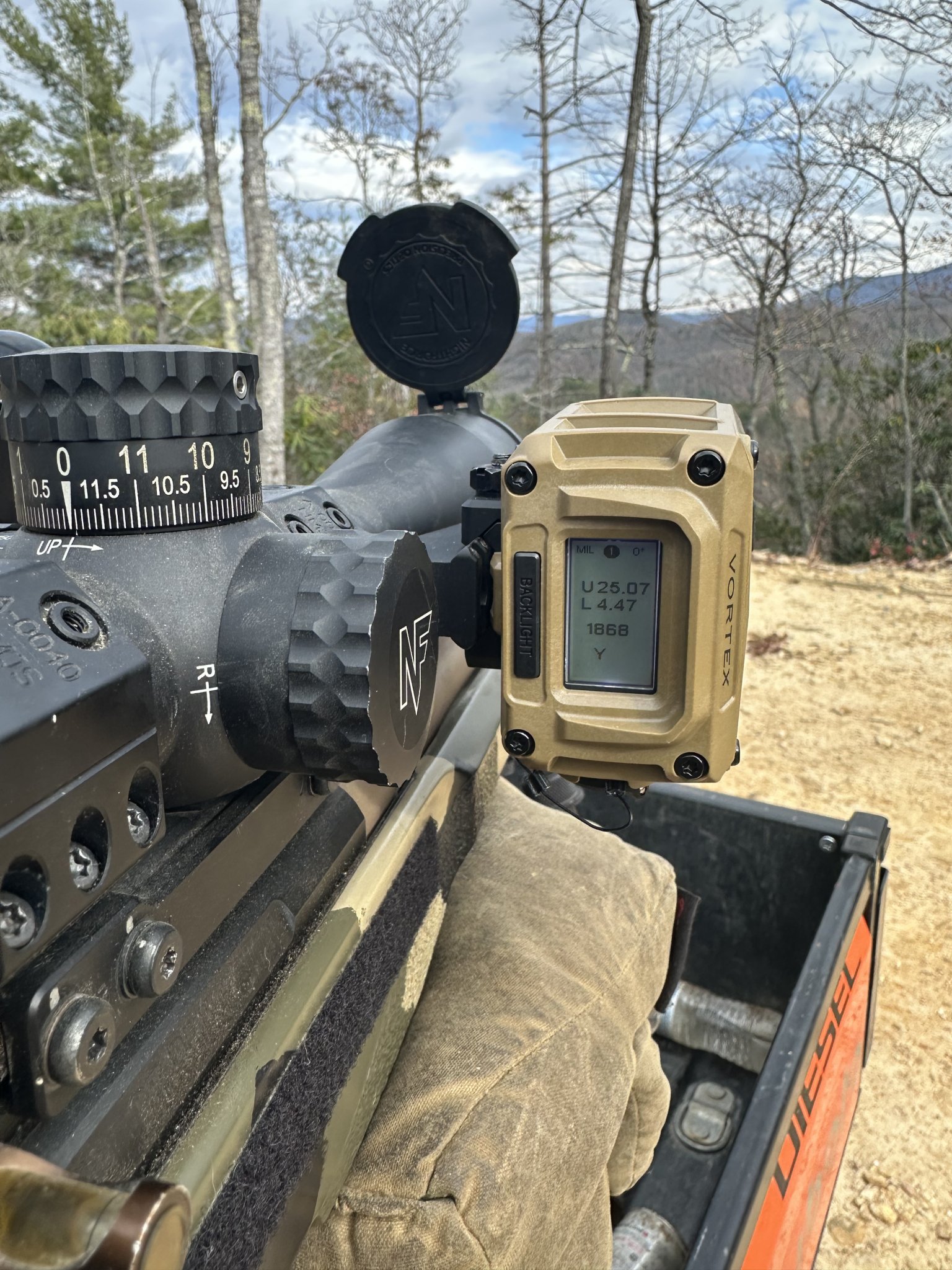

Took a random laze at some trees in the mountains. Got 1868 yards and a solution of 25.07 mils up. Used my kestrel to get a DA of 3300’ asl and put that into my old calc Shooter ballistics and it told me 25.0 mils. Everything so far has been inside a tenth.

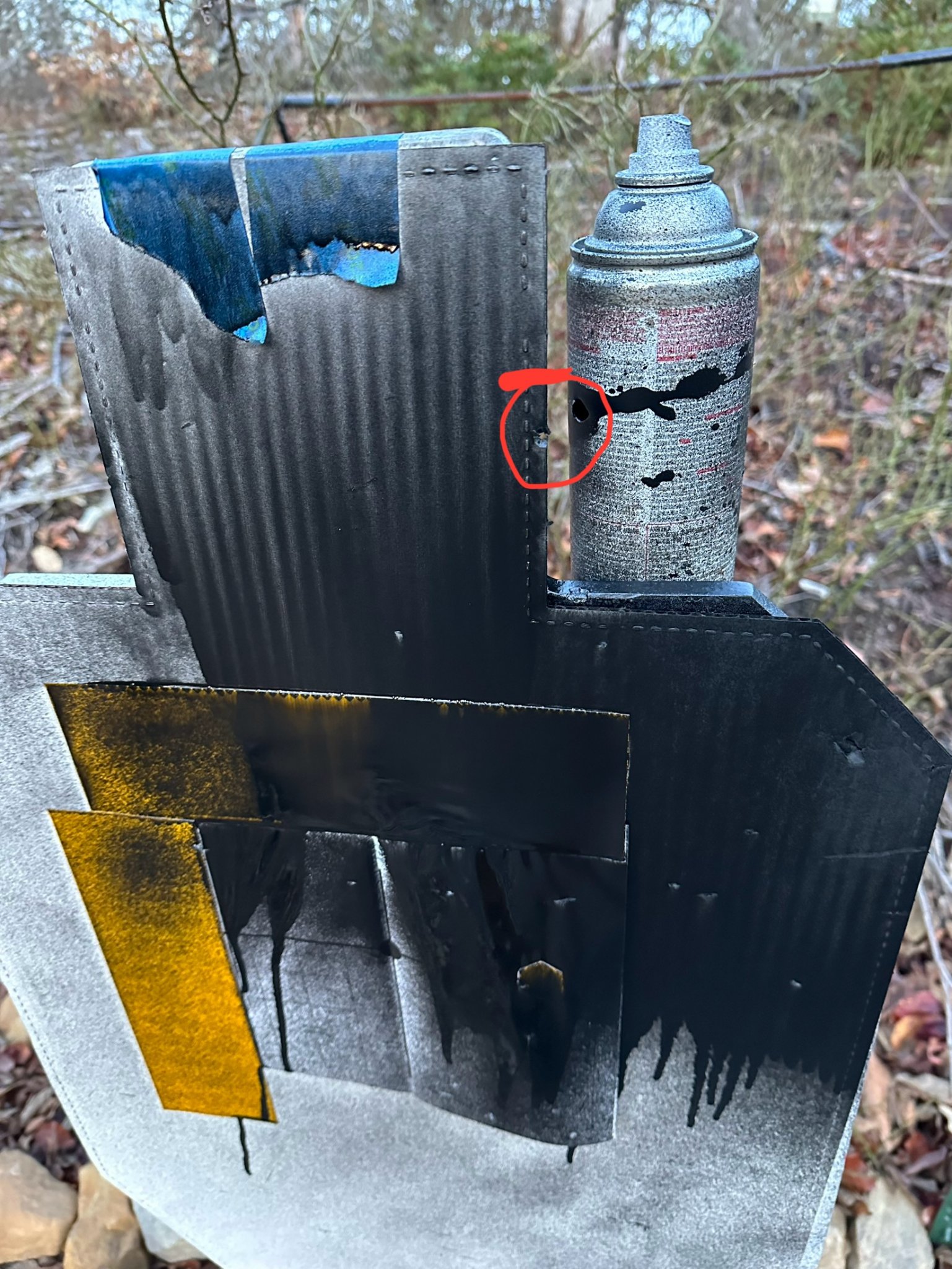

In case anyone is wondering why vortex ships TWO sets of reflective tape and zero targets with their wmlrf, it’s prob because of retards like me who go to fine tune their lrf zero at long range after zeroing at 100 and realize they left their paint can on the target, then feel morally obligated to shoot it. Fortunately I fine tuned both the impact 4000 and the radius before the shot and they both gave 414 yards. Neither was able to get a reading from the 6” black circle 5 yards in front of the IPSC though (but I can with plrf10c).
close inspection shows that the bullet did not touch the perforation lol. I have no explanation for why the can flew back towards me and coated the front of the target. Never had that happen before. I was thinking worst case I’d hit the head and throw some spalling through the reflective tape. Oh well.
