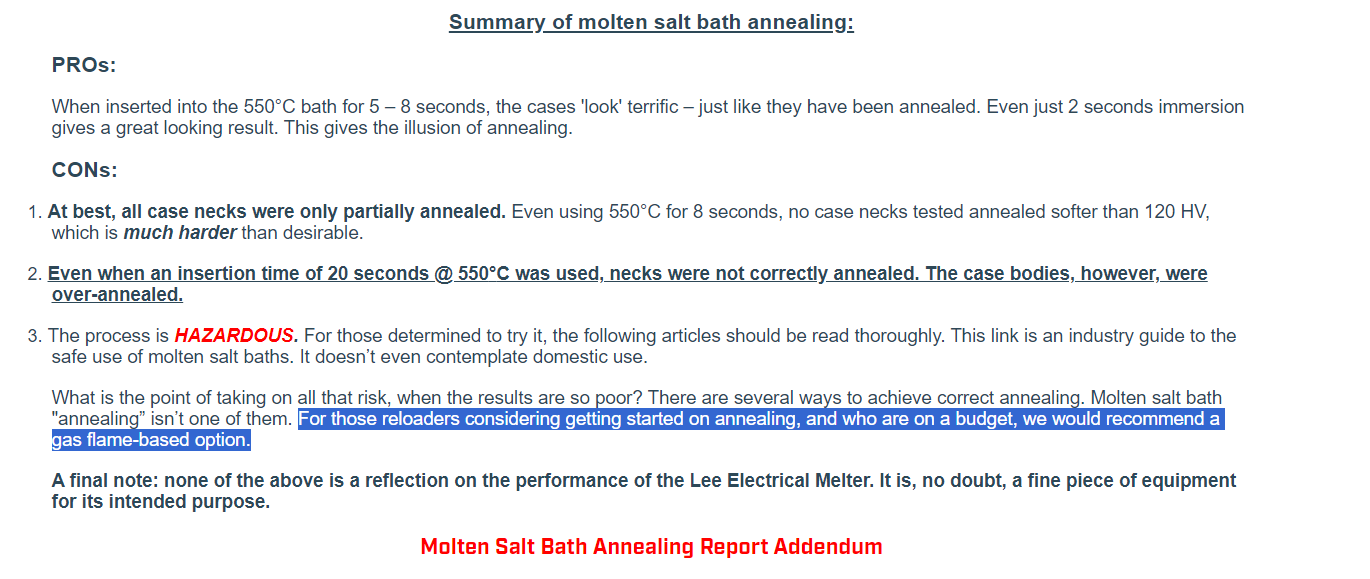

Below, straight up from AMP themselves (the makers of your god tier annealer), if you're looking for a low cost annealer, they recommend a gas flame based option.
https://www.ampannealing.com/articles/52/salt-bath-annealing--does-it-work-/

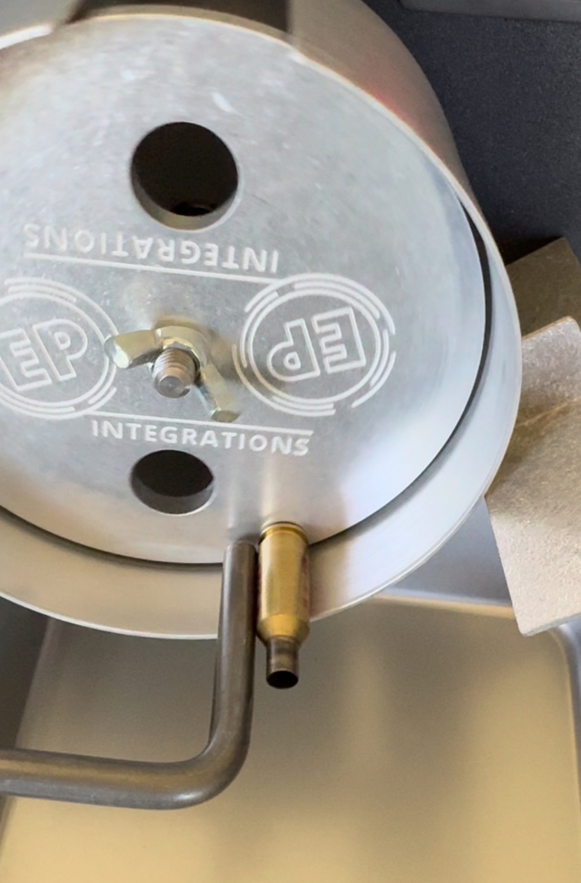

I have not annealed brass before and want to start. What are some decent low cost annealers?
Alternatively, I got all of the parts for a DIY annealer (Elfster's) following this youtube:
Anybody use this DIY annealer?
that's awesome... man, it's been that long since i made that video already!?!? time goes by wayyyy to fast!
yeah, there is a reason why we developed the EP 2.0 annealer over the DIY model in the above quoted video I made years ago. #1 it will adjust from 5.7x27 to 50bmgs, rim or no rim, and adjust in less than 30 seconds without having to add or remove any parts. It is purely based in the KISS method and its hard to explain until you use the simplicity of the EP 2.0 annealer.... Also, there is a reason there is no hopper = IMO a hopper is not needed... Why? If we are talking a case feeder, then maybe yes.... but a hopper is not a case feeder. Regardless if you're using a hopper or single feeding a fence like the EP 2.0 annealer, you still need to pick up the brass, orientate the brass in a particular direction, and feed the hopper or single feed fence. A hopper doesn't make the process of annealing faster. If 1 pc of brass takes 6 seconds to be annealed, then hopper or no hopper it still takes 6 seconds. By the time I orientate brass in the right direction, fill up a hopper, and swap out parts, I'm already 1/4 of the way into annealing with the EP 2.0 annealer. All you're doing is filling up a hopper and its not like you can go mow the grass while you have a flame running in your reloading room anyway. On average it might take approx ~6 seconds per anneal x 100pcs of brass = 600 seconds = 10 minutes of your reloading process per 100pcs = not that much time in the reloading process. Now a case feeder would be a whole different story where you are throwing in handful of brass and the machine does all of the work, but this makes it very difficult to do when it comes to the adjustability of the EP 2.0 annealer from 5.7x28 to 50 bmg, rim or no rim, = once again = KISS (keep it simple stupid). $239.99 gets ya everything you need to anneal other than the propane tank... there is a ton more info here too www.epintegrations.com
with that said, i actually talked to the guys with AMP at the last shot show and had a wonderful conversation with them... and not naming names, but 1 of the 2 actually told me if you would like to start with annealing, then "if you want to anneal and dabble with it flame annealing is the right way to go" & "there is no debate that you can or can not anneal with a flame, if you can melt the case with a flame then at some point you can anneal with it"... I'll agree that the AMP is a wonderful product and obviously produces an amazing anneal as mentioned in the video link below, but not everyone has $1675+ to drop on an annealer..... personally i like to use the "glow method" and using "test brass" to set up my flame based annealers = quick and simple and 100% will notice a more consistent headspace bump when testing resizing with bump gauges from pc to pc of brass resized & can be tested for a consistent bump.
anyone that has tried to bump back stubborn lake city brass (especially 7.62x51) with and without annealing will KNOW that annealing defiantly helps with the resizing process 100%... not only does annealing help with cracked necks and just better brass longevity, but IMO the #1 reason why I anneal is for more consistent headspace bumps.
this is how i use ANY flame based annealer & how it get it going and set up in approx a min using test brass... hope this helps

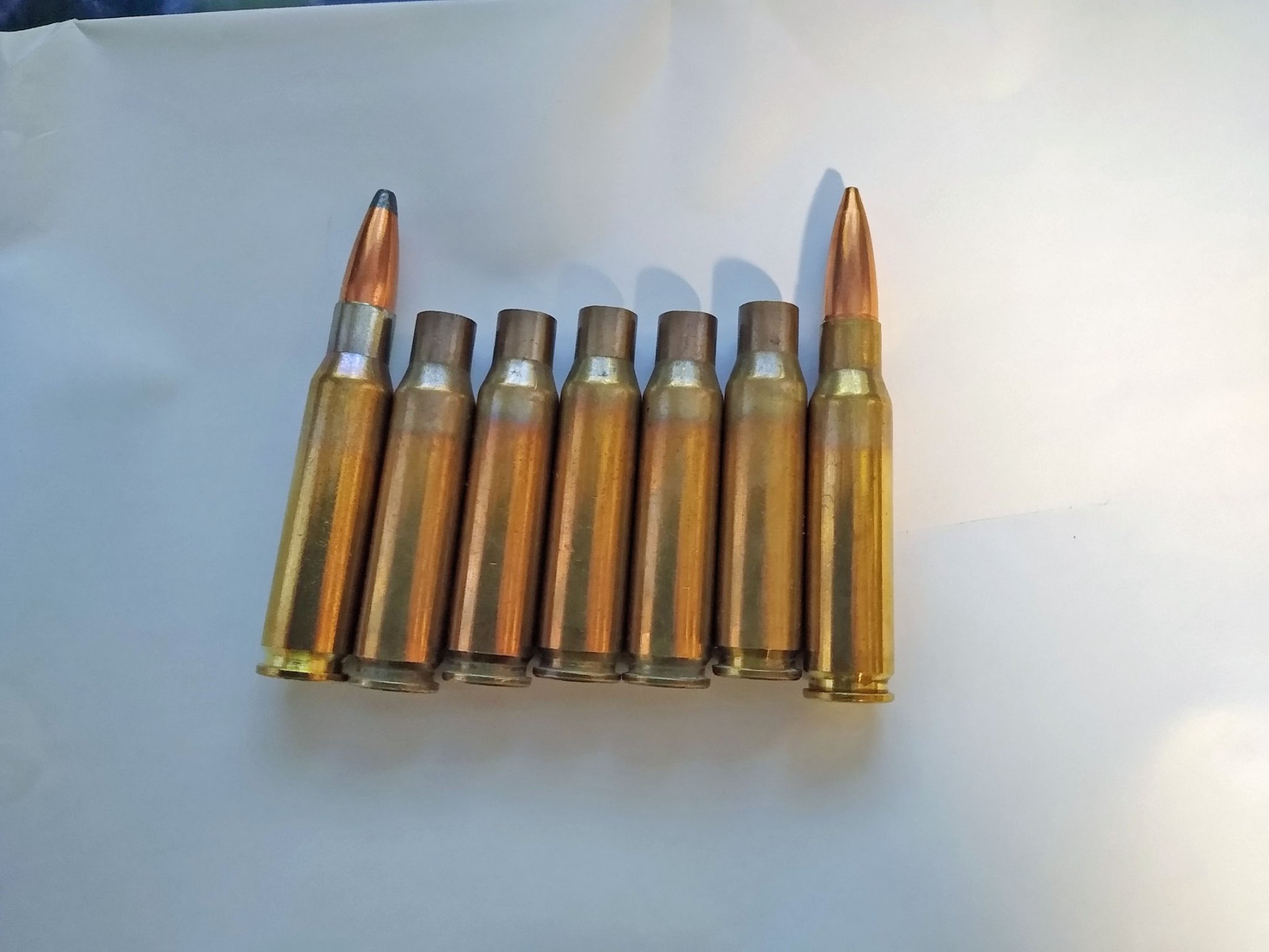

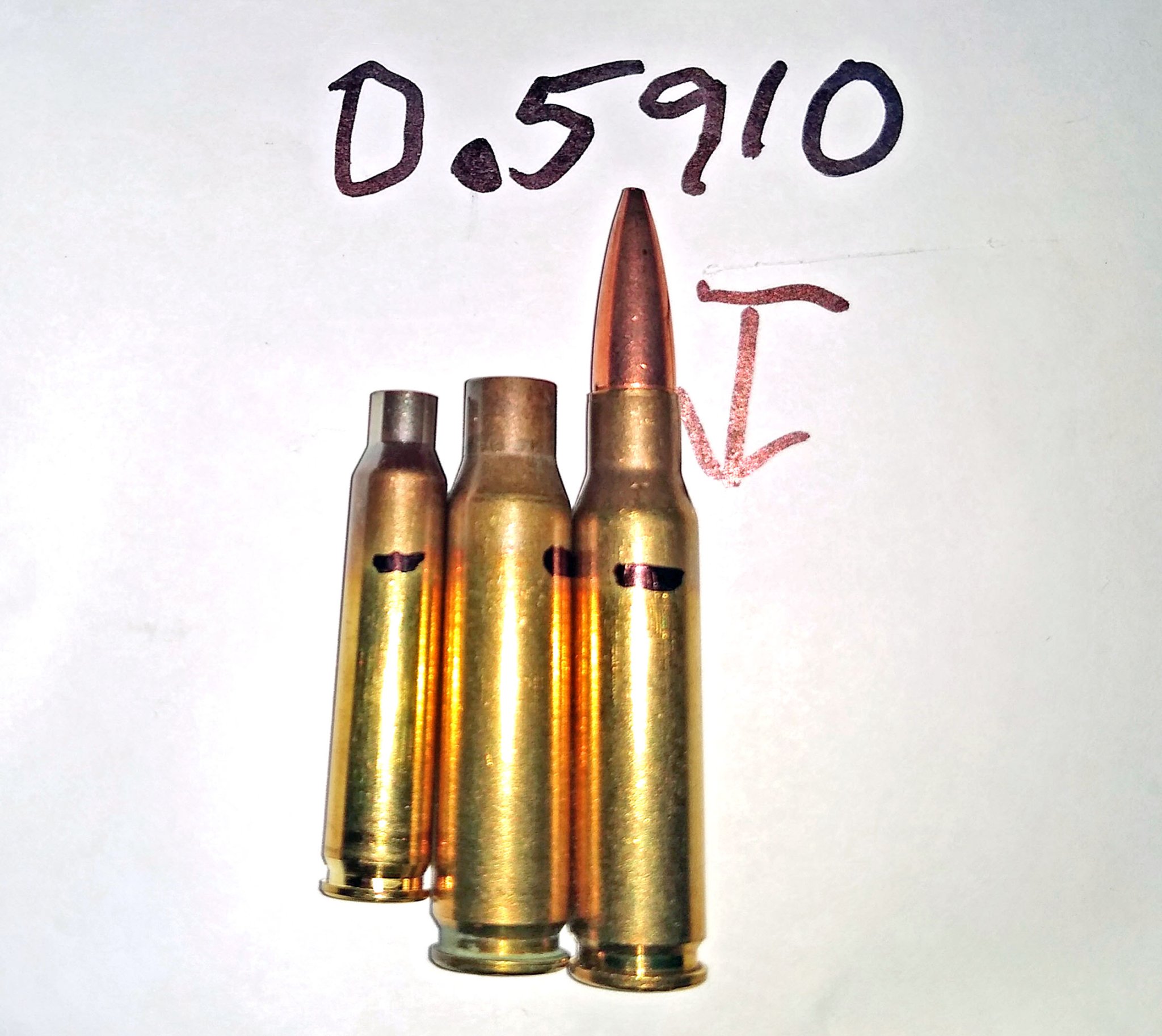

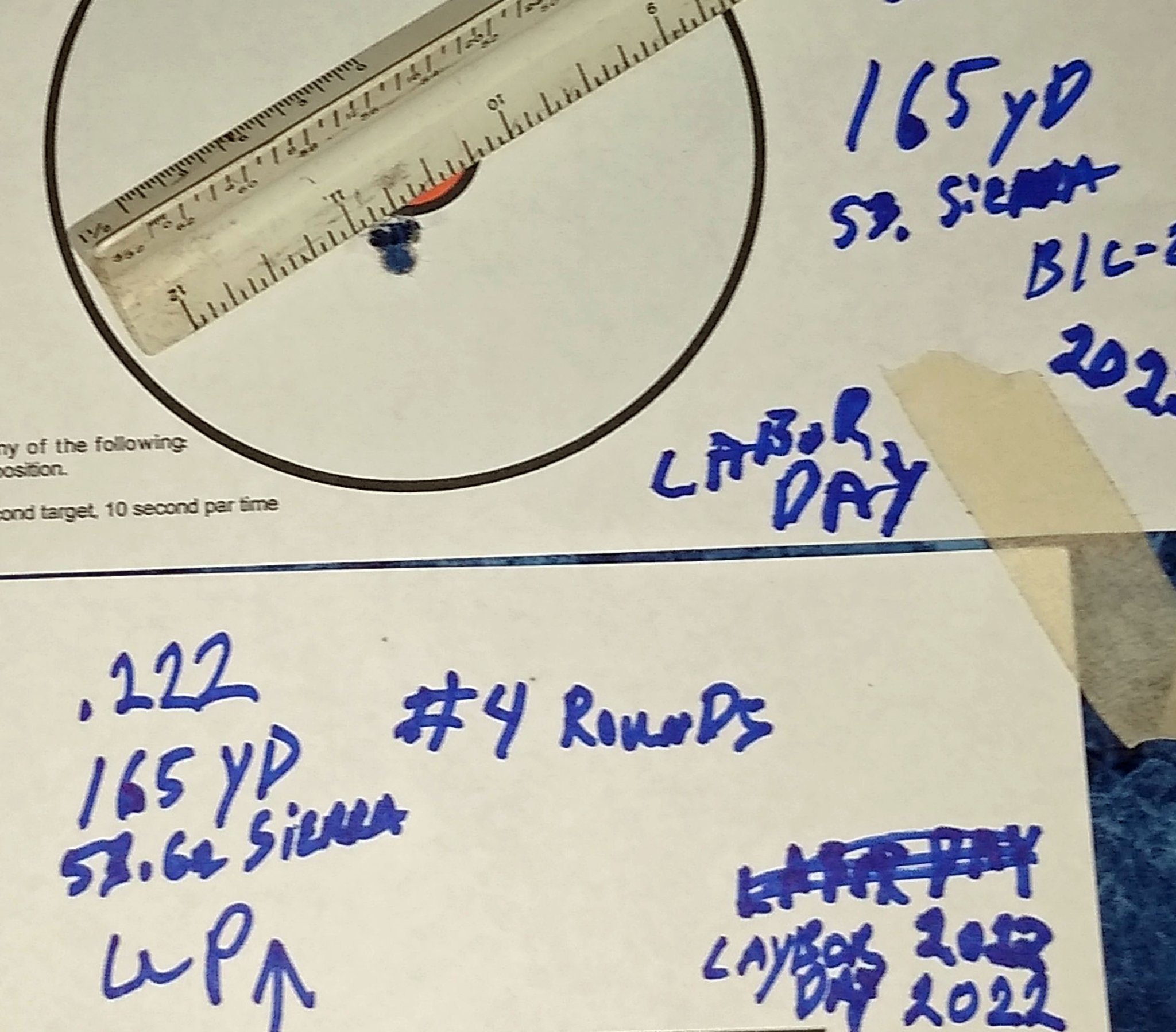

Excellent repeatable results can be obtained using flame as well as induction . Production case stress relief is done faster with induction ,yet depending upon electric KW $ might not be less expensive .
Either method works EQUALLY WELL . As one is simply restoring ductility to the neck and shoulder and NOT repeat NOT annealing, at best can be referred too as PARTIAL ANNEALING .
I do K's of cases a year in #14 various calibers and have had ZERO issues with MY modified Annealeez . Key is pin point flame placement and direction of flame . Aim at base of neck where shoulder meets torch angle 22-37 Deg. flowing over case neck NOT THE BODY . Takes mere seconds and brass reaches 1200 Deg. at the neck shoulder perhaps 950 Deg. . Yet case base NEVER sees 250 Deg. . I DON'T use water to cool as it's totally unnecessary . However if one wants to stand brass in a tray of water and flame the neck shoulder area for the necessary duration ,you most certainly can as it won't hurt anything .
COST verses QUALITY and QUANTITY ; For home reloaders induction via AMP ,ISN'T cost nor quality effective sorry you pissed away your $$$$'s but it's your monies .
As someone once wrote proof is in the target and mine are producing desirable RESULTS . In case longevity if nothing else PAYS FOR ITSELF IN NO TIME . Match's Lapua's witness marks perfectly .every single time regardless of case ,once I set the correct flame angle . Group 7.62X51mm one case is Lapua all others LC note witness marks ,all those rounds went relatively into one hole aka 1/2 MOA .
For those of you who also doubt the ability of a proper Ultrasonic cleaner and solution ,THINK AGAIN !. I've restored nearly 5K .30 Cal M2 cases which are head stamped 1942 and 43 from worse than photo shows ,to as clean and shiny as Military brass gets . Ultrasonic bath 3.5 minutes then rinse in DI water,shake place onto the dryer wait 1 hr. run em in the annealeez ( Flame partial annealing ) ,resize and trim ,prime load and fire .

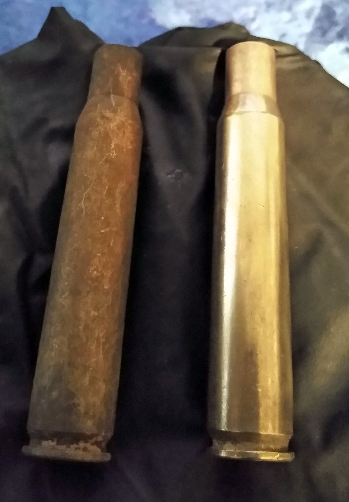

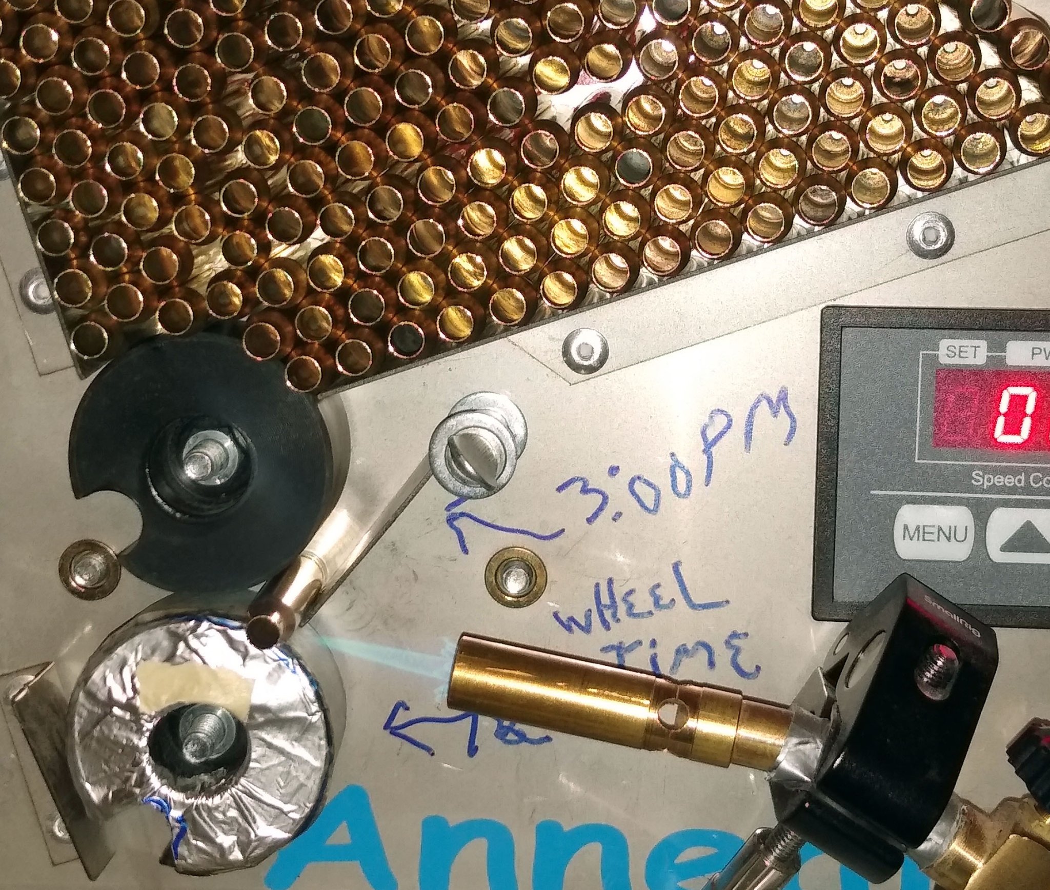

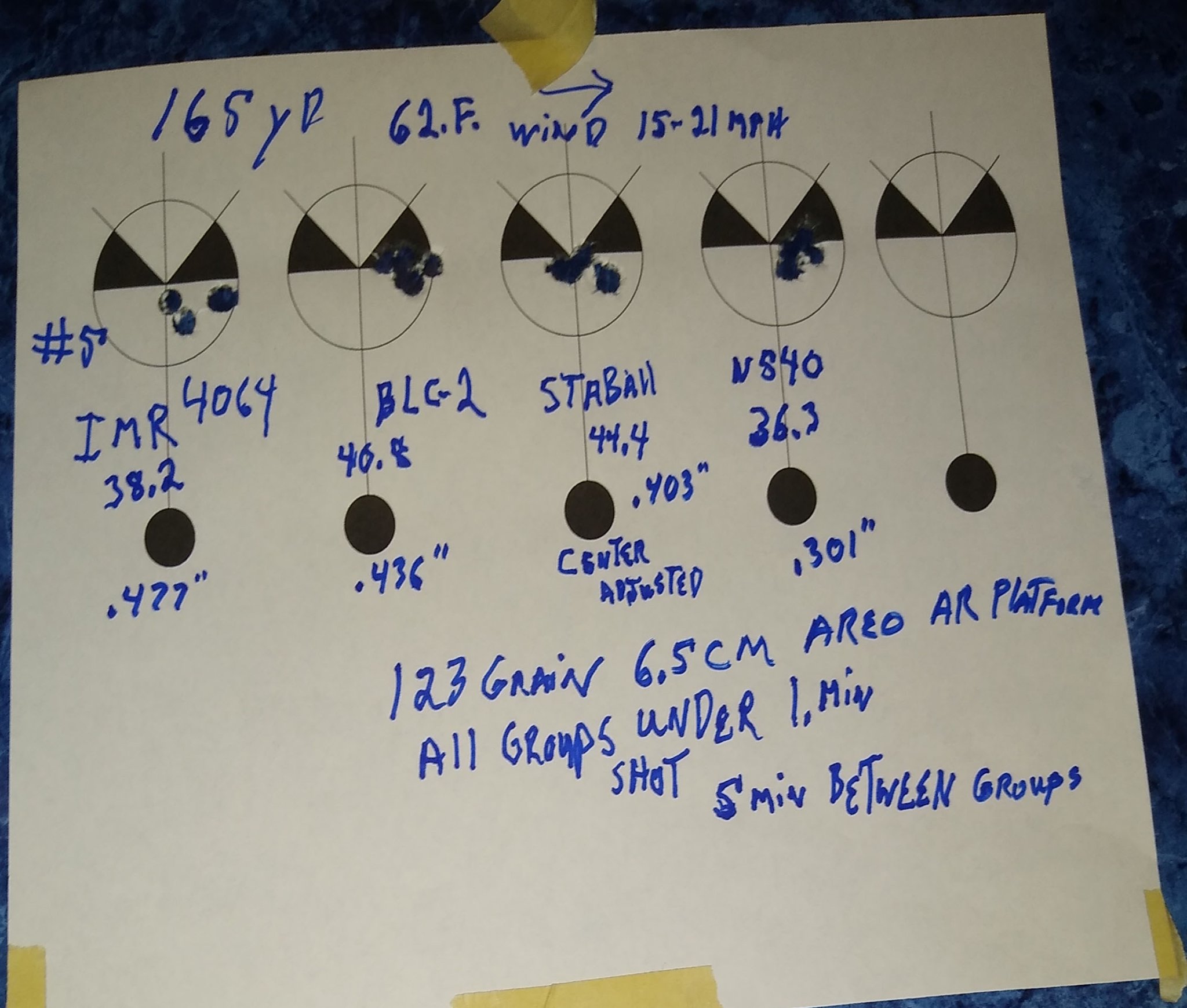

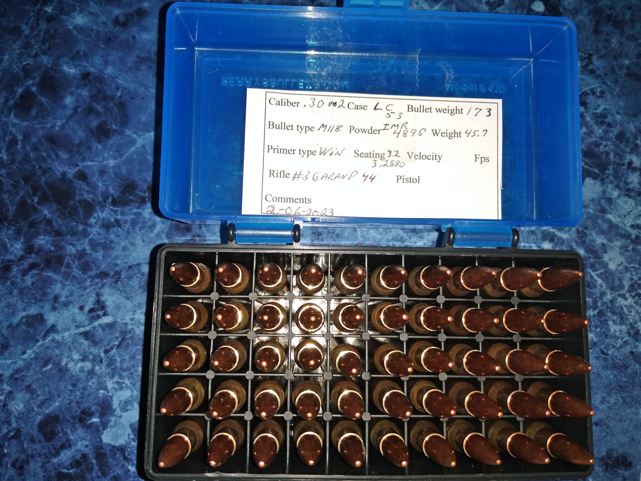

So far #38 firings on original 1 once fired 1942 & 43 brass ,without losing a single case and all loads are within 1 grain of Max. charge .
I believe I can obtain #50 reloads on those those 42-43 , .30 Cal M2 cases before they become too thin to safely reload . I'll finish that test by Labor day :D
Fyi : I shoot off a sand bag without a rear ear bag or happy sack if one prefers ,so imagine what could be done using a BR setup . I don't even own a BR setup any longer .
Fyi : Those Triple deuce loads were from 1994 and I shot the remainder of them in 2022 on a near windless day ,which is like having Two blue moons in a Month around these parts . A light breeze around here is 22 mph , no one bats an eye or speaks of the wind until it reaches 60-80 mph !.
:rolleyes: Bottom line DON'T believe everything you see or read on line , there's enough BS too fuel a Country on line !!. ASK PEOPLE WHO KNOW or read Reputable Publishing's !.
