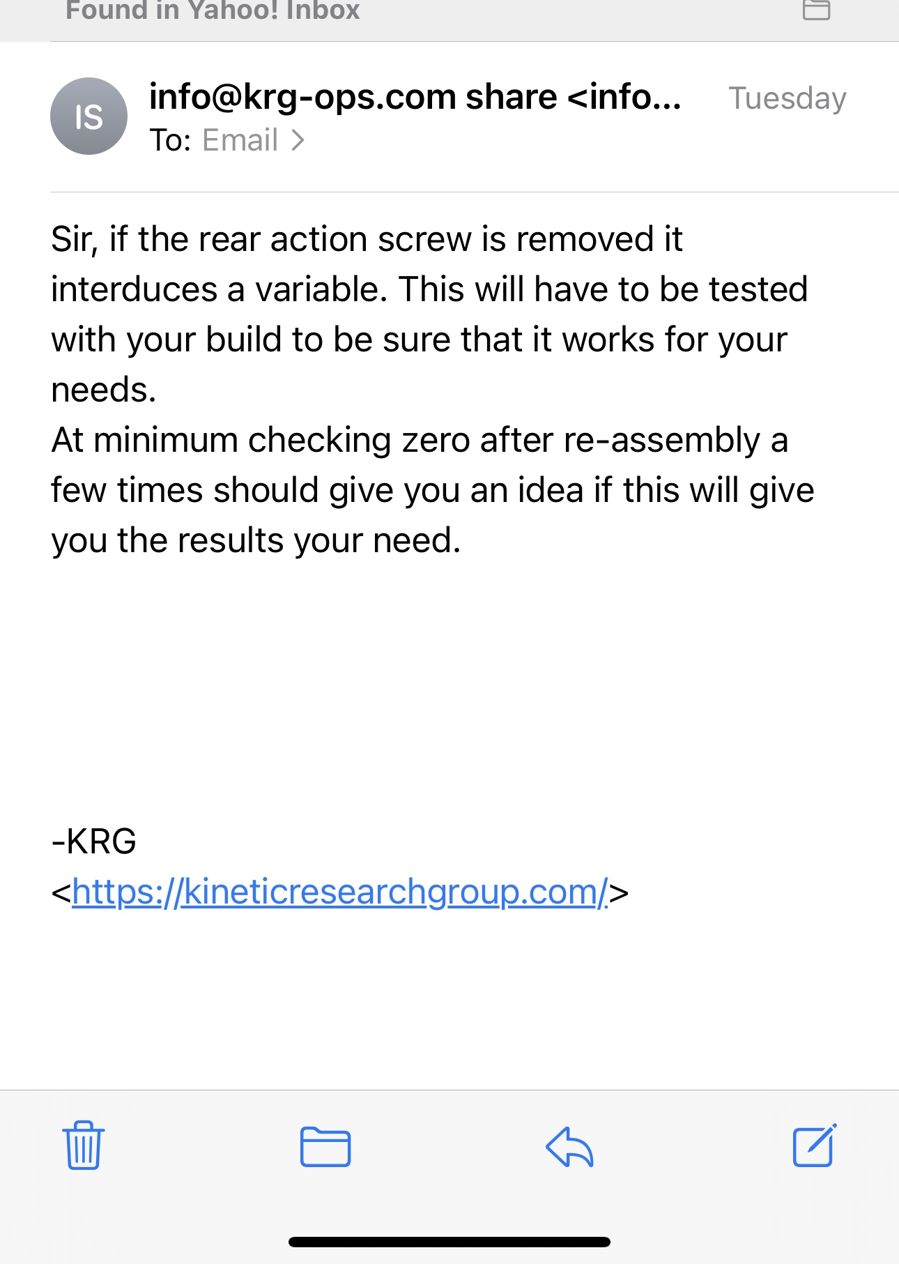

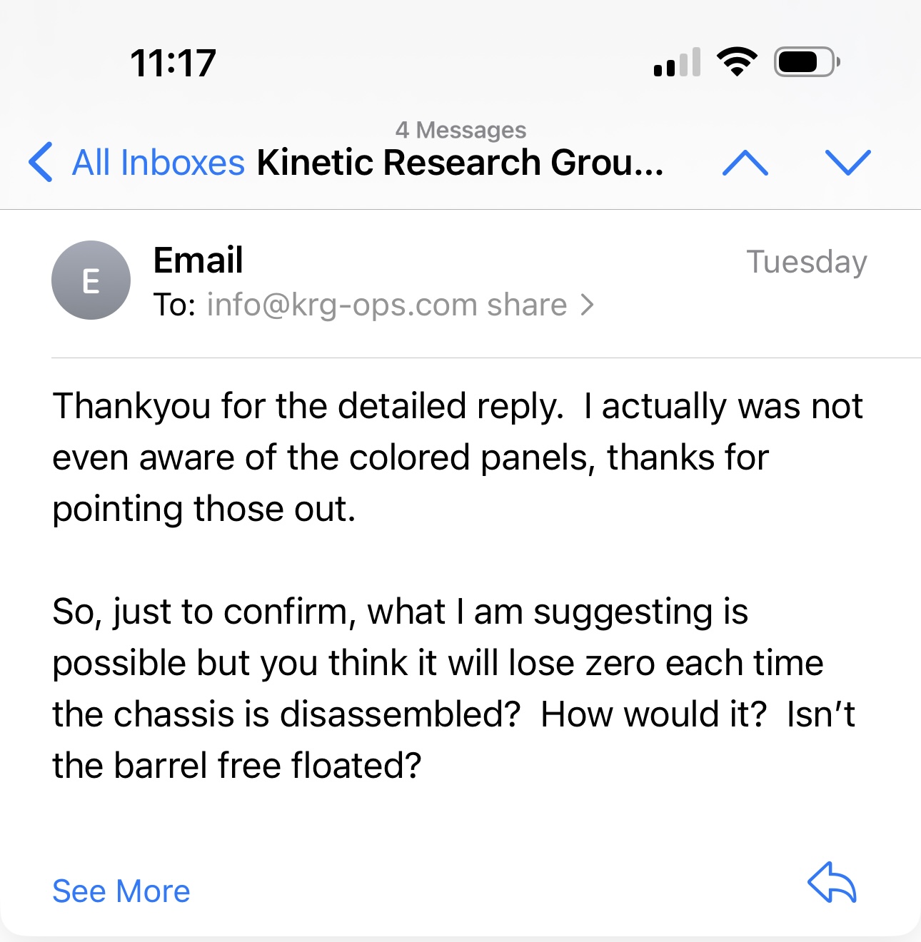

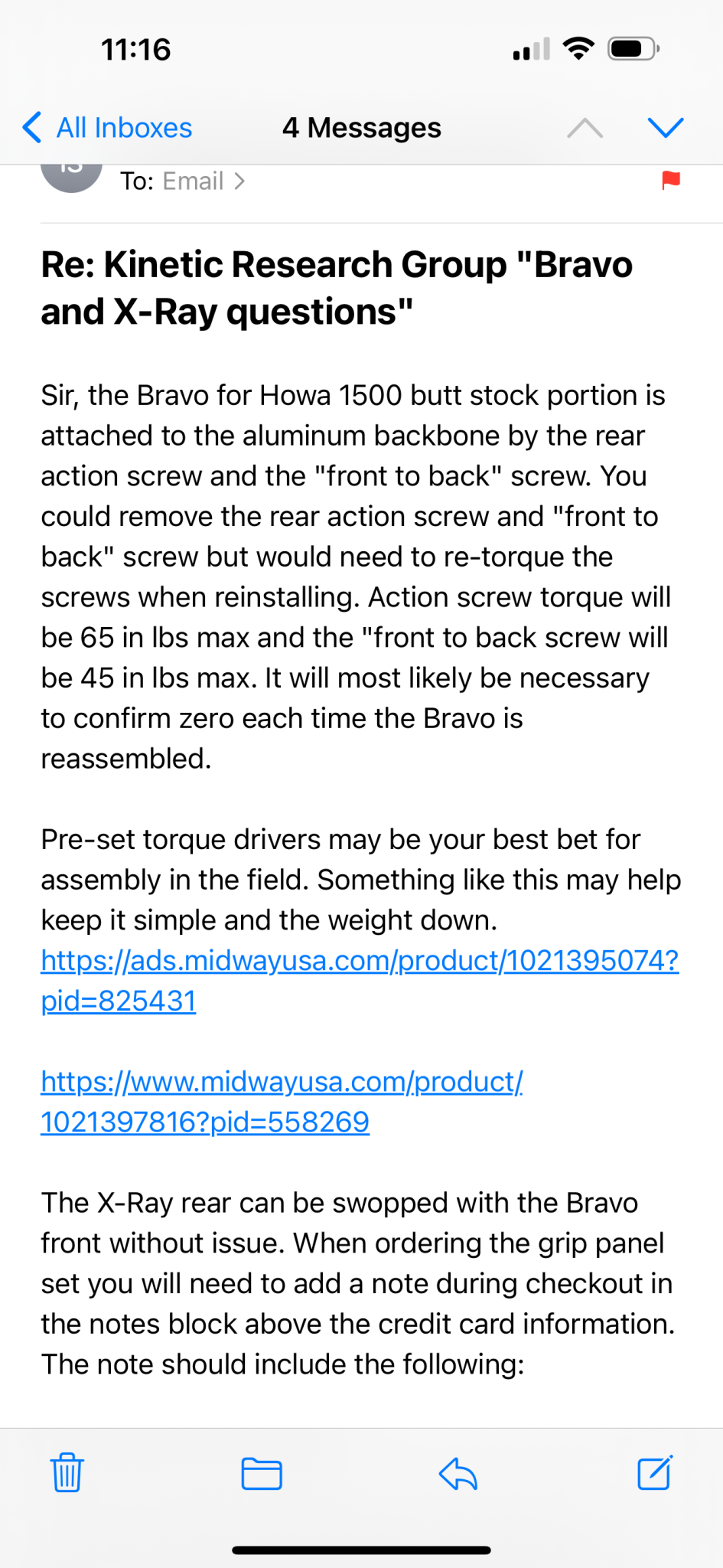

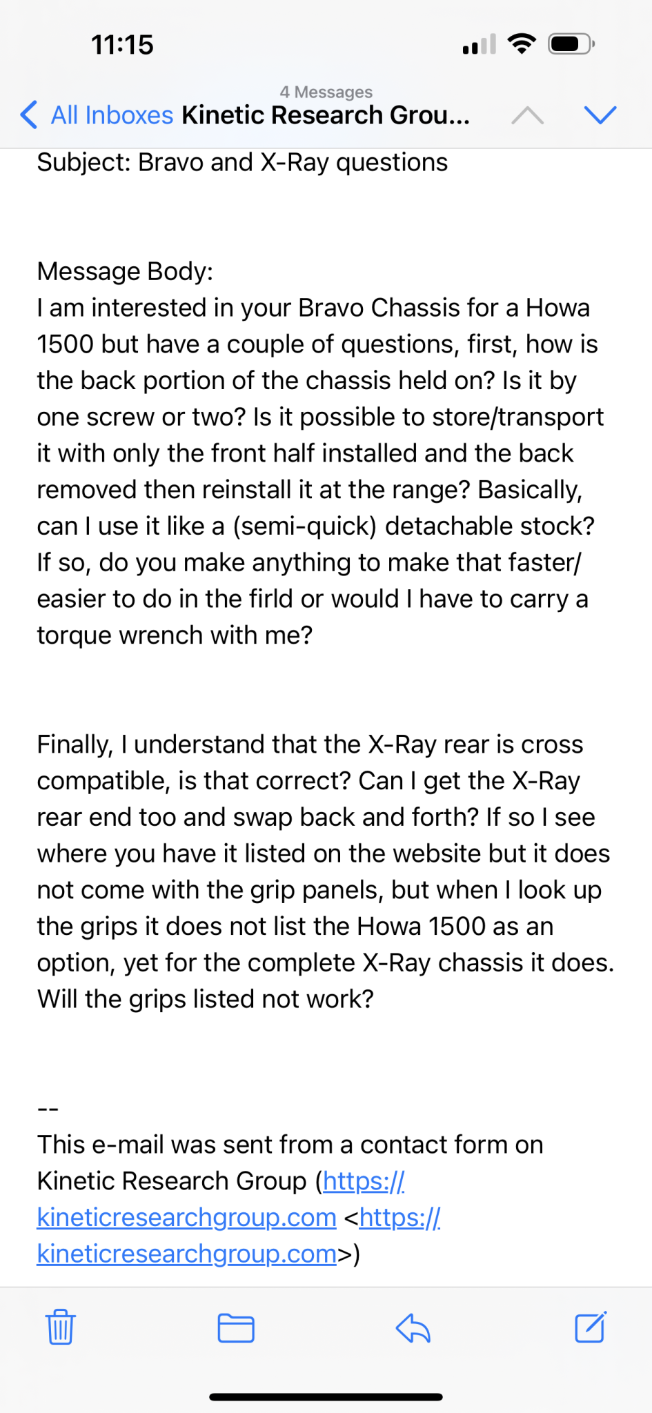

That was based on my emails with KRG directly, it was the rear screw they were concerned with, they called it a “variable.”
I read that as “we think it will screw up your zero but maybe you will get lucky, only way to know is to try (after paying us $400). But we made no guarantees either way, so don’t sue us.”
Do you read it differently?
Or are they really full of crap?

The rear stock on KRGs cannot be removed without removing the rear actions screw.
It migh look like you can remove the stock via the single bolt that holds the stock on...however...
That bolt its...<drumroll>...the rear action screw....
Exaggerate much? All they said is that zero may have to be checked because evidently the rear action screw holds the butt stock on. Not that the zero will be screwed up. You do realize that rifle zeroes aren't actually static for reasons that have nothing to do with the rifle or scope itself, rigjht?
Anyway why do you want to take the butt off the stock for transport? Even when I drove a VW Golf GTI I had no trouble transporting rifles in it completely out of sight.
