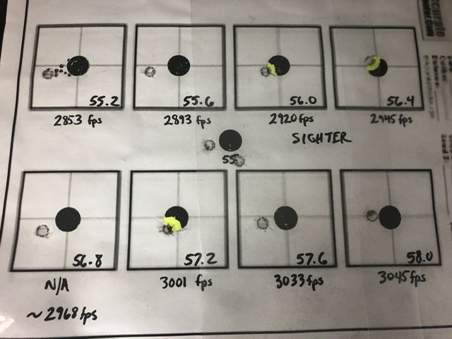

Load Dev:
10 rounds over magnetospeed, .2 jump until a bit over book max. Find flat spot in velocity
Load 15 rounds at that flat spot. Shoot 5 over chrono, 2x5 for groups. If it groups, we're good.

I do two rounds of each on the chrony starting at .02 off the lands or mag length if I can’t get close.
My seating test is pretty coarse .02 increments so after the initial I test .04, .06, .08 and .1

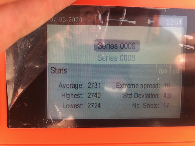

ive also loaded 15-20 rounds of a generic ammo loaded with 130 bergers/lapua brass/h4350 and given it to 3 other shooters w/ 6.5 creed barrels...they all reported ~1/2moa, as good or better than any factory they shoot...didnt watch them shoot it, took their work for it
example; last 2 barrels i messed with i wanted 109s @ 2925-2975 and 144s @ 2700-2750....39.8 and 41.3 of the powders i used gave me 2955 and 2731
i load up more, confirm zero, confirm dope (typically 3-5 shots @ 500 and 5-10 @ 800, could be 3 and 3 @ each range, but i like to be sure)...go shoot
i did the above w/ 3 different load combos, in 3 different barrels for our last 3 local club matches at 3 different ranges

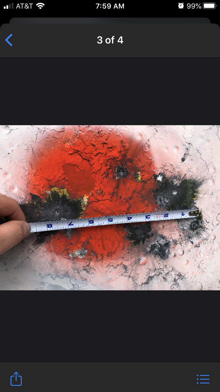

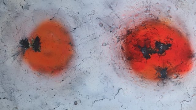

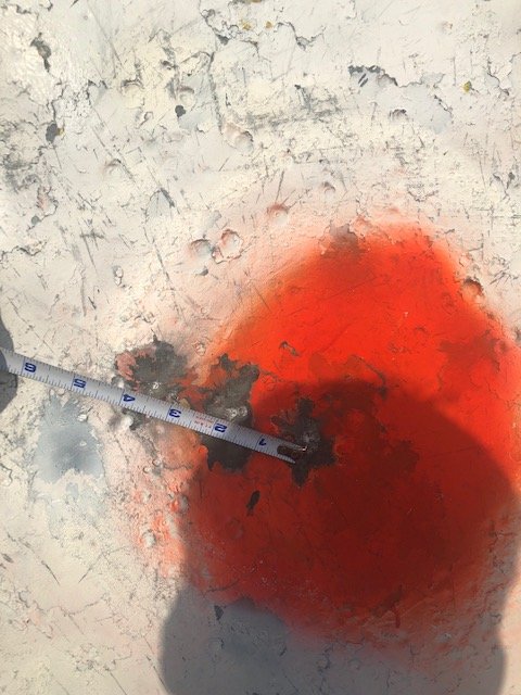

some pics from the last 2 trips out with 109s and 144s...

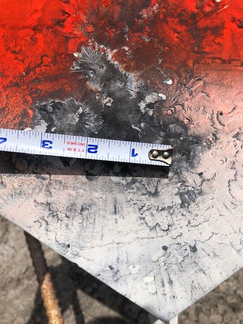

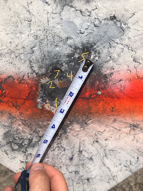

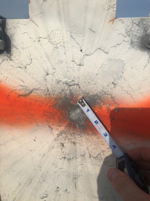

3- 109s @ 500
5- 109s @ 500
5- 144s @ 500
2 + 3- 109s @ 800
first 3- 144s @ 800
adjusted wind .2mil, shoulda went .3mil...3 more- 144s @ 800
one of the trips i shot a total of 20 rounds of 144s...2 shots misread when my muzzle brake blew the lab crooked and 1 i forgot to arm it for the first shot...100 yds zero, 500 yd plate, 500 yd tyl rack, and 800 yds
groups above are either 3 or 5 shot and generally thats all i shot at that distance that day, i just count them all together for every distance...they ALL need to be 1/2 to 3/4moa (or better) at whatever distance im shooting...if i shoot 3 shots at 800 within 4" and then make a wind adjustment and shoot another 3 on a 6" dot...any adjustments in wind/elevation i make, need to match what happens down range...good enough for me, im not positive i could shoot any better to tell the difference consistently from a bipod and squeeze bag

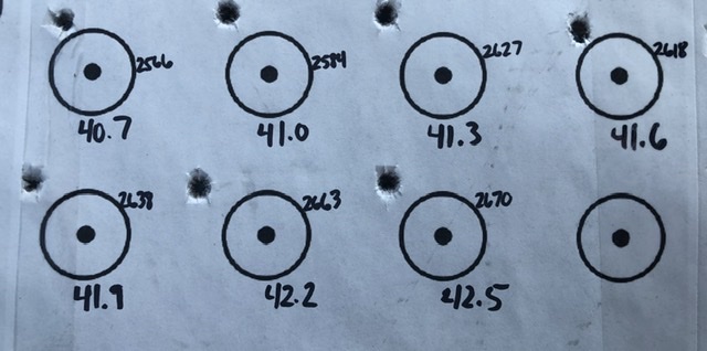

similar to below...first is a 6.5prc, 2nd two are 308s

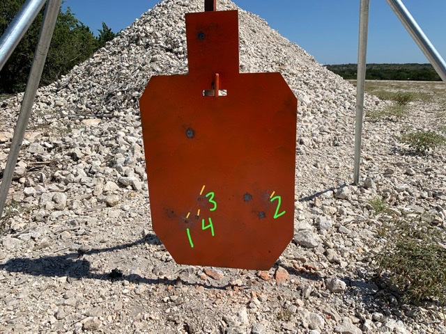

Shot the 6.5 creed 144 hybrid load from the above post #23 this weekend @ 1770 yds...first time past 800 yds for them
first 3 shots were a few tenths low and tweaked my BC off those to get on target, moved from .345 to .342 g7
then went 4/9 on the 18” wide ipsc below
2 of the misses we had no call, the other 3 hit spot on water line with the impacts...wind got me just off the edges (unmarked impacts are from buddy’s 338)...not sure I could even shoot any better, even if I had a “better” load
