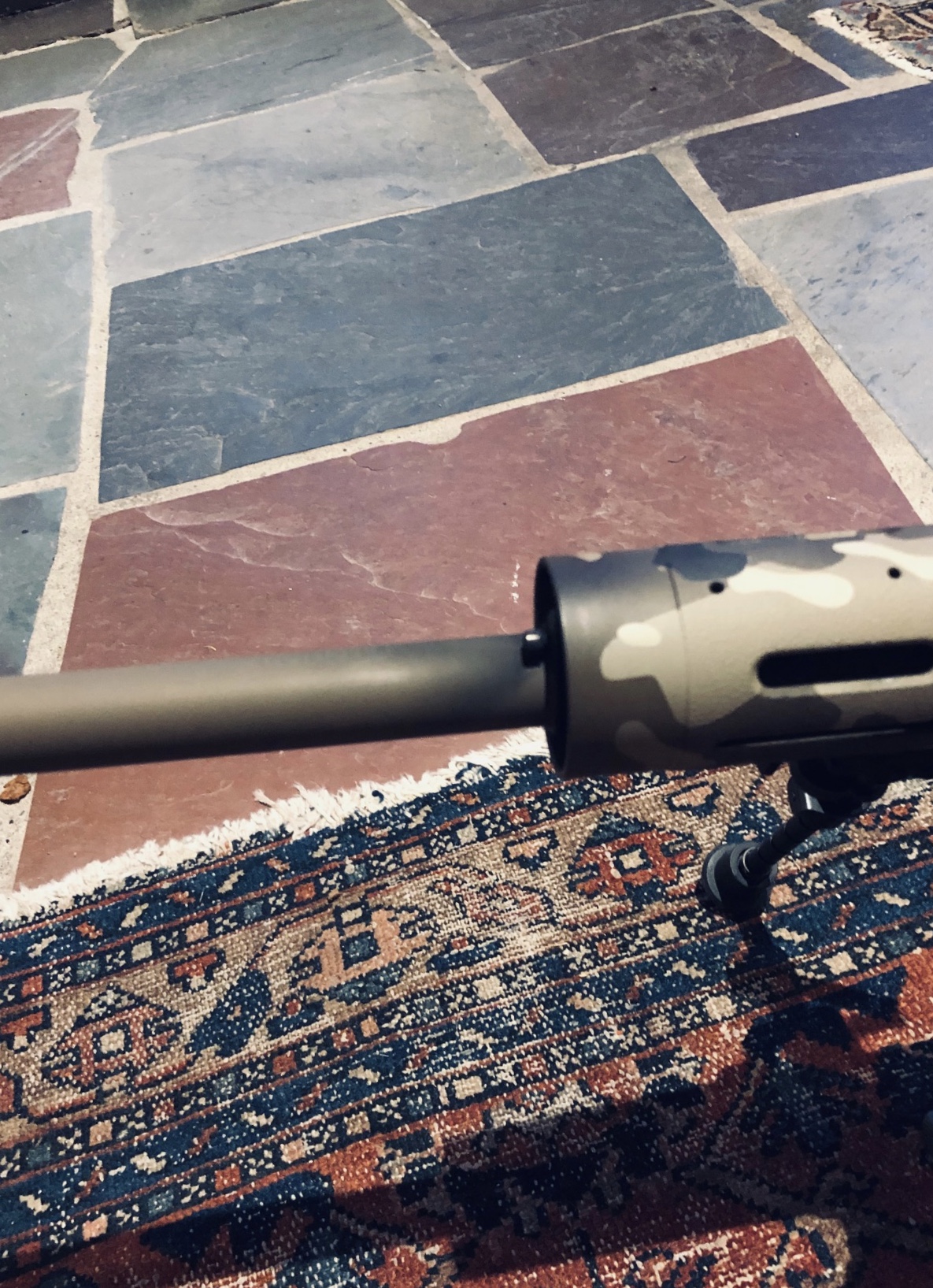

I'm running a 6mm CM gas-gun with a standard weight bolt carrier, it has an adjustable gas-block, and a rifle +2 inch gas system. I have the gas system opened up completely to make the bolt cycle, and as a result I'm getting a lot of back fouling and fouling around the gas block on the barrel. I'm thinking I could run this more efficiently with a low mass bolt carrier, which would allow me to turn the gas dial back. Any thoughts? Thanks.
Sounds like your gas block doesn't fit well on the journal.
If you are running it wide open, just get a standard gas block to replace it. Maybe a clamp on style to reduce the gas leak.
Thanks it's a GA built gun, which they built for me on MA TEN receiver set. The block is the same they use on their GAP 10 builds.

Assuming the gas block is already aligned right, I'd start with sealing the gas block to the barrel to eliminate that leakage. You can wipe a little bit of black or copper RTV or blue Loctite around the gas port hole and inside the gas block and re-install it; this seals it and stops the leakage you're seeing. Of course, don't use so much that you block the hole, a very thin wipe is all it takes.
On the lightweight carriers - I don't have a 6 Cm, but use a light weight carrier on my 308 and really like it. My carrier is right about the same weight as a full auto AR15 carrier and in my experience it makes the gun a bit easier to shoot well. Something like that may solve your under-gas issues, but try just sealing the gas block first.

OP, are you ssying that you need the gas wide open just to make it cycle and it will not cycle if you were to adjust it down just a little??
In regards to a low-mass operating system it could help, just basic physics the gas would now have less Mass to propel rearward over a standard size BCG, not only that but the low mass bcg's smooth out the the recoil impulse as well.
I would first remove your gas block and measure the gas port in your Barrel, if your barrel port size is correct then I would carefully reinstall the gas block make sure to seal it as stated above.
Also you did not state whether you were running this system suppressed or not???

Thanks for your comments. I am planning to run it suppressed some of the time.
