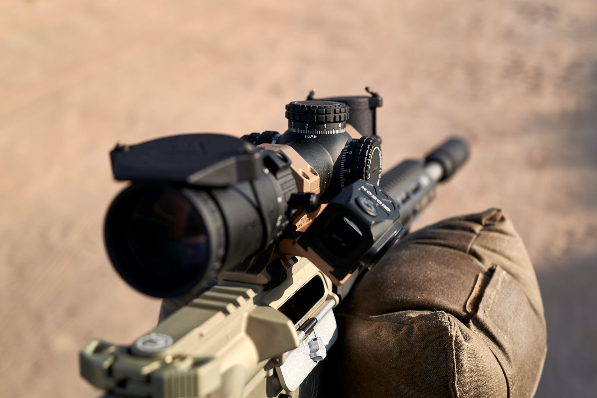

I run this rig on my wolf/lion hunting rifle. This is an old photo, I've had this set up for 4 or 5 years. Still have the rifle which is a 6.5 Creedmoor gas gun, currently running an illuminated 3-18 XTRIII with this offset red dot.
Works great, zero issues. The scope is perfect for my needs and the dot is there for close proximity heavy timber.

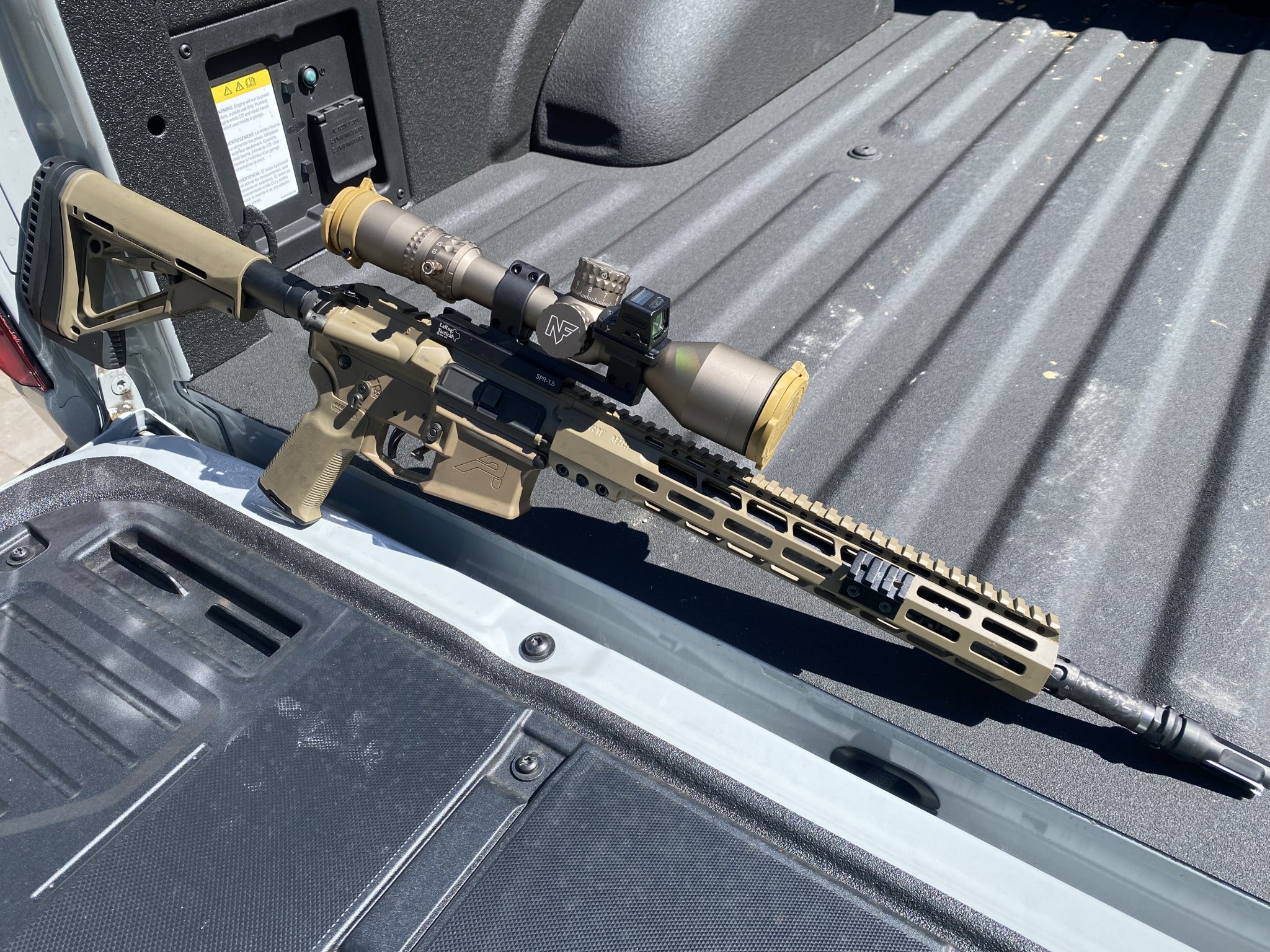

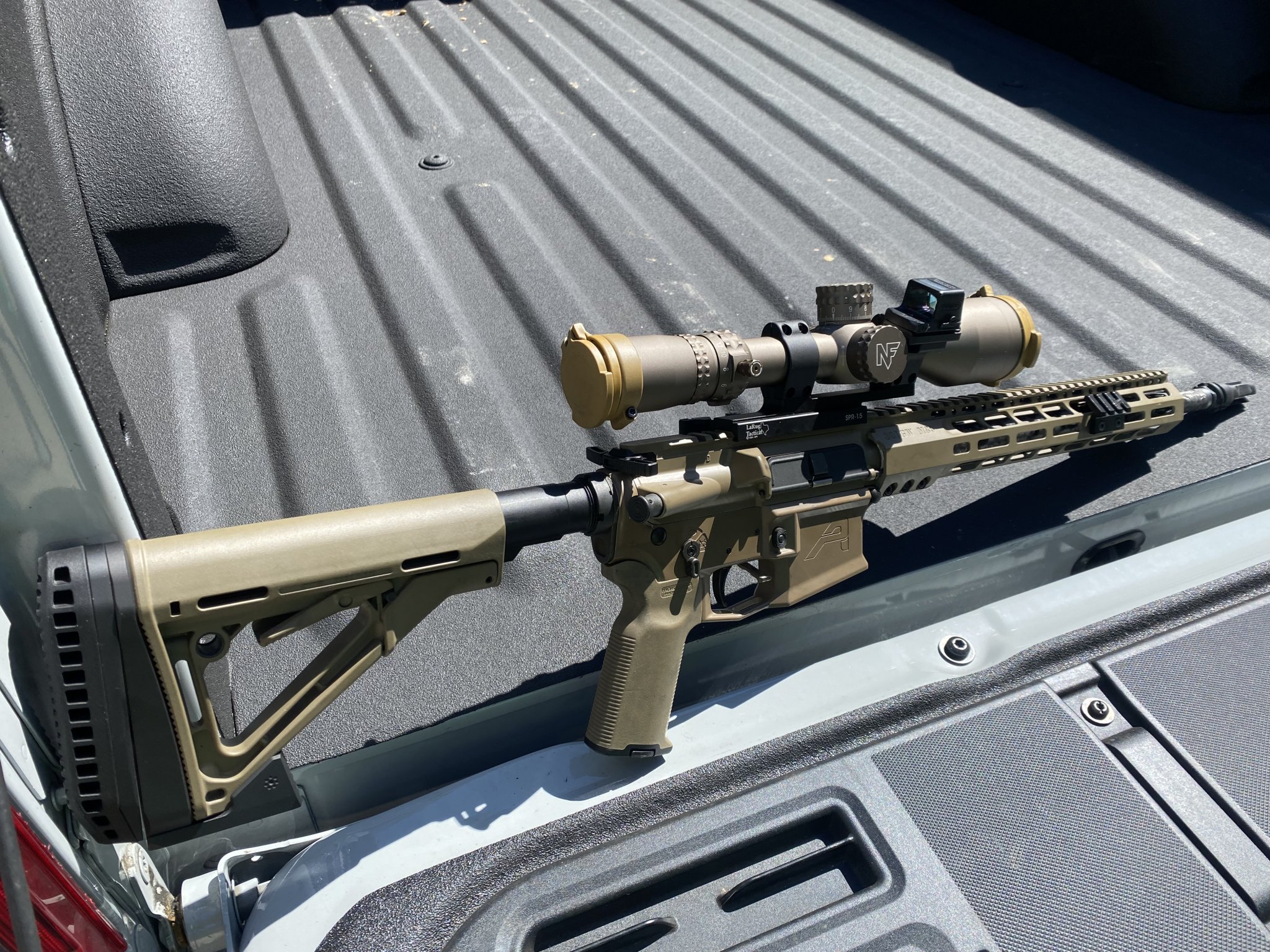

NX8 2.5-20X with an offset red dot is a pretty wicked “do all” combo. This one I built has a Proof CF 16” barrel and is a freaking laser. If I could only have one rifle, this one might be it (and I’ve got 3 other AR rifles with NX8 1-8x, Razor G3 1-10x and and Trijicon TR24)… so speaking from experience.
How do you like the larue rmr offset mount compared to a standard 45 degree off set mount ? Looks like the larue offset mount you have is more of a 70 degree angle.
How does the carbon fiber barrel act when you put a lot of rounds through it, and it gets hot?
How do you like the riflespeed adjustable gas block?
IMO, if you’re not going to use the LPVO at 1x, get an MPVO and red dot piggyback . Even at 4x a scope is fairly easy to shoot both eyes open. Caveat is make sure the reticle fits your need.
As someone with a 1-4 with piggyback dot, I agree. The dot saves me when transitioning from a far target and a close target, but if my LPVO is set to 1x, then the dot doesn't even exist to me.
I like it so far, but I don’t have experience with standard 45 deg mounts. I can keep my chin on the stock with the LaRue and get the dot up fast. The rifles profile didn’t really get any wider with it on there. Very compact setup.
The carbon fiber sheds heat fast, which can create more mirage faster than a standard barrel, so that can be an issue when shooting a lot through the scope. On the flip side, it does cool much faster, so the mirage goes away faster. I haven’t noticed the barrel losing accuracy due to heat.
It’s awesome, but you gotta be careful with your choice of rails, it won’t fit under a lot of the skinny rails. I’ve got it on another precision AR, they are excellent. I wish they made one for .875” journals…
