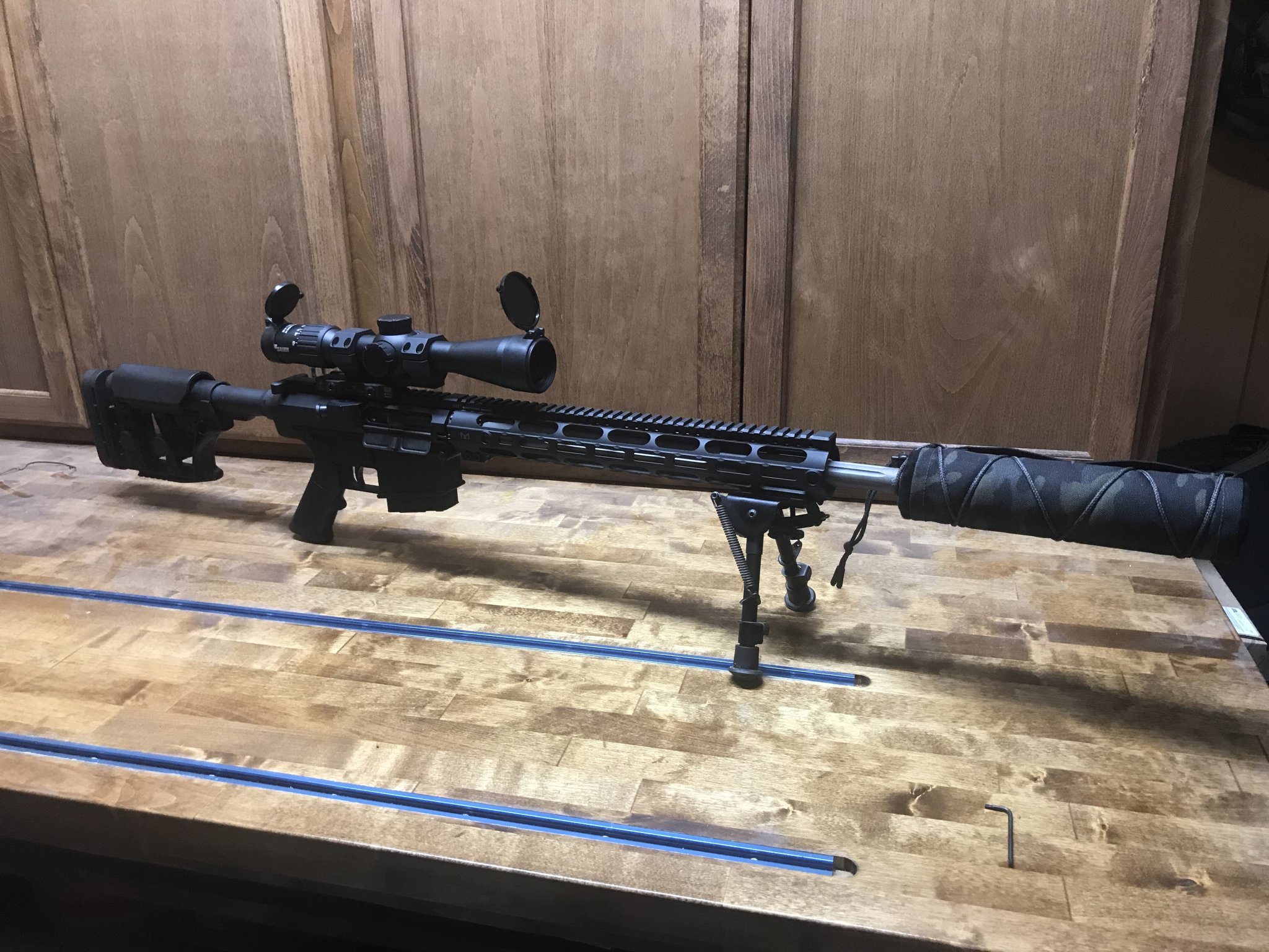

This quarantine has me digging through the safe trying to get guns figured out that I have had issues with. I built this LR-308 back in 2018 and its got some issues.
Specs:
DPMS LR-308 lower
DPMS BCG
DPMS Mags
DPMS Carbine Spring and Buffer
AR Stoner Upper Receiver
Rainer Arms 18" Ultra Match barrel
Rainer Arms .800 gas block
Now when I built this I did not have a suppressor but I was having these same issues when I first built it.
Issues:

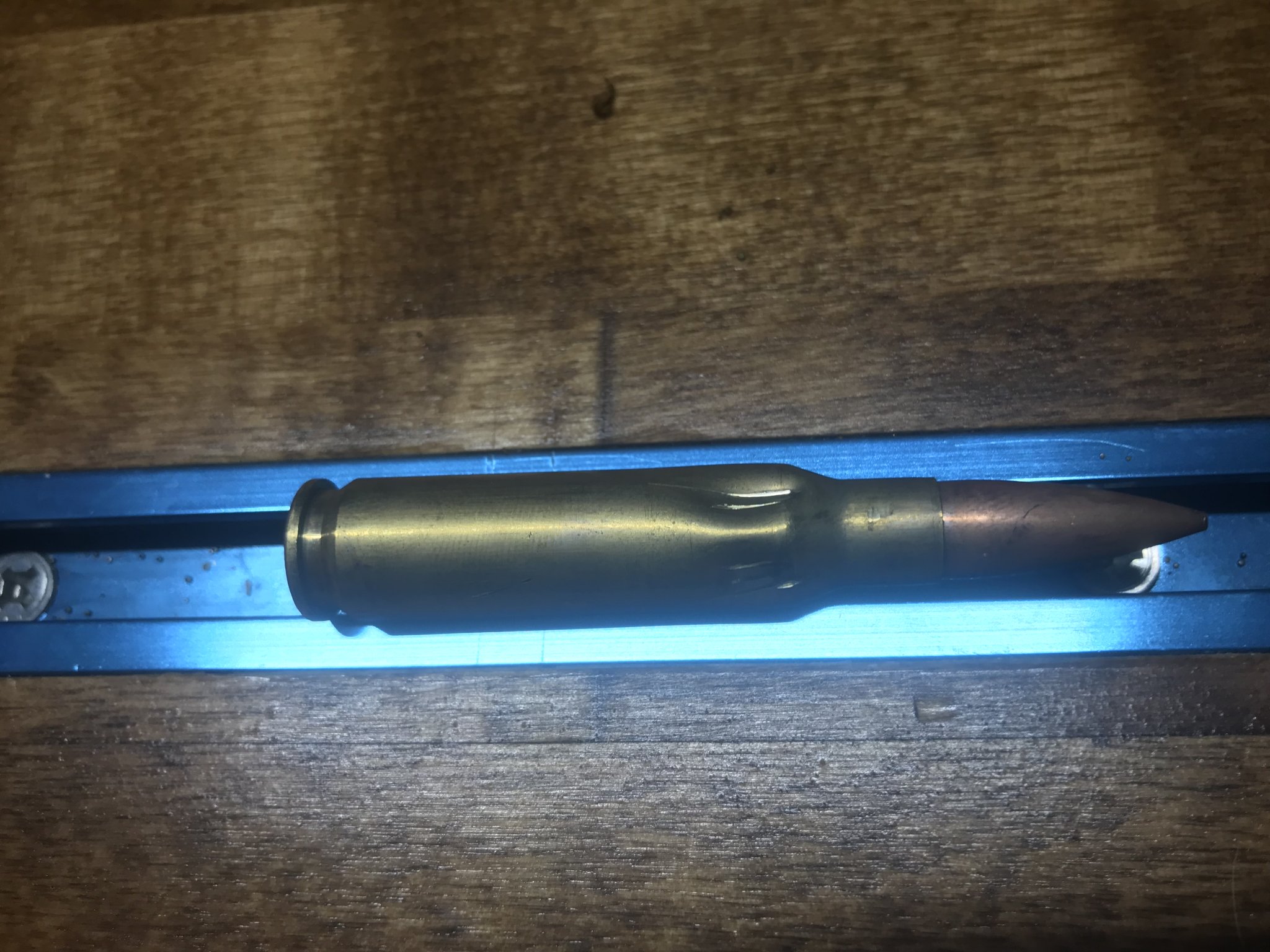

1. Case necks are getting dinged from hitting the brass deflector and they are flying out around the 1 - 2 o'clock position.
2. Some times it seems like its short stroking and using friction pulling the next round out of the mag and then proceeds to smash the bolt through the side of the case. (Had this issue on my DPMS LR-243 and keeping it well lubed fixed it, doesnt seem to be working on this LR-308)

My build was putting a dent on the cases at the shoulder from hitting the deflector, with by AGB adjusted 1 click past holding the bolt open on an empty mag.
A little tape on the deflector pretty much eliminated the dent. Maybe not the preferred way, but it works.
I also would get those double feeds, but only when I tried to use a brass catcher. Once I ditched that, no issues
The dented case looks like a short stroke. Does it lock back on the actual bolt catch or mag follower on the last round?
I was thinking it was short stroking when it dented the case. After it did this with two rounds(they were not back to back) I started single feeding them. And don't remember it not locking back, but I cant say that I paid attention to if it locked back on the bolt catch or the mag follower.

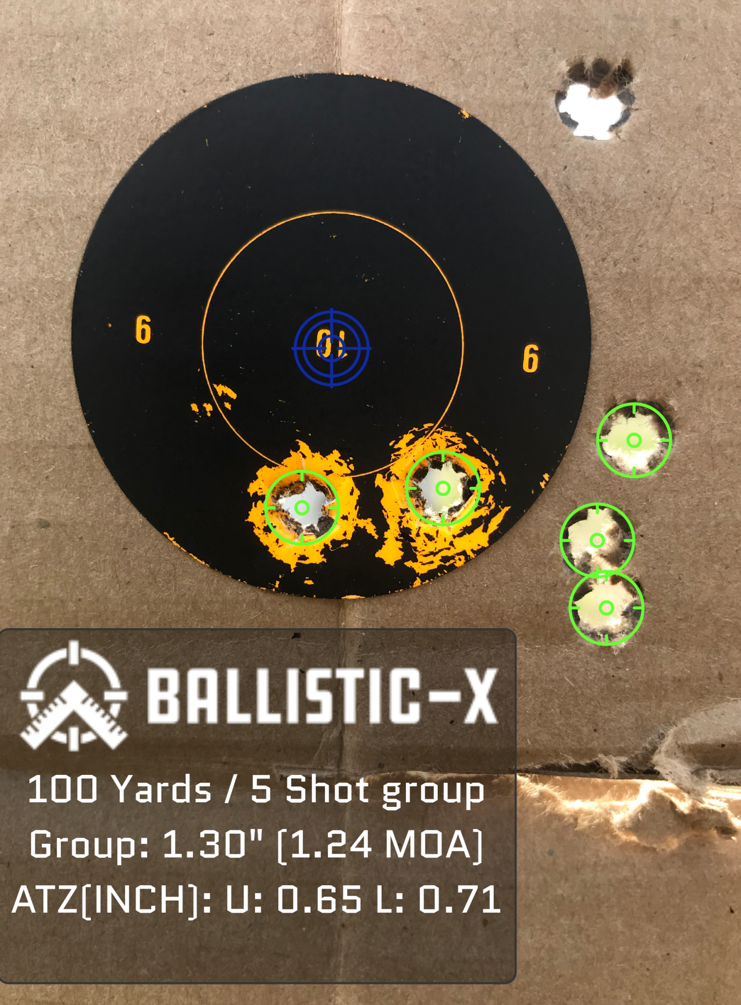

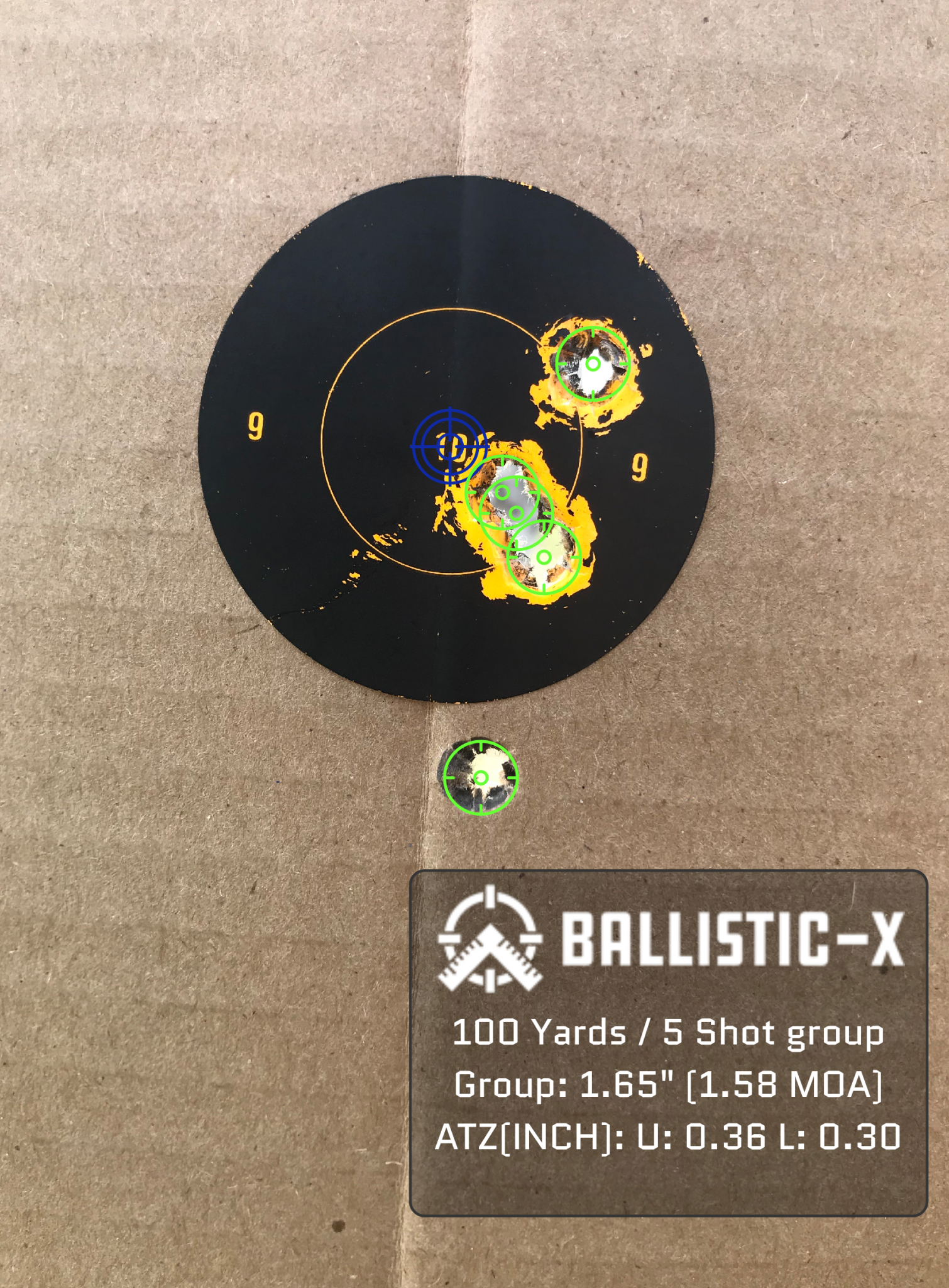

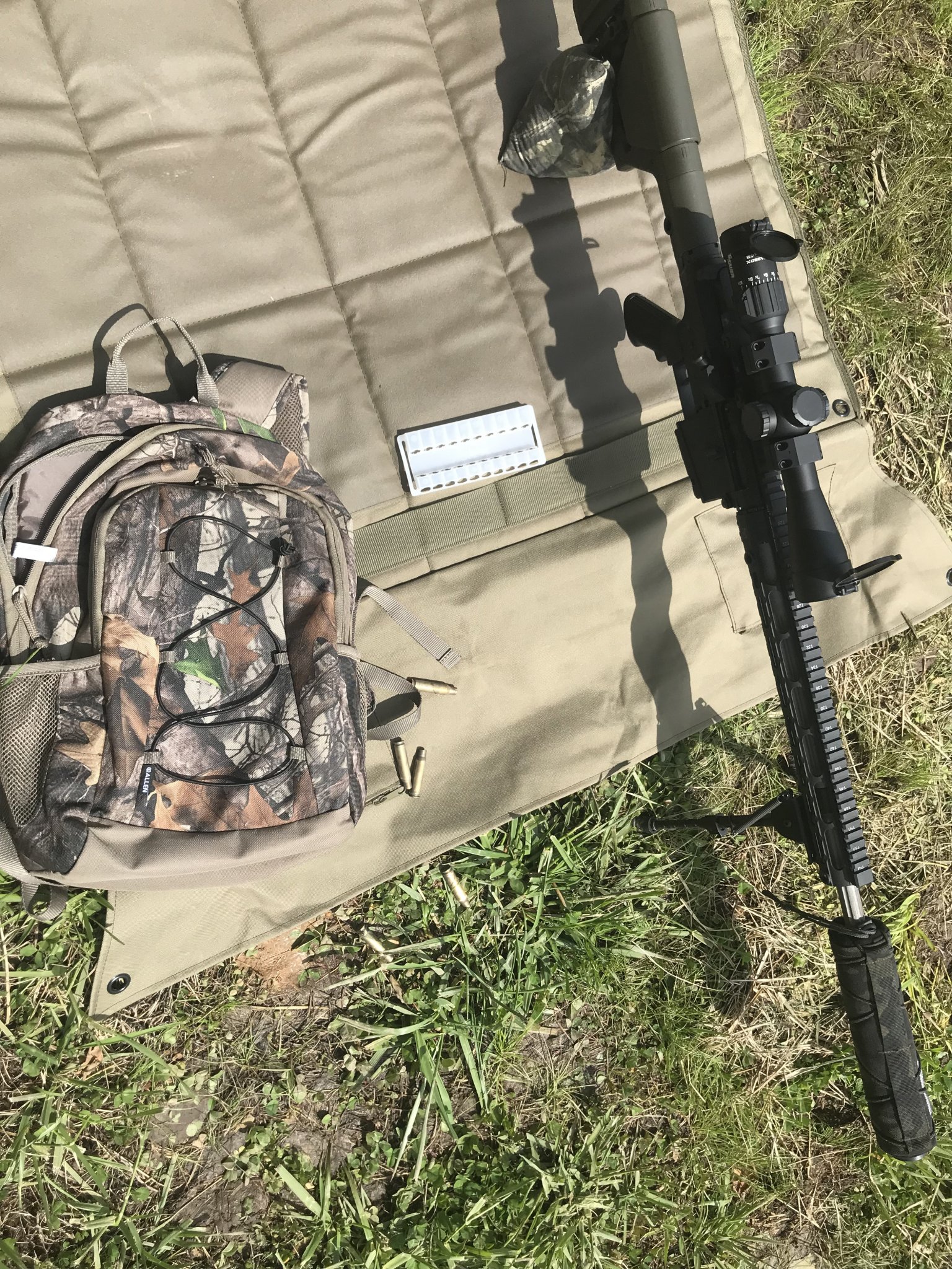

Got the 6.5oz buffer and spring in from Heavy Buffers. Got some 168 gr FGMM ammo from my cousin and took the rifle out to test it. Ammo fed fine into the rifle. I'm starting to wonder if my hand loads were causing the problem. the 168 gr are 2.8" long and I had my 175 gr hand loads a 2.81" long. They did not drag on the mag but Im thinking that was just to close to the mag to get them to feed correctly all the time.
Now ejection does not seem to have changed. As you can see in the picture there are 3 cases next to my bag and 2 just right off the mat. These are exactly where they fell. The bolt is not locking back on the last round. Not sure if its short stroking or a mag issue.
As for the 168 gr FGMM it has shot the best 5 round group out of this rifle. My hand loads with 168 gr Nosler CC and 175 gr Nosler CC where shooting around 2 - 2.5 moa. Not sure if these barrel just doesnt like the bullets or my powder choices are just to slim right now.

Frankly, where your brass is falling is great... if it was flinging it considerably further I'd worry about.
As for the not locking back... consider putting the OEM recoil spring back in and trying that with the 6.5oz buffer
And how many rounds through it so far?... as in it may need more break in.
I assume you can manually lock the BCG back, with a empty mag.

I mean I like that the brass is falling there. I don't have to go find it. Just off that chart shown above that is not where the cases are suppose to be going.
Ill try the OEM spring next time.
Probably 100 so far on the barrel. The lower and bolt came from an LR-308 that someone took apart to steal the High Rise upper.

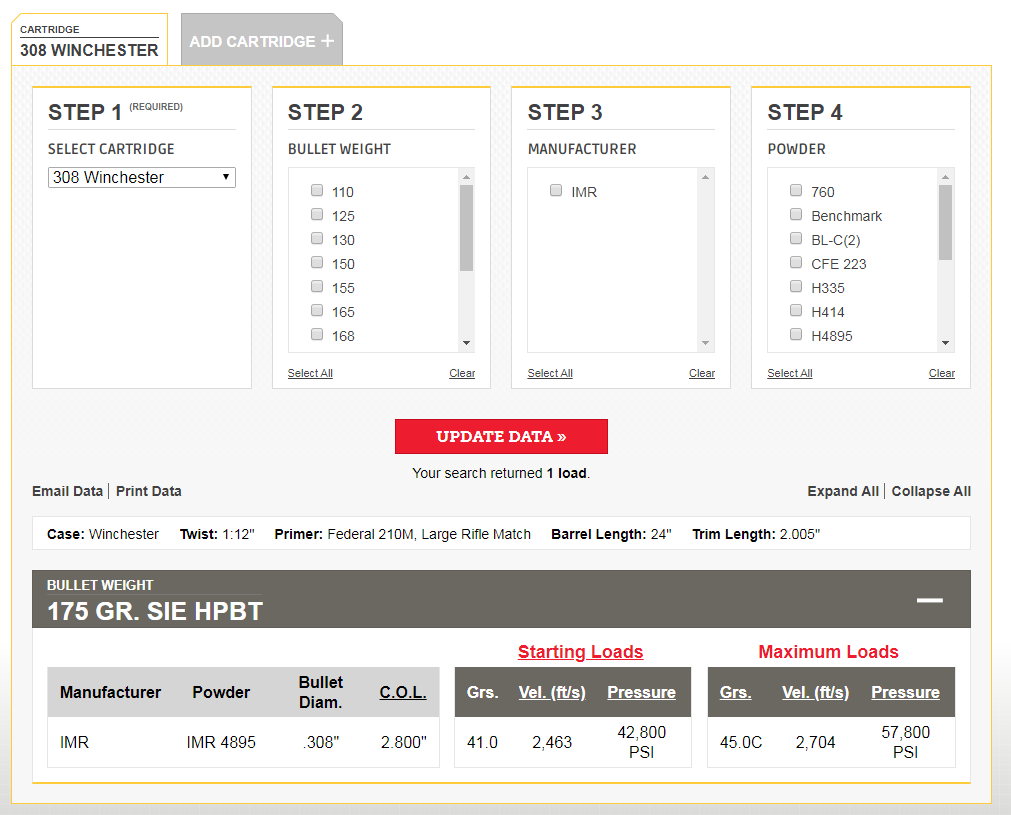

What's your hand load recipe? I load both the 168gr & 175gr Nosler in LC brass with CCI 43 or WLR primers over 43.5gr & 42.4gr of IMR4895 respectively for my LR-308.
I just broke out the IMR4895 this past weekend to try. 175 gr Nosler CC Hornady brass with CCI 200 primers and did couple loads between 37.5 and 38.5 gr of IMR4895 but Im pretty sure my 2.81 OAL caused the cases to feed wrong and messed up a couple rounds. You are over what nosler says for max on both. Do most company keep their load data toward the lower end? I tired some BL-C2 behind the 168 gr CC because that is the recipe I use for my R700 but when I got around the 44.5 grs that I use in the 700 I was getting pressure signs. Or the brass I was using was not in very good shape.
That Nosler data is well under where people normally run with a 175gr & IMR4895.
A 168gr SMK over 41.5gr of IMR4895 in LC brass is a well know highpower load for the M1A.
The nodes tend to be ~1.0gr apart with the highest usable node around 44.X for commercial (Win or Rem) brass with Mil (LC) brass around 43.X

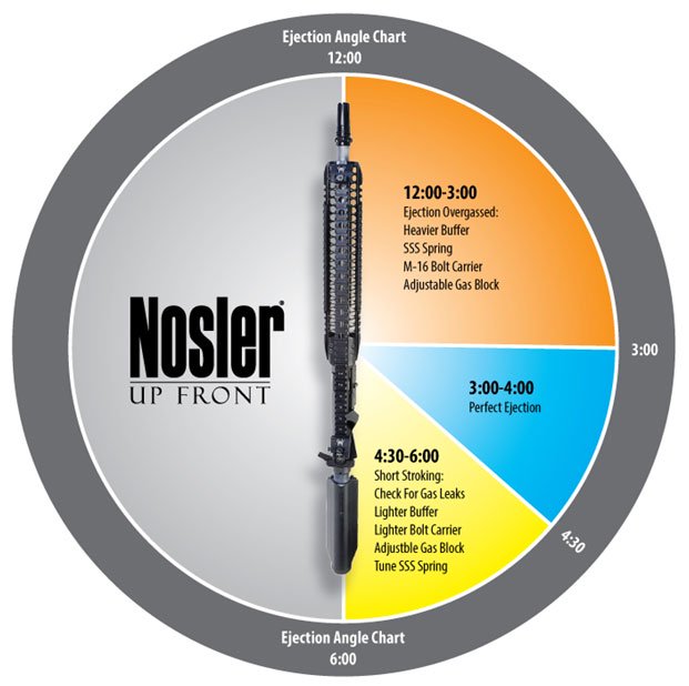

Bear in mind, and judging by the "distance" your fired cases are probably very lightly bouncing off the brass deflector.
If the fired cases were attempting a low altitude earth orbit.. I'd be concerned about the "o'clock" position.
But seriously, that short of a distance, implies a relatively soft ejection.
And if you happen to have a spare ejector spring... clip a coil from it, I'd bet your "o'clock" position would change.
Thanks, Ill keep all this in mind trying new loads for it.
Yeah they are. I noticed that but I guess I forgot about it. They are not all dinged up tho so that is great.
