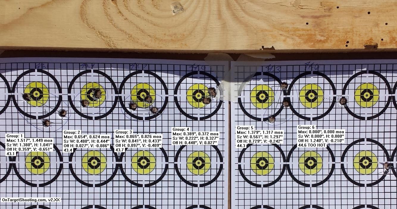

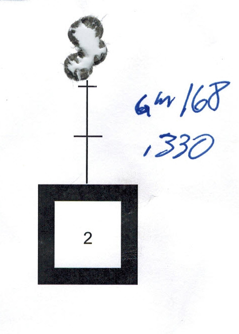

Sorry for the lack of update guys. I didn't want to update till I got everything in check, and I've been busy lately. Here's what I got so far.
The rifle groups 175fgmm consistently in around 3/4" which is great in my eyes for factory ammo out of a semi.
As far as reloads go, I've tried and haven't found anything consistent with military brass, 175smk and varget. So my next step is to try different brass and also to buy 168 Amax as I've heard those are accurate out of semis (or most rifles for that matter).
So I haven't found a good load yet and that's why I haven't updated. But since fgmm groups pretty good consistently, that tells me that atleast the rifle is 'consistent' and I just haven't found what it likes.
I have to buy some Amax bullets (if I can find them) and then I'll be able to update you guys further.

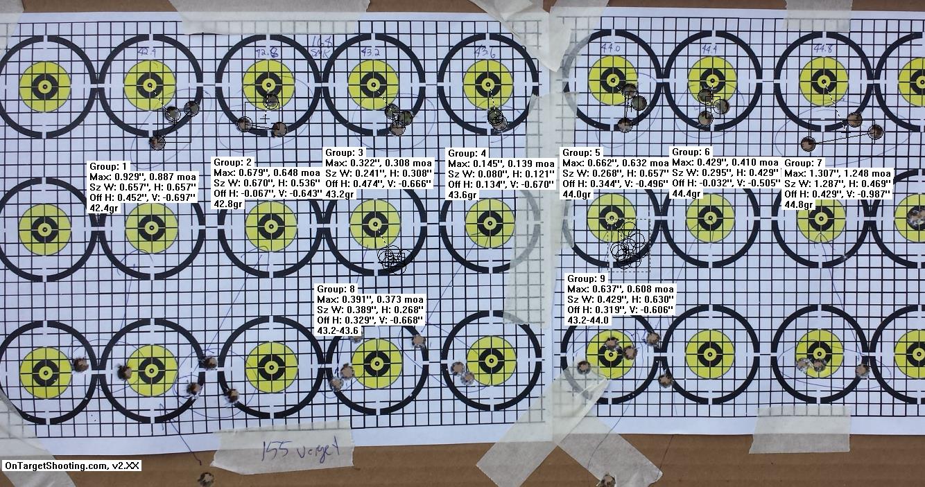

Alright, so I don't have a final update yet but I wanted to keep those that are following this thread up to date.
As I said earlier, 175smk loads did not work out well. Here is my OCW from it:
As you can see there really is no apparent OCW node with consistent POI's across charges. The 44.0gr charge obviously grouped well here, so I tried exploring that further, but it led to a dead end. If the charge wasn't exactly right on, groups opened up large. Nothing grouped better than 3/4 moa consistently.
So I moved on to trying 155 palmas and 168smk's. Here is the result:
The 155's I didn't even put through my grouping program because of how bad they performed. It was so bad that it was hard to even tell which shots belonged to which group! The shots across the top of the paper is the 168smk OCW. FINALLY some great results. 43.2gr to 44.0gr have very similar POI's and that's where the node is. Looks like 43.6 is the center of that node, which coincides pretty perfectly to the tightest grouping group as well. Group # 8 on that picture is me overlaying 6 shots of 43.2gr and 43.6gr onto each other and the result is .37MOA. Group #9 is me overlaying all 9 shots of 43.2,43.6 and 44.0gr onto each other and the result is .6MOA . That is EXCELLENT if you ask me. Thats 9 shots with the bullets varying by almost as much as 1 grain and still almost 1/2moa. I will be loading up 20 or so at 43.6 and testing it at the range to confirm the results. If all goes to plan, it looks like I found something this rifle likes and its gonna be a hammer.
I wish the 175's would work since they can be stretched out further, but I doubt this rifle will be seeing 1k yards much anyways, so its not a big deal. I might end up trying some 168AMAX's instead since they don't have transonic problems, but thats later down the road. I can't wait to see the results of my next range trip when I hopefully confirm the load and put all this behind me!
