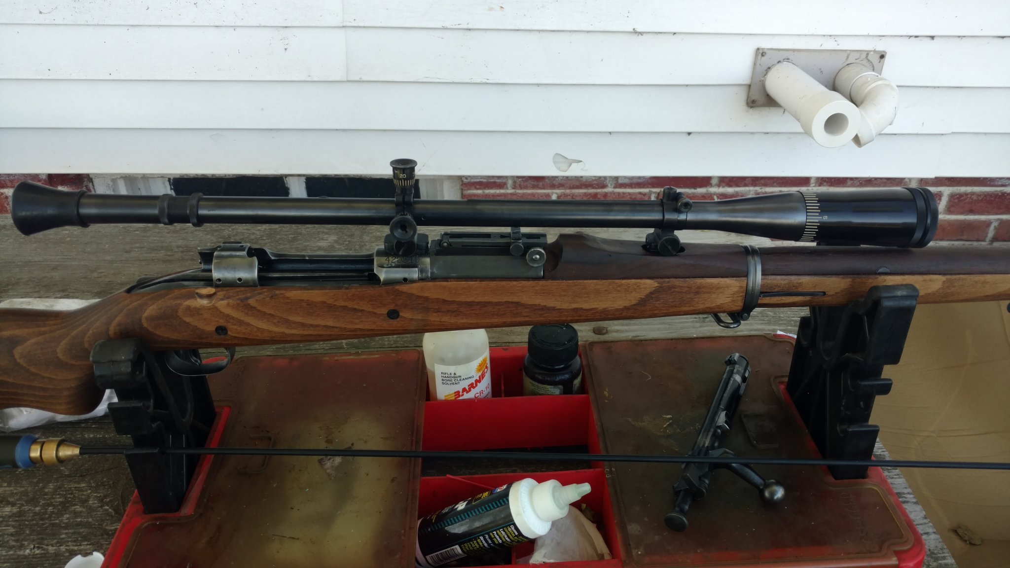

Lyman TargetSpot question
pitspitr
Nov 13, 2020
196
188
Central Nebraska

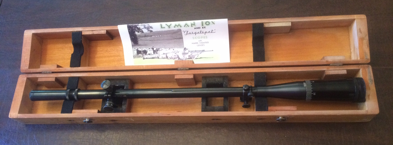

I was going to post this question in P Mac's M-70 thread, but thought better of hijacking it and decided to ask in a separate thread instead.
In the last few months I've bought a couple of commercial Lyman scopes. The latest was just last night. I bought a very low 4 digit serial# 12X Super TargetSpot on Ebay for what seemed like to me a very low price. Obviously, I haven't held it yet so can't offer any more information than that.
The other is the root of my question. It is marked "TargetSpot," not "Super TargetSpot." It came in a nice old factory oak carrying box that is also marked TargetSpot. My question is this; This scope is marked 15X but it was my understanding that Lyman only made the TargetSpot in 6x, 8x, and 10X, but that the Super TargetSpots went up to 20X. Is this some kind of early or transition STS or was the information I had about the TS simply incorrect?
Thanks in advance for the information. This place is simply incredible for the amount of knowledge here
Targetspots were 8, and 10. Junior Targetspots, were 6, 8, and 10. Super Targsetpots were 10, 12, 15, 20, 25, and 30. The ocular's were interchangeable and could be purchased separately. Someone upgraded by purchasing a 15x ocular.
Would be awesome if the origin eyepiece was in the box too, but someone’s grandkid probably used it to play outside one day and it’s gone forever….
So what you guys are saying is that if I could find an 8x ocular I could down grade it and make it legal for vintage sniper matches?
Yes.

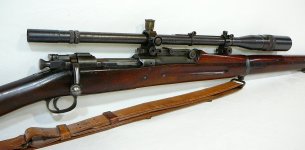

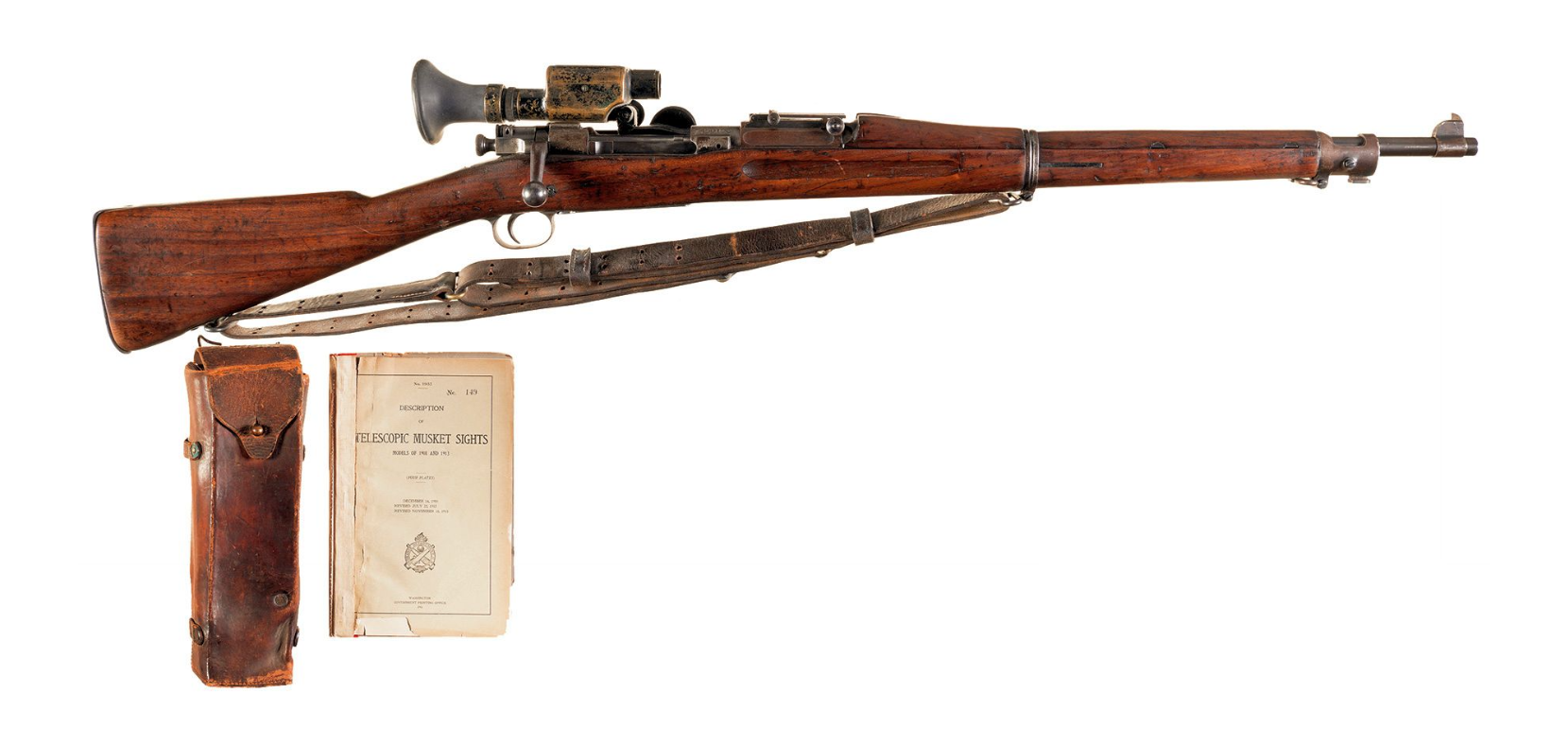

Table 7-- Vintage Sniper Rifles and Scopes Rifles Scopes United States:
United States: .30-06 cal. 1941A1 Springfield (C stock, Standard 1903 sights with Unertl type scope on Unertl type mounts and bases):
Winchester A5, Winchester B5, Winchester B3 USMC original issue: Unertl 8X Sniper Telescope Non-issue scopes: Unertl, Lyman or Fekker 6X or 8X scope with up to a 1.5” objective; Leatherwood Malcolm 3X, 6X or 8X Note: All scopes must have external adjustment and no recoil spring

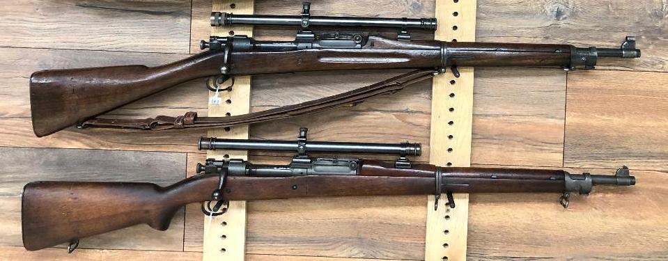

Thread Hijack - I have a really nice 8x Junior Targetspot, #5978. I've been trying to find a date of manufacture / serial number list on the net with no luck - anyone have an idea the DOM or happen to have the Lyman serial number zip file that used to be floating on the web?
TIA
A couple more questions.
1 What is the difference/reasons for a different model between the Target Spot and the Super Target Spot?
2 Who word be the go to vendor who might have an 8X ocular?
Defender,
No problem with the Hijack. I learn stuff from other peoples' questions too! :)
I do also, appreciate it.
FWIW - You may try the CMP forums and eBay, but they may be hard to locate or command a higher price due to people in the same situation.
If you could find a vendor to make 8x eyepieces that dude would have plenty of short term business. This is probably an opportunity for someone, but they’d have to be expensive as there is going to be limited clientele and once they have their scopes converted it’ll dry up forever.
The 8x Malcolm availability would hurt as well. These are turning out to be a pretty good scope. I have some issues with the locking screw on the elevation turret but otherwise it’s solid and affordable.
I don't know the difference b/t a TargetSpot and SuperTarget Spot. I had a 10x SuperTarget Spot that I sold a few years ago after I replaced it with a vintage 10x Unertl scope on my M70, but in retrospect I think the Lyman was a better/brighter scope and I should have kept it. I think it's objective lens is slightly bigger than the Unertl. Attached is a pic, and I had a manual for the regular Target Spot that I had found on eBay. I have not seen any rear oculars for sale re these old scopes, but I suppose its possible. (I use a Leatherwood USMC replica 8x scope on my M1903 sniper, it works well).
Thanks guys. I knew this would be a good place to ask.

The new to me 12X STS is in hand ( well actually it's mounted on the '03 /1941 replica) . Please explain the parallax adjustment scale. It only goes to 200 but I want to set it at 600. Is the scale on the ring on yards?

Probably about the same reason they don't allow a straight stocked 1903 with an A5 Winchester.
If someone showed up and wanted to shoot a straight stock 1903 with the proper A5 vintage optic, I'm pretty CMP staff would not turn them away, as long as the rifle passed the trigger pull safety test. Everyone uses a "C" stock because it has better ergonomics and you can get them in new condition. The old straight stocks are antiques, but if someone showed up with either of the rifles in the attached pic, I'm 99% sure they be allowed to compete. (Although not recommended w/ such rare and fragile scopes!). BTW, one of those rifles was sold via a CMP auction w/ the vintage scope bases still intact...

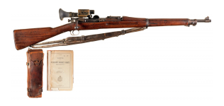

I'm collecting parts to build a replica 1903/A5.(I accidentally won an A5 on eBay) CMP said they, the straight stock, aren't currently allowed but I could petition them to change the rules, so I did
