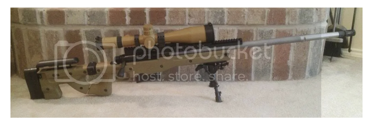

The M110 can was designed to interface with the m110 flash hider. This is different from the mk11 mod 0 suppressor which was designed to interface with the barrel itself.
Eta: here’s an example

what @nn8734 said. It is very, very exacting. We make the M110 barrel for the M110 rifle, and the distances have to be precise. The Mk13 Mod5 did this with the Mk11 can. I have never seen or heard of anyone doing it with the M110 can, but the pic above is spot on. The can will need to lock to a true KAC M110 flash hider and then lock to grooves at 0.75" apart at the center of the elipse from each other, for the gate to come down upon the barrel.
The barrel smithing is excruciatingly precise, and if the barrel smith gets it wrong, the entire barrel is toast, and you have to start over, which is why most barrelsmiths will not do it, and those who will charge a fortune, as they have to bake in some probability of fucking up the barrel and starting over.
