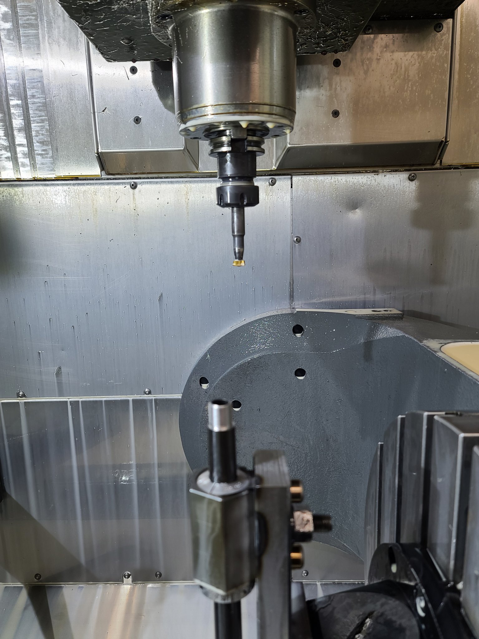

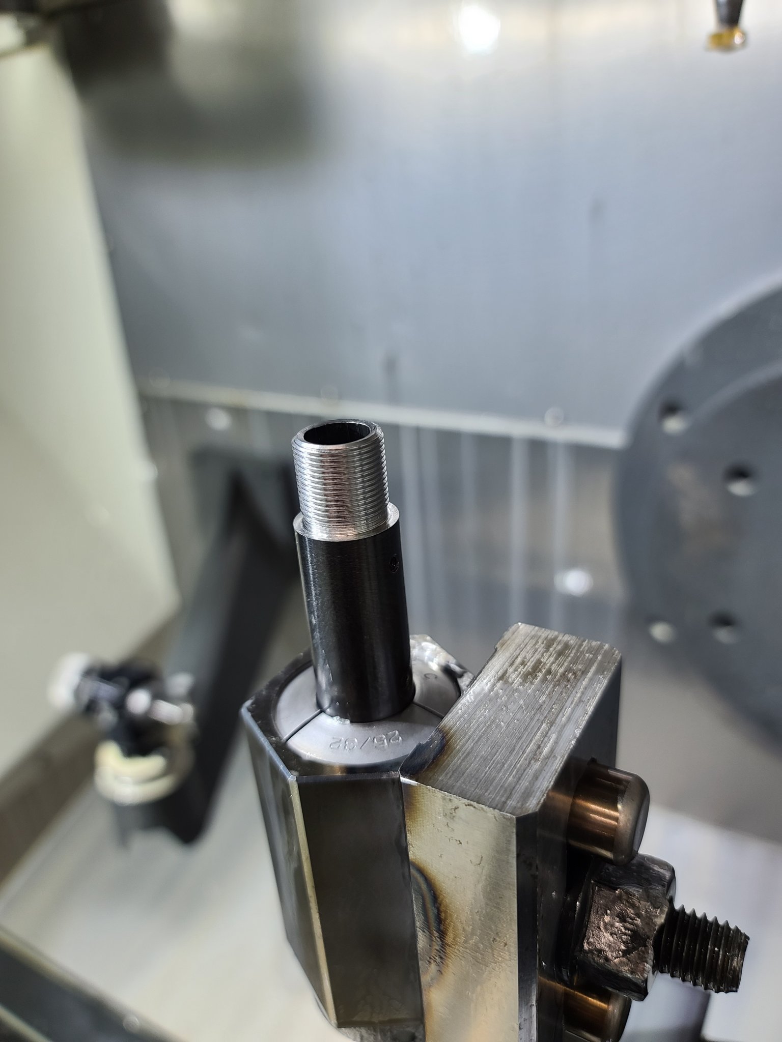

    How I've been doing this now for the last couple years. The probing routine borders the absurd and takes almost 5m to run, but they come out nice.
    Ripping lever guns apart to thread a muzzle is something I equate to invasive dentistry minus the shot in the gums.
    So glad I took the plunge with this machine a few years back. It literally changed everything from a GS perspective. The best part of this machine is the HUGE glass window. It's the ideal "white board" for jotting down notes. Haas gets a shitty review from time to time by some folks, but they nailed that one!
