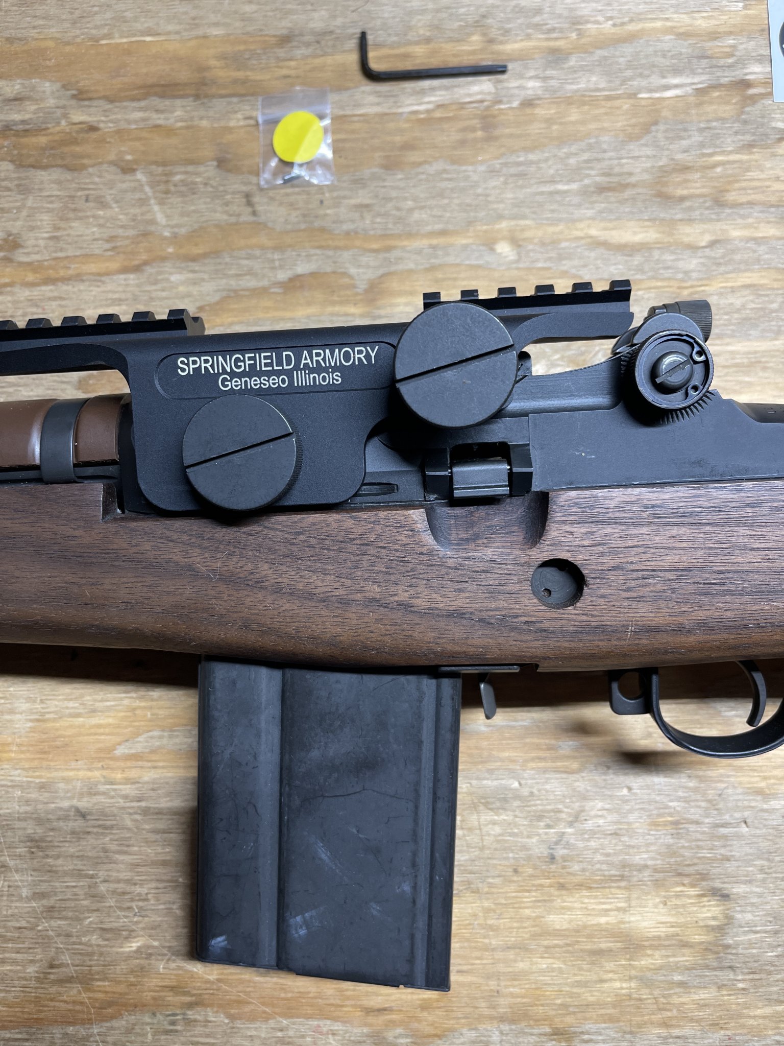

    Just picked up a Springfield national match, and it’s got the SA scope mount on it, I’m going to run irons for the foreseeable future. The install looked pretty detailed… is the removal as simple as undoing these two big screws?
    Reactions: Moose

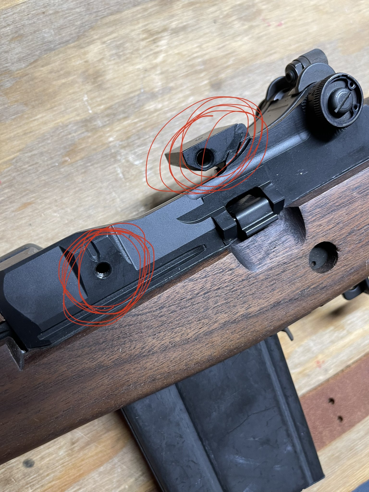

    Left hole, you can prob install a set screw from the hardware store.
    Also, can’t see the top of the stripper clip guide on the right in your pic but is that an Allen head fastener holding it onto the receiver?
    ETA: it’s not an Allen head but the roll pin securing the stripper clip guide to the receiver. To remove, you just take the barreled receiver out of the stock then drive it out.

    That’s the plan. I’m going to call SA Monday and get a manufacture date on this one. I think it’s older.
    I want to take the action out so I can add a bipod stud, but I’ve read that it’s not good to remove it in the glass bedded models
    You can take it out of the stock just be gentle about it and to give it a good cleaning you should take it out of the stock.Make sure you keep the gas system and also the chamber clean.
    You don't need to do anything to the hole in the side of the receiver. In fact, if you do put a setscrew in it, you run the risk of it interfering with the bolt lug should it vibrate/rotate inward over time.
    As was said above, the rear hole is in what would have been the stripper clip guide. If you aren't running stripper clips (does anyone use them in an M14 except to load mags?) Leave it also.

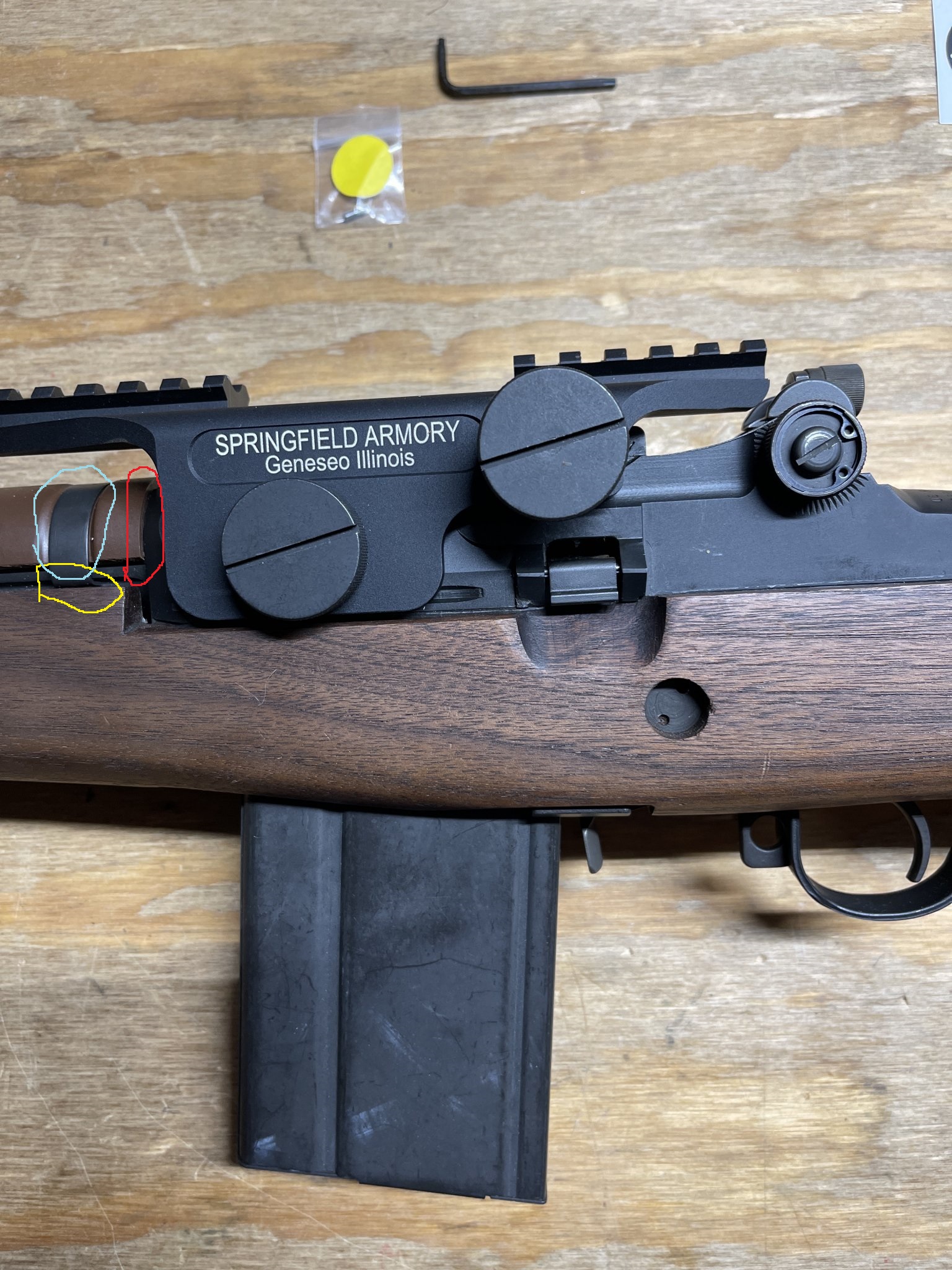

    A couple other bits of advice on that rifle:
    - Yellow circle - the handguard clip nose could be trimmed a little to help the clip be more tight against the handguard. It should also have clearance (1/32" or so) between the clip and stock.
    - Blue circle - The handguard clip should be glued to the handguard to limit handguard movement under recoil
    - Red circle - The handguard should have about 1/16-1/8" clearance from the receiver face.
    - Use some "Right Stuff" RTV at the nose of the handguard where it sits in the (hopefully unitized) front band/gas cylinder and on top of the barrel under the handguard at the back. This prevents handguard movement under recoil.
    - Check clearance for the oprod from the stock. Shouldn't be any dragging there either.
    - Seal the stock and put a good finish on it like Danish oil or Tru-oil. Humidity will wreak havoc on your ability to be consistent with an M1A with "lumber". Plus the finish will bring out what looks like some nice grain in that walnut.
    - If you aren't obsessed with originality, scuff the handguard with a Scotchbrite pad and paint it with H-D wrinkle black paint. It tends to cut glare and mirage when shooting peeps in the hot sun of Range 4 at Quantico ... just sayin :cool:

    Leave tthe hole

    That’s what I was thinking, but watching SA’s install video, they were changing out pins and shit in the receiver
    The pin in the receiver they most likely refer to is the roll pin that holds that piece of the mount / or stripper clip guide in place. Like others have said, you’re probably not going to use stripper clips so don’t bother with it. As for scope mounts, Bassett Machine out of Dripping Springs, TX has some good feedback and options. Some mounts you can still use the iron sights if you wish. Several other mounts to read about and choose from around the net. I never mounted the rail or scope that came with my M1A many moons ago. Dewey made/makes a good bore guide for the front and there was a device Creedmoor used to offer to put in the bolt to keep it back, your rod off the bolt face, and kept the solvent off the bedding. NukeMMC has some great advice about the hand guard and sealing the stock. Mine still had the shine after I got the Hawkeye (position in a can, anyone?} off. Also may consider picking up a set of the sight protectors to protect the finish.
    Thanks for the tips! On sealing the stock, does the stain that’s on it, not protect it from moisture?
    I don’t want to do much to permanently alter the rifle.
    I am going to call SA today and see if I can get a stripper clip guide so I can remove the optic one and sell it with the mount.
