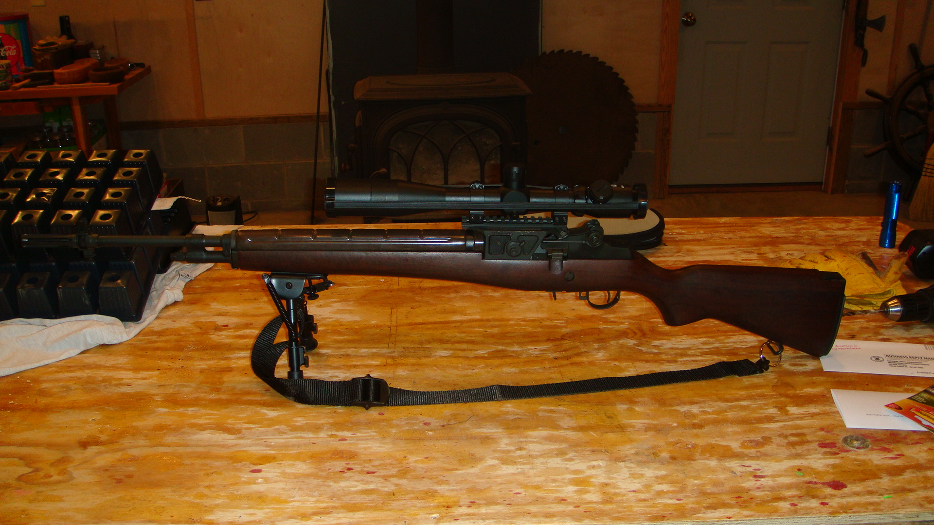

I guess I'm more of a traditionalist. I like the standard M14 look much better than the EBR or JAE stocks:
She's a SA National Match model. I plan to use iron sights just as often as a scope, which is why I opted for this one.

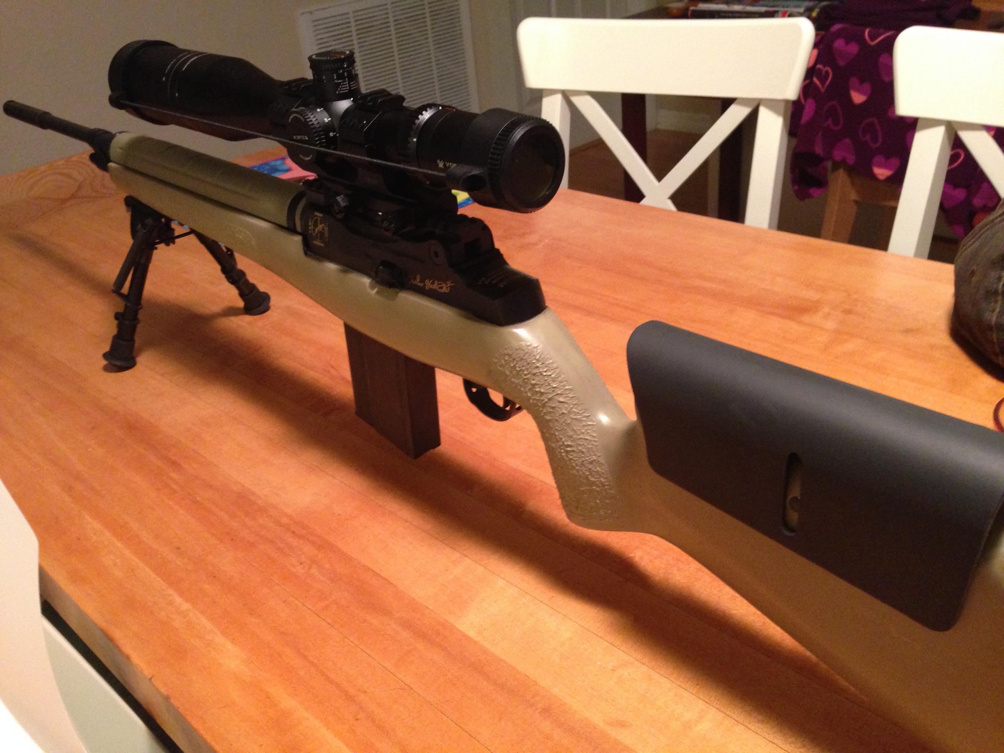

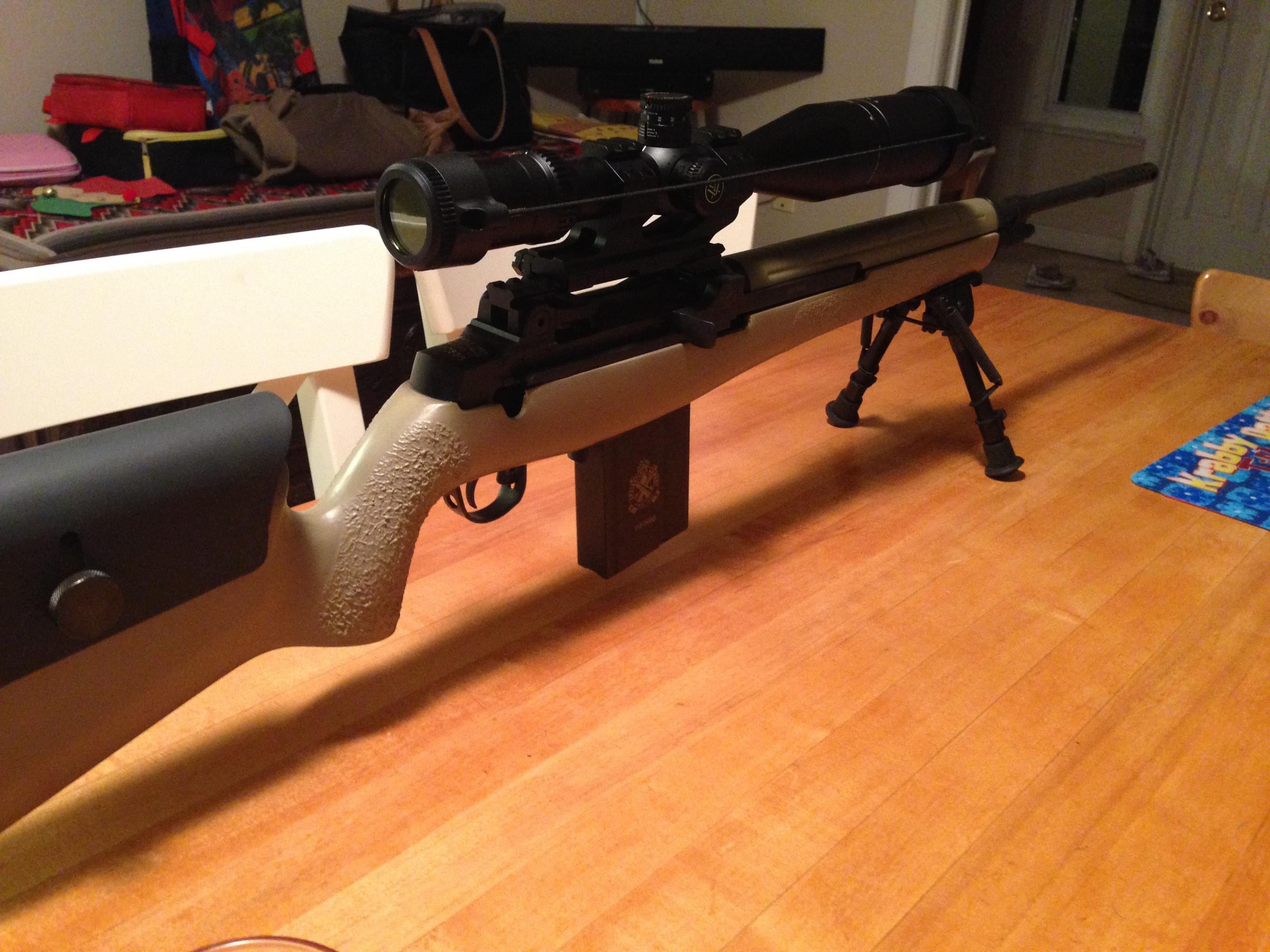

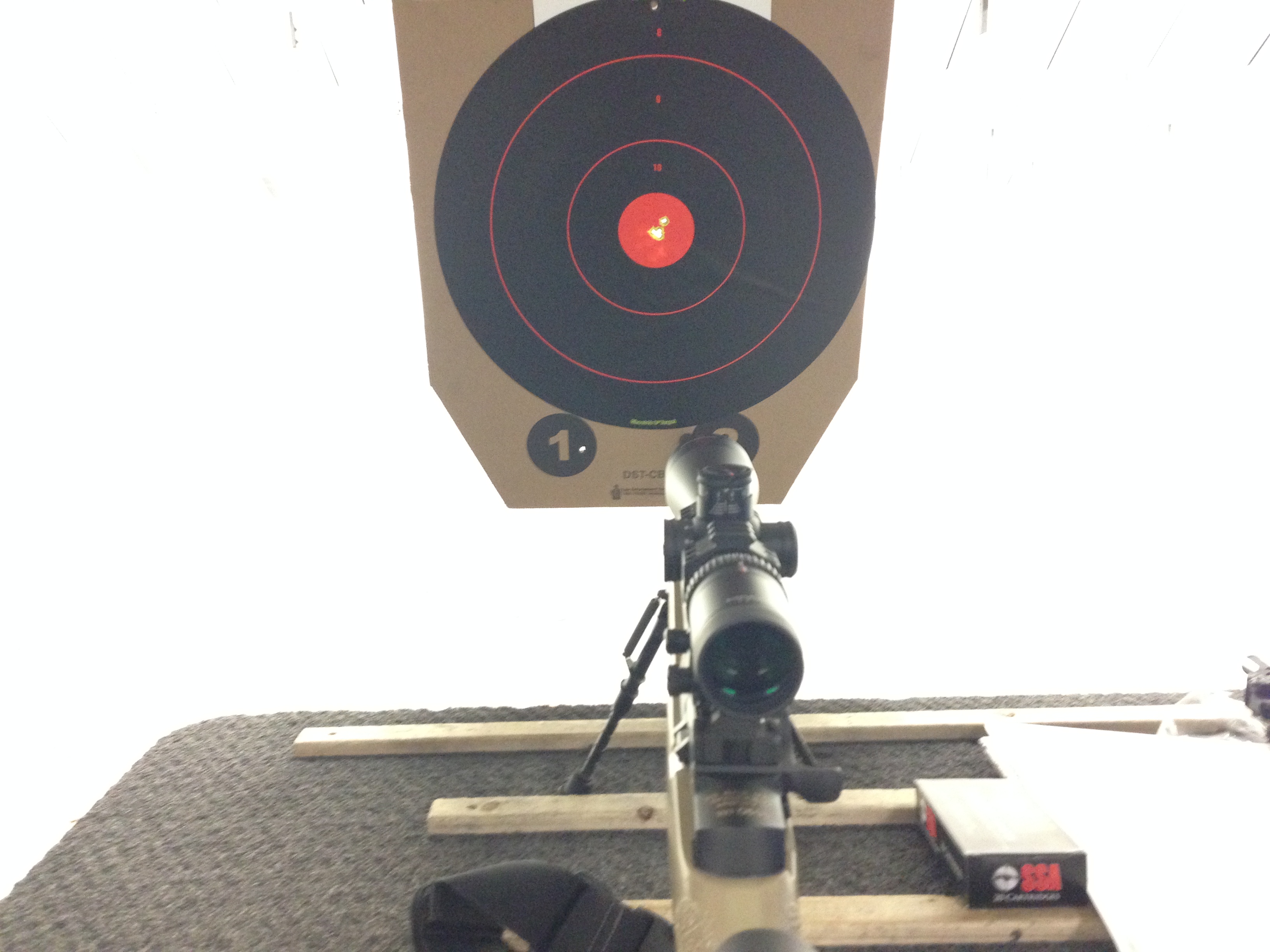

I just got into the M1A thing...
Picked up a SAI Loaded for a pretty good price. Replaced the extractor, hammer and sear with USGI parts and the gun ran flawlessly for the first time I ran it on Friday.
Groups with iron sights were 2-3 inches at 100 yards but I'm fairly new to iron sights.
I placed a hunting optic on the rifle with a Sadlak Airborne mount until the McMillian M3A gets here in August.
I really like the absence of the cheese grater spring sound from not having a buffer tube on my ear as well as not feeling the secondary recoil for the buffer tube assembly of the AR-10 I sold 2 years ago.
To all of you M1A guys I really have no experience with the platform but for now I plan to have a M1A Smith add a rear lug to the receiver and bed it in a McMillian M3A stock with a torque bolt through the stock going into the rear lug as the issue in my mind is having a solid bedding job onto a Fiberglass Stock / Chassis System for Accuracy and Repeatability.
This along with unitizing the gas cylinder and performing a National Match Trigger job what else needs to be done to the platform for enhanced accuracy??.....
Thanks....
Shim the gas cylinder. Unitize the gas system. Those 2 things can improve things quite a bit. I shimmed my gas cylinder, unitized it with some jb weld, then bedded the rifle into a mcm m3a. Bedding the rifle was a challenge, way more steps than a bolt gun but it was fun to do it myself. You could always practice on your factory stock and if you screw it up no big deal, grind it down and try again.
I know the scope isn't the greatest, but I sold my mk4 and got that one in a trade. I used devcon to bed it. I really didn't get to do much accuracy testing with it after I bedded it because I pcs'ed overseas before I could enjoy it. But in a unbedded Boyd's wood stock my loaded shot around 1.25-1.5 moa with 168gr fgmm. Why a add a rear lug? That is a lot of labor. If you really want a rear lug why don you sell your loaded and buy the best looking m1a out there, the SA M21. Rear lug, Krieger barrel, gorgeous adjustable walnut stock. If I were right handed that is what I would buy.
