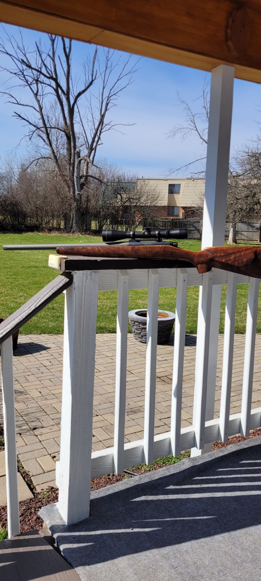

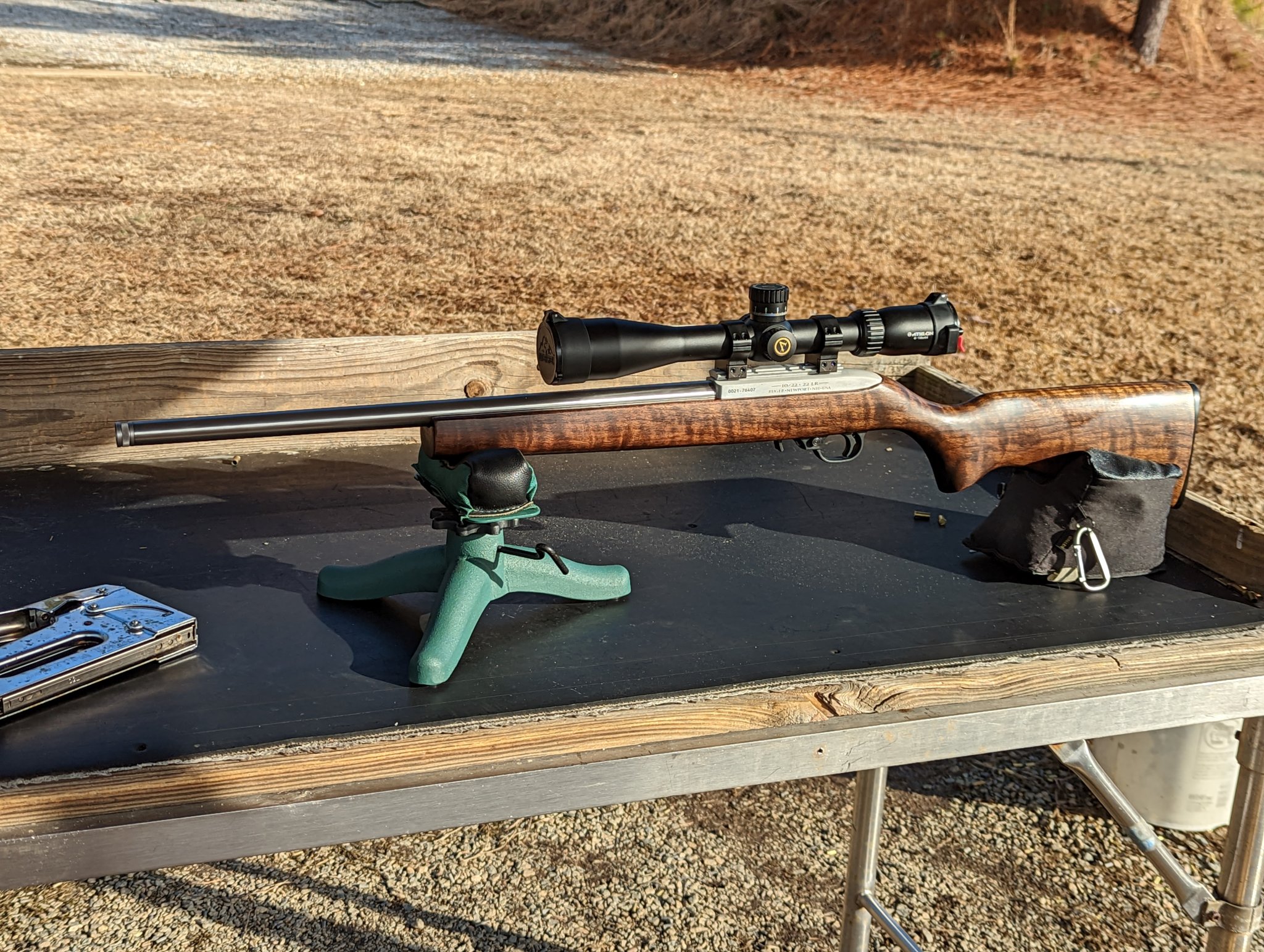

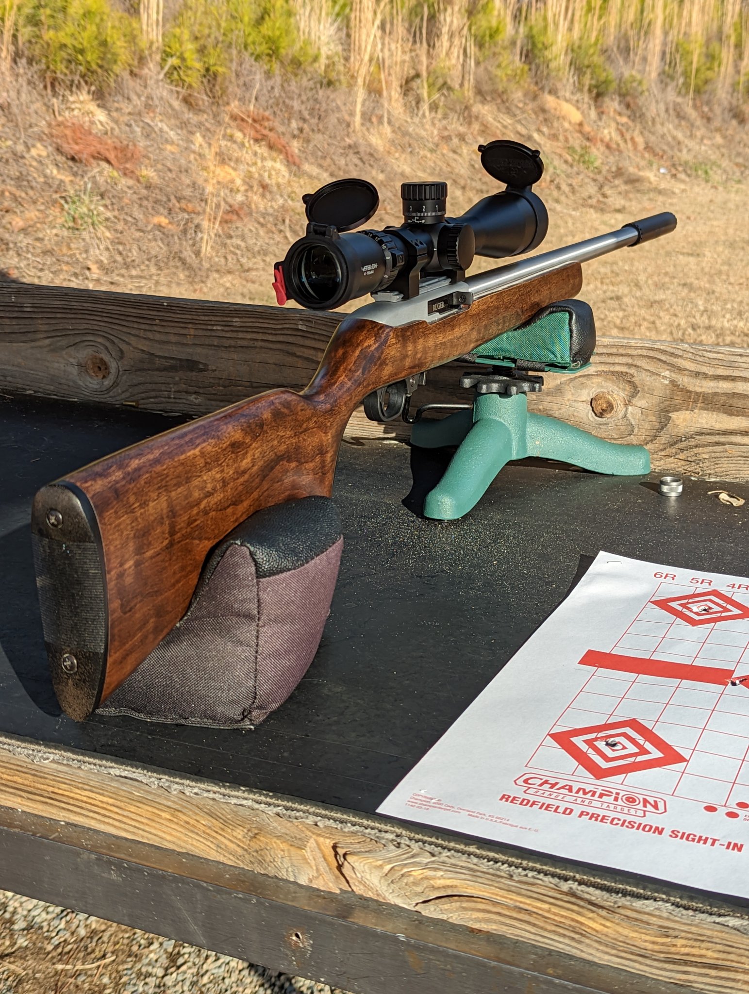

I sent one of his M40 stocks to LRI to build me a rifle…..
I did the oil finish….
LRI AI compatible bottom metal.
Comes with a flush three rounder….
300 yard target I shot with 175 FGMM

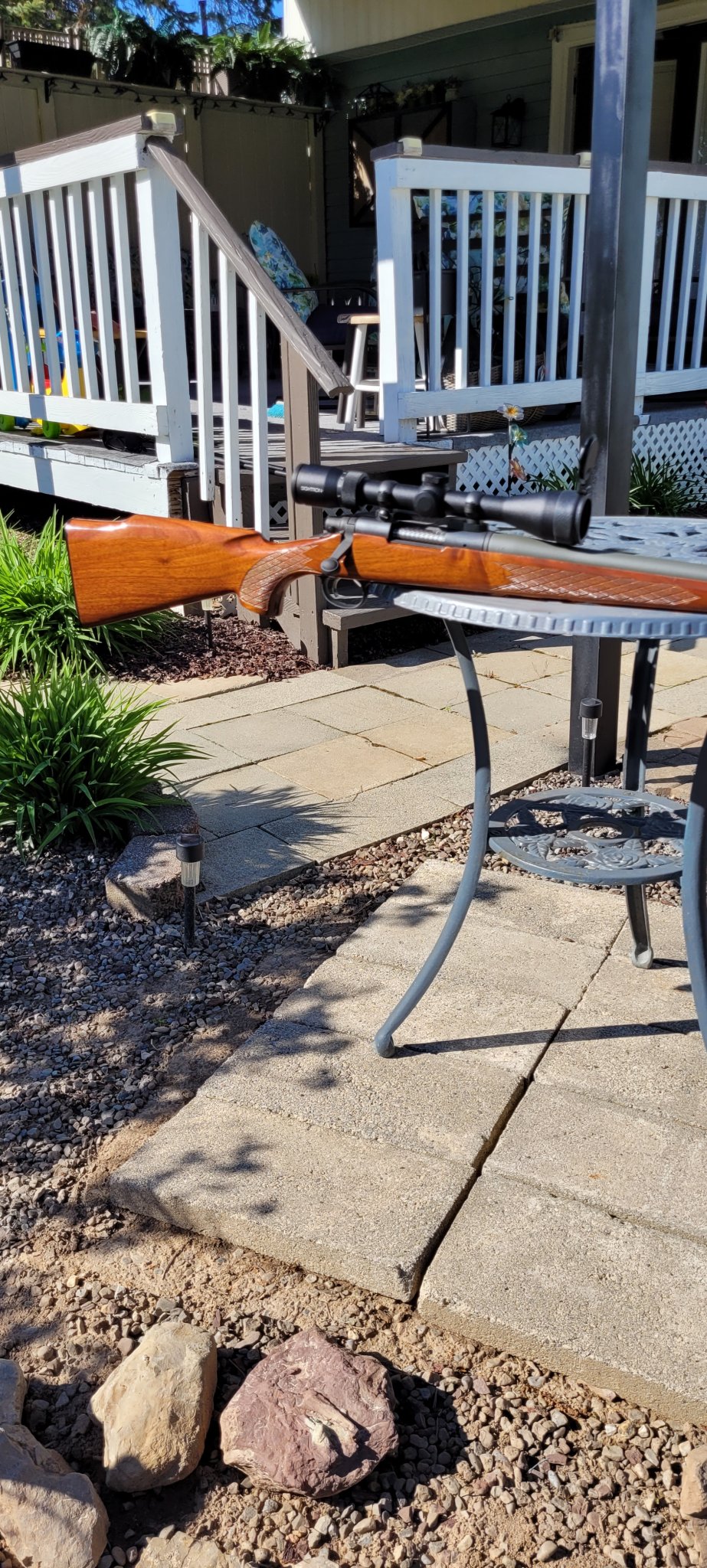

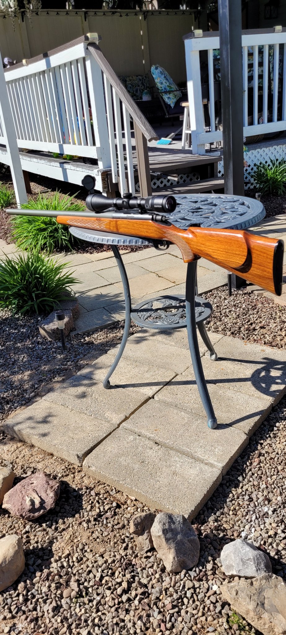

My rifle is a basic Remington 700 Varmint in .308. I had it in a synthetic stock with an aluminum bedding block that I bedded. The gun would shoot, but it was so heavy it wasn't any fun other than shooting prone. Changing to the wood stock, BDL floor plate instead of the DBM, keeping the Nightforce SHV.
Goal is to have a rifle that I could hunt with while still retaining decent 600 yard capability, and look a little like a M40.

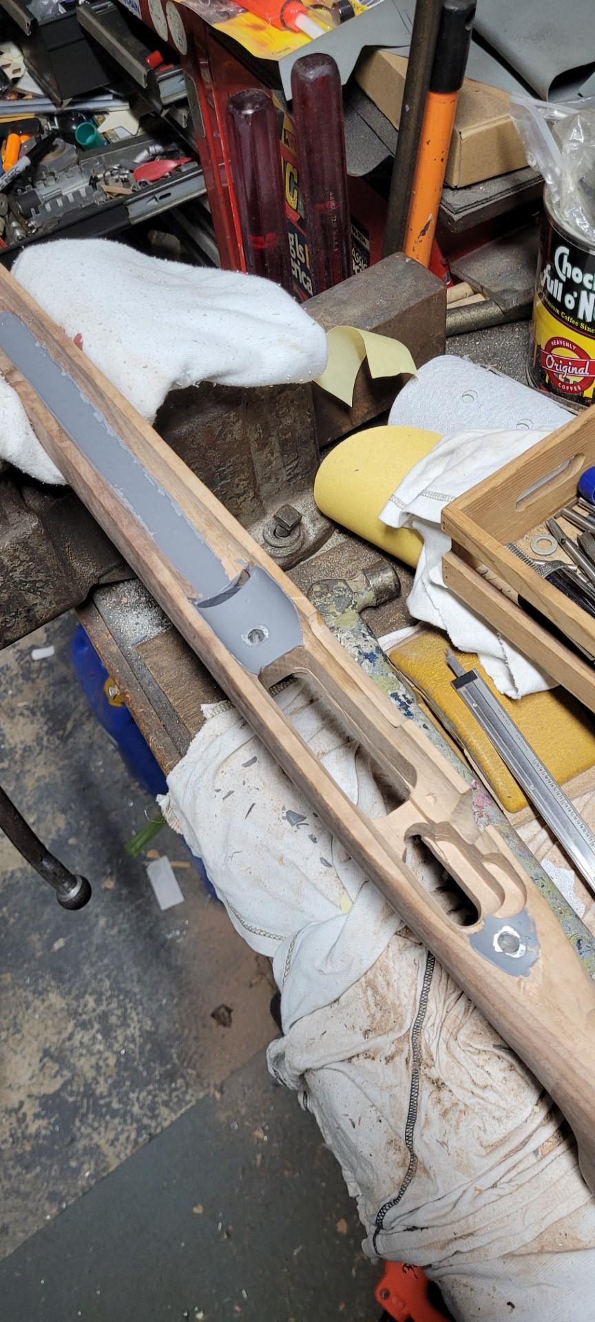

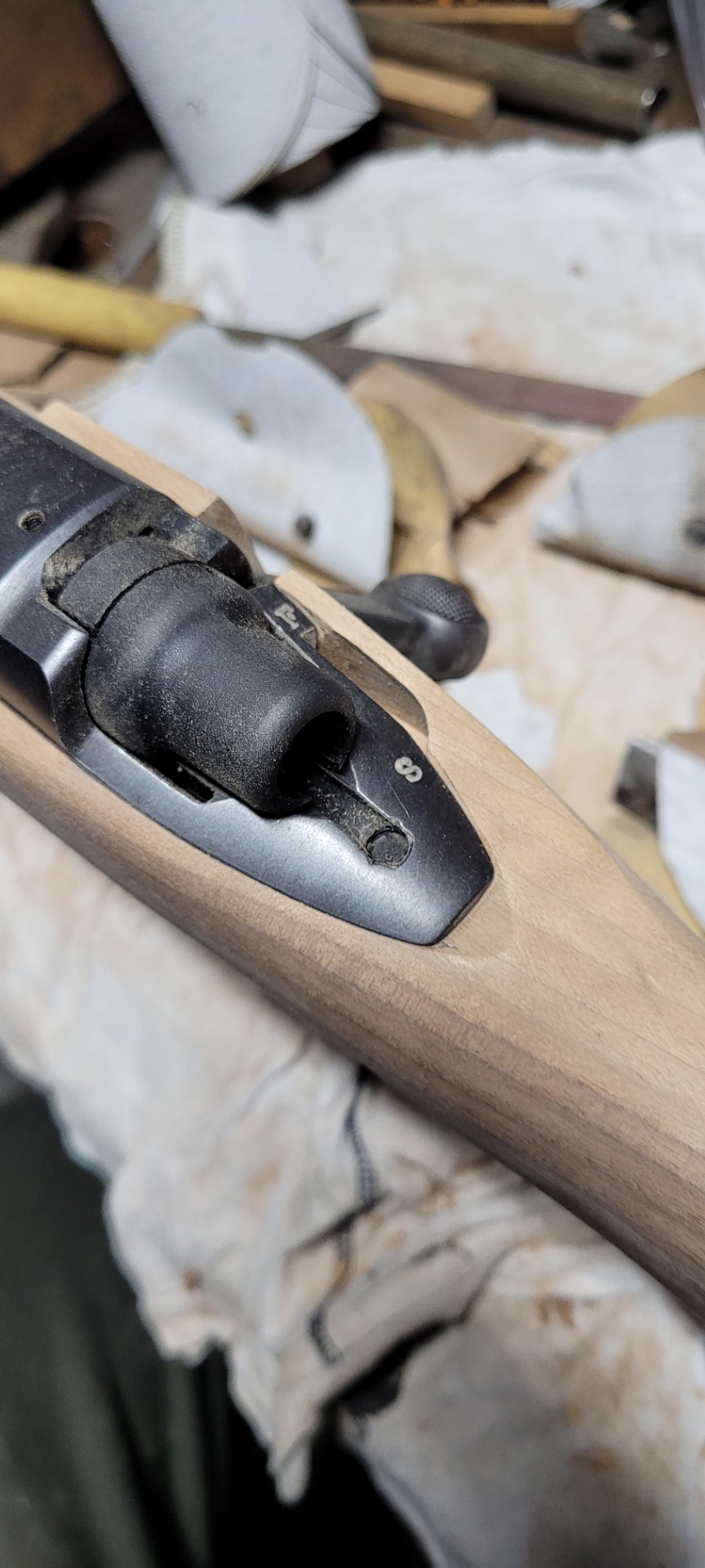

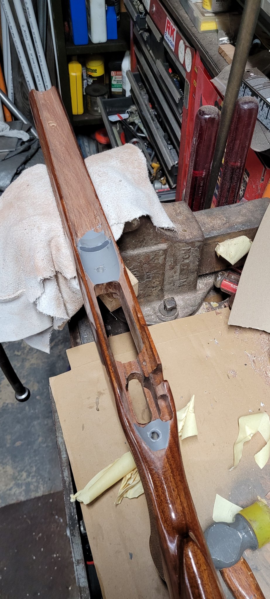

I am doing a stock from "Beever156" for my son right now. The fit is really good to the action. I pillar bedded it and now applying many coats of boiled linseed oil.
My son showed pics to a friend of his and asked me to do one for him. He wants to pay, but I have no idea what to charge him. How much do smiths charge for this work? I've re-finished a dozen stock for myself and my family members.

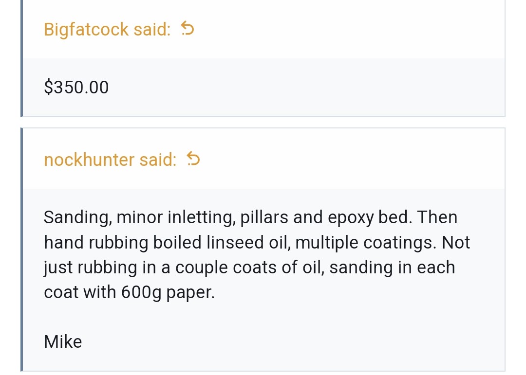

Sanding, minor inletting, pillars and epoxy bed. Then hand rubbing boiled linseed oil, multiple coatings. Not just rubbing in a couple coats of oil, sanding in each coat with 600g paper.

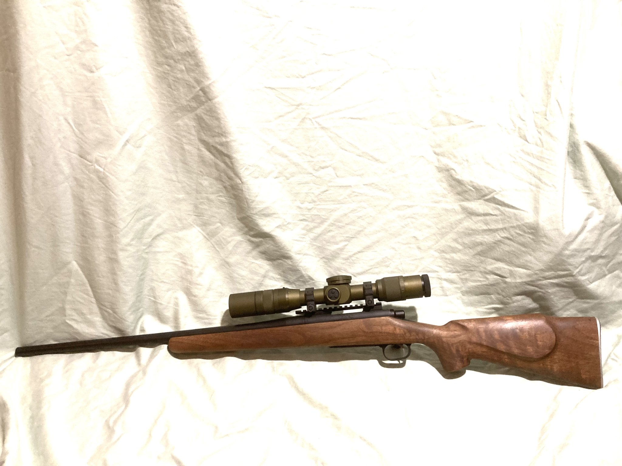

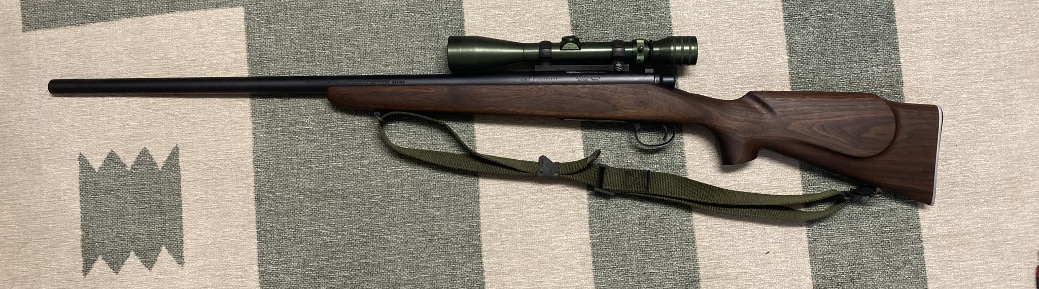

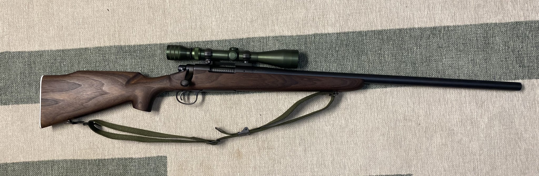

The stocks made by beever156 are nice. As others have noted, not quite accurate through the forend, but easy enough to shape, and really the best option currently available.
Here’s mine (albeit in .223 and 26” barrel for the time being)

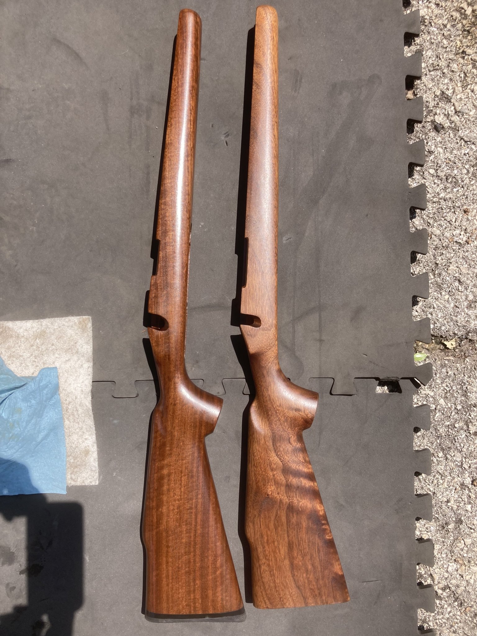

I didn’t build a clone but it is a good clone stock probably copied from one of the MaWhinney commemorative rifles….
