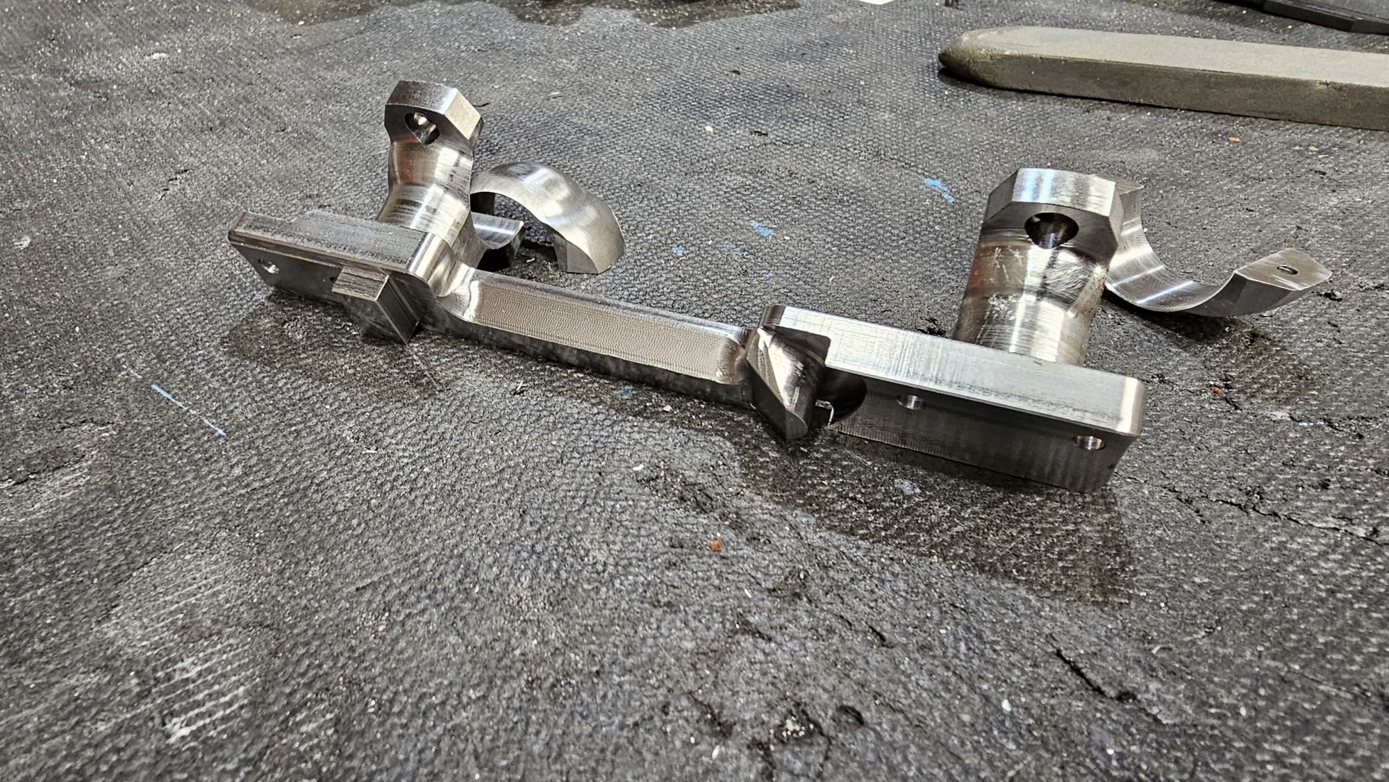

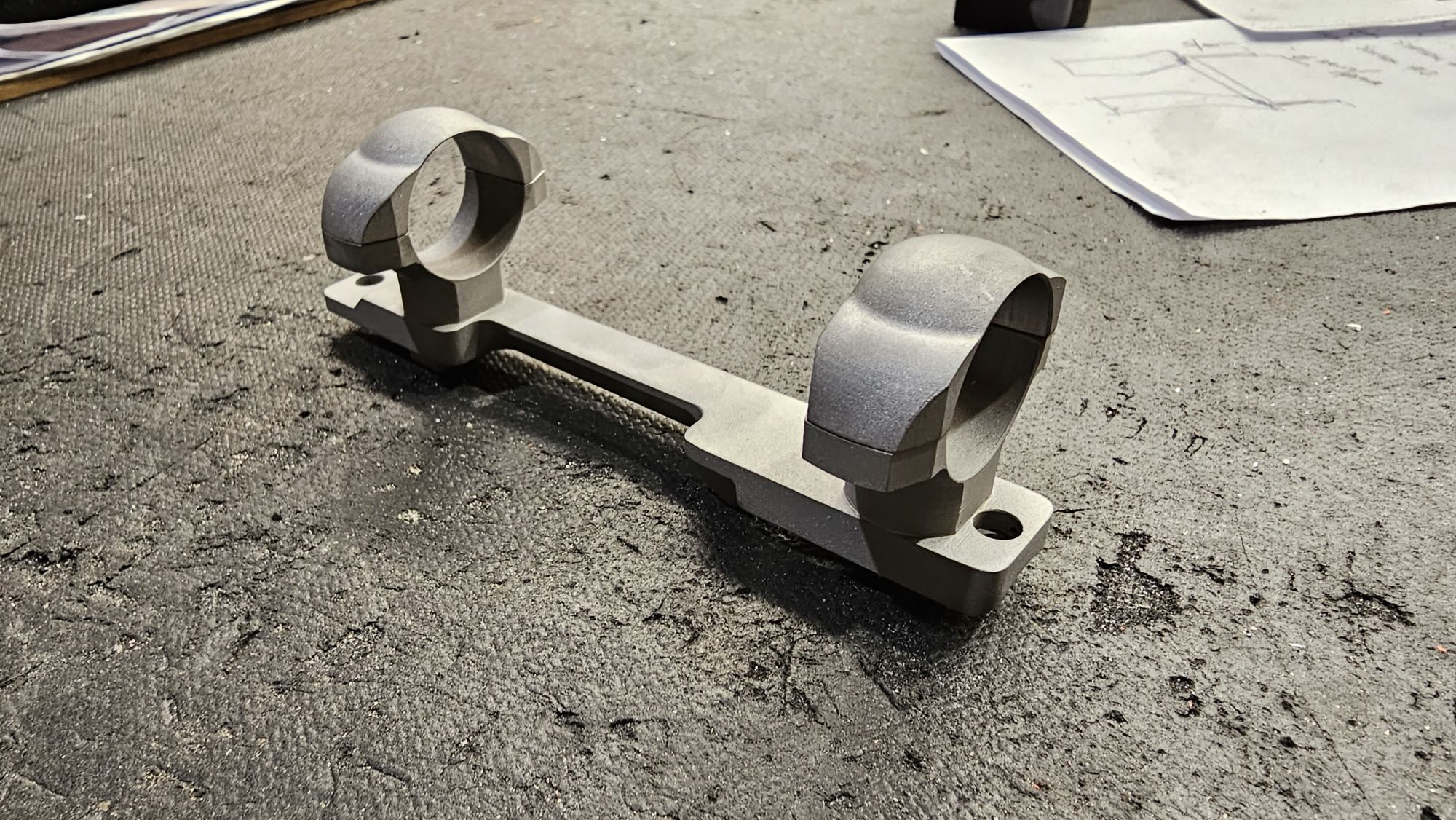

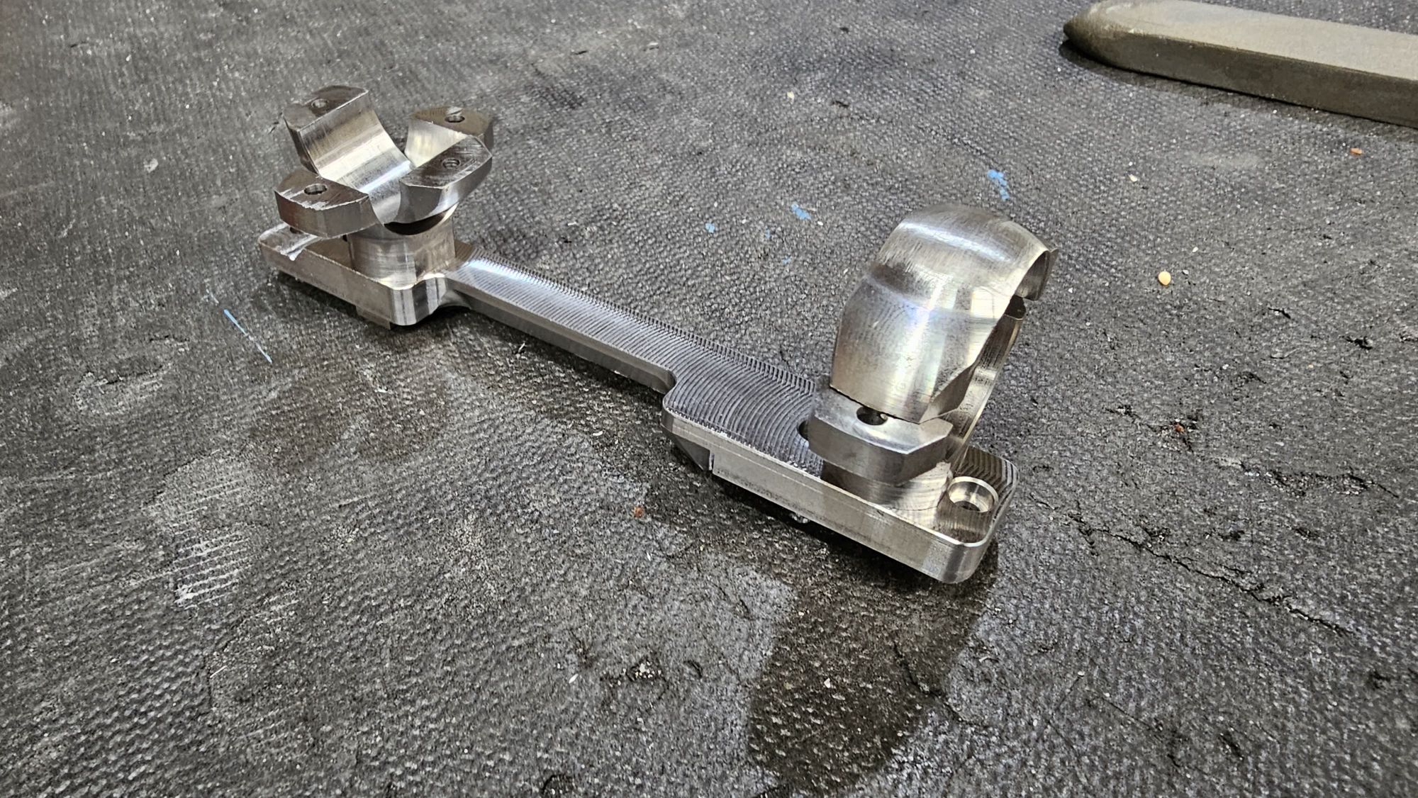

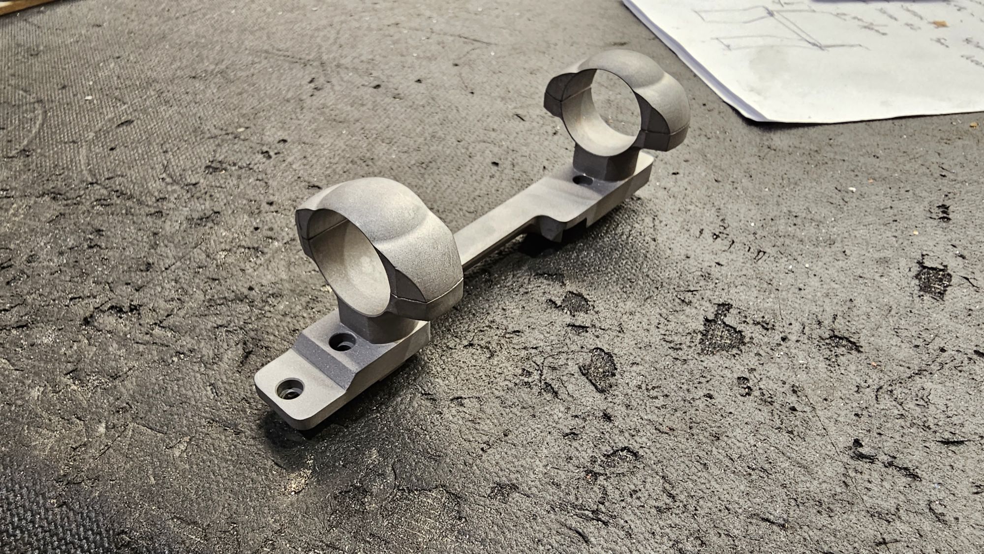

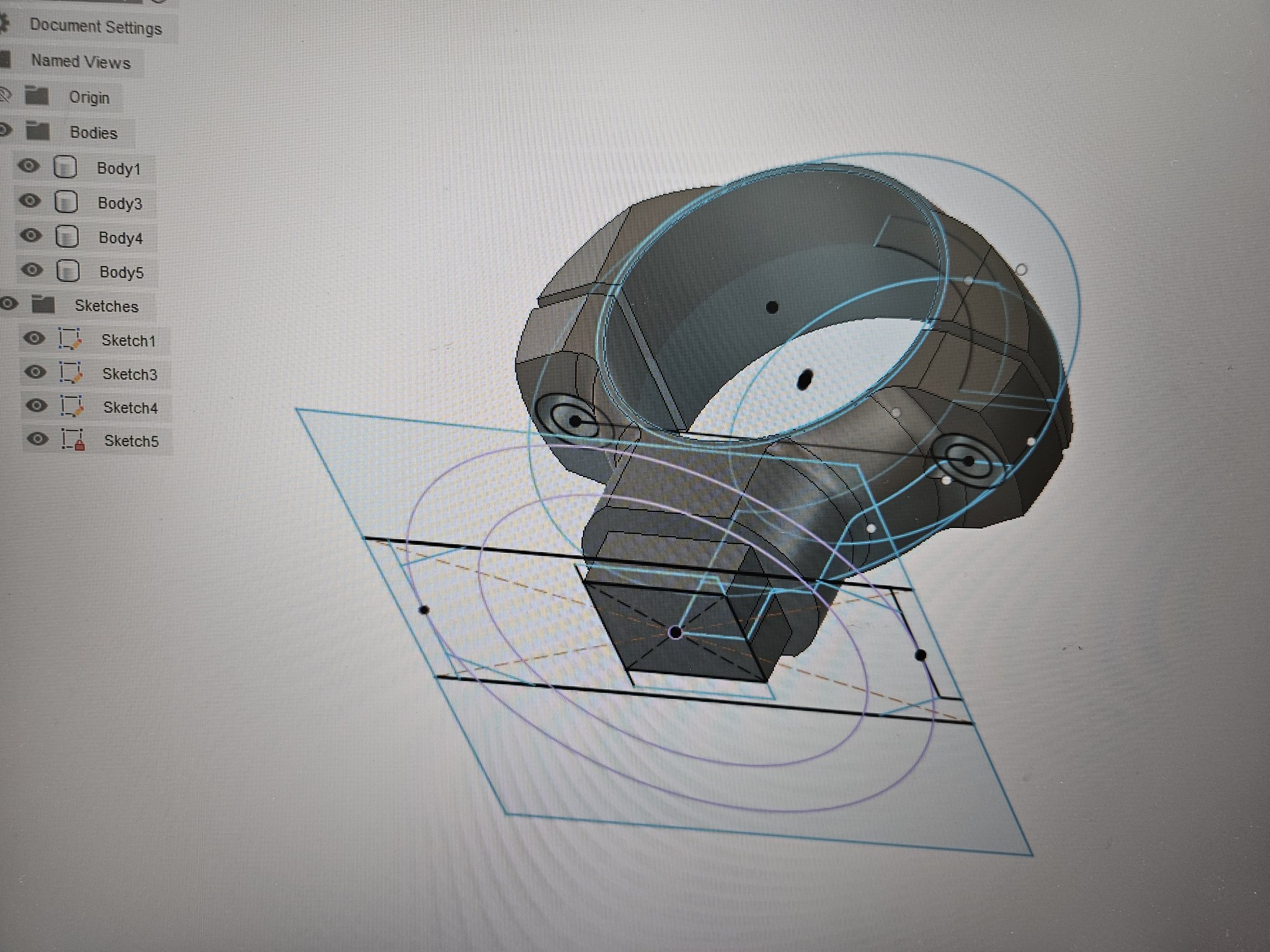

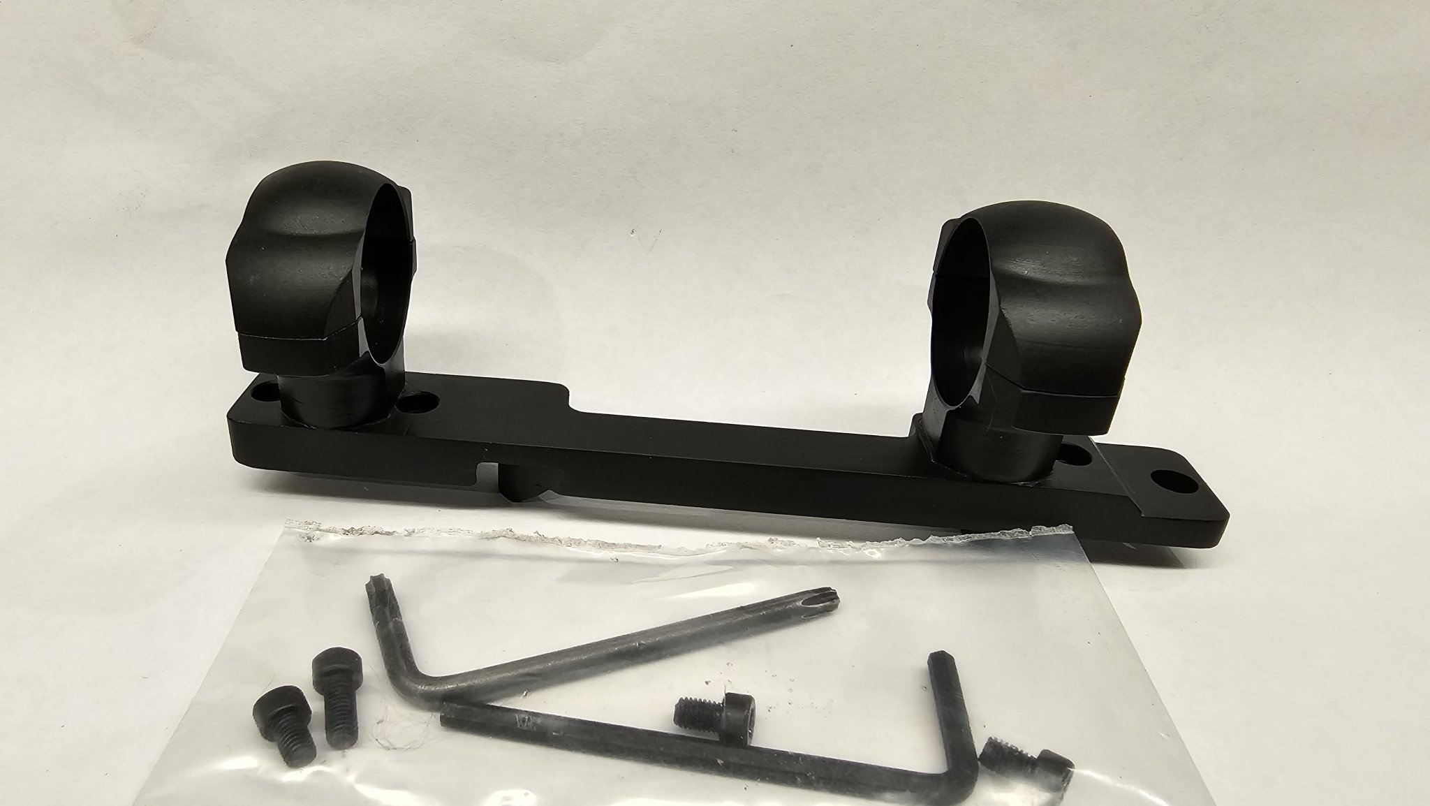

Just about to finish this. Going off for finishing next week. I got a hold of a set and fully digitized it and made some. As exacting and correct as I could do.
They do not require small tac-welds to hold them together. They will also withstand unlimited amounts of shooting 308win / 7.62 under normal bolt action conditions.
In Australia. Yes, i have authorisation (DoD export permit) to send to USA.
I dont have many. This was to help a mate out fix hit junk tier ones from "someone else". Wanted me to make a high quality set. This is what i came up with. I tried to make them as exacting as original as I could. They will be finished in a week.
I scrapped one in prototype, and will forcefully destroy another to ensure it is the best quality I can make.

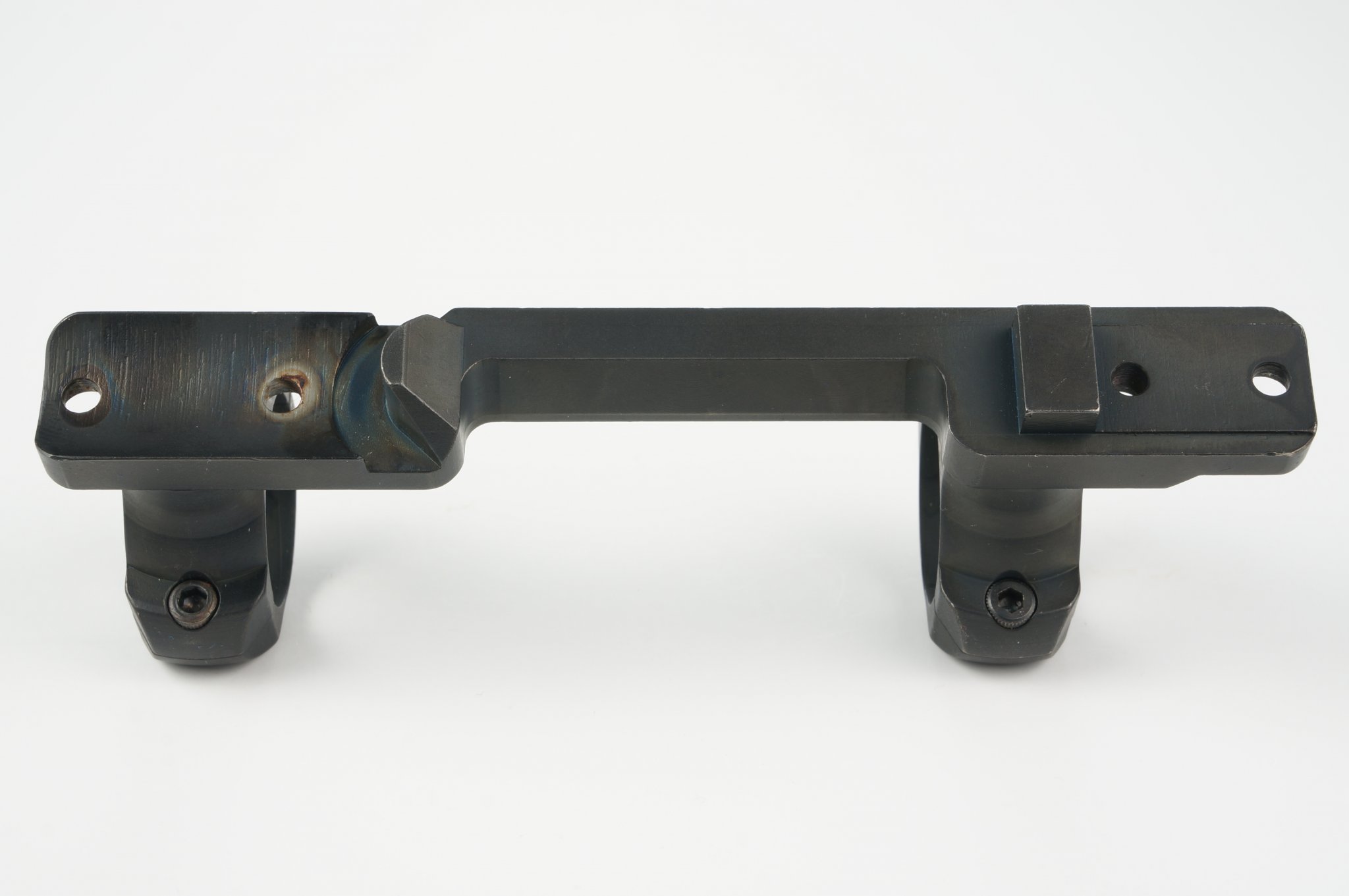

Out of curiosity, what are you basing the specs on? Do you have an original USMC Unertl mount on hand to measure? Are you taking measurements from the mount that shall not be named (we all know what that piece of garbage is, lol)? Or is there anything else you're using to get the specs or a combination of these?
Mounting on a tube for alignment is what's always been done, I actually have the tube that Dan Ross used to alignment the rings on his mounts (which aren't to Unertl spec). Quick, easy and accurate way to line things up. The original Unertl mounts had the rings brazed in place or whatever it would be called. On the underside of every USMC Unertl mount you can see the coloration from the heat when they brazed them.

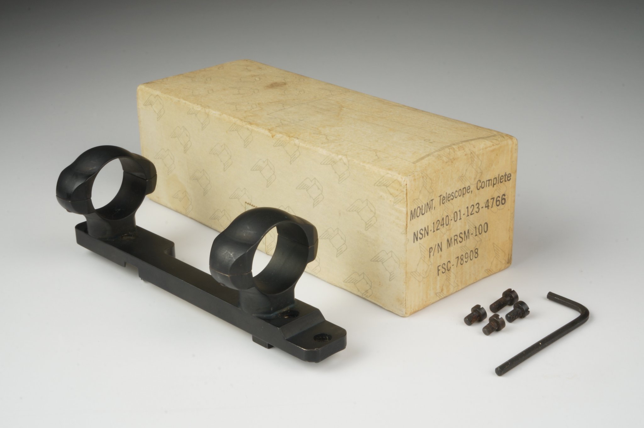

Since you're doing a box with your mounts, it would be pretty cool to replicate the one that the mounts originally came in. Check out these photos, I can send you a close-up of the box's artwork if you're interested in trying to incorporate it into your boxed set. The Unertl boxes don't have any padding in them, the mounts were just wrapped in tissue paper. But it's probably better to add padding in you box as planned, tissue paper isn't very good at protecting things, lol. The screws and an Allen key were also provided in a small plastic bag. And that's pretty much it for the original USMC Unertl mount packages, not much to it.

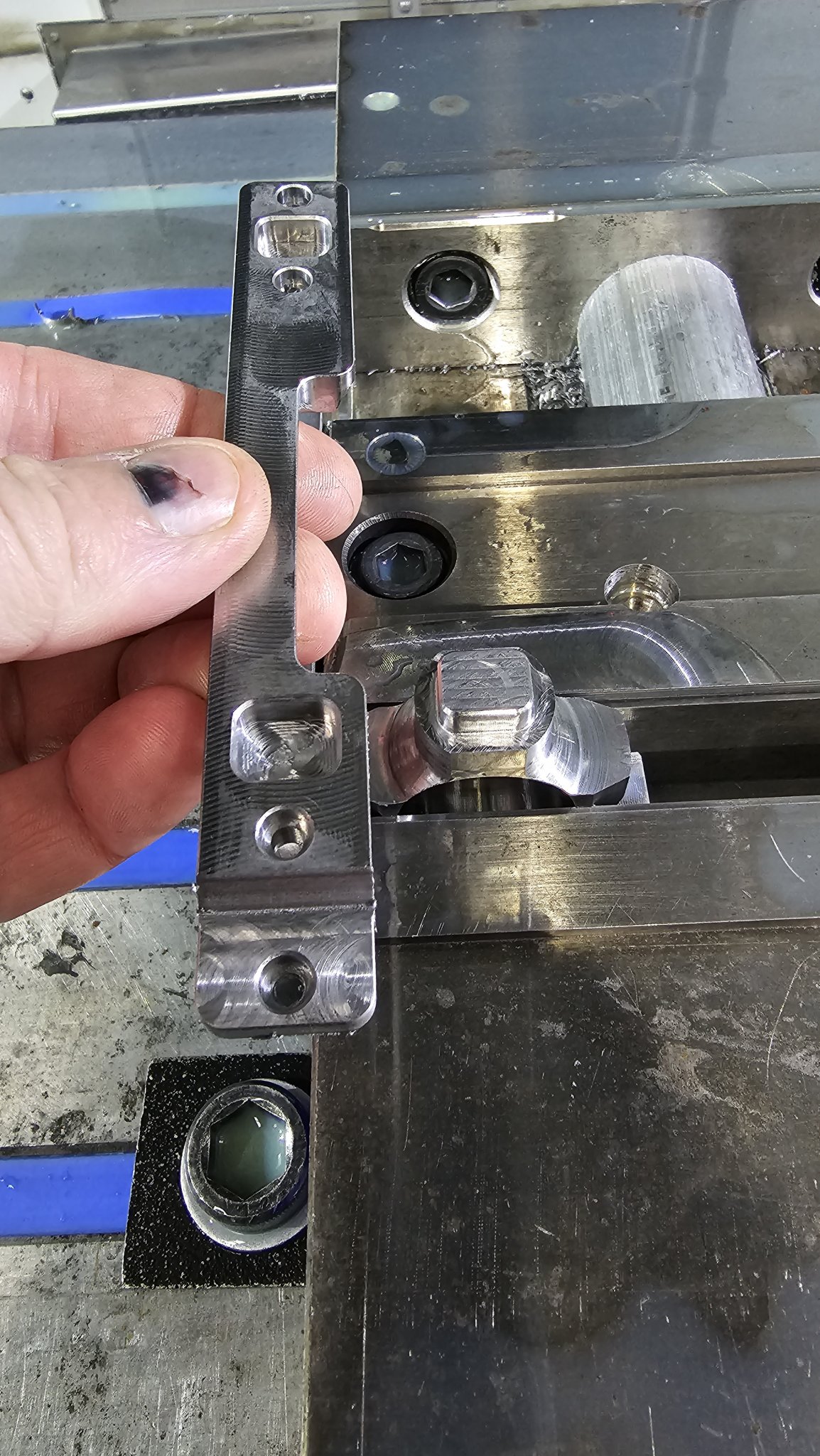

Ive had both mounts to measure and compare. Ive tightened a few things up and put a few tweaks in (chamfer, radius clean up, etc). Nothing really "modified" from original, just cleaned up.
If i had 10 units, id get a very good idea on dimensions and tolerances. However i had to make do with a real and a fake. Guess which one i relied on.
Ive hooked up with a local company who does black oxide, and have given them info on the project and they are on board.
The single biggest issue i have currently is finding screws to screw into the receiver. I have custom made T15 torx, heat treated black oxide screws which are aussie made (not chyna junk). They are not pan head screws like original which im not custom making as i have to order 2000 at a time.

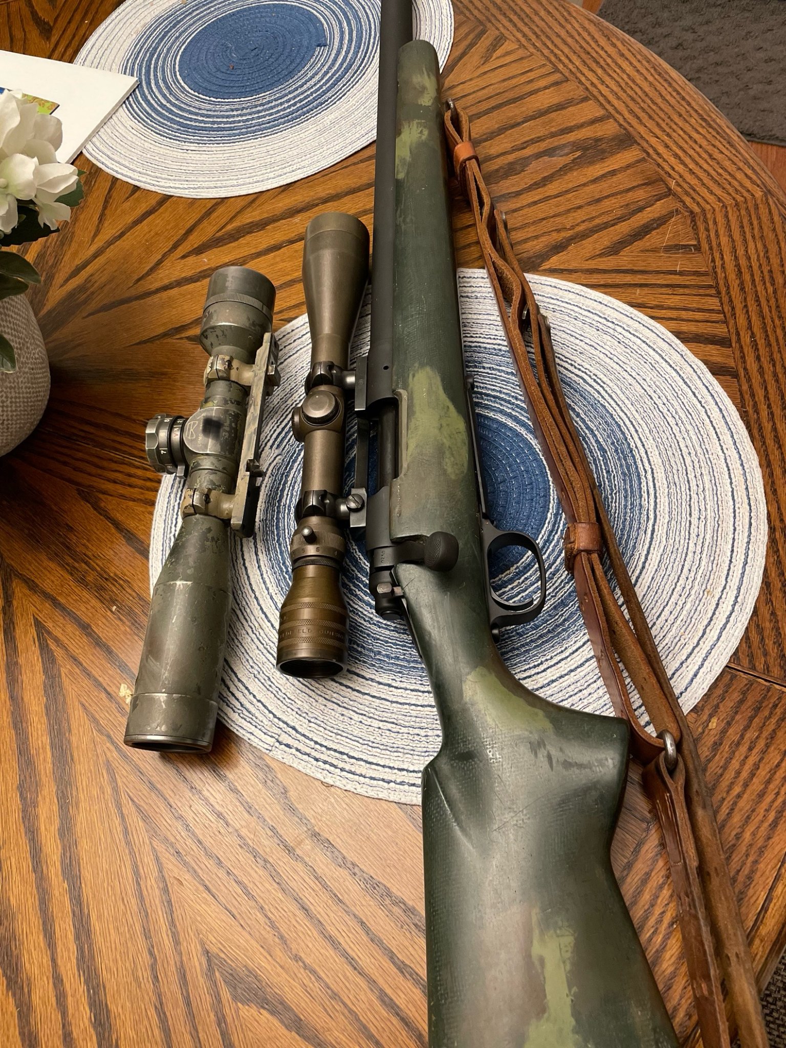

My bastard clone setup…if I get cold feet and don’t want to shoot the greenie, I can throw on the backup scope/base that’s been fitted to this rifle…
Nice mount. Looks salty and legit. 😉
It’s definitely salty…the 221xxx Redfield base with medium rings gives options for clone builds if you aren’t willing to wait for a reproduction base.
