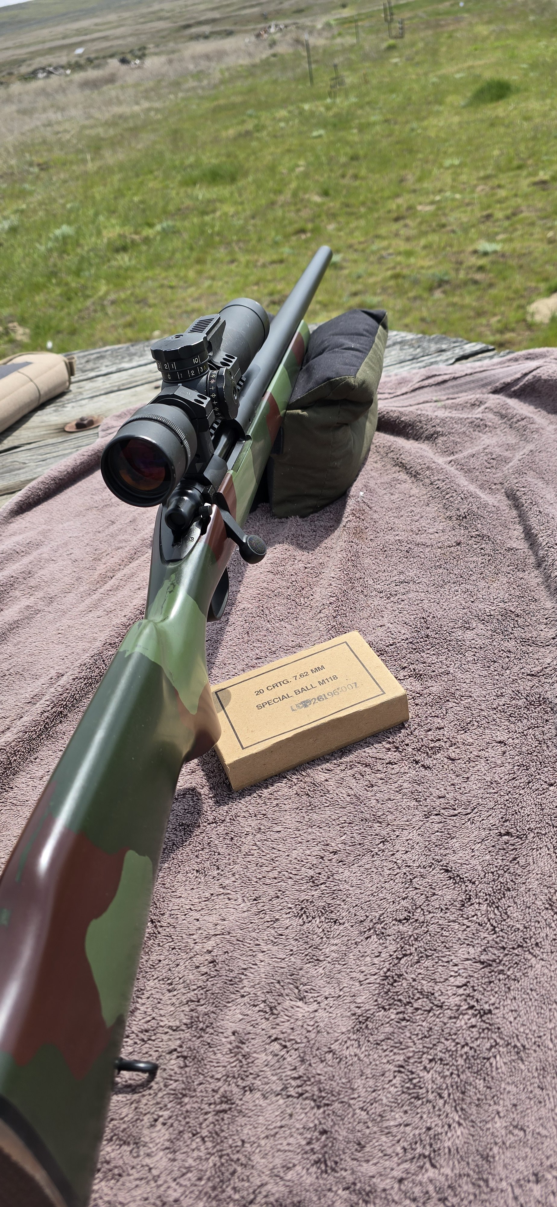

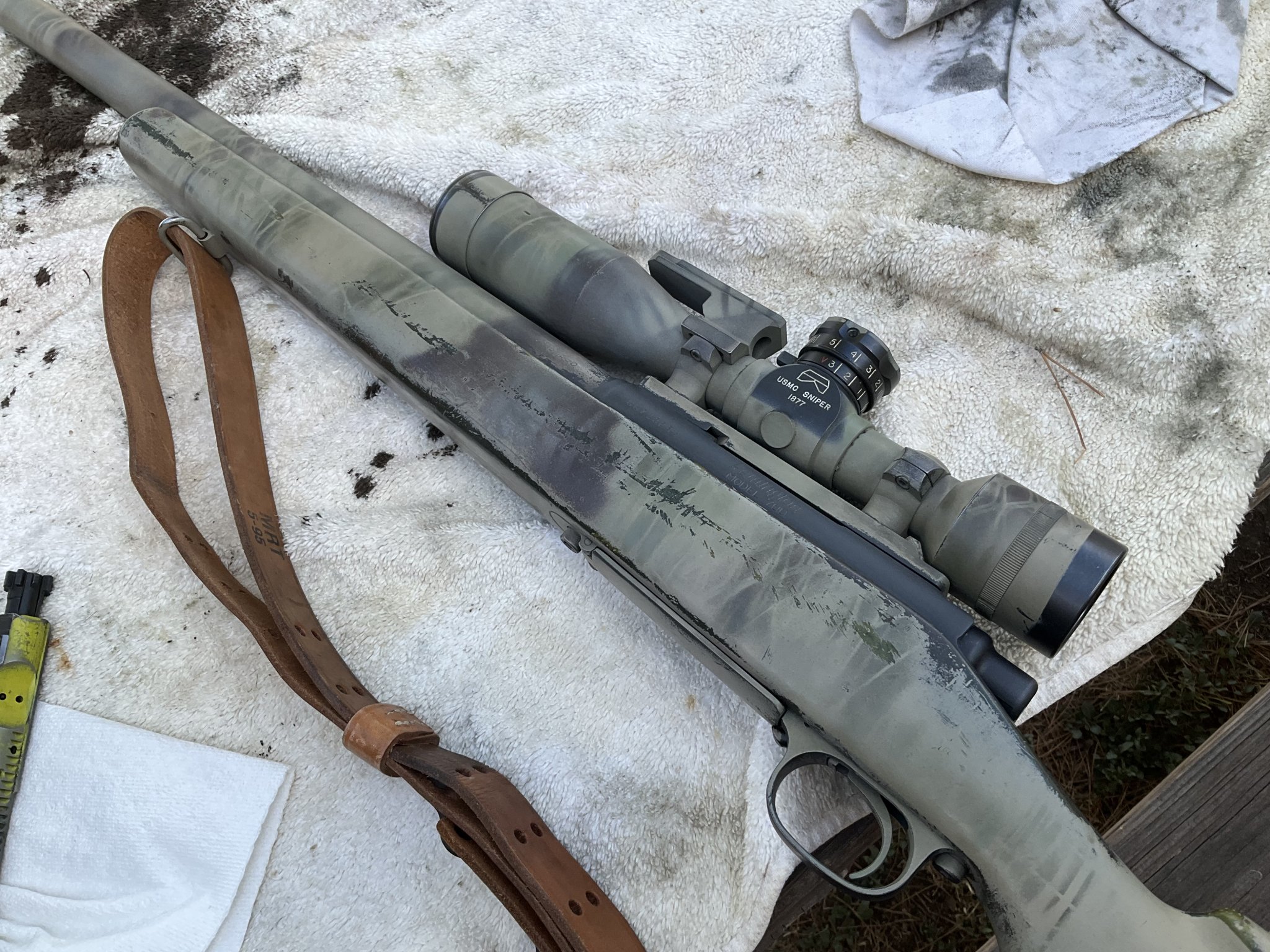

So I took my GA Precision M40A1 out to my property yesterday. Since everything was dialed in nicely and the wind was 2-5mph I tested the Urnetl scope settings. With Special Ball it was spot on to 880 yards.
I have steel songs from 100 to 735 yds and there is an abandoned root cellar at 1/2 a mile. The cellar has an old oil drum in the doorway. It rings when hit squarely. Dial it to 6 and hit the 600 steel like clock work. And so fourth and so on at every distance. It was a pleasant afternoon.
The only thing different about my setup is I had them add a Badger 20moa rail so I could keep the rings that came with the scope.

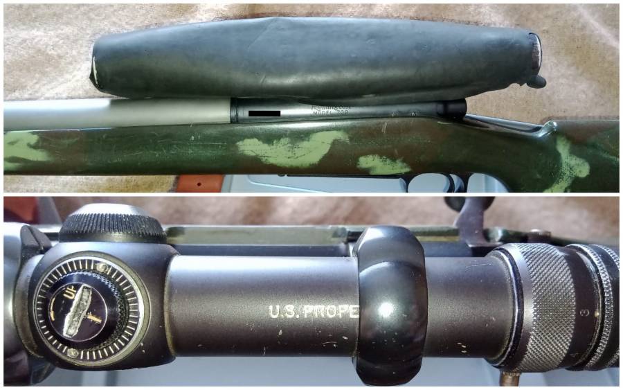

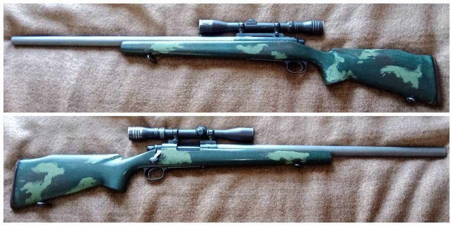

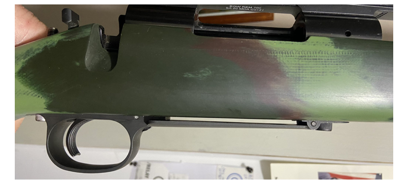

Greetings.
Recently aquired my m40a1 clone. Smear stock, U.S marked Redfield 3x9 wideview. Win 70 bottom metal. Unfortunately the bottom metal serial number does not match the stock and reciever is not clip slotted but does start with an A prefix.
Barrel still needs to be black Oxided but need to sort out headspace issues on this rifle.
Original redfield base, rings and scope cover.
That US PROPERTY Redfield is different. Do you know the origin of it? USMCSGT0331 has posted about the trial run of Widefields the Marines used, but they weren’t adopted for quality issues. We’d love to know the story on that one.

Greetings.
Original redfield base, rings and scope cover. View attachment 8713229View attachment 8713230View attachment 8713231
Nice build. I’d trade two of my repro Smears for an original Return Smear.
Greg
I also found the Redfield interesting, havent seen one like it before, marked U.S. property *28. Wish i knew more about this rifle.
The story is without provenance. I am from South Africa and aparently 3 of these rifles have made it here, havent seen any others though. I am 3rd person to own this rifle was made somewhere in the late 70's early 80's. The rifle found its way here alledgedly by some of our STF guys doing training in the States or some of your guys doing OPS in Africa.

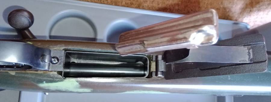

I know its not a legit m40a1 due to no clip slotting, serial numbers stamped on various parts etc. I do believe it might have been a hobby build assembled with original parts.
Chamber has 0.010 excessive headspace with a neck diam of 0.345 quite a big. Will get that taken care of soon.

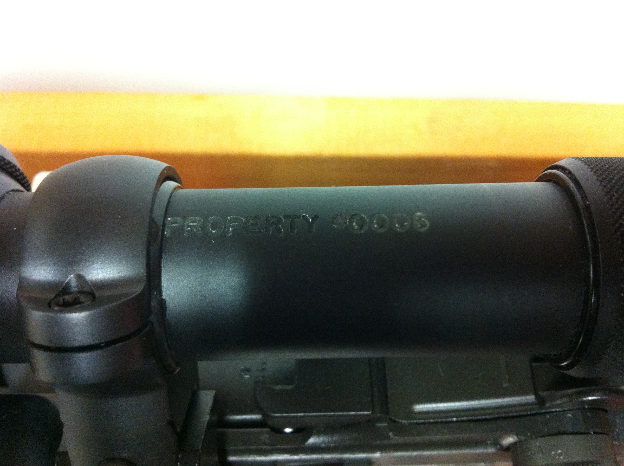

Does anyone know the significance of the U.S. Property *28 on my Redfield Wideview scope?
I know they werent officially adopted, does that mean i have a once off, is it rare? Does it translate to valuable? Is it collectable? Can the date be tracked? Sorry plenty of questions. Would appreciate an opinion from

Does anyone know the significance of the U.S. Property *28 on my Redfield Wideview scope.
Maybe cplnorton can look in the archives one day for more info. My understanding: they are briefly mentioned in two books as evaluation scopes that Redfield provided to the USMC in the late 1970s when they were updating the M40 to the M40A1 configuration. Your scope is the 5th one that I have seen. I used to own serial number 6 (“*0006”), but I traded it to a local buddy a decade ago who collects USMC items. It’s been sitting on his shelf with other USMC optics for the past decade. I briefly mocked it up on an M1A back when I bought for $150 on the CMP forum:
The two books that briefly mention/show the Redfield Wideview evaluation scope are Peter Senich’s ‘The One-Round War,’ and Chandler’s ‘Death from Afar, Volume 1.’ Both were printed in the early 1990s (pre-Internet).
Senich noted that 3 or 4 other scopes were evaluated in the late 1970s:
Chandler’s book shows one of the original Redfield boxes, note “sand blasted” (matte) finish and cross hair reticle “CH.”
I took my scope scope (serial number 6) to a Quantico vintage rifle match a decade ago to ask others about it. Sure enough, a middle aged man who was either a former USMC Scout Sniper or a former MOS 2112 Precision Weapon armorer looked at it, and said he recalled them being tested back in his day. He went on to say they were not very reliable scopes, and the new Unertl 10X scopes that he first saw around 1980-81 were consider “Star Wars technology” at that time. Major Jim Land’s son was in that conversation, and he chimed-in and said he had one of those scopes at home as well, but the serial number has been scratched off. (It’s seen in an old NRA article on the M40 rifle history).
Someone posted that Redfield provided 100 of these scopes to the USMC to evaluate, but that number seems exaggerated to me. So, Maj Jim Land (ret) has one (I think serial number was grinded away), Ryan has 2 or 3 of those scopes, I had one, and somehow serial number 28 made it over to South Africa…I suspect a few more exist on random hunting rifles here in the Virginia area.
Since these scopes were presumably no-cost samples or evaluation scopes - and thus not inventoried by the USMC, my guess is some of them were perhaps “rescued” from the dumpster approximately 45 years ago…so I do consider these as obscure but still collectible scopes. That’s all I know.
As for a possible one-off Redfield scope, my guess is there was at least one such scope evaluated back in that same late-70s era by the USMC (source: Chandler, DFA, Vol 1):

I asked Chandler about these scopes years back and what he told me is they got them in, and they did not hold zero, so they sent them back into Redfield. He said a few of the guys at PWS kept a couple, including him, but all the rest went back.
When I asked him if they were marked, he told me they were not. He said there would not be anyway to tell one that was used by the Marines. I know where the scope that Chandler kept is, and I will ask the current owner if it is marked. If it is, I will correct myself. But at least what Chandler told me that day, he said they were not marked. But sometimes I do see him mix traits between the different platforms, just old age, so I will double check his scope.
As far as the US Property marking that is really not a Marine marking. That is an Army Ordnance required marking. If you get in the Army and Marine documents, both state clearly that US Property is a requirement of Army Ordnance and is not a Marine specified marking.
You do see some US property markings sprinkled on Marine inventory, but usually that is because the Marines acquired it through Army channels. You do see the Marines required some stuff to be marked in their contracts. But it's generally shortened, such as just having it marked "US." Usually, any markings specified by the Marines, will be something different than "US Property." That is why I said these are likely to be to another branch if real.
After digging so far into the Archives, I think the one thing that I see is so much is automatically assumed to be Marine. The Army, Navy, and Air Force all had M40's and Remington 700 rifles. Not only as sniper rifle platforms, but also rifle team equipment and regular base recreational rifles that could be checked out. It seems if one branch tried it, they ALL did it. Which makes it a mess trying to decipher who did what.
The really bad thing is barely anything of what the Army, Navy, and Air Force did has ever been addressed publically. So there is so much out there that we all need to learn and research to try to understand the Marine program more. I think a lot of stuff that is automatically attributed to the Marines, is actually to another branch. It's just the Marines are known for it and the other branches are not.
But I will ask about the markings on the scope that Chandler had to double-check myself. If I'm wrong, I will definitely admit it. :) I honestly never verified it past what Chandler told me. But at least what Chandler told me back in the day, he said they were not marked.
