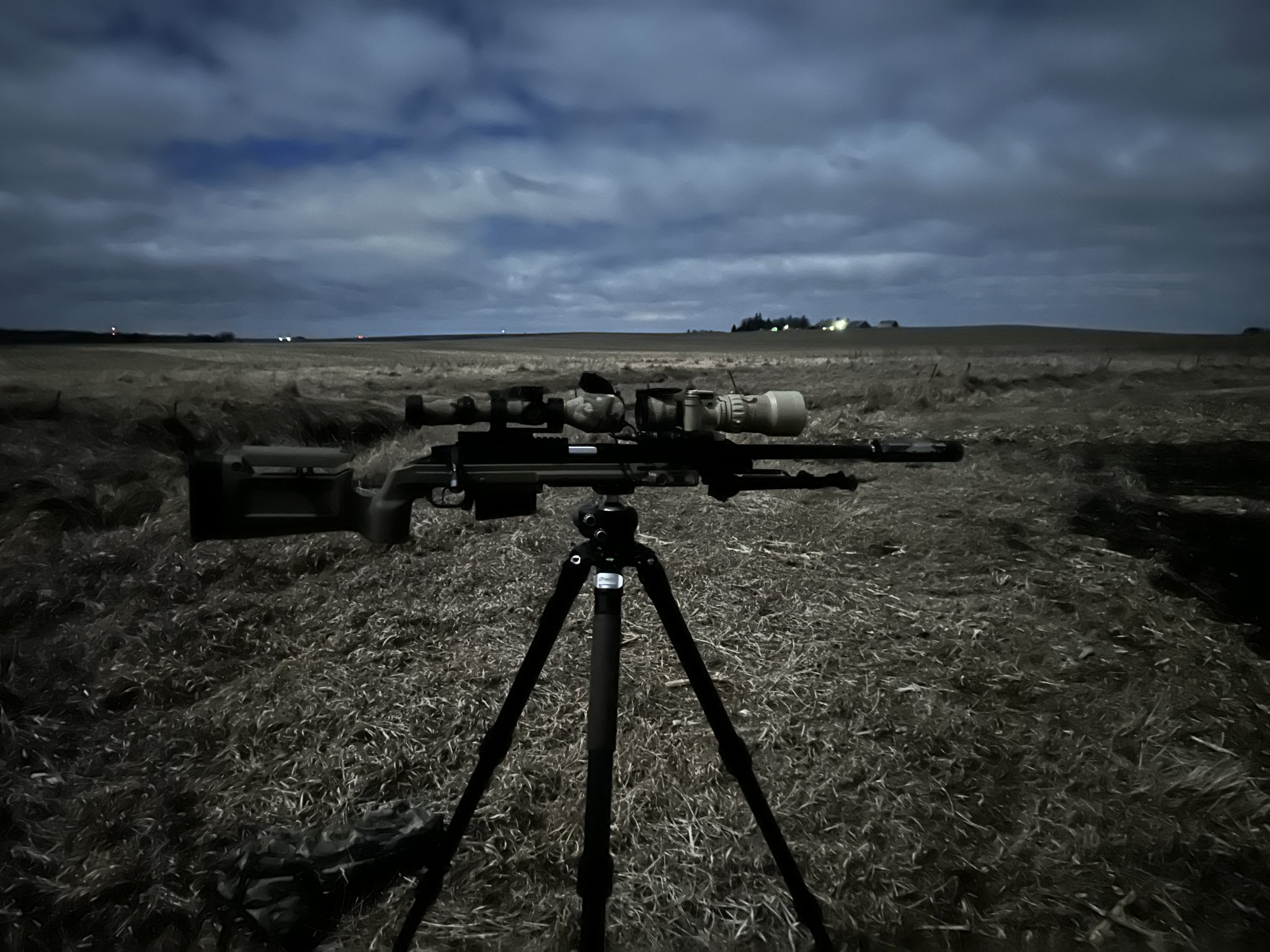

I’ve been working with @Tyler Kemp on this exact thing and I’m hopeful we can get everything ready before too long! Seems more and more guys are looking for this solution. Next I’ll be bugging Joe for a long action bolt with a 223 bolt face :ROFLMAO:
For what it’s worth, I’m running 6 CM (carbon), 6.5 CM (MTU), 308 Win (MTU), 300 Win (MTU), and 300 Norma (MTU) on a Zeus QC in a Bravo which has been great.
AWESOME!
