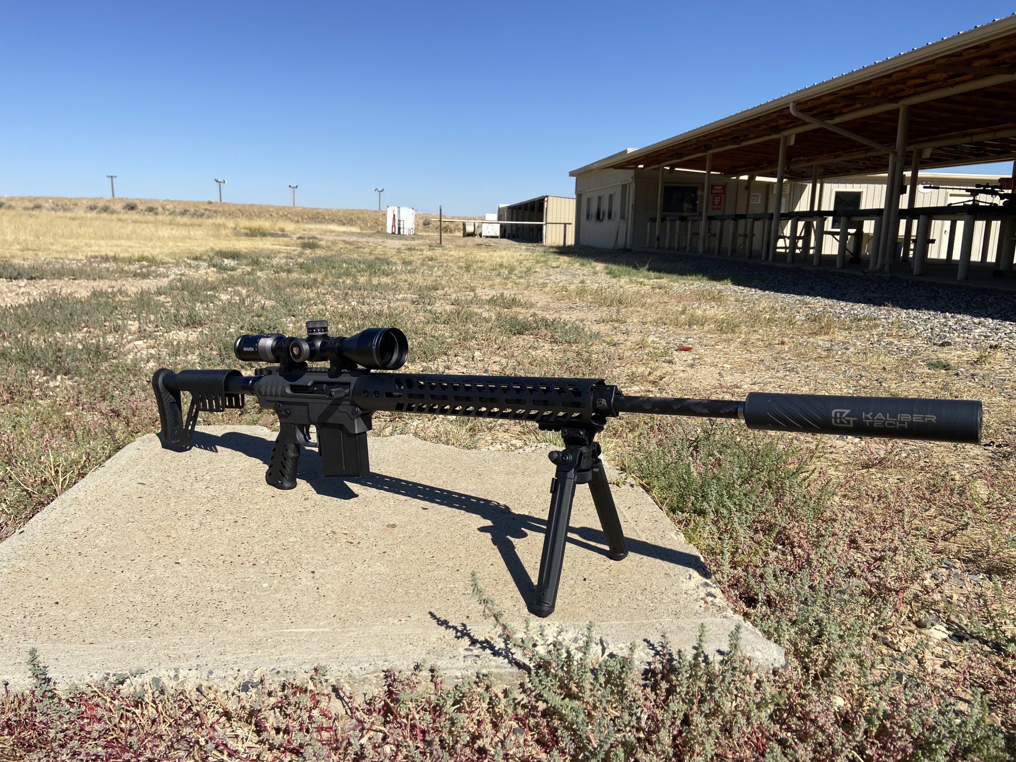

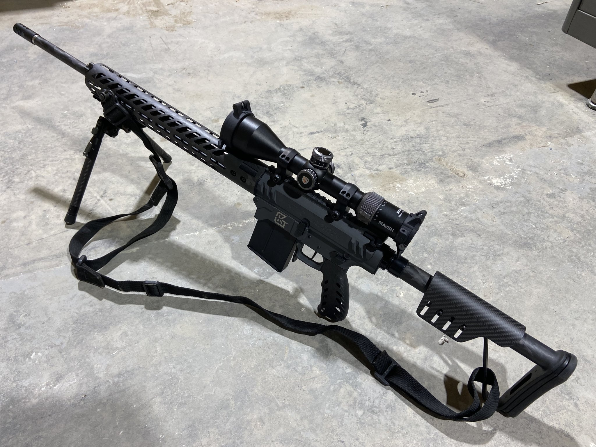

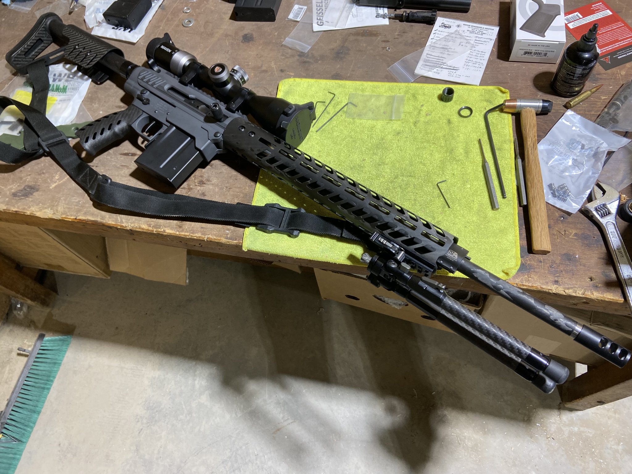

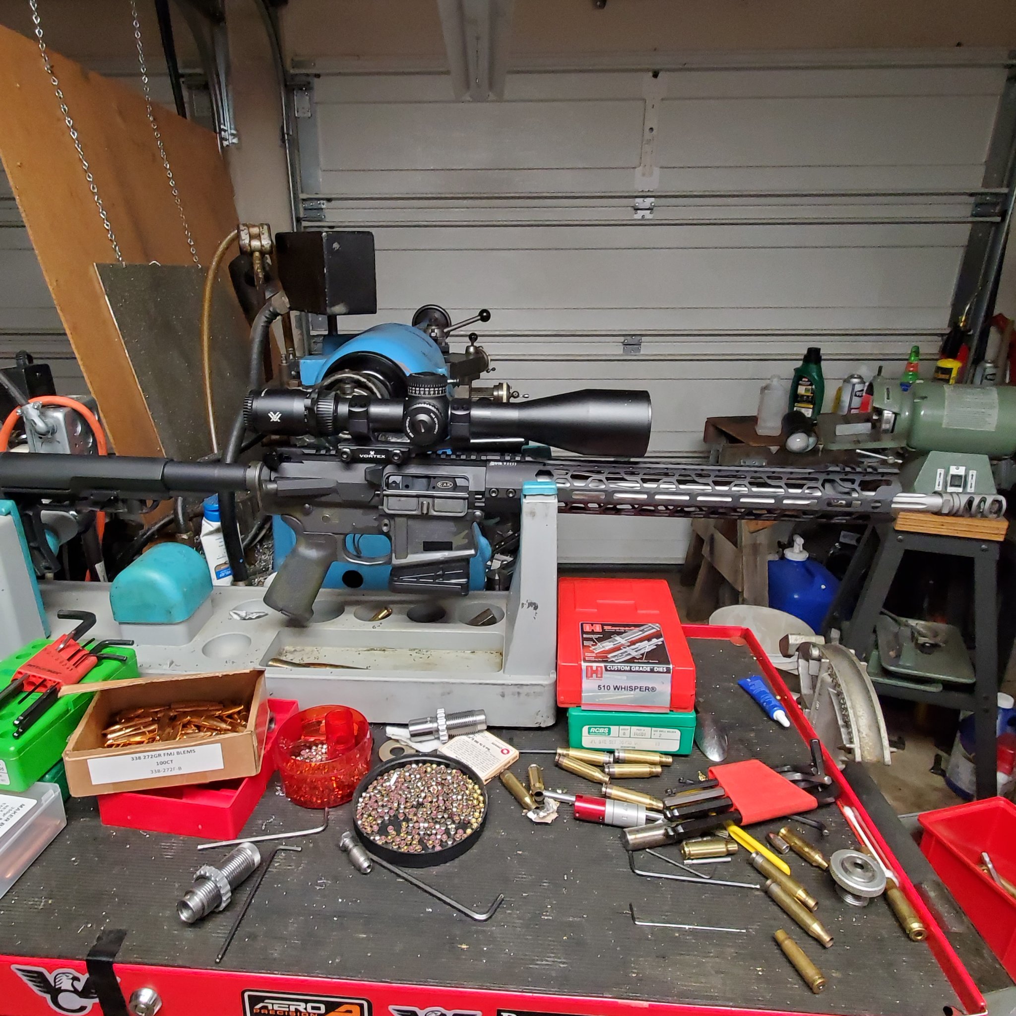

It's been awhile, but I finally got around to taking some pictures of the carbon fiber rifle. It's 10lbs 11oz (if I remember correctly) as it sits in the pictures. The side charging upper really makes this platform a lot better IMO. I've had 100% reliable ejection with this upper, very pleased with how it's turned out so far. I also tried shooting it suppressed, the ammo I had that day was already loaded a bit hot. It started showing a little bit of pressure signs with my handloads, so I switched to some 180gr factory ammo I had and it seemed to work better. I've got several loads worked up now, I'll be taking it out this week to see which one it likes the best.

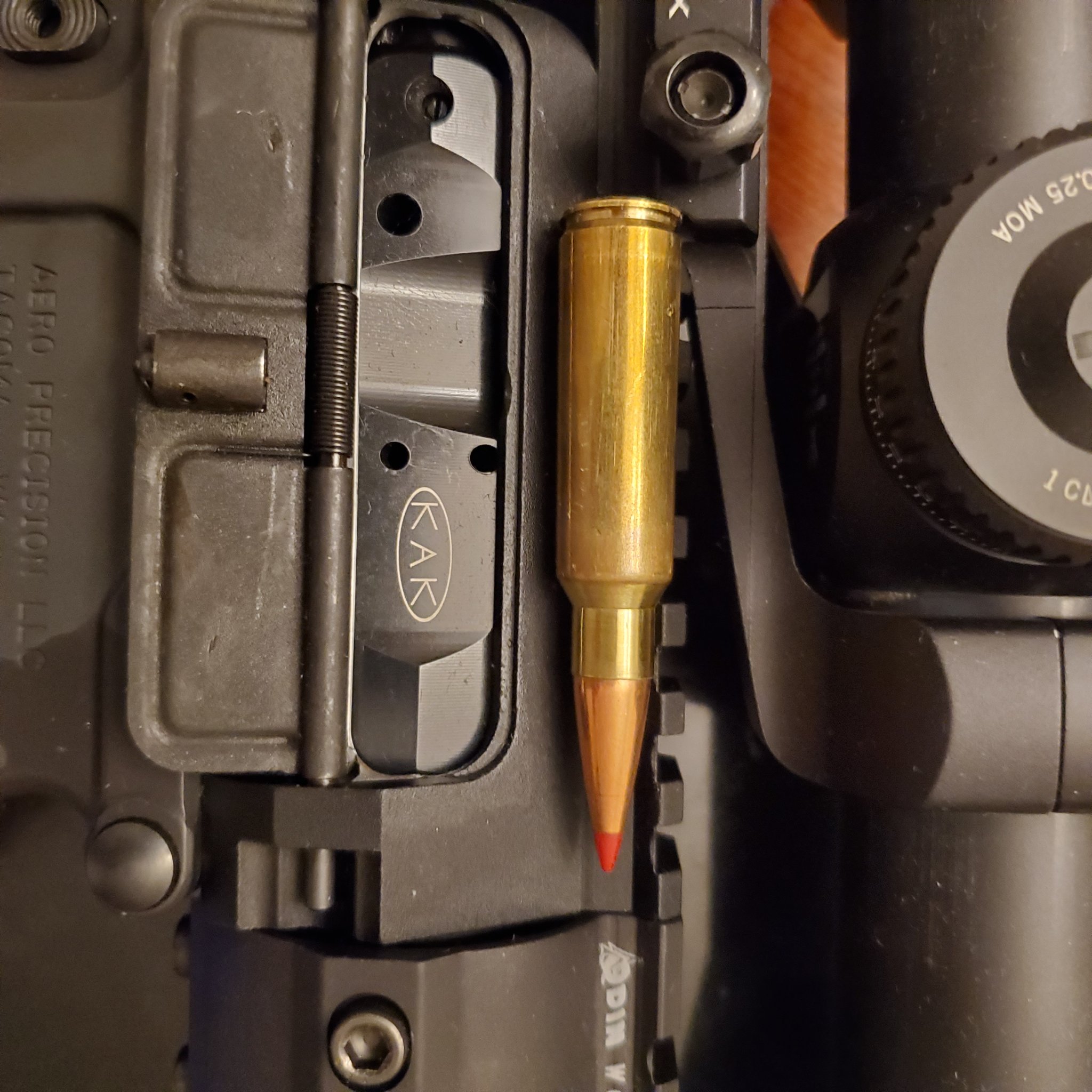

Anything special on the rifle other than the boltface and barrel?

Specs on this build?
Thanks
300 WSM
22" X-Caliber Barrel
+2 Rifle Length Gas Port
Superlative Arms Gas Block
Alexander Pro Fab Side Charging Upper (modified by me)
Kaliber Tech Lower (my design)
Rise Armament RA-434 Trigger
Standard Rifle Buffer and Spring
Smoke Composites Stock, Grip and Handguard
Tier One Tactical Bipod
Maven RS3.2 5-30x50mm Scope

It's a 5oz buffer. I have a 9oz I'm going to try when I get out and shoot either today or tomorrow. The one load I quickly put together was 2840fps, 190 berger vld, 61.5gr of H4350. This load was a bit hot, and the recoil was more than I'd like. I currently have several loads put together with 180 berger elite and various weights of H4350, we'll see which is the most accurate and go from there.

Nope, you can buy the KAK magnum bolt, or complete bolt carrier, and upper reciever, together for the easy button.
Or use, Your AR 10 upper reciever ejection port is opened up a bit on bottom of the ejection port, but you can do that with hand tools.
Barrel can be ordered, KAK used to have 300 WSM in stock and complete uppers, rifles, but no more.

Finally got out and got a load developed, here's what I'm using so far:
300 WSM
Norma Brass
Also Hornady Brass
180gr Berger Elite Hunter
59gr H4350
CCI 250 Magnum Primers
Averaging 2790 fps
COAL 2.955 (about .010 off the lands)
I'm not the best shot in the world, but managed to get a .73" group at 100 yards. I'm going to get some more loaded up and head back out to get some 5 and 10 shot groups. I think with a little more practice and some better brass prepping, I can get down to around .5" at 100 yards.
I got up to 2900 fps with 62.5gr, but slightly worse grouping, just barely under 1". This was toward the end of the day, so I might have been flinching a little bit as well, those loads were feeling a bit stout. No pressure signs though, so I could have kept going if I was looking for speed.
