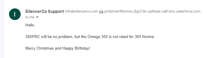

I would reach out to SiCo and get their thoughts in writing.
