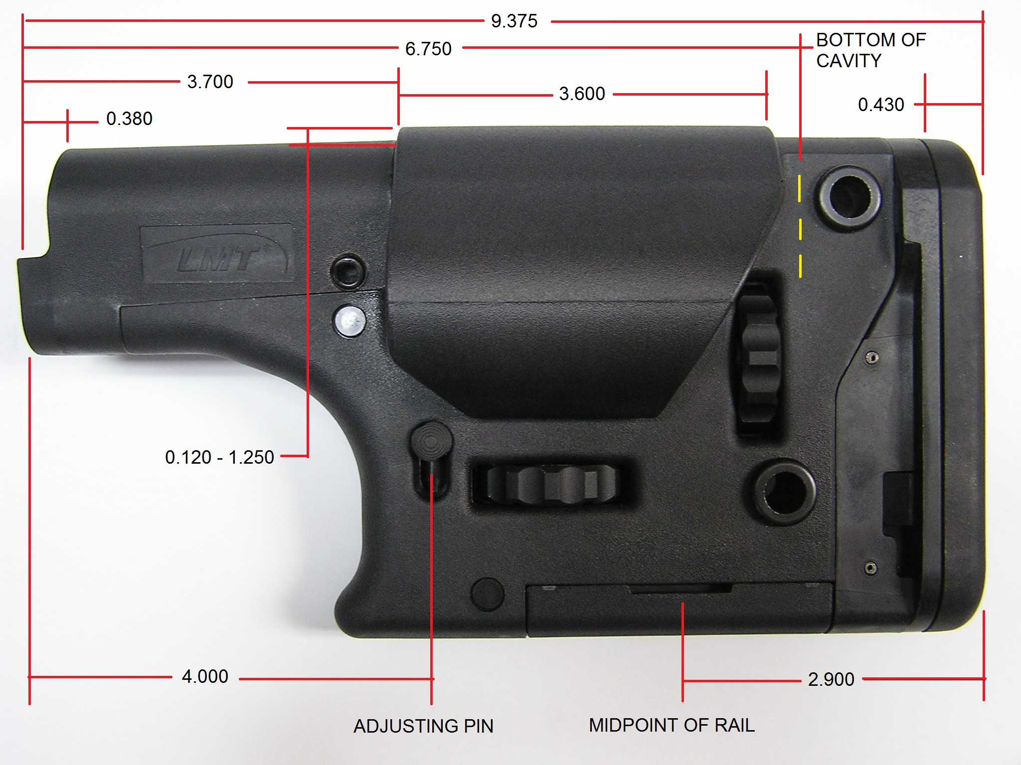

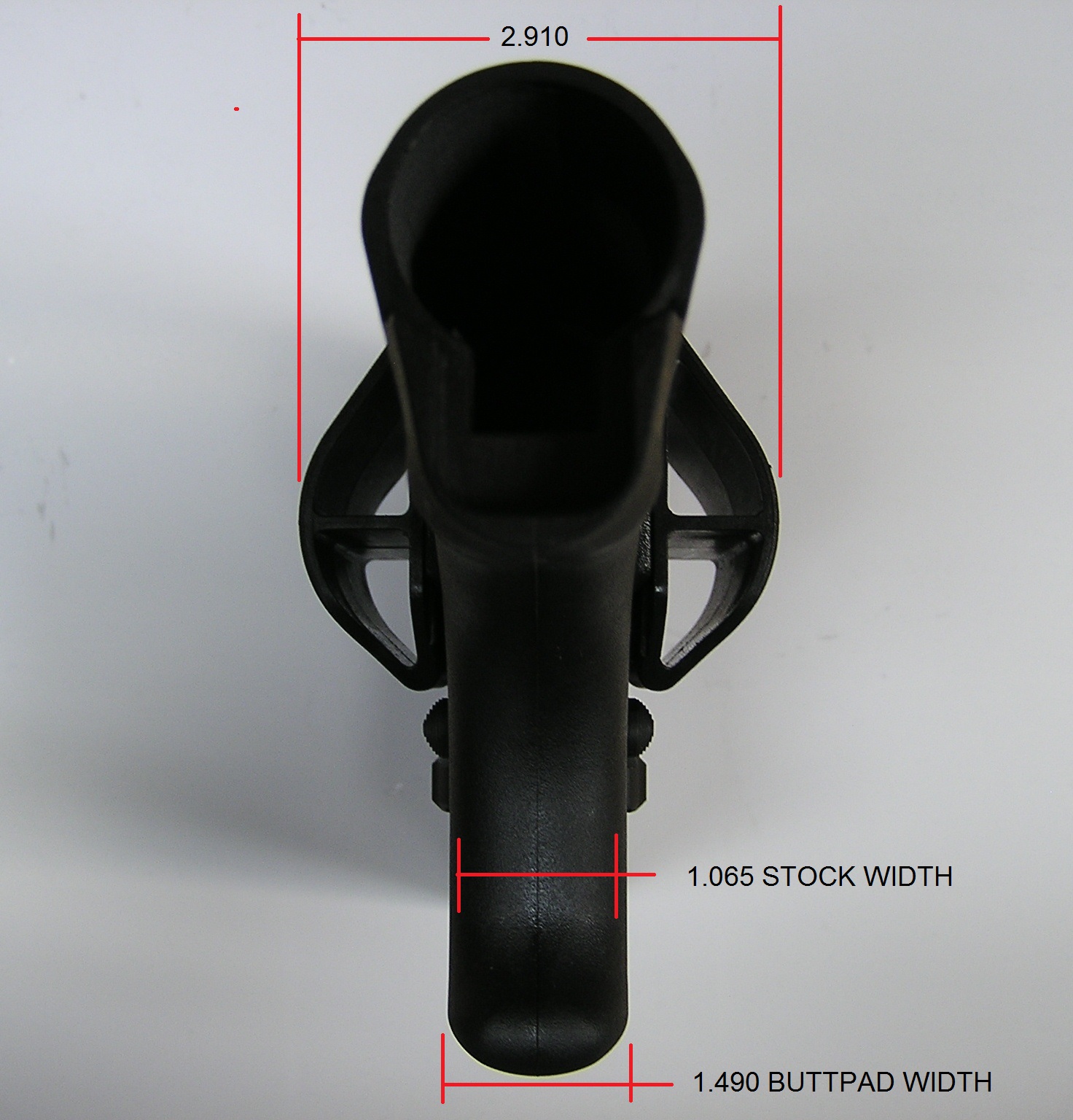

The LMT DMR 308 has intrigued me as an alternative, but I can find ZERO information about it. It looks to be a little shorter than the PRS, but there are no specs to speak of.
I hope this helps.
Sorry for the crudity, I didn't feel like pulling up AutoCAD or Creo to do it in. Please note that all dimensions are in inches and +- .010.
Edited: I should have clarified that this is a 308 DMR Buttstock. I do not know the differences in the 5.56 DMR Buttstock.

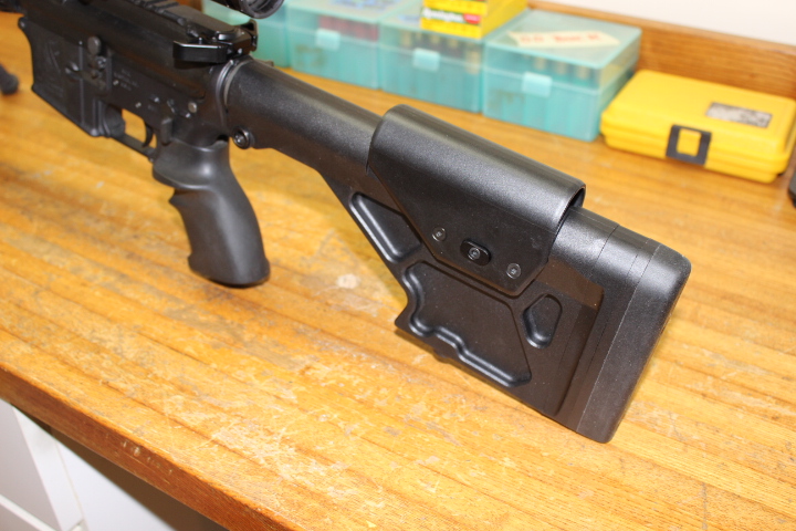

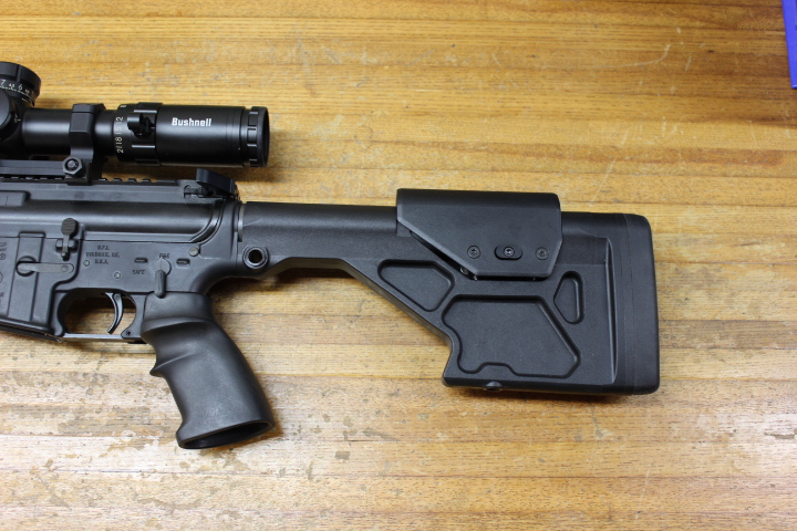

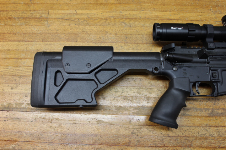

I've been considering an aftermarket stock for 2 years. Looked at Magpul PRS, Luth, LMT, and Seekins . Decided on the Seekins and took advantage of the Primary Arms sale. The Seekins was easy to install and everything fit perfectly. The cheek piece is easy to adjust. I set the LOP using 1 "Shim" and it seems about right on initial view through my scope. IMG_1037.JPG
