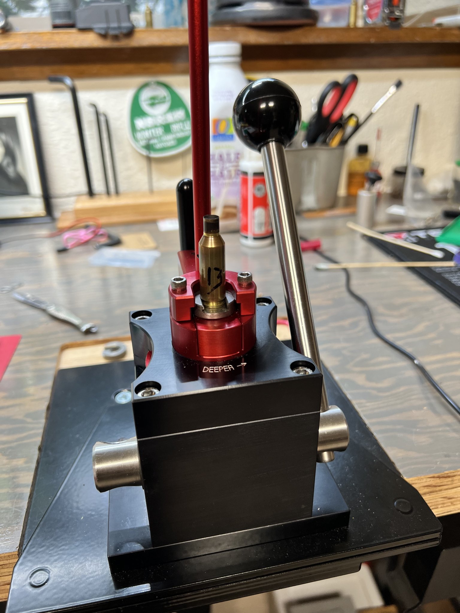

Major Factor in Primer Seating Depth Variability
We seat to the bottom of the primer pockets and if necessary give it a little crush so the primer is flush with the bottom of the case. To do what you advocate requires primer pocket uniforming and seating short of the bottom which may reduce reliability.
He didn't advocate doing anything at all. He merely correlated primer seating depth error with rim thickness when using priming tools that rely on the rim (shell holders and such).
He's already shown in previous videos that it's very bad to not have the primer seated to the bottom of the pocket. So he's obviously not advocating that you do anything at all that would prohibit that. He's also shown that you can have precision differences with different amounts of crush or below flush seating. However, he's shooting a 6ppc for short range Benchrest.....so it's likely not enough for most people on the Hide to care about.
You have a few choices how to handle this. You can sort cases via rim thickness, or you can use a tool or add on that negates that rim thickness. Such as the Lee primer tool.....or the F Class Products add on for the Primal Rights Seating tool.
Or, you can set up a tool that will seat far below anything you'd need and seat to the bottom of the pocket via feel. Which is probably just fine for anyone on this forum. However, if you don't have something like the FCP Primal Rights add on, you won't be able to consistently crush the primer past the bottom of the pocket.
You could also sort your loaded ammo via the amount below flush the primer is seated.
But, he definitely didn't show anything in this video that would necessitate uniforming pockets and not seating to the bottom.
I measure the depth of the pocket then measure the primer cup thickness.
If you're using a priming tool that uses a shell holder or similar, you'd have to do this on every single case to ensure consistency. That's the point of the video.
Let's say you measure the thickness of a primer and the depth of the pocket and decide you need the primer to be .005 below flush, then put in in a Primal Rights tool.....you'll have to adjust the tool until you measure your primer .005 below flush. That's all fine.
But on the very next case, if the rim is .001 thicker, your primer will now be .004 below flush and possibly not touching the bottom of the pocket. Even if you made sure to add say .005 crush and go .010 below flush on the first case you measured, you're now going to be .009 below flush instead of .010.
He said the sweet spot is .008” below flush. That requires pp uniforming otherwise you’ll crush the primer.
Reactions: Capt45
Does that seating tool not have micrometer or screw adjustment? If loading on range could you not set it "shallow" separate everything that fits your target band, then go again a touch deeper, go separate again then deeper once more, given you are measuring each one anyway I suspect it will be only marginally more labour time in practice and result in less discarded brass.

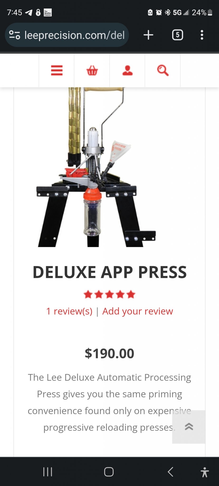

I can't seem to find just the seater for sale anywhere. This is the only thing I can find that you can actually buy. Are they just out right now or did that model get discontinued in favor of this?

What is this add on? Attached is a pic of what I used in my test. Is that add on in the pic?

So, for $150 more in addition to the $600-650 I spend on a Primal Rights, I can get more reliable primer seating depths from a $100 Lee priming tool? How much $ do I have to keep spending with “add ons?” This is all starting to sound like a huge snake oil sale to me.

Edit to add the $150 only gets the plate, the gages are more $$ 😆. I'll pass. The Lee design makes a lot of sense too. Wish they still made it.

If there's a way to use that Lee priming system with the APP - which I do have - or some other press/setup that *is* available, I'd be game to try that. I'm just not paying scalper prices off eBay for plastic and pot metal - I don't care how good it's supposed to be.

How was the CPS mounted to the bench? Sitting on it, or bolted down?

Attached is a pic. It was bolted to the bench top.
Basically uses and indicator. You seat until the primer stops at the bottom of the pocket and then use the indicator to get a consistent crush past the stopping point.
There are obviously some issues that are still possible. Tight pockets might “feel” like the primer bottom out. Or the depth of pocket varies.
But the CPS has quite a bit of leverage, so shouldn’t be too bad on friction being an issue. It does get rid of the rim consistency issue though.
