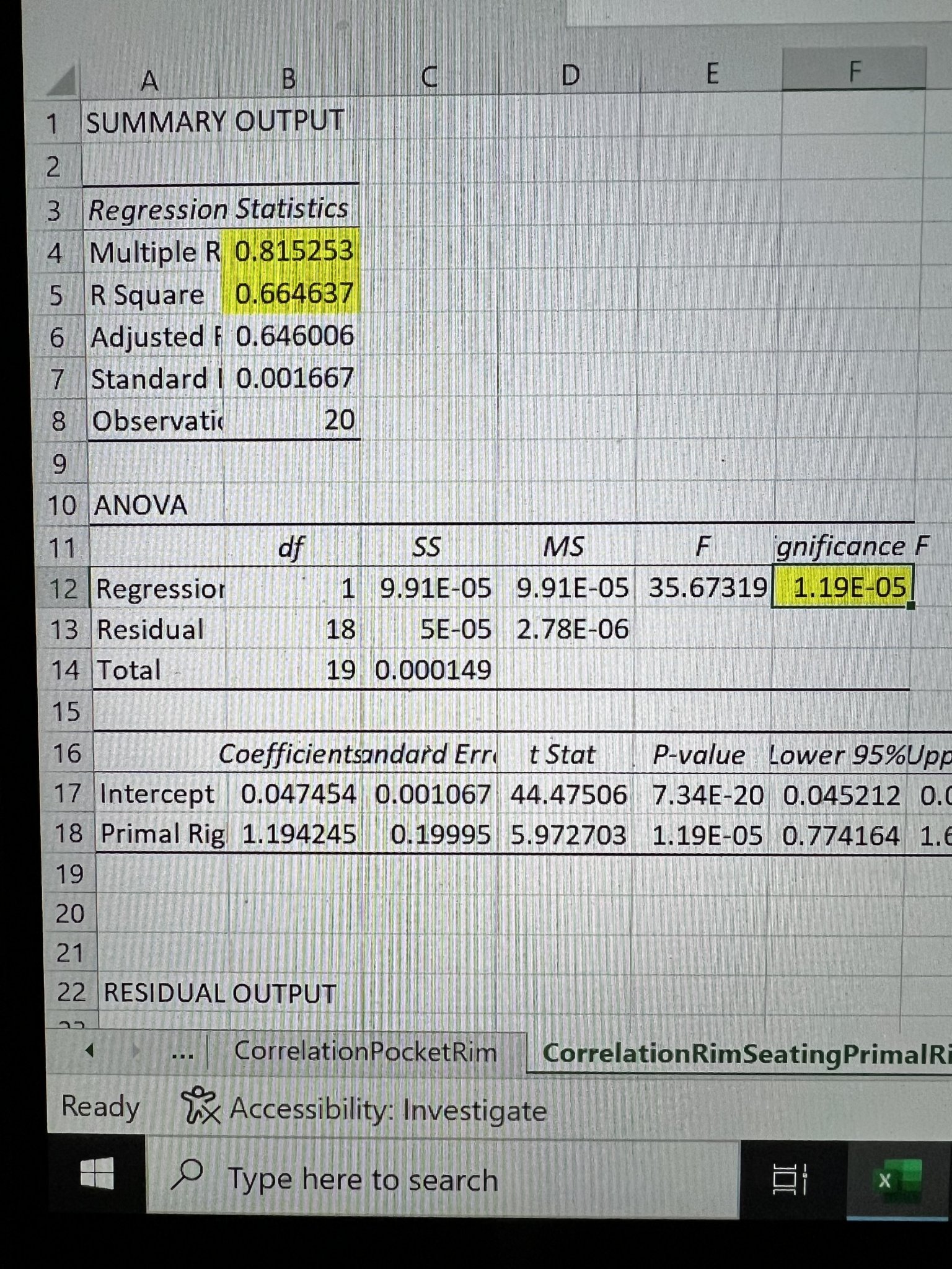

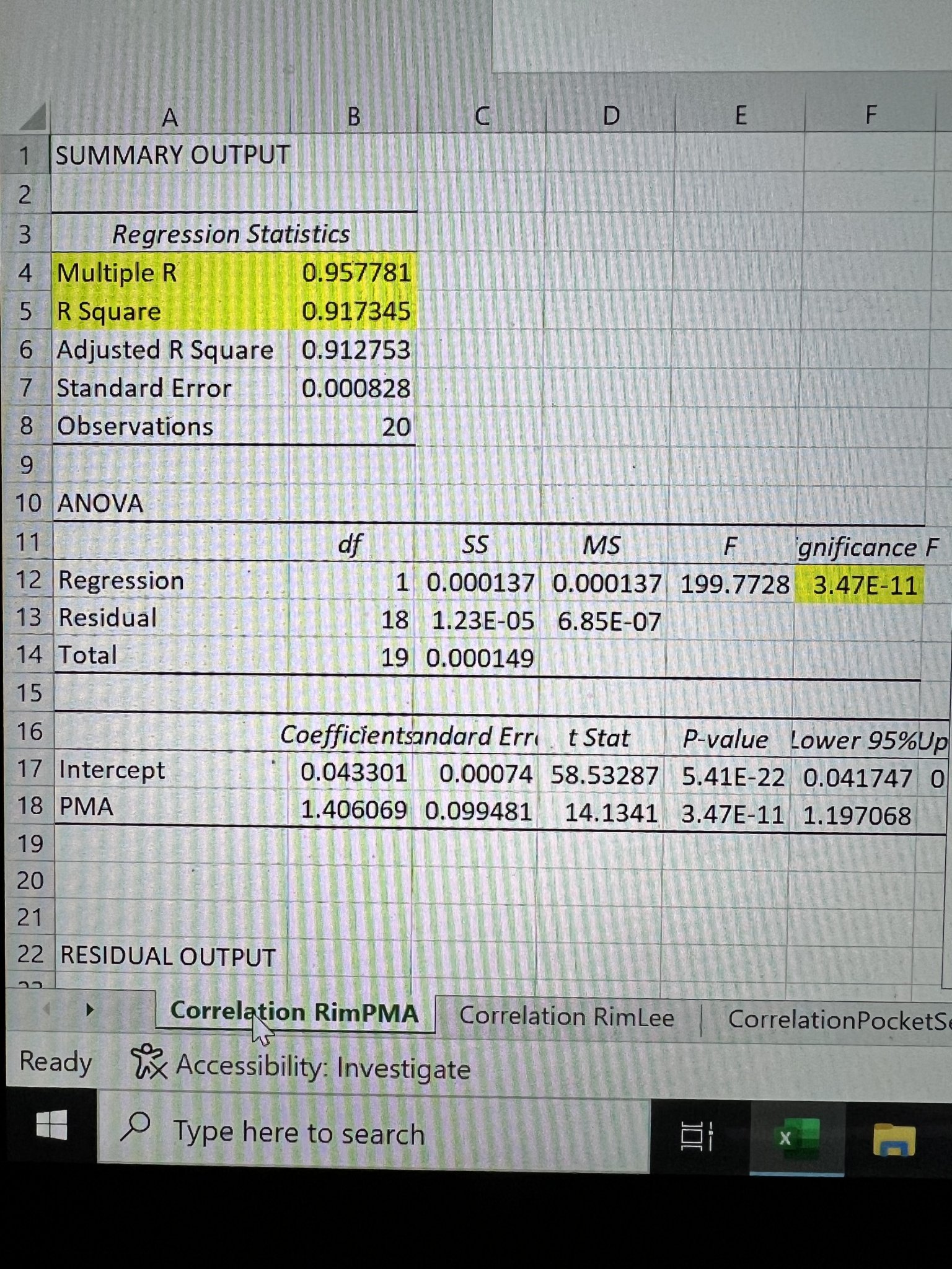

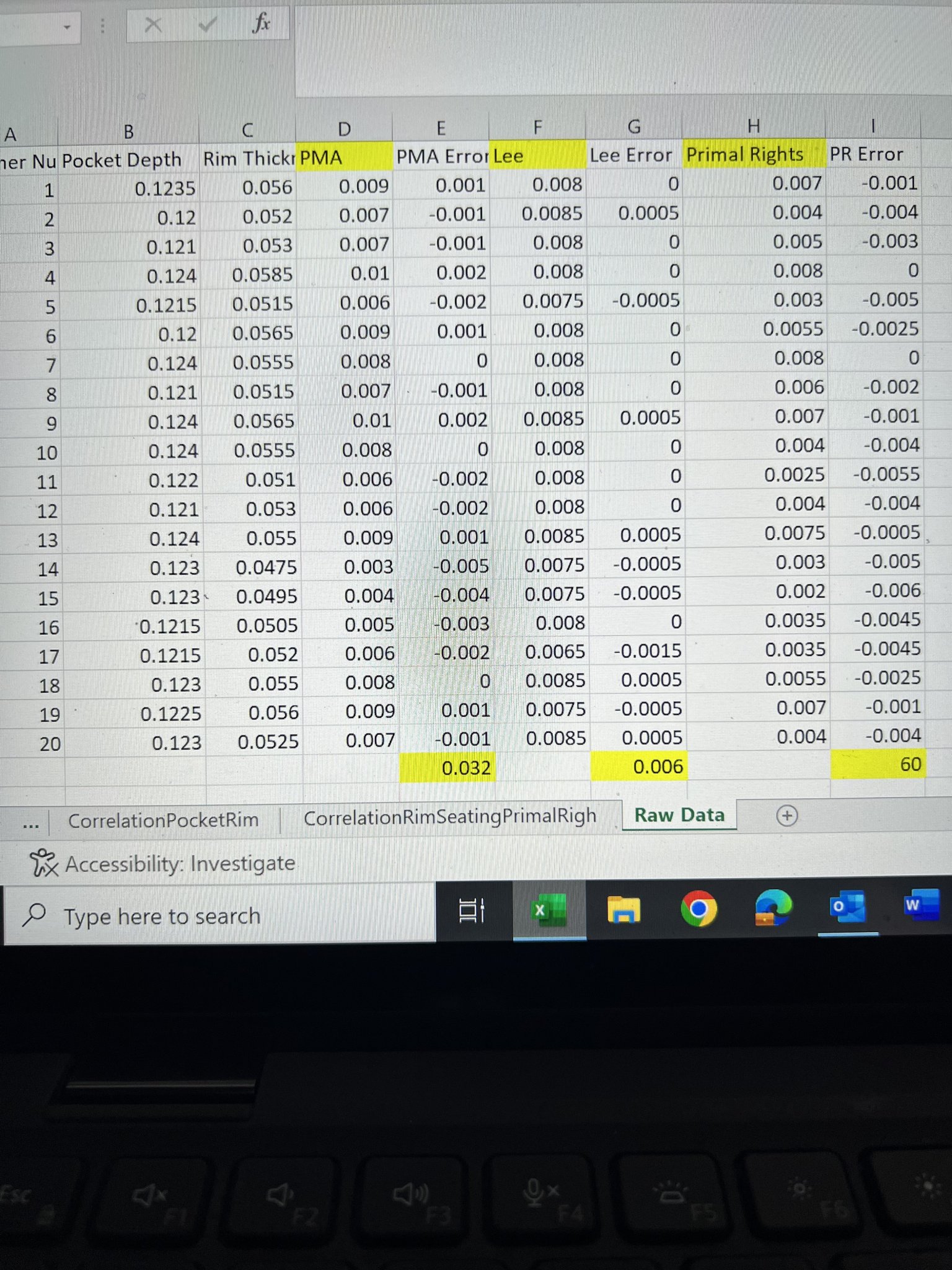

Which is why I'm slightly confused why it's not pretty common knowledge that if you seat a primer using a shell holder, and then take a measurement using the bottom of the case as a datum, that you will always have at a minimum, the difference in rim thickness from case to case as an "error" in the measurement.
People have argued before (typically when talking the PR CPS) that it's a user error thing.....when it's literally just a function of the system design.
It’s physically impossible for a system using a shell holder to have consistent results unless the rims are consistent.
Anyone who’s showing consistent results with the primal rights (or others using a shell holder), is because the rims are consistent. Be it because they sorted, or their brass is just consistent even though they didn’t sort.
So... kicking the can down the road for the sake of argument... lets say that some systems that reference off the face of the case head, like the (no longer available) Lee ACP or the one mentioned by @Alan Warner and that pretty much everything else references off the case rim. And given the way we measure primer seating depth, that method of seating is going to give more consistent results.
I agree it's not been widely acknowledged as being a big deal by the shooting community at large because hell, exact primer seating depth hasn't been the limiting factor for most people for a very long time - and still isn't, outside of BR and maybe top-tier F-class. Keith Glasscock (aka 'Winning in the Wind' on YT) has grumbled about the way primer seaters referenced off the rim for a couple years now, and has been kicking around an idea for a different design. That said, I know I lose way more points to wind and gun handling than I probably ever have anything I could attribute to the primer. But, like the late Glenn Zediker said way back when, 'making the target bigger' by way of making the group smaller is never a bad thing.
So, all that aside, even just comparing the two devices in Bryan's test that *both* referenced off the case rim - the PMA hand priming tool, and the CPS - why do we think there was such a marked difference between those two?

I have no idea. The PR seemed like a robust system but showed a systemically shallower seating depth. It seated perfectly to .008” the primers that the PMA and Lee seated to .008” so for whatever reason, it was shallower with most others which is why it produced the higher error. Please note too that I did a “double” and pulled the handle to where it stopped twice for all primed brass so the full force was applied twice. I’m miffed.

Just with more variation, and a tendency to seat shallow, correct?
Yes. I attached the data. The PR tended to seat shallower than the PMA. Also, the PMA seating depths were accounted for by 92% of the variance in rim thickness whereas the PR depths were accounted for by 66.5% of the variance in rim thickness so there is another 33.5% of the variance explained by something else. In the video I suspected that the PR has some kind of weaker seating mechanism relative to the PMA which is why the PR was overall more shallow in seating. Just a speculation.

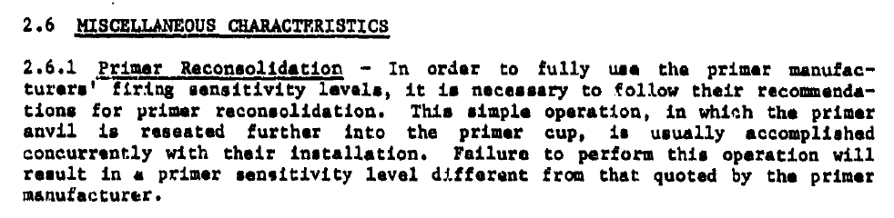

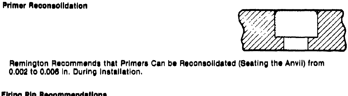

I like to call it “anvil compression” but I hear and read the term “crush” a lot. Are we saying the same thing?
Bryan,
As far as I know, "crush", "anvil compression" , "reconsolidation" and "sensitizing" in this specific context, all mean the same thing, i.e., pushing the anvil down into the primer cup and "crushing", "sensitizing", or "compressing the anvil" on the pellet of priming compound.
In the old DoD primer design specs, the term was called "sensitizing" and "primer reconsolidation"...
The typical OEM recommendations ranged roughly 0.002" to 0.006". Our typical nominal goal was 0.004" to give us the middle of their recommended range.

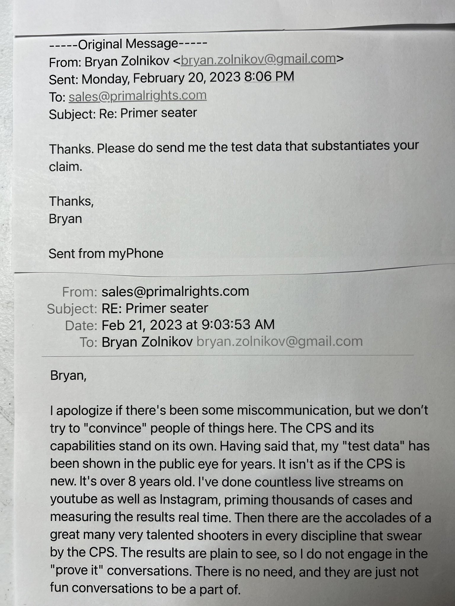

Please don't misunderstand, my comment wasn't directed at anyone who bought one, at least it's easier on one's hands and it's their money, they can strive for excellence, and they can light it on fire if they want to (wait, I do that too lol).
But ummm, anyone who's been on the forum for a few years who doesn't have amnesia remembers that douchebag snake oil salesman telling dudes that we didn't know what we were missing if we didn't pony up for one... I mean the great Erik Cortina uses one (that I'd bet $1 he didn't pay for lol).
There's lots of that in this sport, Area 419 is coming out with a $900 chamber-flag just in time for Black Friday.
Yes, gotta be careful of the snake oil salesman. Tons of zombies following them and lining the pockets of the salesman while gaining no benefit but becoming a stout brand loyalist who will attack you if you say anything that can be perceived as negative to their master. Attached is what that PR person wrote back to me when I asked for data in the PR while I was deciding on what bench primer I wanted to go with. No data for you! I’m just the best! Hahaha! Sure, sure. Unfortunately, he’s probably already made a ton of $ off the zombies and uses them as a force against anybody trying to find the ideal primer seater.
