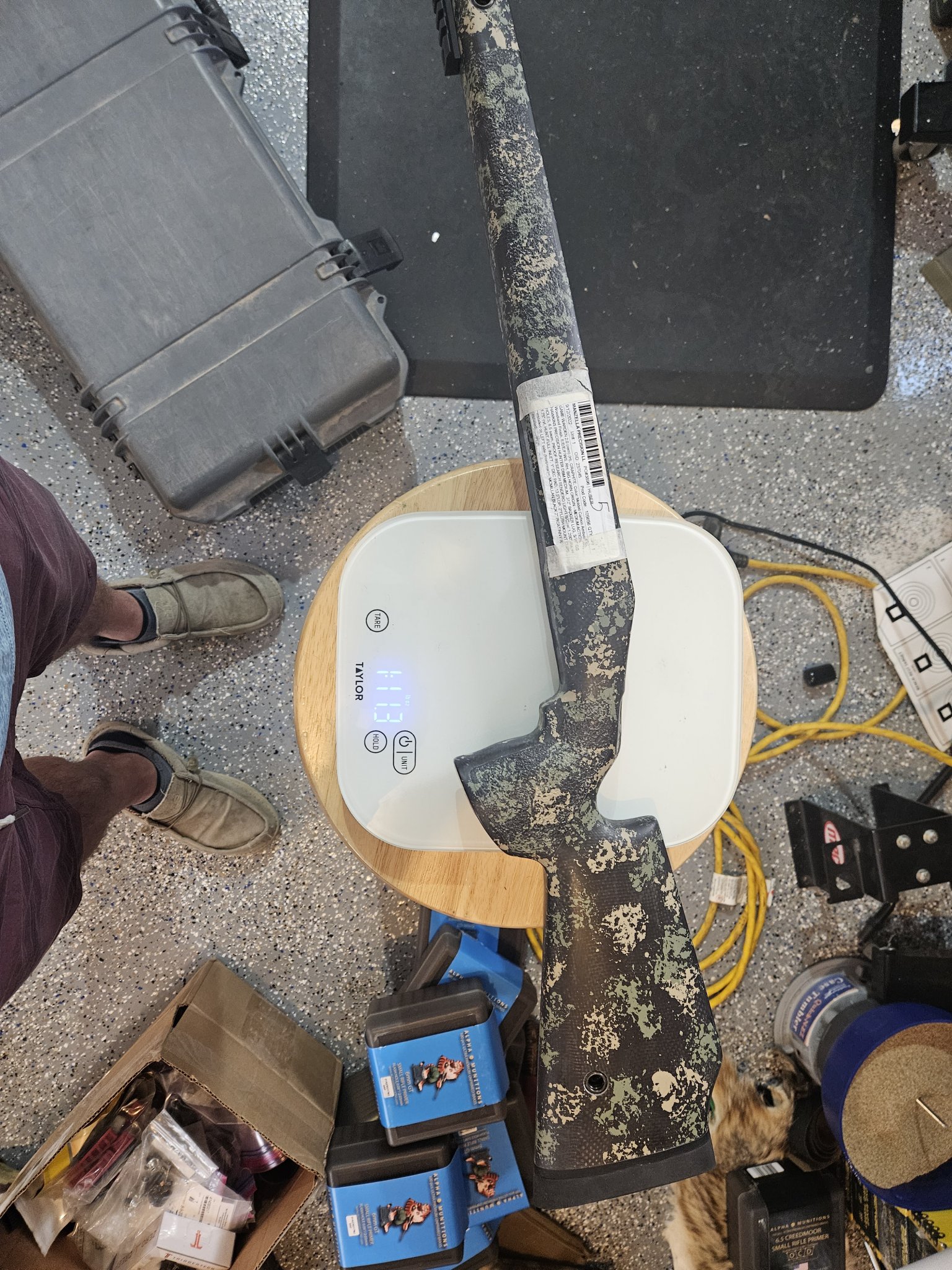

If anybody is searching for an update on the EH1 weight like I was; I just received one and weighed it. Atlas 34 pic rail, two swivel studs, 1” pachmayr pad, aluminum pillars, no bedding yet, 29 ounces.
McMillan Game Warden 2.0, medium length inlet, front Pic rail and 2 qd cups L side. 27oz.
