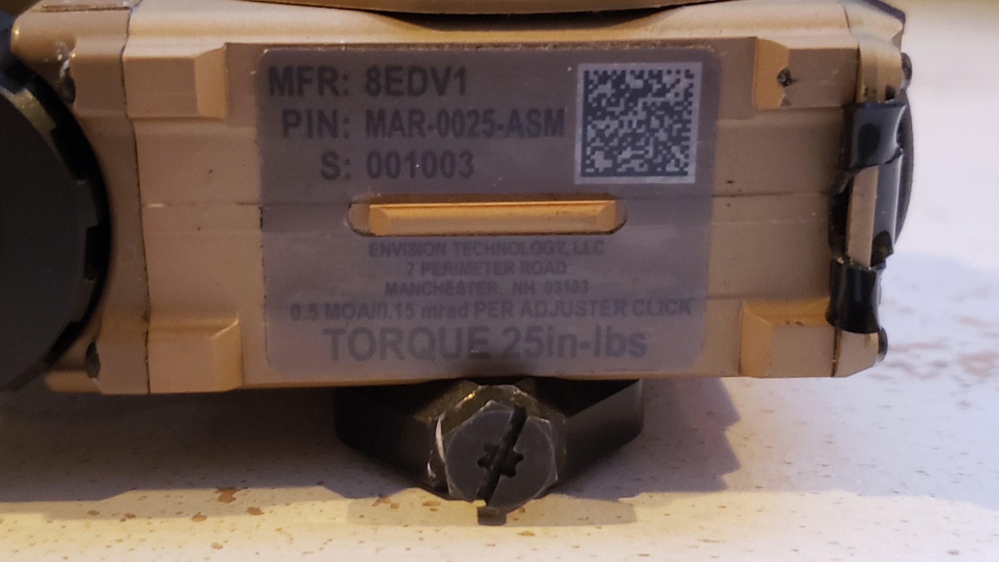

The MARS-Lc is about the size of a business card from a length and width perspective. From a height perspective, it’s cleverly just tall enough for the display to clear taller turrets you might see from a ZCO, Tangent Theta, Hensoldt, Schmidt & Bender, and Leupold, as well as many others. It’s overall size is absolutely tiny while still maintaining full usability. MARS-Lc fits perfectly on a SPUHR rail, but is also compatible with other 12 o’clock rails such as the Badger COMM and EraTac solutions. I tested it first hand – it works. For clarity, MARS-Lc can also be oriented at the 9 o’clock and 3 o’clock positions should the end-user have a preference.

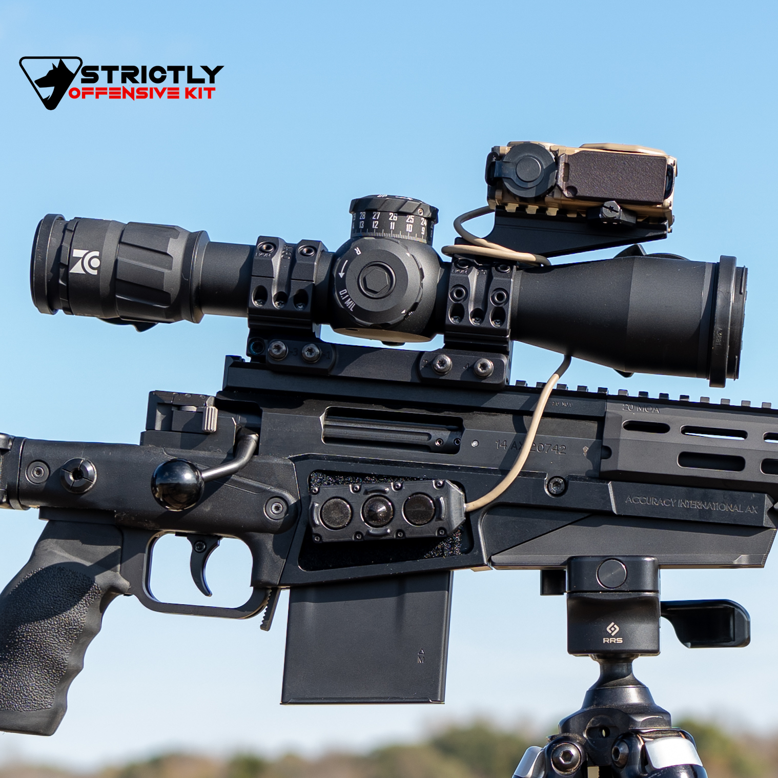

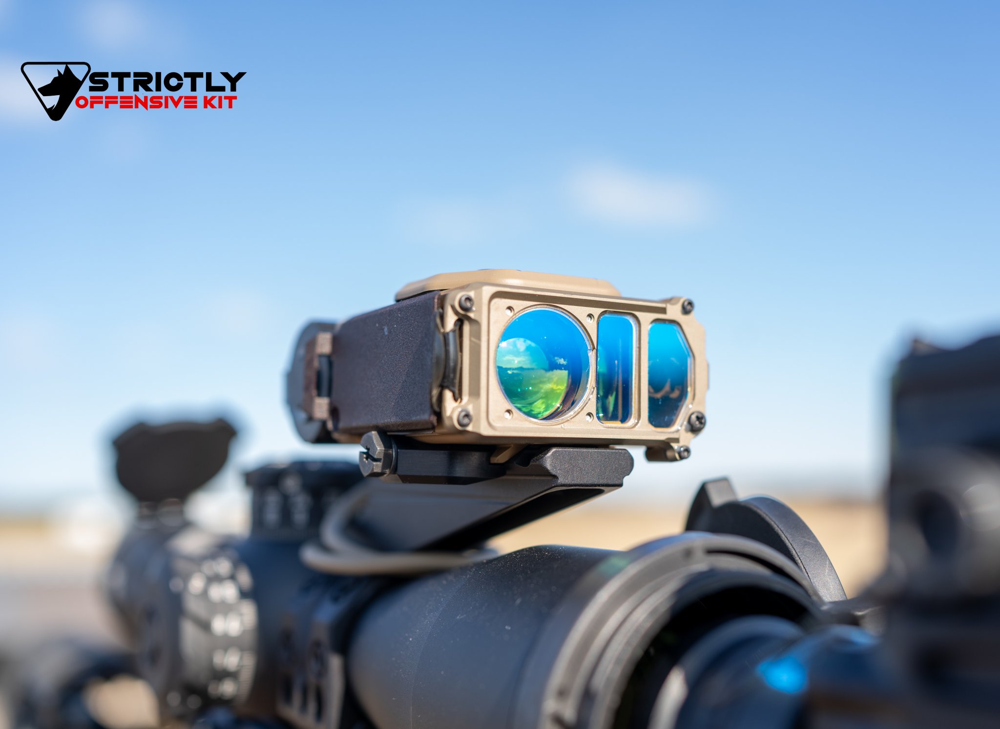

Mounting: MARS-Lc uses a single pic rail slot with one bolt that fits a socket, but also cleverly in the center will accept a Torqx key. It’s a pretty nice unexpected touch. The mount itself is rock solid; we did not experience any zero shift under recoil. That’s a hard requirement for my use case and I’d accept no less.
Battery: MARS-Lc runs off of a single CR123 and displays battery levels directly on the display. If you’re running low, it will be obvious it’s time to change the battery. While I can’t tell you exactly how many ranges I got off of a single battery, I can tell you that I use MARS-Lc almost daily and have only changed the battery once. It’s quite efficient given it’s powering an LRF Module, Onboard Computer, Display, Lasers, etc.

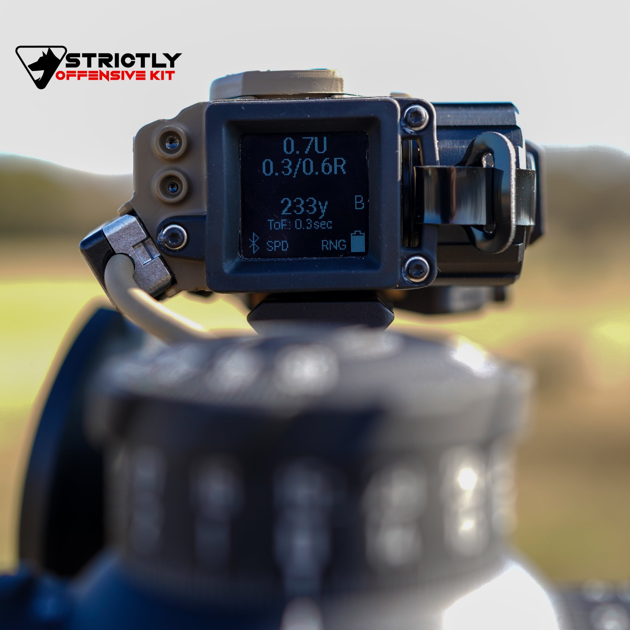

Display: MARS-Lc provides a nice square display that is configurable for brightness (including auto), additional feature layouts such as ToF, Cant, etc., and yet everything is still easily seen while deploying the weapon system. The display is also easily seen over even the tallest of turrets which I originally speculated based on its size, but clearly I was wrong.
Display Orientation: MARS-Lc, being a square display, will shift based on where you mount the device: Left, Top, Right. Being that it uses a square display, it simply shifts based on what setting you use. I prefer Top as its most useful to me right on top of my day optic.
Ranging or Ballistic Mode: End users can select if they want a ballistic solution or if they only want to see range. Admittedly, I really only care to see my ballistic solution, but if that’s not your use case, then you can setup it up to send a range only.
Units: Much like you would expect, MARS-Lc displays Mil/Moa, Meters/Yards, etc. If you have configured your Kestrel to work for you, you can configure the MARS-Lc to do the same.

Remote Trigger: MARS-Lc comes with a remote that cleverly hooks into the side of the device and is unintrusive to scope turrets. The cable can be routed to a convenient location allowing your trigger finger to manipulate the controls which are 3 buttons, the same 3 buttons on the unit. The controls can be inversed depending on how you setup the remote that way it’s always natural to the end-user what button they’re pushing. When you hit the ranging button, you get a quick but silent vibration to your finger that lets you know when MARS-Lc has completed the range and solution. Pretty dang cool and totally unexpected!

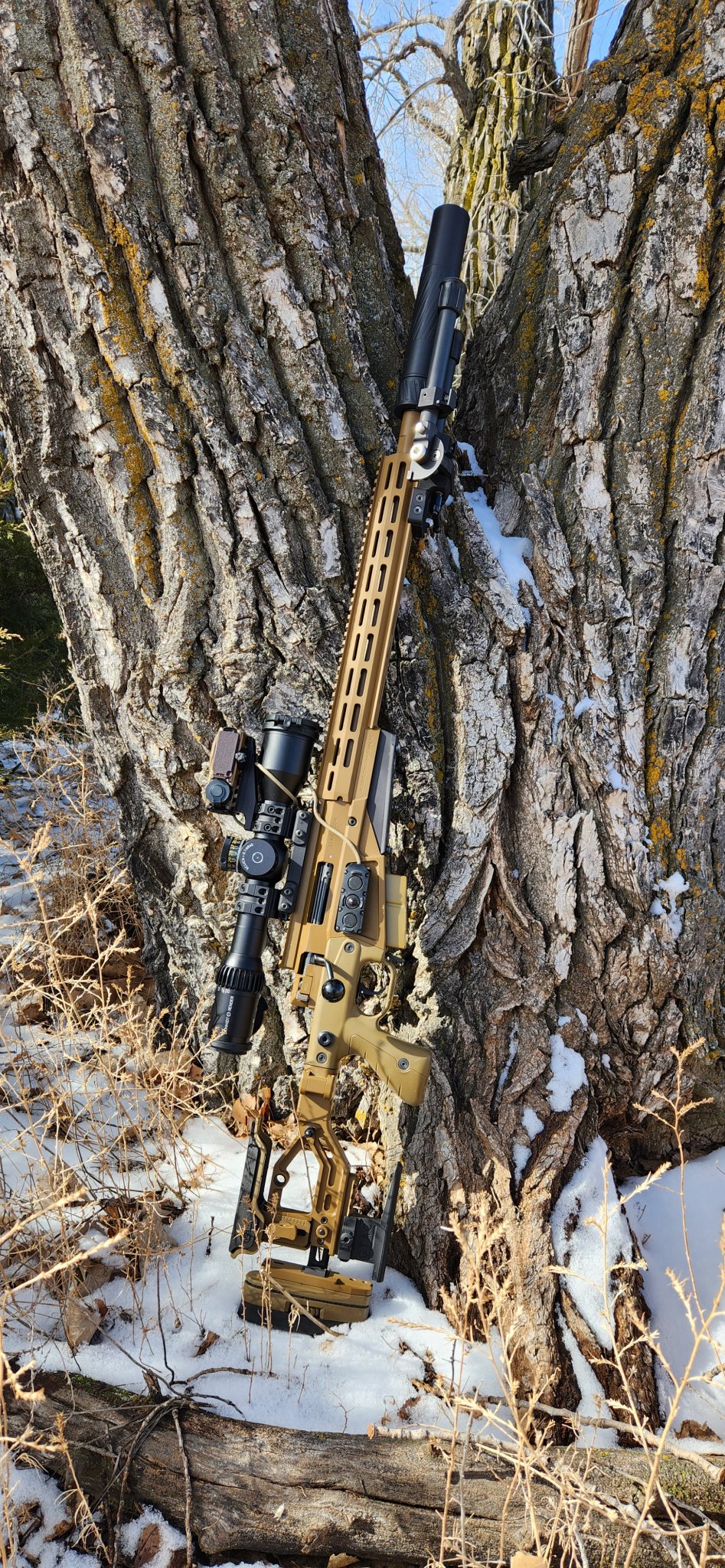

Long Range Hunting: This rig pictured is a LP Ti-Razor LA, 300WM Proof Carbon 20”, Manners Carbon Stock, Trigger Tech, SPUHR with Rail & S&B 320 US weighting in at 9.75lbs with the MARS-Lc. In my eyes, this application isn’t as traditional for WMLRFs since we primarily see them on heavy rifle systems, but I’m here to tell you that there’s no disputing how useful it is to get a shot off when you may be working with seconds before your target species has moved out of sight. Add in the complexity of canyons, angles, and range, it quickly becomes a mandatory tool if budget allows it.

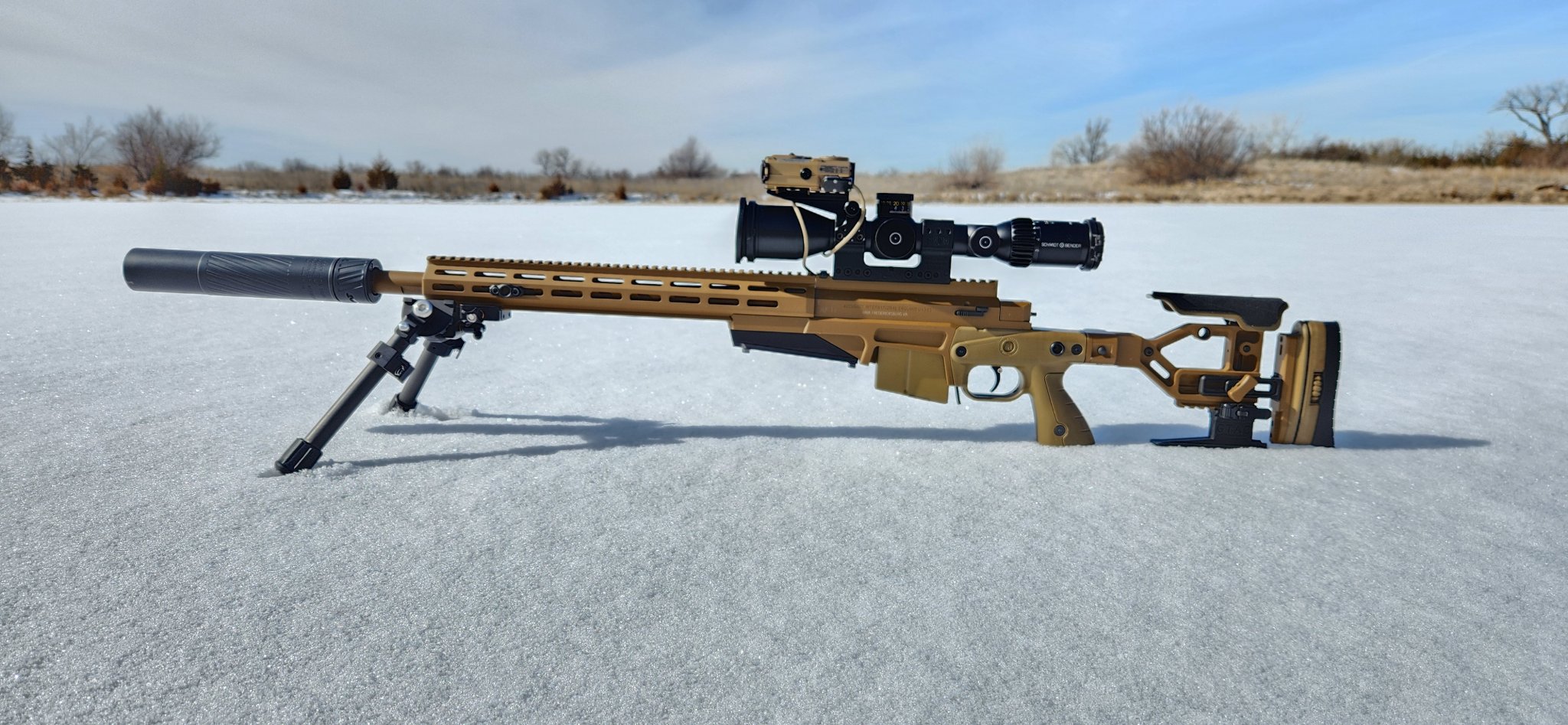

Competition Rifles: MARS-Lc, among many other WMLRFs with AB, have been seen at recent competitions where majority of the leader board had this distinct advantage. I’m not a competition shooter so I won’t dive into the nuts-and-bolts of it, but I’ll speculate that it provides enough advantage that they’re becoming more mainstream.

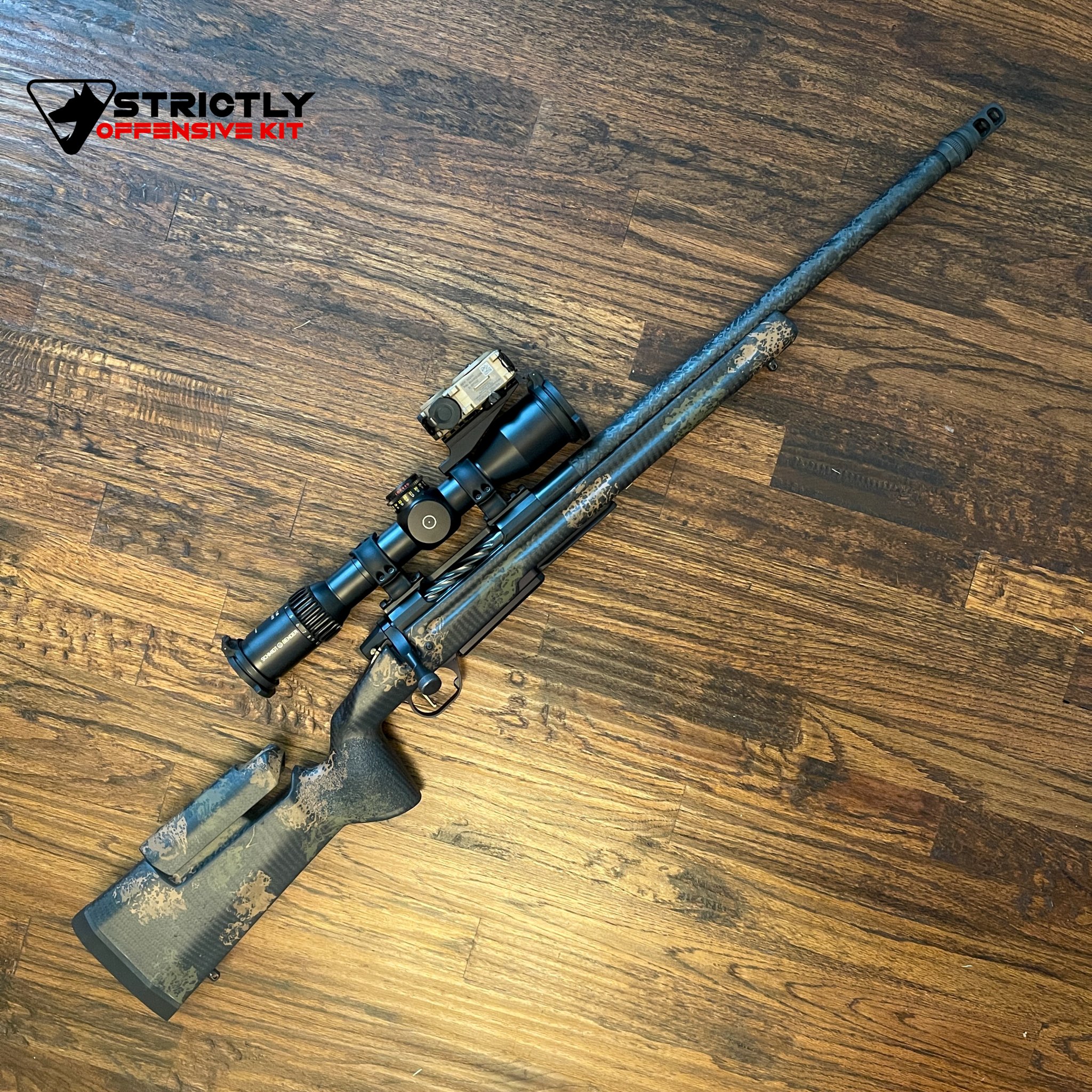

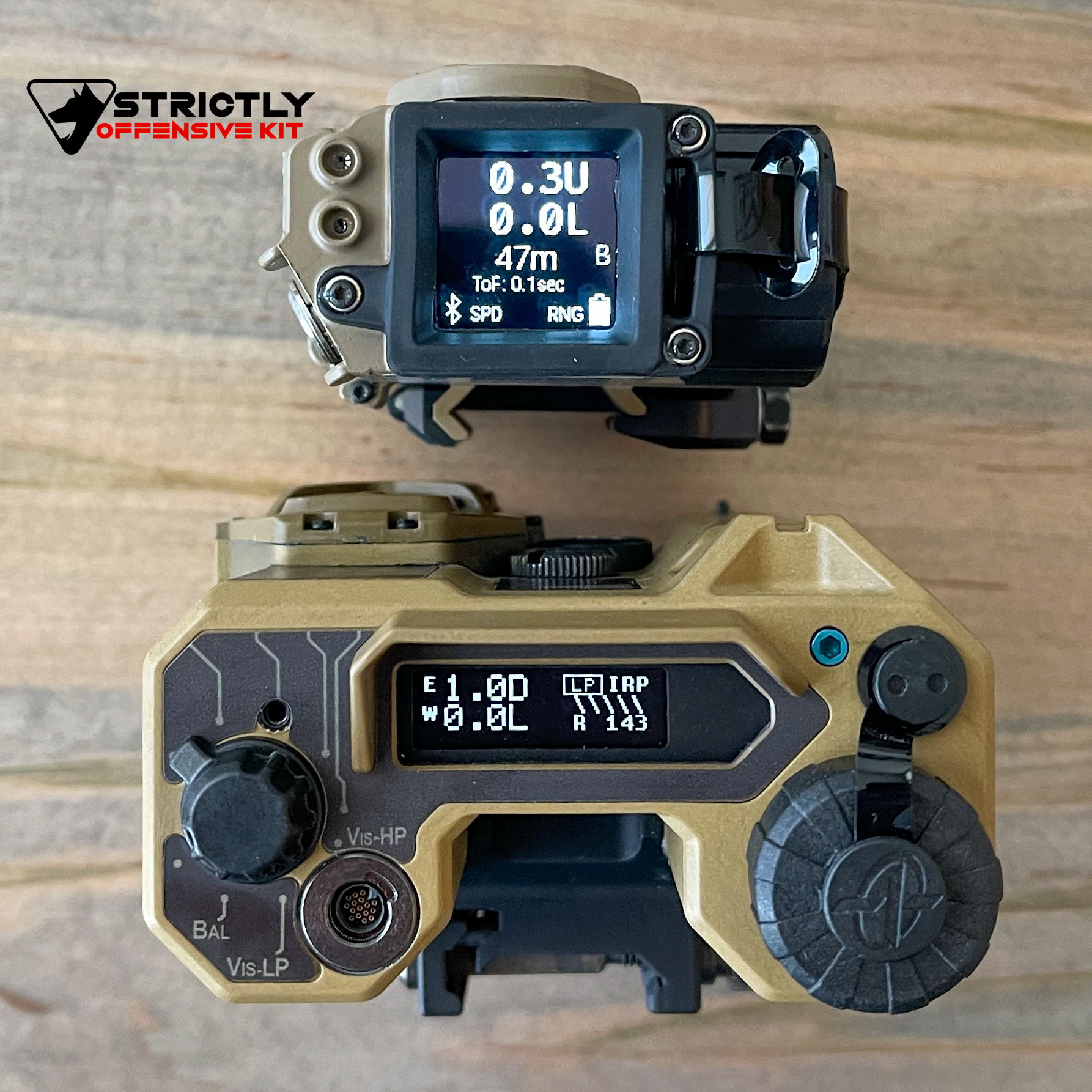

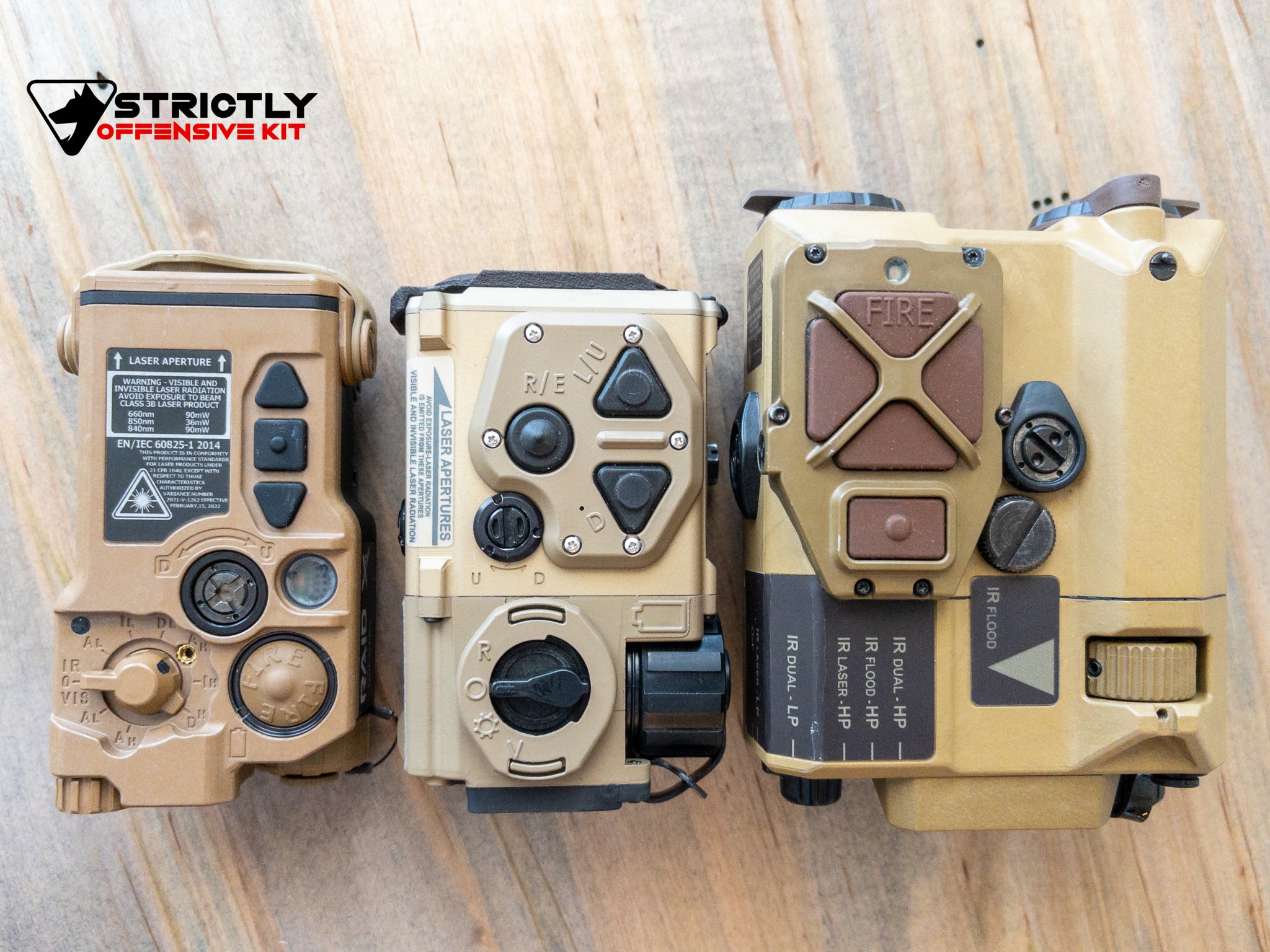

The Raid Xe is 6.9 oz with a CR123 just like the MARS-Lc, and they're nearly the same size. Lot of punch in a tiny package.
Check out the displays, brightness (both on Auto) and the bolded characters. Tho a little deceiving in the photo, the characters are much larger, but because of the overall length of the Raptar pulling the display closer to the camera, they appear closer than what we seen in reality.

Got my unit this past Friday from Mike over at ET.. Cannot wait to get some time with it here this weekend.. I will try to add to this thread with pics and my opinion. I'm not a pro reviewer or anything so I'll keep it short and sweet, but the unit itself looks awesome and from what little I have fvcked around my neighborhood with it, it certainly has no issues doing what it was designed to do..
Interested in your thoughts. Keep us posted!
