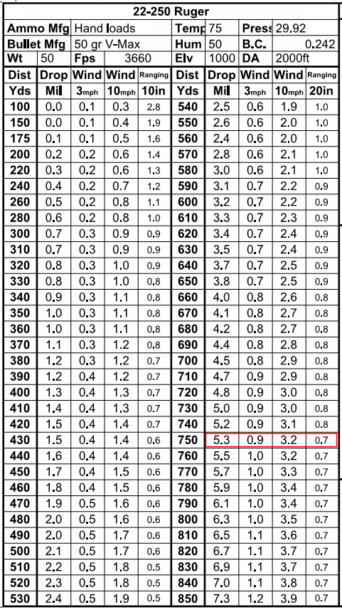

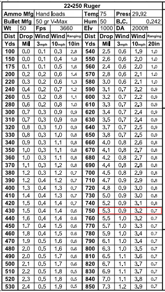

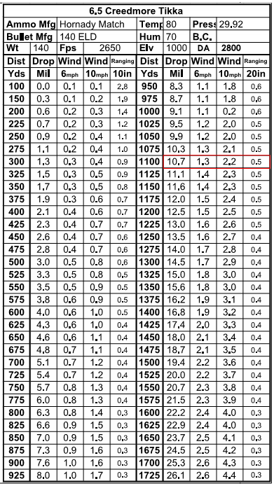

in target shooting, a lot of shooters judge a caliber's effectiveness by the supersonic range. When a bullet drops from supersonic to subsonic is goes through a "transonic" zone that can do weird things to a bullet's flight. Most shooting in PRS style competitions is less than 800 yards, a lot of it less than 600 yards and stage or 2 that might be in the 800-1000 range. Of you can keep your bullet supersonic and learn to read wind really well, you'll do okay with a 22-250 to get started.
For your reference here are 2 data sheets. One for my 22-250 and one for my 6.5 creed for you to see the differences.
Notes
22-250 is zeroed at 200 yards for prairie dog shooting.
22-250 is 50gr V-max (rather than your 55) due to 1-14 twist.
22-250 50gr goes subsonic at 750-ish yards
6.5 creed goes sub near 1100 yards
Can you compete with a 22-250. Yes. As long as you are having fun doing it, jump right in! Just know, you might not be competitive with the other shooters in larger calibers when getting started.

Ok I didn’t know about the transonic thing. That makes a lot of sense though. I had always just looked at the drop or windage at a certain distance which made me think the 22-250 was equal or at least close to to the 6.5 ballistically. Thanks for the replies everyone. It has been enlightening.
Notes
View attachment 7209718 View attachment 7209722
Great breakdown....supports the point I made about wind but also made a good point about the round going trans. Look at that wind at 500 Yards and 10MPH, double the wind hold. But other good points as well around use what you got and know your equipment this does not limit you from competing.....have fun
