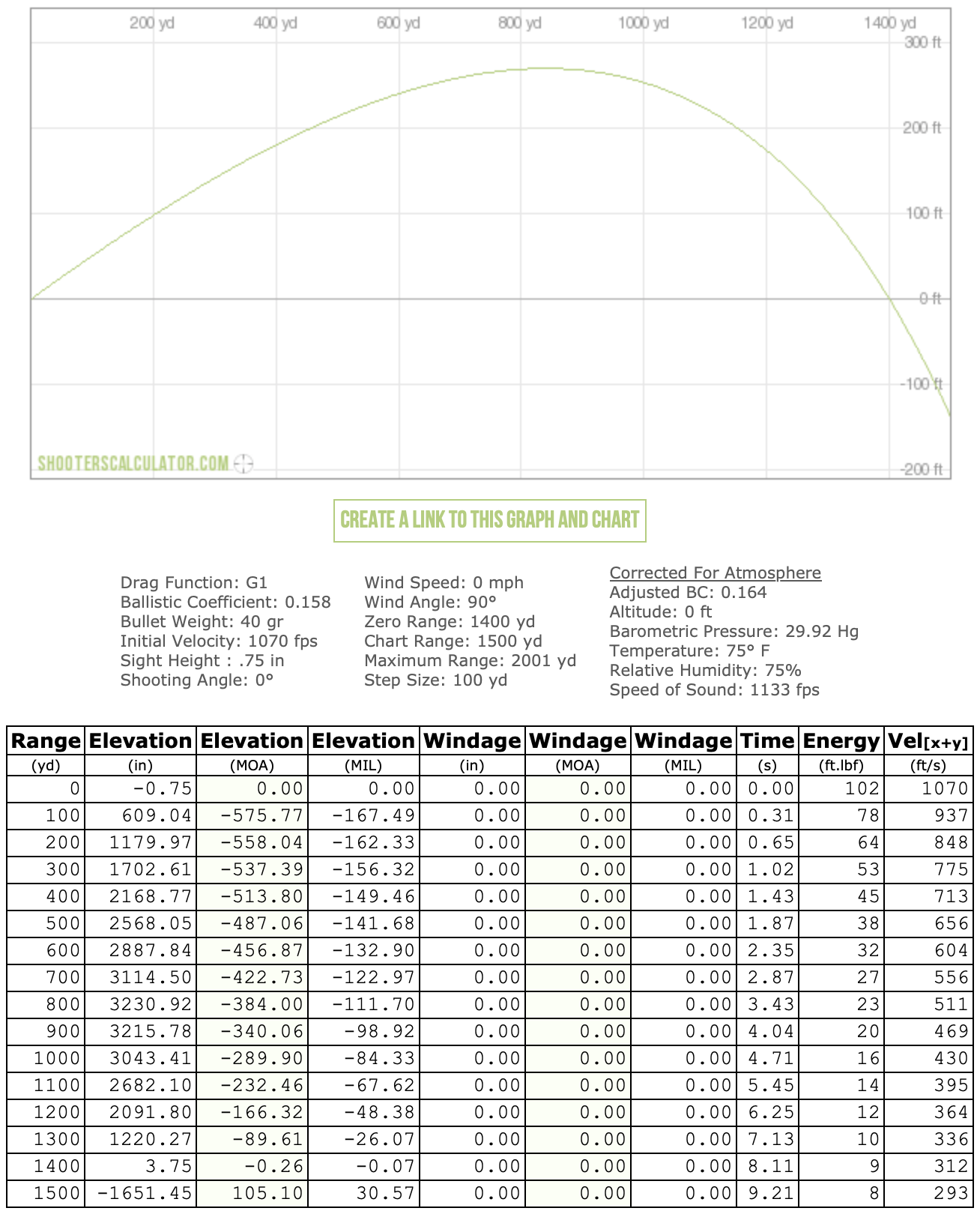

Around WWII, US army conducted time consuming and exhausting tests on several brands of 22 LR ammo with MV=1050-1100 ft/s. In conditions close to standard atmosphere, at sea level, the maximum range obtained for 40 grainers was approximately 1400 yards with bore elevation 25-30°. This was a looong time ago. Have they repeated the tests in modern times of radars aviability with 22 LR ammo manufactured not so long ago?

As already said, constant BC rarely works good for calculation of extreme range trajectories , no matter what drag function taken. Point mass trajectory models based on appropriate zero-yaw drag coefficent functions are better, but also can be sometimes quite off .
The "WWII calculation" was actually a real world firing test. Calculation based on 300 yards ballistic charts of a typical 22 LR in 1940. would yield ~1800 yards- G1, ~1600 yards- RA4. The reference says measured was 1350-1400 yards...I don't know anything else, what riffle or twist rates were used, what spread or if beaten zone was determined etc. But it's not 22LR that behaves in an odd way.
