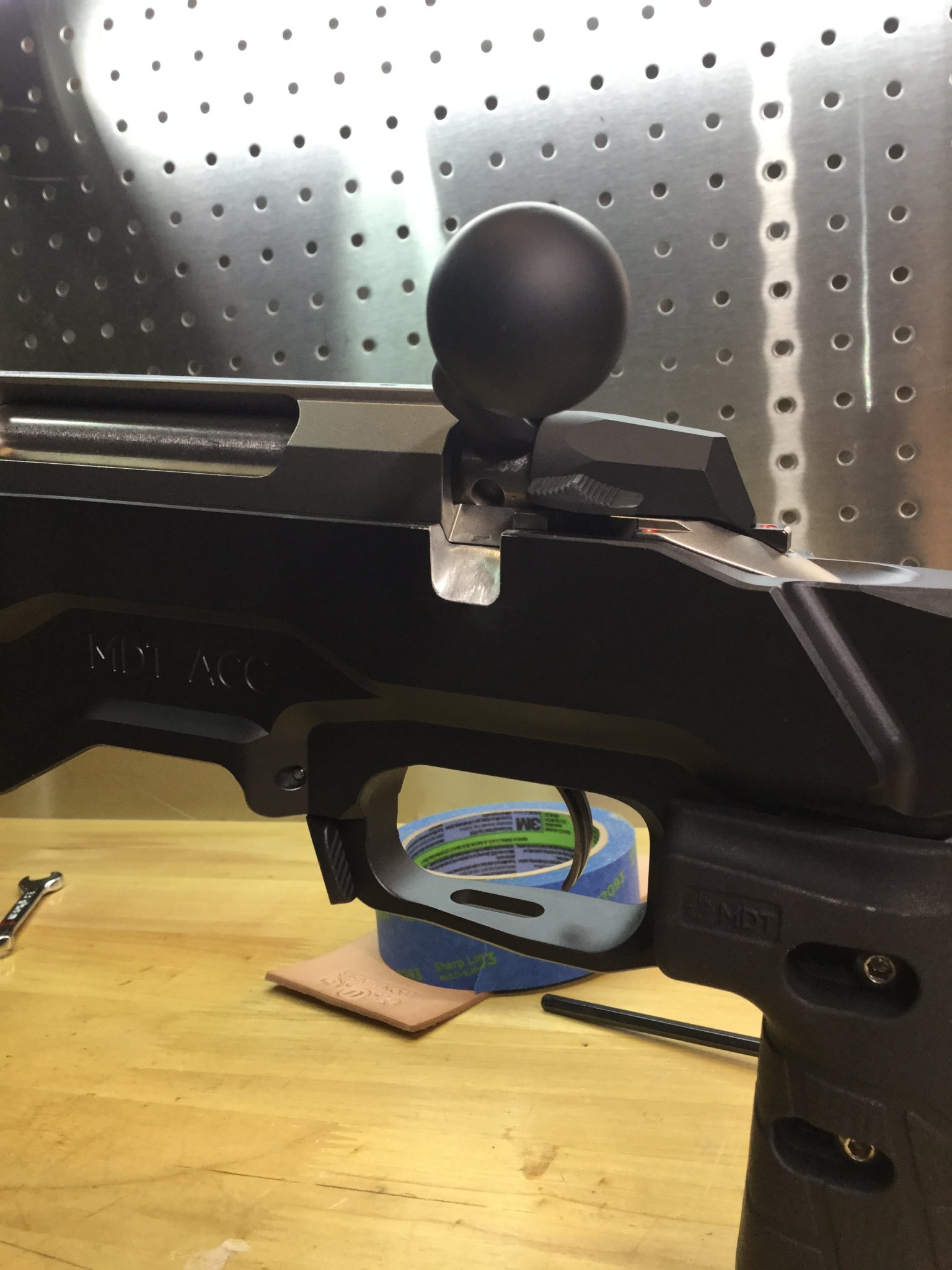

Today I was throwing some Krylon on the old MDT ACC Chassis to make it blend a little better into the weeds. For some reason I could not take my eyes off the bright red TriggerTech Diamond that was showing through when the bolt handle was lifted....so I take a rifle that was shooting great....and take the chassis off the barreled action and sponge paint the side of the trigger housing that was showing through. I also took this time to install a Hoptic quiver. Afterwards I installed the chassis just like your YouTube video and fired a 3 shot group to see where I need to rezero. It was already shooting 1/2" high due to zeroing at 28F the other week and today was 65F and seems that is the distance it will rise using Retumbo. Here is the results after taking the chassis off and reinstalling:
I was going to go for a 5 shot group but I chickened out...heh
My question to you is....is this your normal non shifting POI when re-installing a MDT Chassis...or is it due to my new paint job? Because I may have Uglified it....but she's beautiful to me:
@MDT_OFFICIAL @MDT_Josh
Usually, you shouldn't see much if anything when you reinstall the action.
Chances are that the added paint changed your POI just slightly or it may have been torqued down to slightly different values? Either way, the v-block is machined to repeatedly hold your barreled action, meaning that if you were to re-zero and retry the test, you'd probably be a lot closer to zero without changing anything :)
Josh
Reactions: b2lee

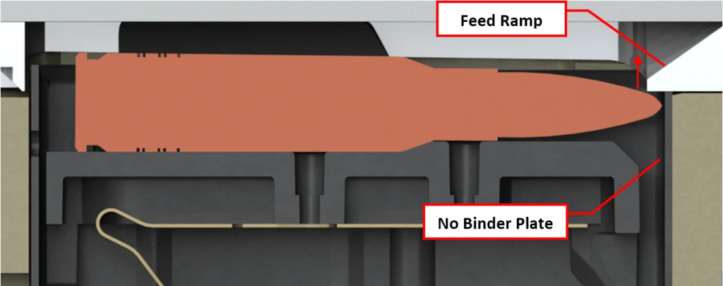

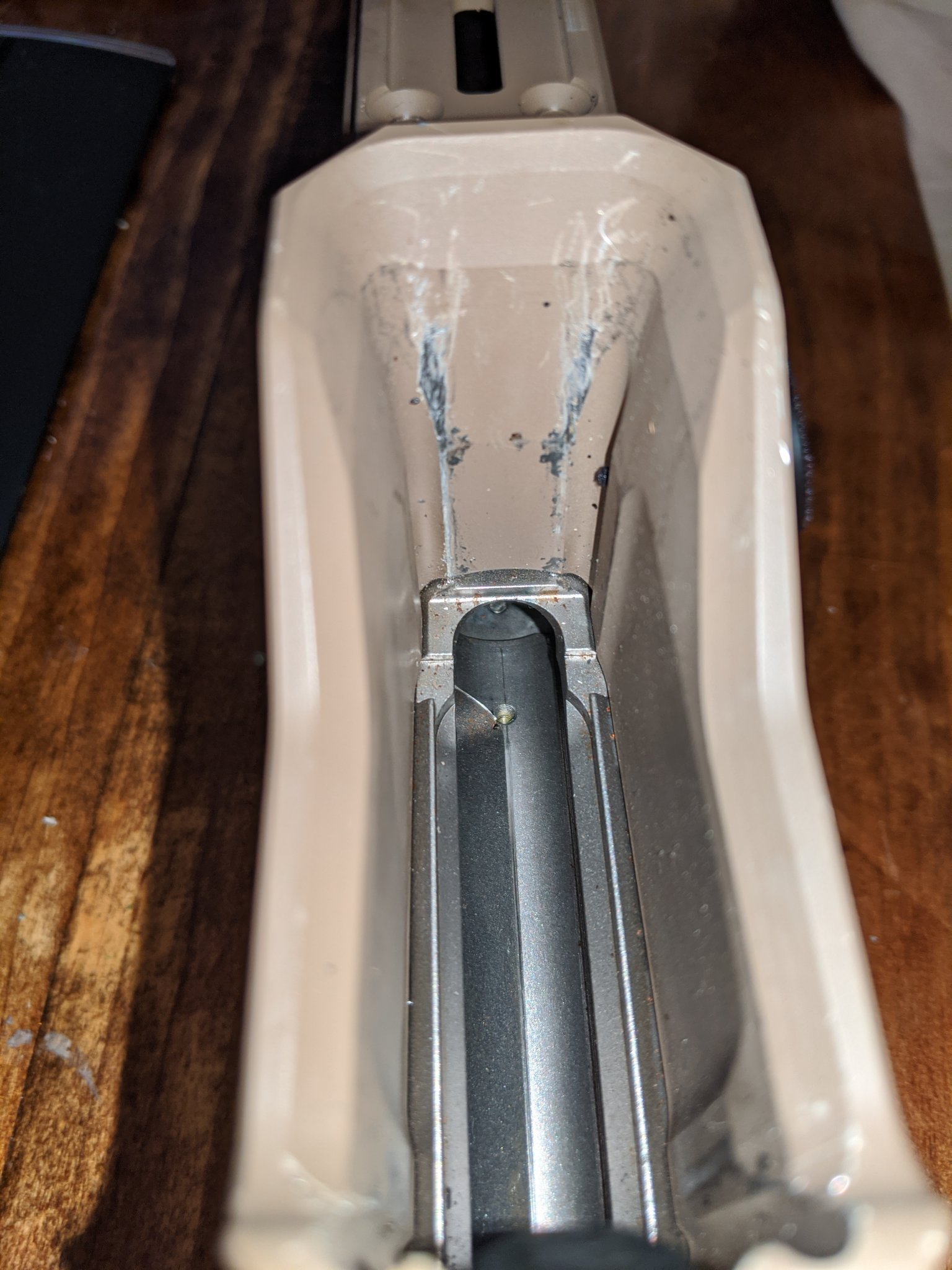

MDT ACC Mag issues on Tikka.
I'm running a Tikka T3X 6mm CM. I shot a PRS match today, never had this issue before, but something would randomly happen to the mag position, not allowing to bolt to go forward. So I would have to drop it and reinsert it. Using a KRG mag with no binder..I just switched my action so only have maybe 20 rounds through it prior it this.. Any Mag recommendations? I would image the MDT ones are pretty solid?
There is a chance that the tip of the rounds were catching underneath the feed ramp of the Tikka if you are using handloads that are approaching 2.950"+. It is unlikely, but for very long rounds, that is a possibility.
Another option would be that the magazine was being pushed upwards whilst you were cycling the bolt (from a bad or prop) which was causing the tips of the feedlips to come up and block the bolt? That shouldn't happen on the Tikka due to the way that the magazine well is placed relative to the action, but again, there is a slight possibility.
What I would recommend is that you disassemble your magazine so that you just have the empty body, insert it into your chassis with the action in it, then flip the whole thing over and see if the inside face of the magazine will clear the bottom of the feed ramp. If it doesn't, then you may have to notch part of the feed ramp out for longer rounds.
We have this pretty well explained on the website:
Let me know if this helps :)
Josh
Reactions: b2lee
Josh
Thanks for the response Josh.
Never had this happen while just out tuning the rifle, but I never put more than 5 rounds in the Mag.
I'm using factory prime ammo 107 . It happened I think on about every stage.. couple or more rounds into the mag. So are you saying I should be using one with a binder plate to prevent that if using factory ammo?
I didn't have time to look into the chamber to see what was happening when it happened. But if I released the Mag about an inch, and reseated it, it would chamber fine. So that leads me to think the mag isn't seating correctly for some reason. Could be a combination of both.
I'm going to try a MDT mag and see how that works.
I will try what you suggested and maybe posts some pic
Reactions: MDT_Josh
It’s not got to do with the ammo, it has to do with whether or not your action allows be clear all the way or if it overlaps a bit at the end of the magazine. If it overlaps the binder plate helps fill up that that space under the action lip so that the bullet, any bullet, will not snag under the overhanging lip on its way up into the action.
Reactions: MDT_Josh
Makes sense. It stated on the KRG site that tikkas dont need the binder so that's what I went with. I ran around 5 10 round mags through it last night to see if it would happen and it didn't. (not shooting) like you where saying, my bag my have been pushing the mag back. There is some play on the rear side of the mag but not the front.
Reactions: MDT_Josh

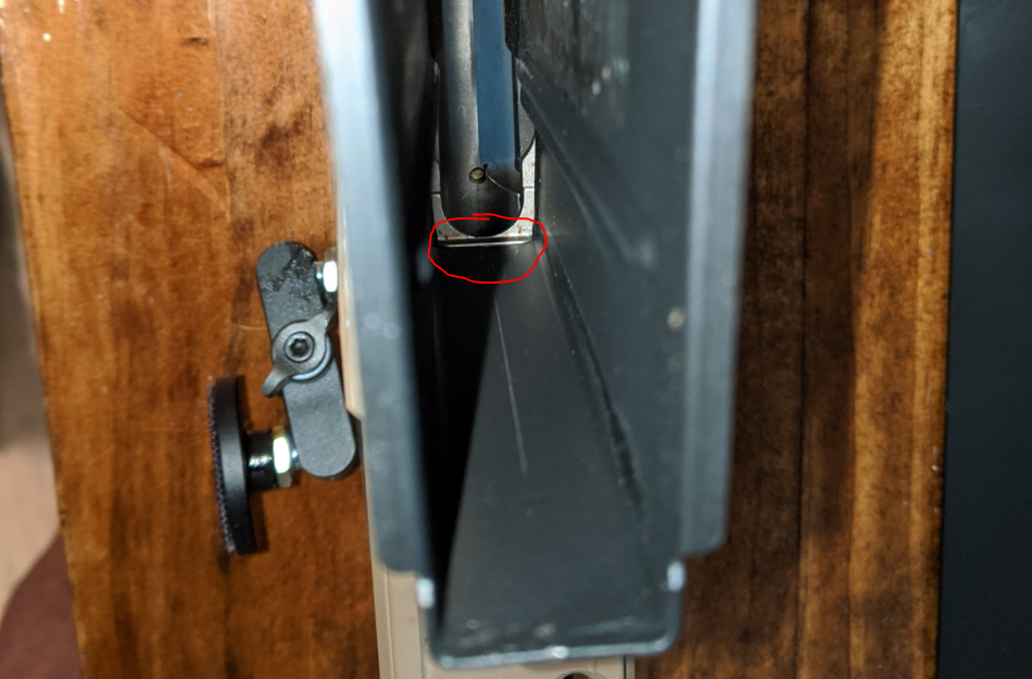

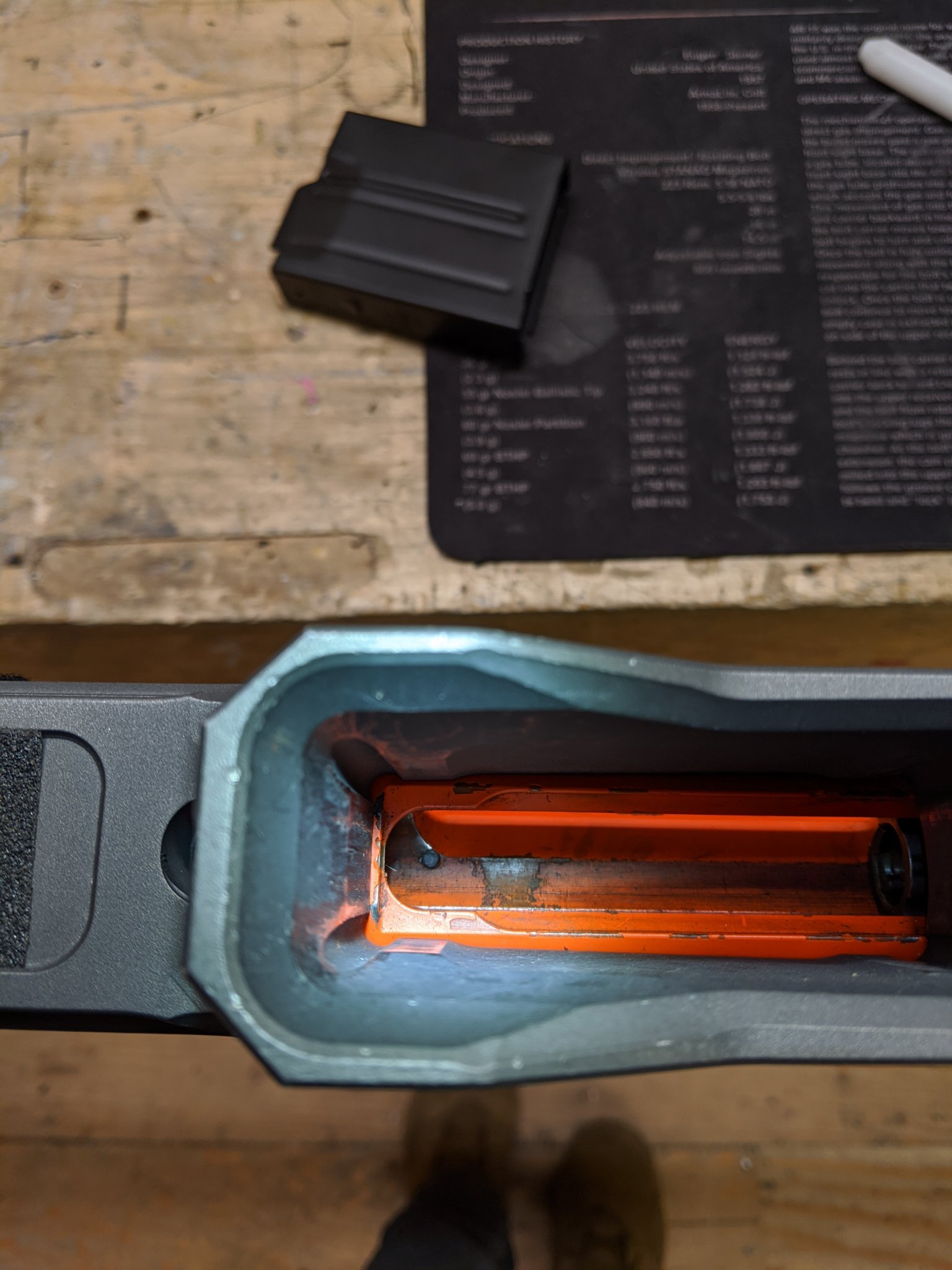

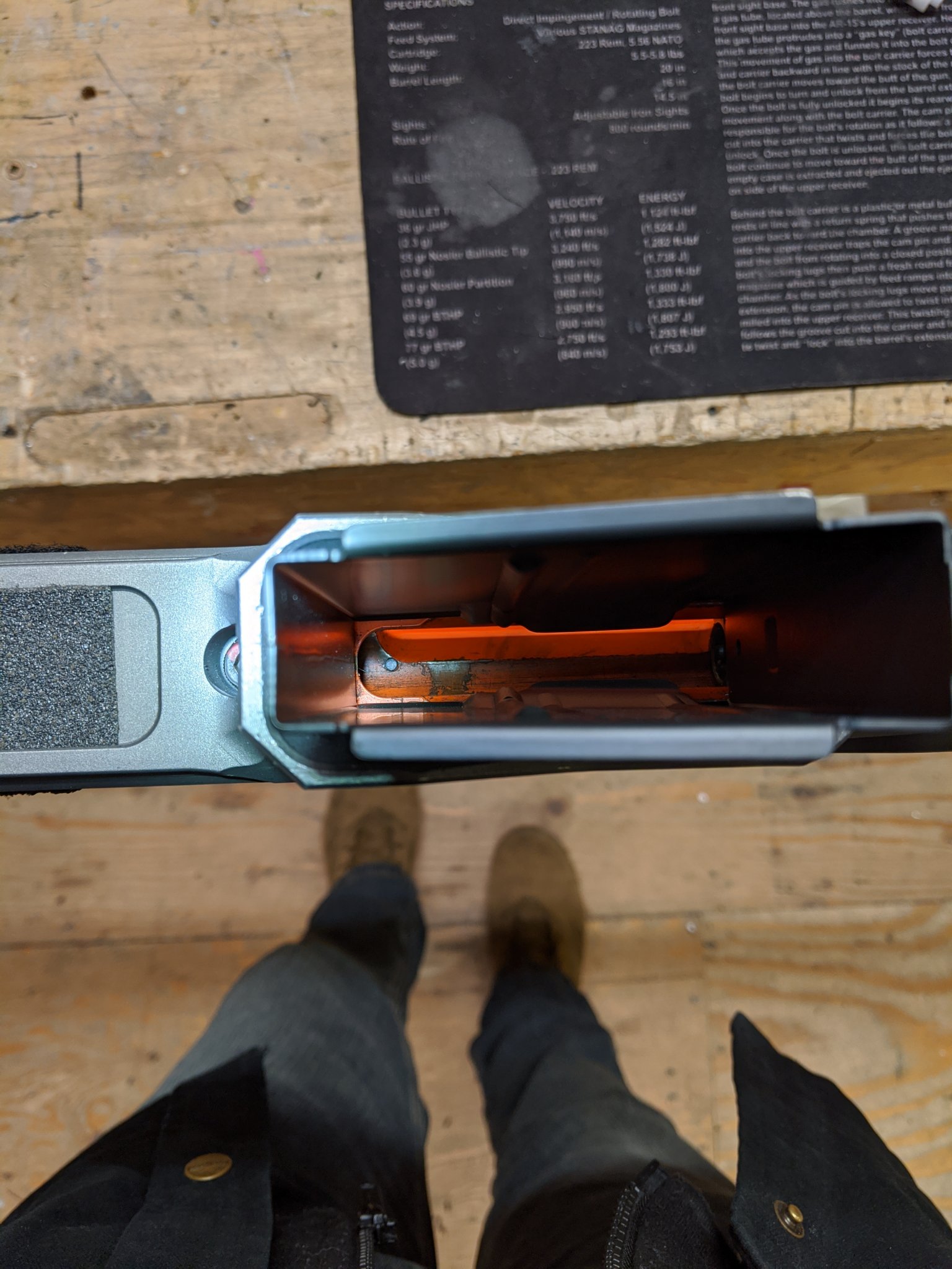

Okay, so your ammo should be loaded at around 2.810" (if I remember correctly) meaning that there should be tons of room for the tip to clear the underside of the feed ramp. Magazine tilt shouldn't cause a round to jam forward, but the rounds shifting under recoil could cause them to slide forward and jam under the feed ramp, if indeed that is the issue. You also wouldn't really see that issue with only 5 rounds in the magazine but with a full mag, it could become apparent.
If you could take a picture of the underside of your setup looking into the magazine well through the mag, then we'd be able to tell pretty quickly :) I'll see if I can get you some pictures to show what I mean.
Josh
Reactions: gnochi
That's perfect! As you can see in the below photo with the circle, there is a little tiny bit of material that is over hanging the font of the magazine:
That would be just enough for the tip of the round to get stuck under if that is what is happening. I am slightly doubtful that is what's happening though as I also have my Tikka in an ACC and have run a lot of rounds through binder and non-binder plate magazines without any issue! Here are the same pictures from my gun:
