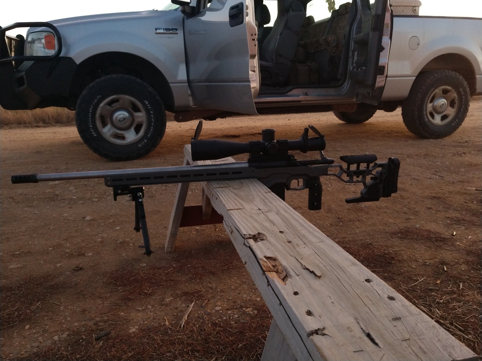

Quick review of fixed vs folding ACC stock and removal/installation for you guys. LOVE the folder, especially when it comes to cleaning.
Big thanks to the guys over @ MDT for sending this over and their continued support of Snipers Hide and the precision shooting community as a whole! MDT has been killing it lately with innovative and frequent product releases !!

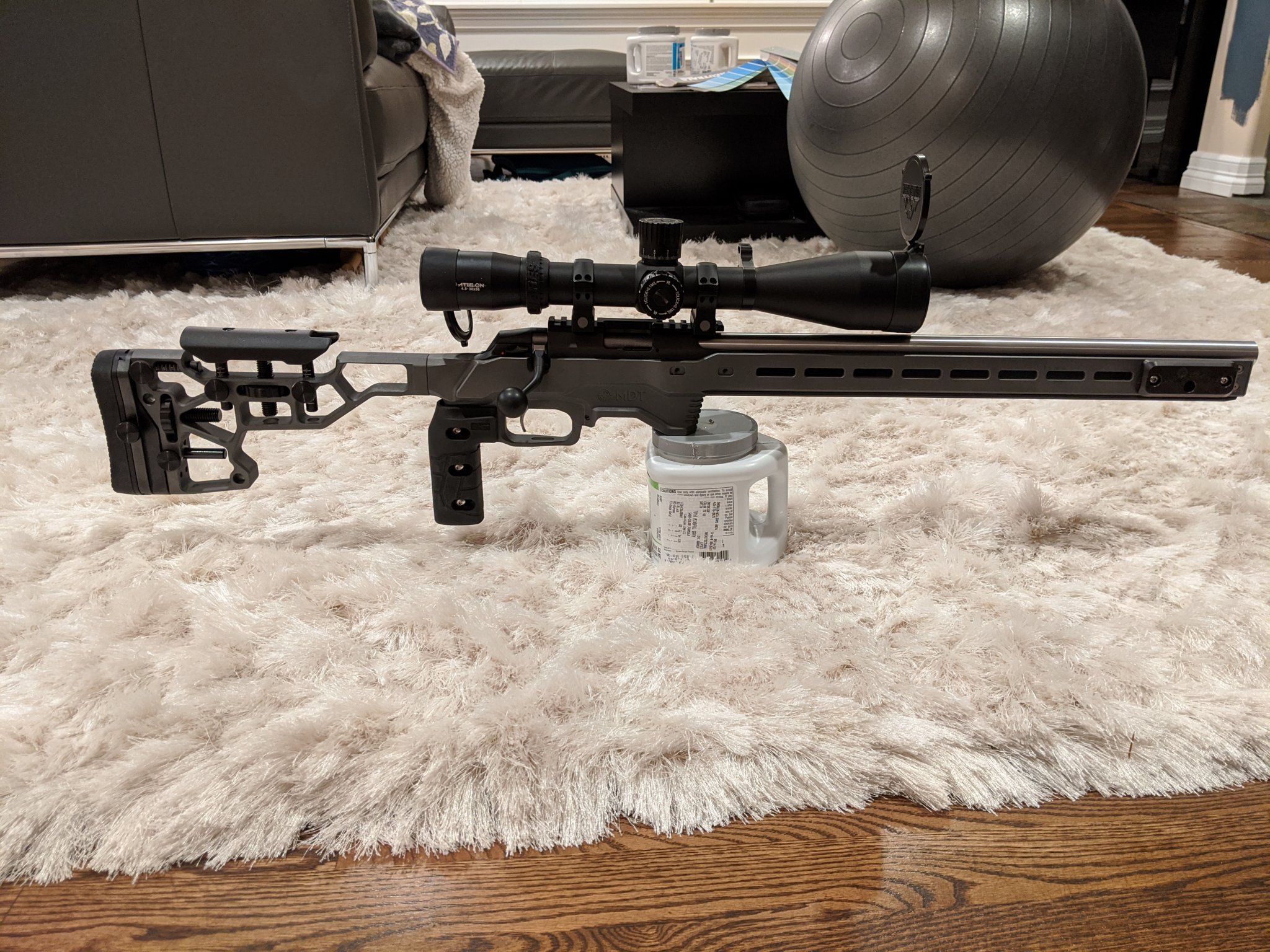

@MDT_OFFICIAL I got my setup put together and wanted to use it for NRL22. It's sitting at 14.5 lbs or so and wanted to lighten it up if possible. Is there anyway to lighten the stock? I know there's a heavy metal piece on the buttpad, is that replaceable with some polymer version? I have the fore-end weights to get it balance right around the mag well. Otherwise way too butt heavy.
Also does your buttstock come with the 8mm allen wrench? I didn't own one and that was a lot of work to get it onto the fore-end. Need to go try to find one at the hardware store, ended up having an 8mm bit for my torque wrench and tried to tigthen it by using some small pliers.

We make an aluminum version of the buttpad base, which we can sell you. Send us an e-mail through our support portal and we can get the purchase set up.

It does not come with an Allen wrench; it is 5/16" for the buttstock to chassis.
You can substitute the included set screws instead of the thumbscrews on your buttpad, cheek riser and length of pull.....it will be minimal..but may be just the right thing for a balance with the front end.
It's hard to get balance right when you are running that tiny barrel.

Thanks, just cancelled my order for an 8mm wrench to get the 5/16" instead. How much weight savings is the aluminum vs steel? Just curious to make the calculations...
Its around a .5 pound difference.

Wow you guys sure deliver. #1, didn't even know your dealer was in WA. #2 I placed this order yesterday afternoon at like 3pm, and it arrived today at my door at 2pm. I didn't realize you guys were going to send it 1-day.
I removed the fore-end weights, ~.8lb difference, and the .45lb buttpad, so 1.25lbs lightened made it much easier to shoot offhand. I can remove the other .25lb from the bagrider, but I left it on there for now. I'm now sitting at about 13lbs I believe which I found comfortable enough to do unsupported prone and standing offhand.
So now I have 2lbs of weights to play with in the future when I move this over to my 308 and if I want to get it weighing around 17lbs.
Thanks MDT!

We do have dealers in WA, however, our main US warehouse is in Washington state. Glad to hear it arrived so soon! It sounds like your set now!
