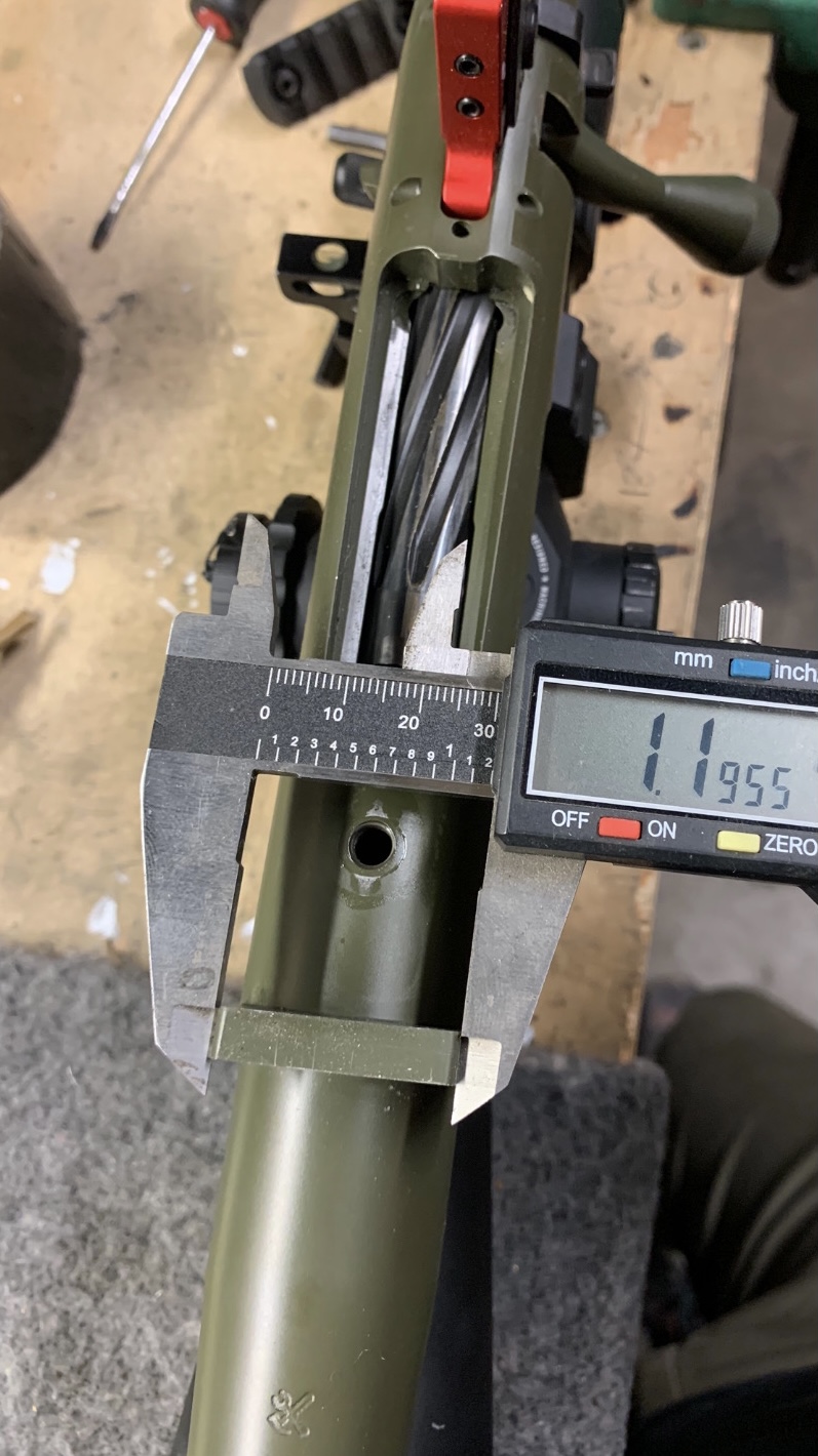

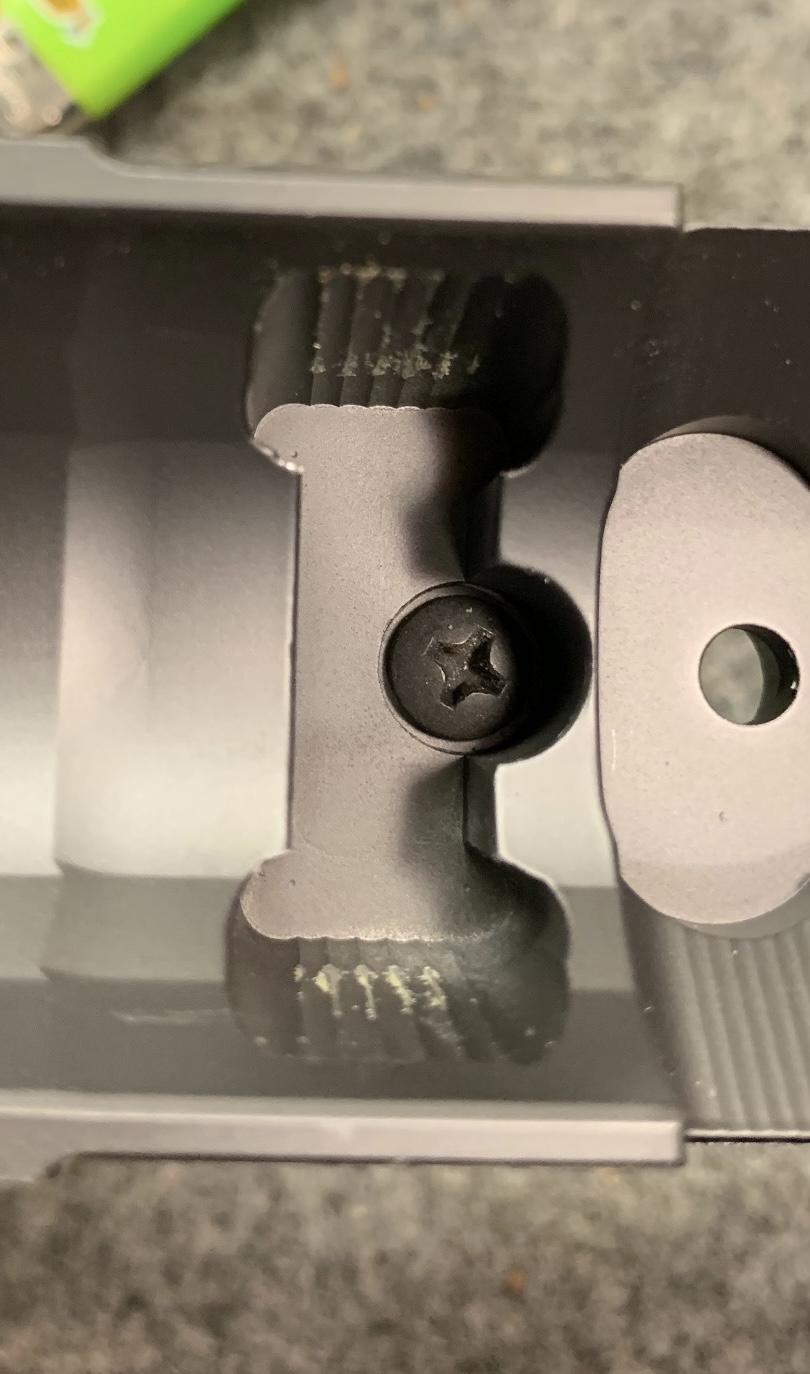

Just posting to say I’m having a similar issue. I got an ESS chassis and pulled my action off my other stock and tried to set it in. Not sure the profile of my recoil lug, but it’s lightly tapered, not as much as others seem to be. When I set it in the chassis it hits a spot halfway down and stops. The inside of the recoil lug slot on the chassis looks like it’s got a more aggressive tape. I measured what seems to be the most narrow part of the slot on the chassis and it’s about 1.18”. The bottom and most narrow part of my lug is 1.195”. Should I just file a little bit off of both sides of my lug? Or do I swap lugs?
That sounds like strange problem, but thanks for bringing it up! What action are you putting in the ESS chassis?
All of our chassis typically allow for a lot of extra clearance around the recoil lug/barrel nut section of the chassis for exactly this reason, but there is a chance we need to make an update :) Also, if you could report your issue to [email protected] and let them know the incompatibility, then we can track it and it'll trigger a product update on our end!

It’s a PTG/Stiller. Rifle made by MHSA. It’s cerakoted OD, and after I tried to seat it I could see some cerakote on the texture inside the chassis where it ran into resistance.

View attachment 7496286View attachment 7496287
Yes, it appears that there is contact between the bottom corners of your lug and the pocket in that ESS body. A small amount of material removal from either the chassis or recoil lug would solve that for sure, and filing/dremeling the chassis will be much easier than the lug (aluminum vs. steel).
Josh
