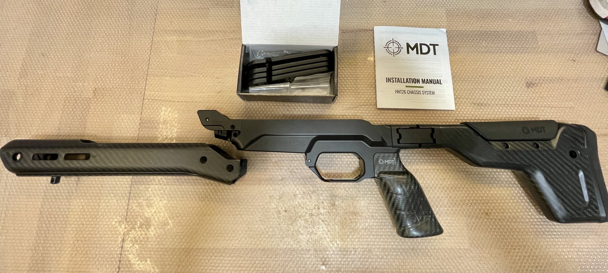

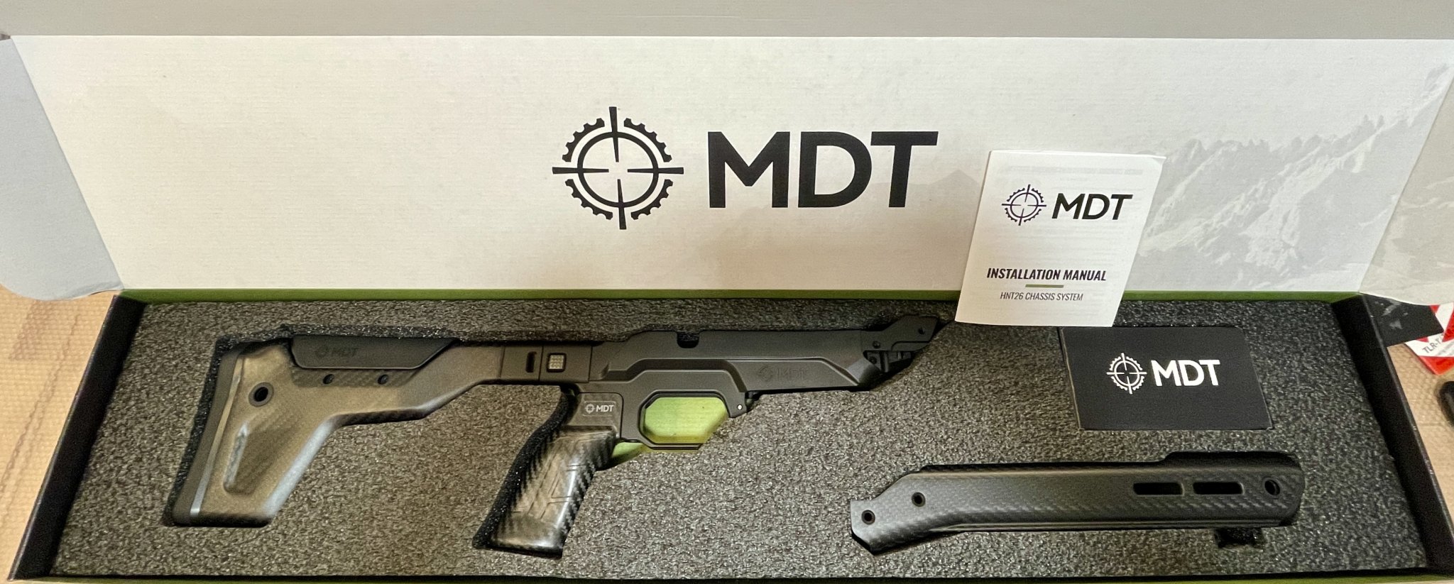

Here are some unboxing pics:

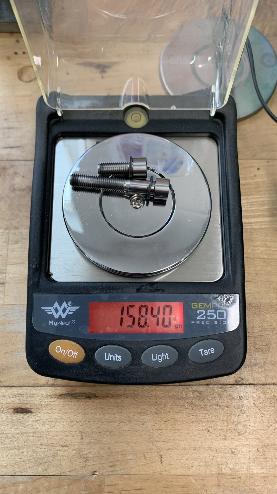

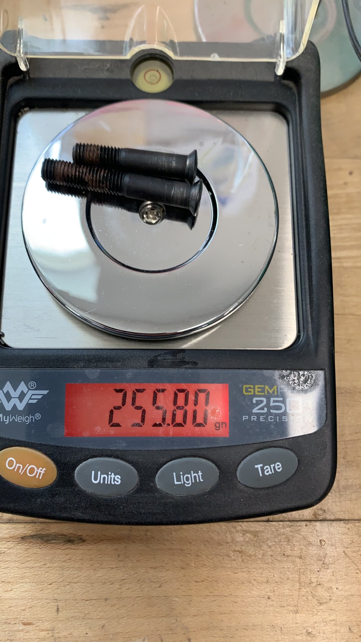

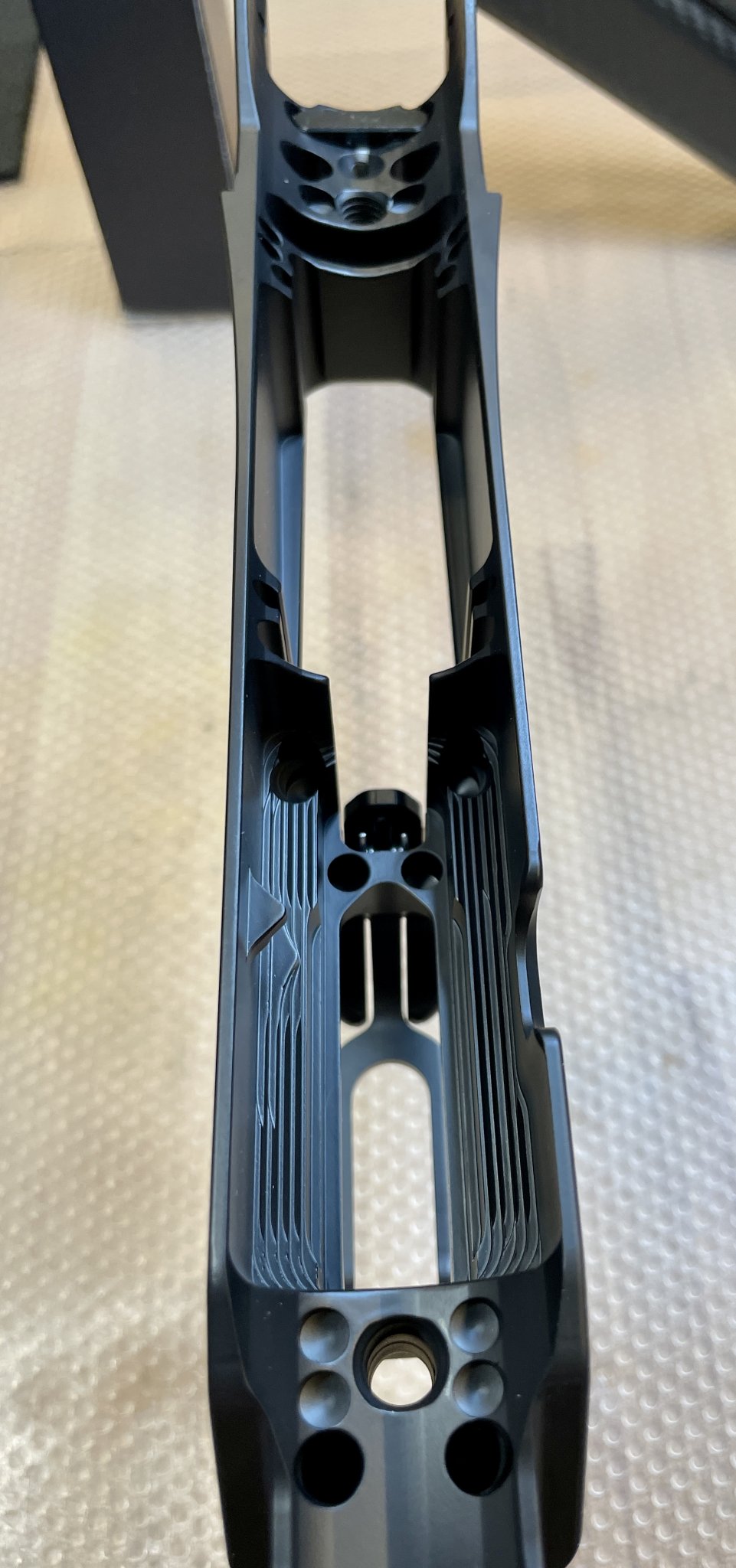

Looks/feels like titanium hardware.View attachment 7710857
Vs standard remmy hardware.

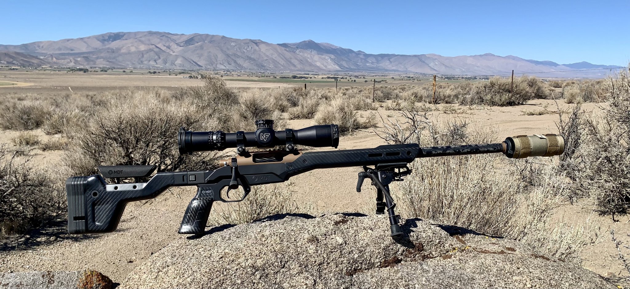

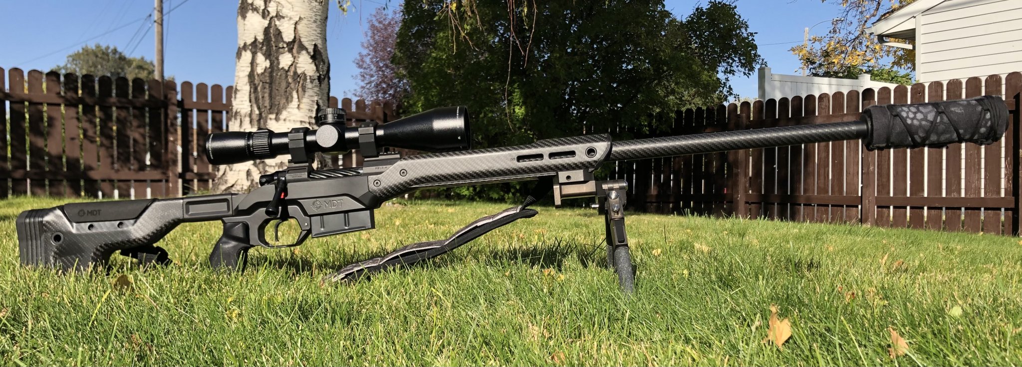

Here’s a lone Peak Razor with a 20” Proof sendero lite barrel in 6.5cm, and Area 419 universal adapter with thread protector.

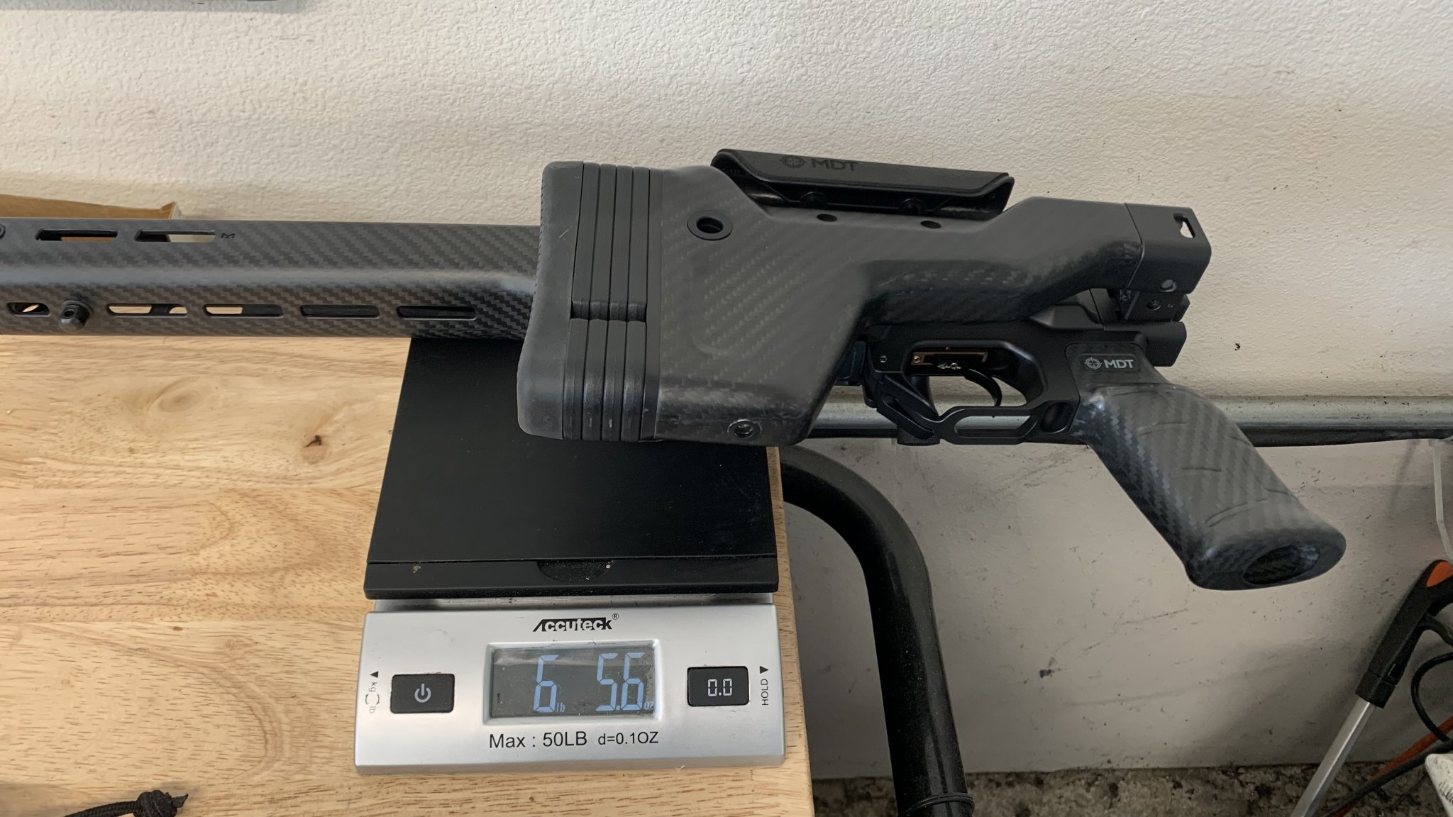

On this scale my bare chassis weighed 28oz on the dot. A polymer MDT 3 rd mag is inserted in the pic below.

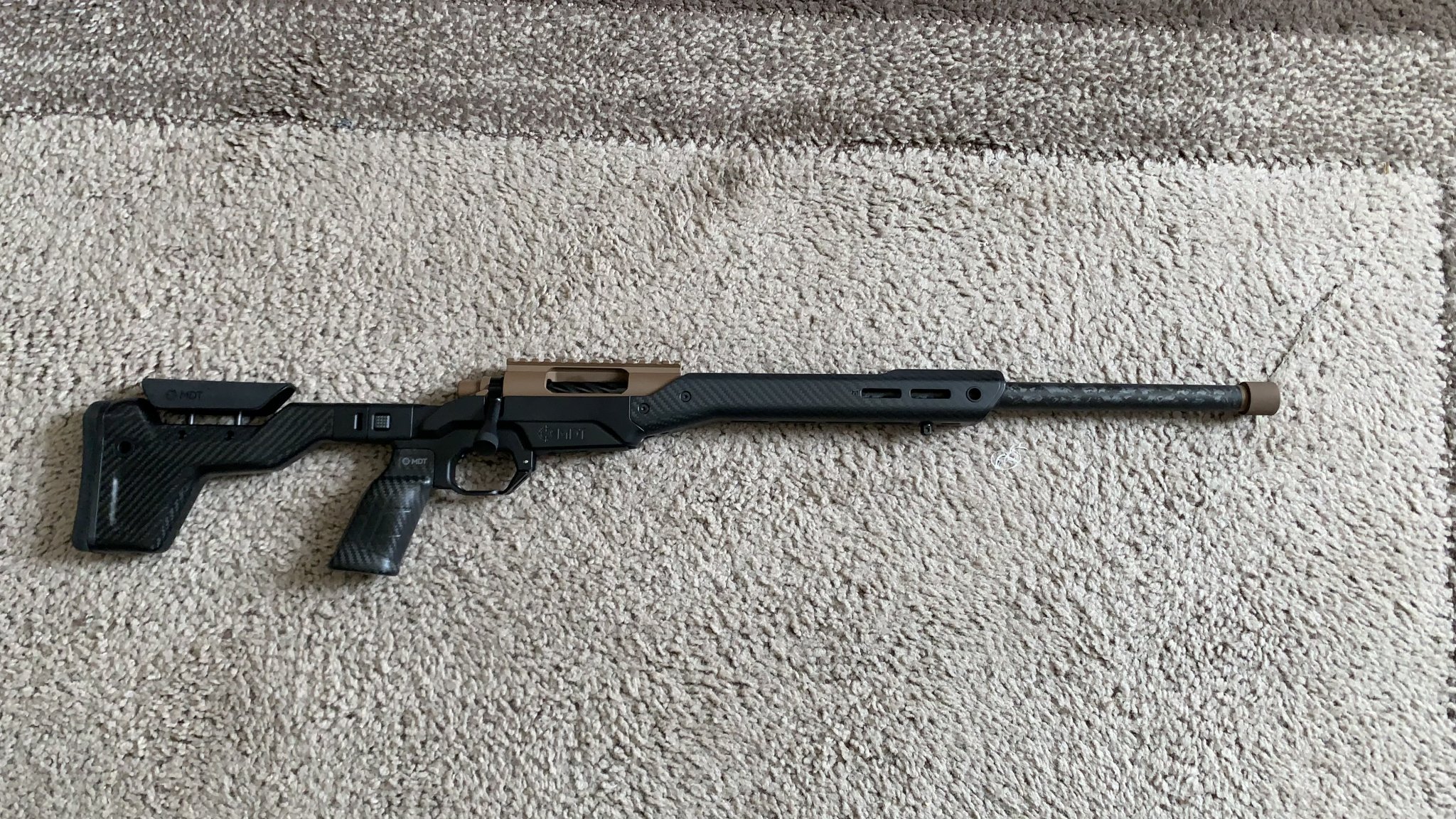

Finally got out to shoot mine. Very happy. The scope below is a test scope. Way to heavy for me on this gun imo.
Never shot the barnes 127 LRX in a Creedmoor, but the only two loads tried shot fine.
Back to back groups with two different loads at 538 yds. Same way it shot in the bedded manners this BA had been in.

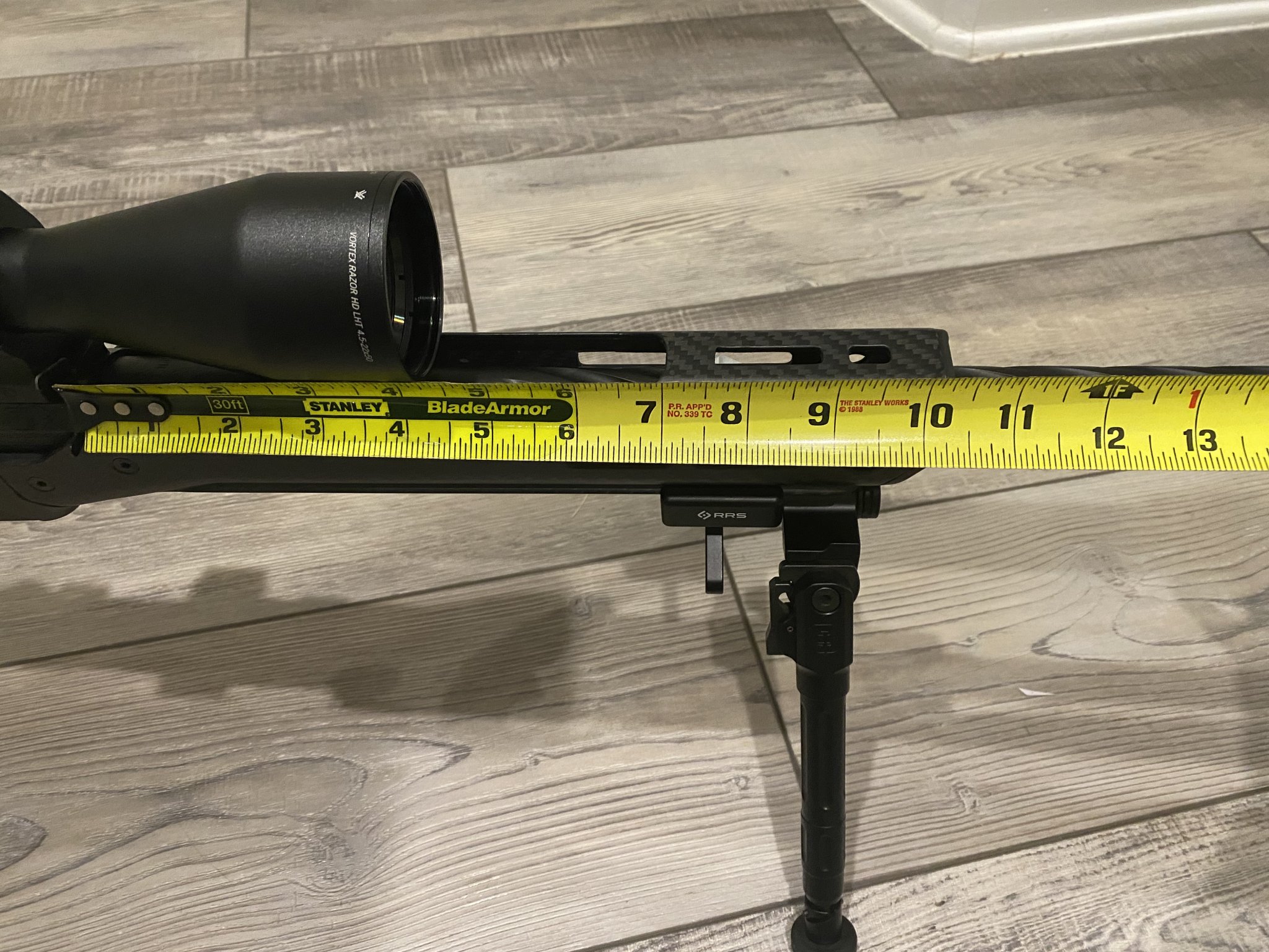

Knowing the measurement from the face of the recoil lug to the end of the forend would be amazing.
Not a perfect measurement, as I just had an old measuring tape laying around and I’ve got a barrel attached, but I hope it helps (was right around 10 3/8”)…

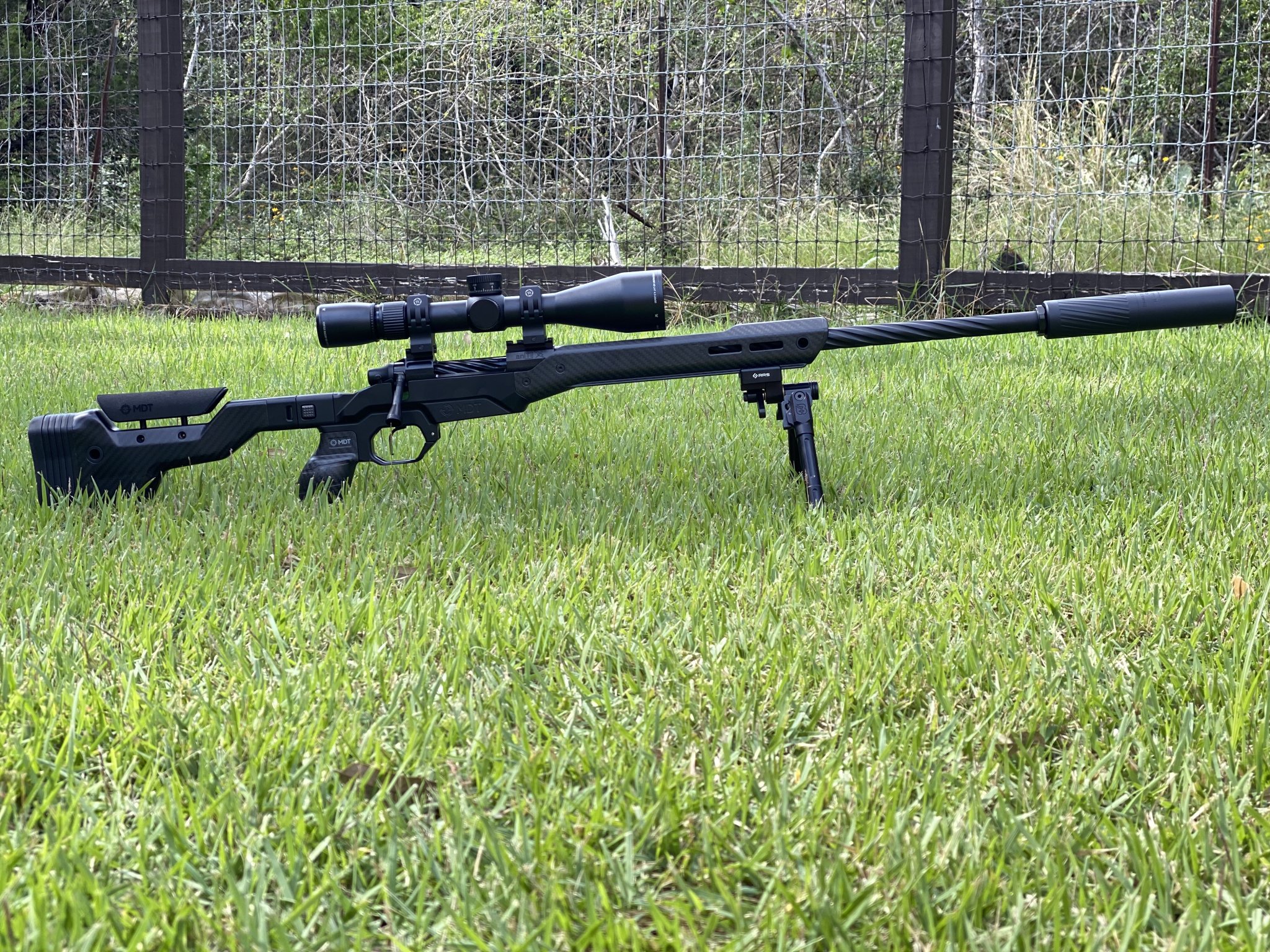

Excited to see some of these in Tikka. Always takes a few photos to sway me…
That said @MDT_OFFICIAL if a guy wanted to do a HNT26 switch barrel gun…recommendations?
The chassis stays the same regardless; pick your preferred action and go from there.

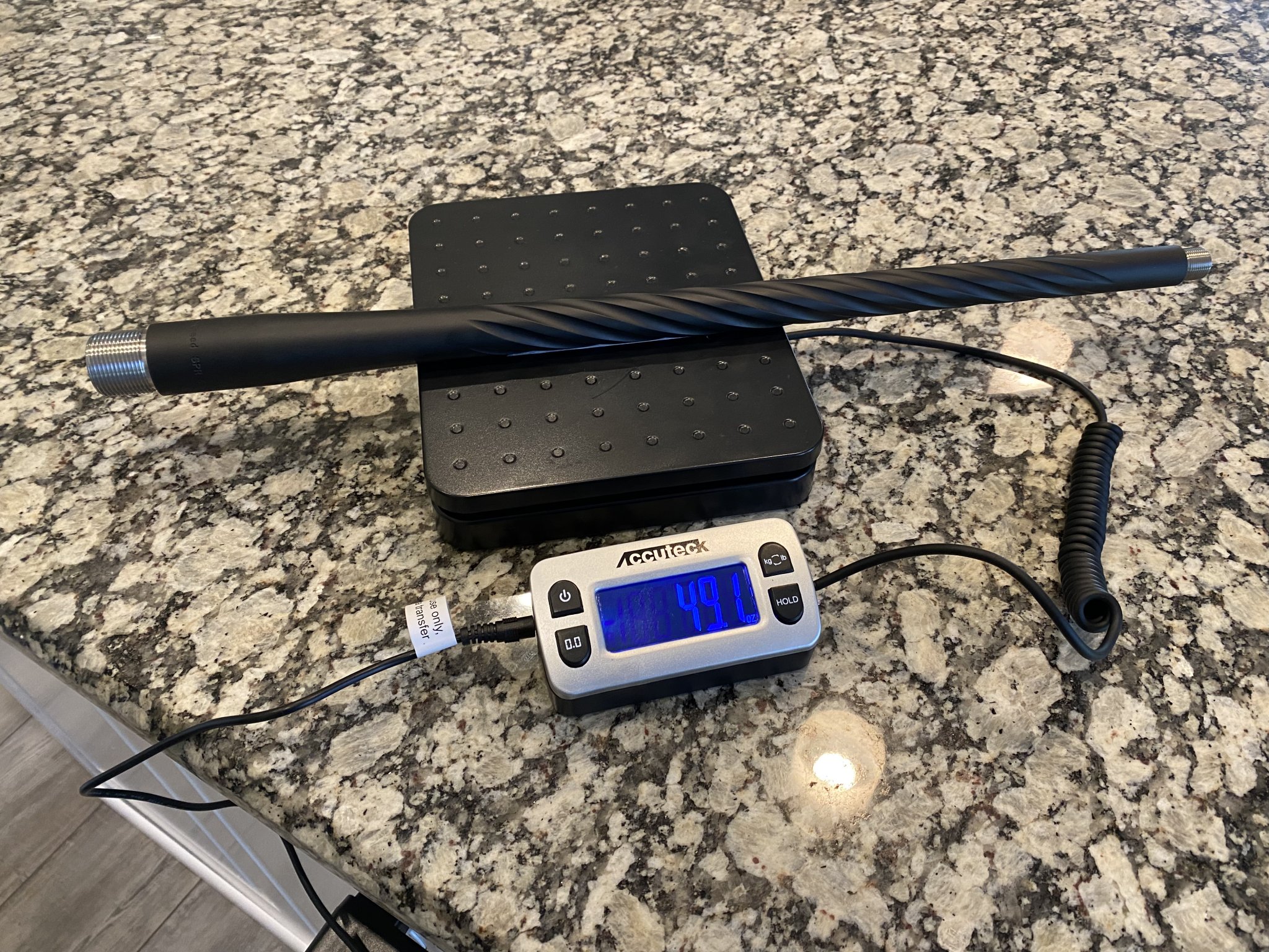

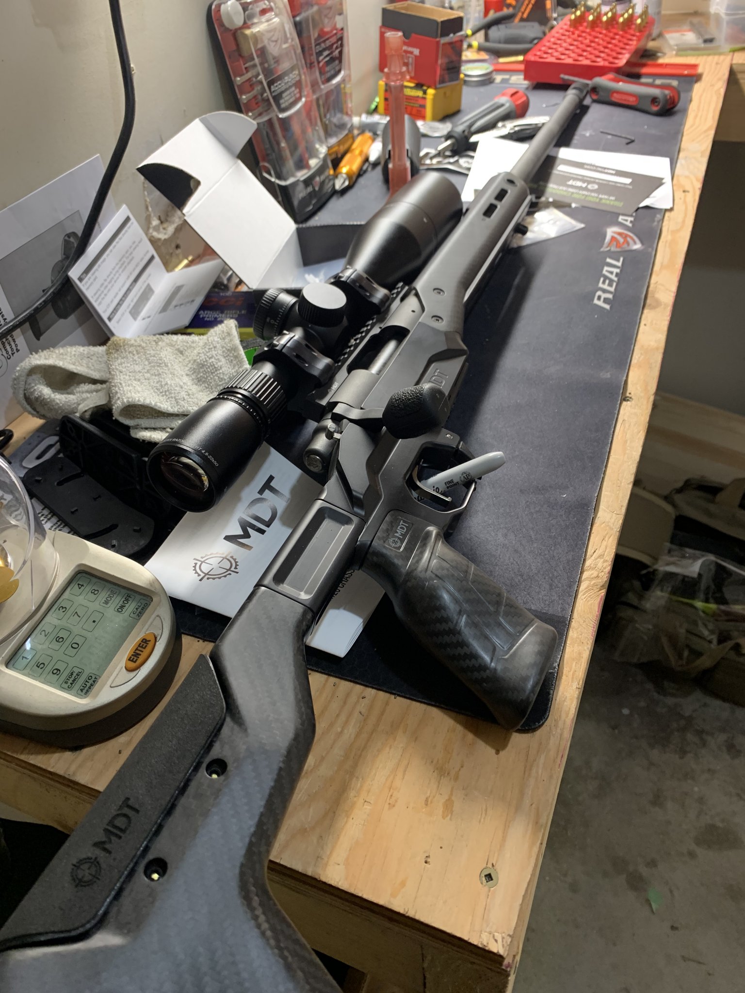

9lbs 0.3oz, as shown, but without bipod. 9bs 6.2oz with 3 round MDT metal magazine. That's with all spacers installed.
MDT HNT26 SA, folder, all spacers installed
Defiant AntiX medium (20MOA/nitrided, notch cut for binderless mags)
20" Bartlein 3b w/ 50deg spiral fluting, chambered in 6.5 CM (didn't want the mirage issues of CF wrapped barrels after strings of fire, and didn't want a pencil barrel I couldn't enjoy at the range)
TBAC Ultra7 G1 with Area419 universal mount/adapter
ARC M10 medium rings, 30mm
Vortex Razor LHT HD 4.5-22x50 (waiting on someone to release something better that isn't overly heavy; TT315 doesn't have enough magnification for me, for my purposes, and ZCO 420 is too heavy)
The barrel alone is 49.1oz, which goes to speak about how light this chassis is.
You can actually use a decently thick profile on the barrel and still end up at a 9lb rifle, scope included, without really giving up much at the range.

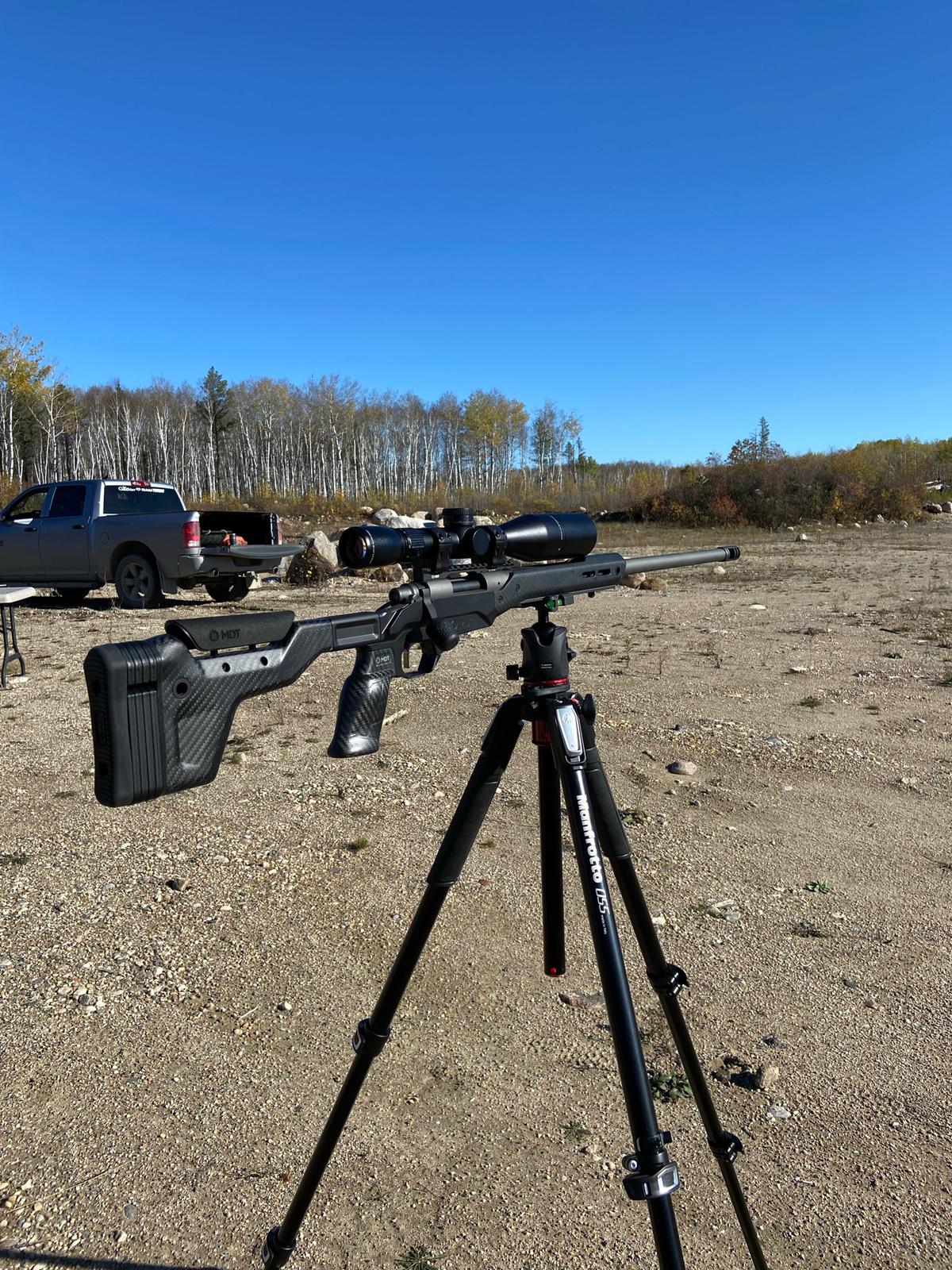

I just got mine last week too. What head w/arca clamp are your using on that manfrotto tri-pod and do you like it? Most of my gear is picatinny rail but for this rifle I thought I would try it out.
If you cut that center post down about 12" you can get pretty close to the ground without losing height on the top end you will likely never use
The Manfrotto is ok. I like the head but the unit is not as solid as my Vortex Radian(it’s also half the price…)
I don’t think I’ll ever have another rifle that isn’t setup for Arca, it makes everything so much more stable and it’s nice being hands free when I want.
I hit my 850 yard gong on the first shot standing right after taking that picture, the accuracy you can get locked into a tripod is amazing.
