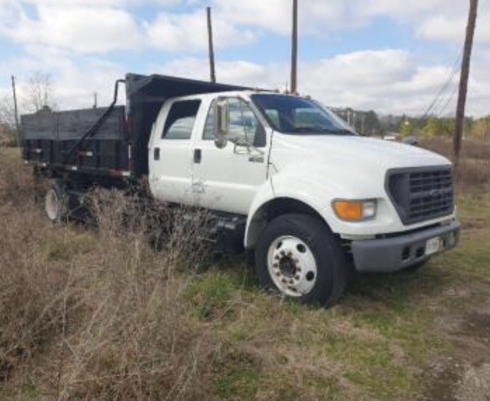

Ok. I’ll PM as well. Just bought a 2000 f650 dump for my farm. 24v 5.9 Cummins. 6 speed Eaton trans. Thing only had 13k miles. Bed looks like all it ever hauled was sawdust. Inside looks brand new. Check engine light was on but fired right up, smooth idle, no chuffing at the oil fill cap, no tight top radiator hose after driving a bit, no other YouTube used diesel warning signs lol. I can hear the turbo spool up faintly (loud truck) No oil leaks, not a 53 block.
So, I bought it and headed back to Tennessee. On the interstate though, thing is a pig. Not able to maintain speed on hills, etc. I bought it to pull a mini excavator and I can’t see any way it’d do it. I don’t need fast but I need torque.
I ordered a Bluedriver reader and it powers up but won’t read codes. It’s got an OBD port under the dash, but I think it may also have a 9 pin connector.
So, I’d like some direction on a reader that might work. It’s my first diesel so I’m not familiar with what one ought to feel like. It may be that I’d be fine if it was performing to factory expectations. If not, I’d love some direction on how to get a little more pep out of it.
edit: looking around a bit, looks like based on the year it could be a 6 pin port too. I’ll check it out when I get home from work today.
Thanks in advance.
Shep

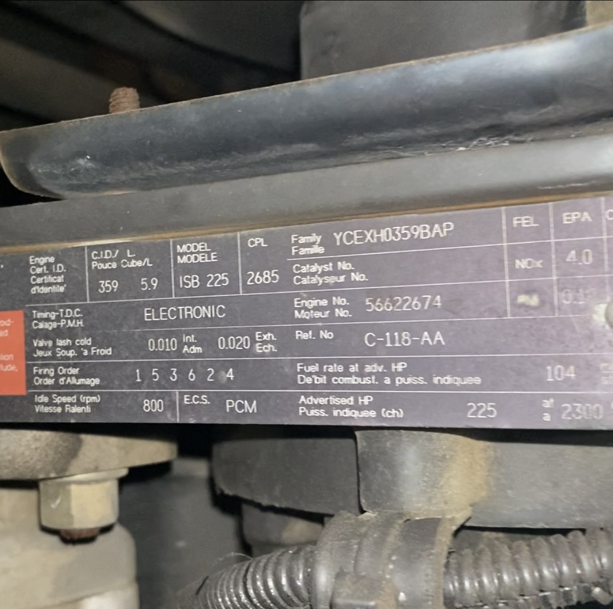

Can you take a picture of the engine tag? Should be in the left side of the engine on the side of the gear case. That year I believe is a 195hp or a 215hp.
The connector for engine diagnostics may be a 9 pin which is a j1939 connector. It is the connector that is used in heavy duty trucks compared to the standard obd 2 port light duty.
I would start with the basic, do a full service in the engine. New fuel filter, air filter, new oil.
Reactions: Mooseknuckles
I have access to Cummins Quickserve at work. Those 5.9 24v with the vp44 pumps are decent engine. Known for having lift pump issues because of the mounting location. But with 13k on the engine I would think it was a lift pump issue.
If it’s a manual trans which it looks to be then it’s the 235hp version. Double check all the regular stuff but also take a look around the exhaust manifold, if there is the slightest leak you are not getting boost. You have very low miles so I don’t think it could be a cracked manifold but I guess it’s possible. Although not as common on the manifolds that the collector is between cylinders 3 and 4 but it’s worth looking.
