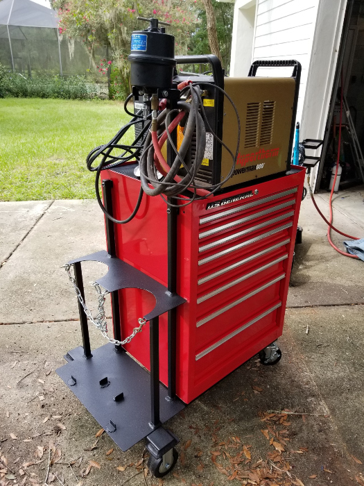

In case anyone cares, I highly recommend avoiding factory-made welding carts. I built rolling frames that held US General tool carts, and they are wonderful.
