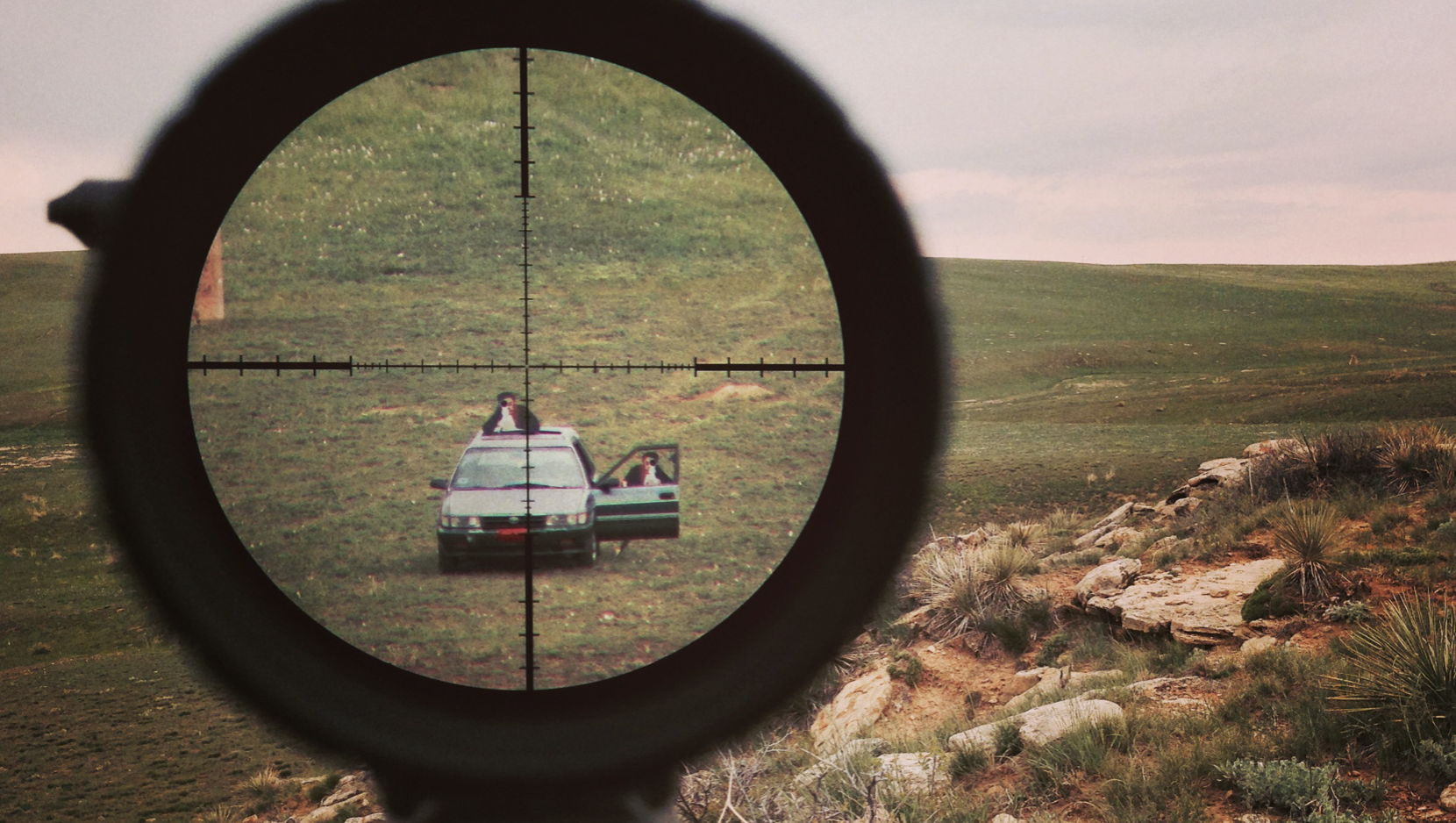

I have a 12" wide target at 450 yards.
how many mils is that?
if I take 3.6" x 4.5 = 16.2" so 1 mil at 450 yards = 16.2"
the target is 12" wide so 12" devided by 16.2" = .74 mils.
So the target is .74 mils in width at 450 yards.
Would this be correct?

You could also have the shooter tell you how large the target is in Mils/moa, save a bit of time on that mental math.2) If you know your range and target size and you are the spotter, do the math to convert your target size into Mils at the beginning of the shooting session. 1 mil = 3.6" for every 100 yards, or 3.94" for every 100 meter or whatever units you want. Figure out how wide your target is (example 0.6 mils) then give corrections on the fly using the target width for estimation. You see shooter miss off left edge, you would call "come right 0.3 mils" and so on.
